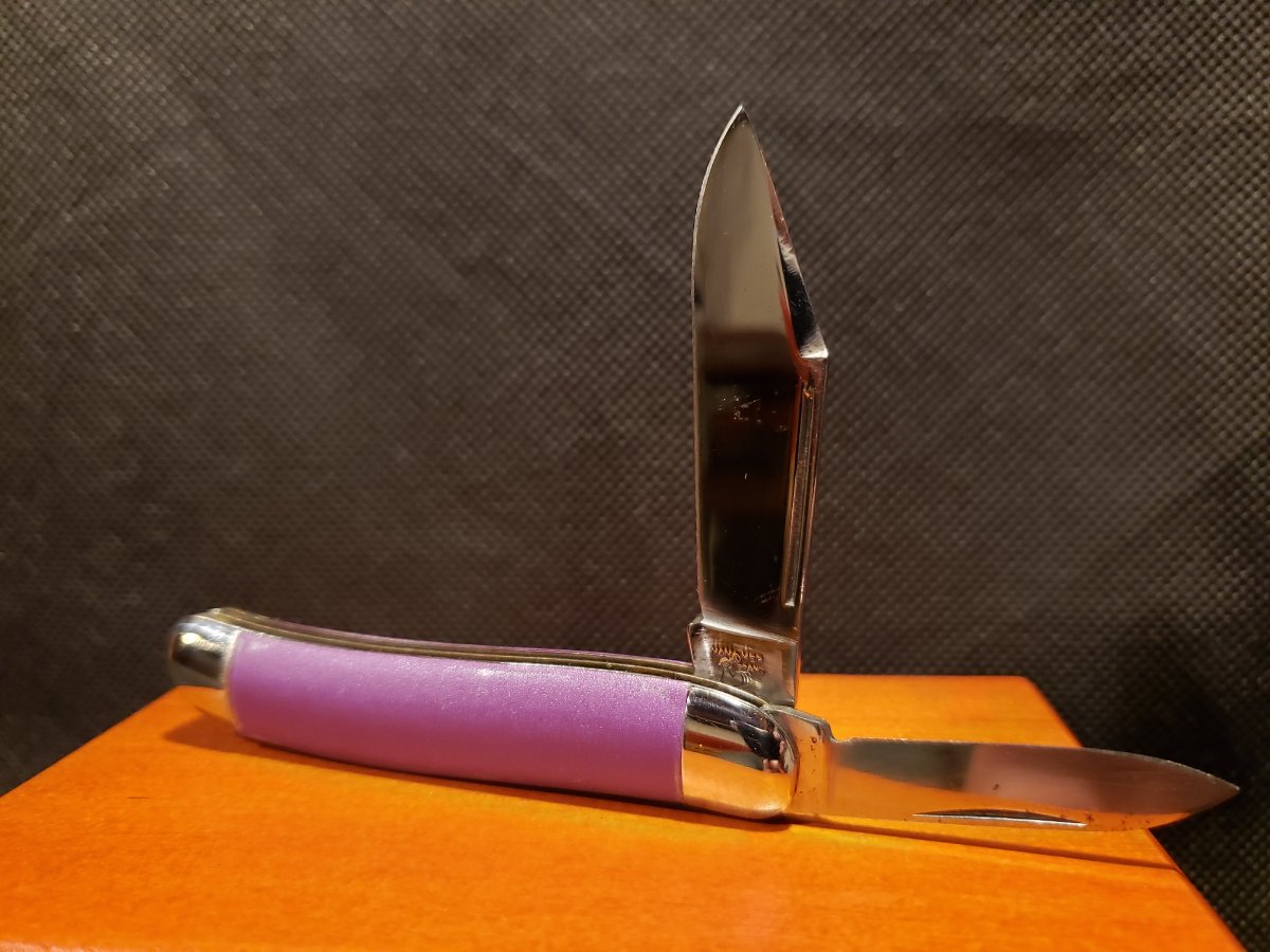

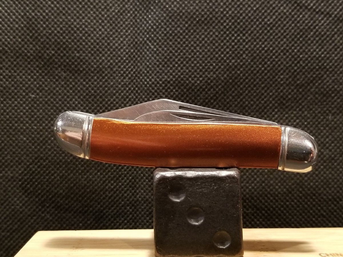

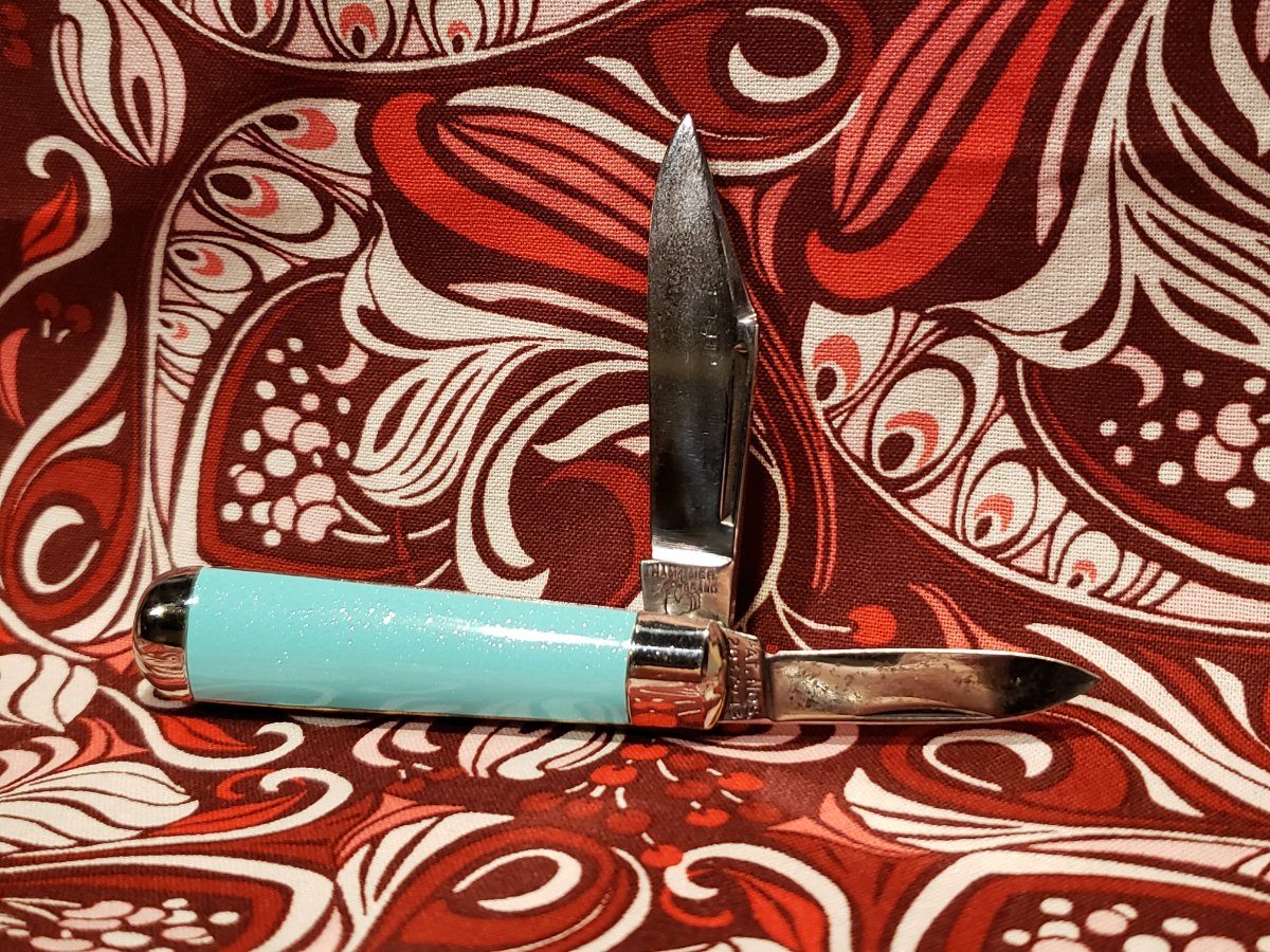

If you're looking to replace the celluloid film covers that can be found on shell construction knives, craft vinyl works well. Easier than a full conversion.

I have painted some shell handles, but never tried the vinyl. Those look really great! Are they glued on?ThatWeirdKnifeGuy wrote: ↑Wed Jan 22, 2025 1:25 pm If you're looking to replace the celluloid film covers that can be found on shell construction knives, craft vinyl works well. Easier than a full conversion.

The vinyl is adhesive backed. Some is stick on just like a big sticker. Cut to size and stick it on, leaving enough excess to wrap under. Other varieties are heat-transfer. Those are meant to be applied to fabric in a heat press. They're more difficult to work with, but stick better if you can get them to work for you. I use a heat gun. For some colors I have a clear vinyl I'll layer on top. It gives a textured look and extra durability. Its actually a product for patching holes in tents.Reverand wrote: ↑Thu Jan 23, 2025 2:07 amI have painted some shell handles, but never tried the vinyl. Those look really great! Are they glued on?ThatWeirdKnifeGuy wrote: ↑Wed Jan 22, 2025 1:25 pm If you're looking to replace the celluloid film covers that can be found on shell construction knives, craft vinyl works well. Easier than a full conversion.
