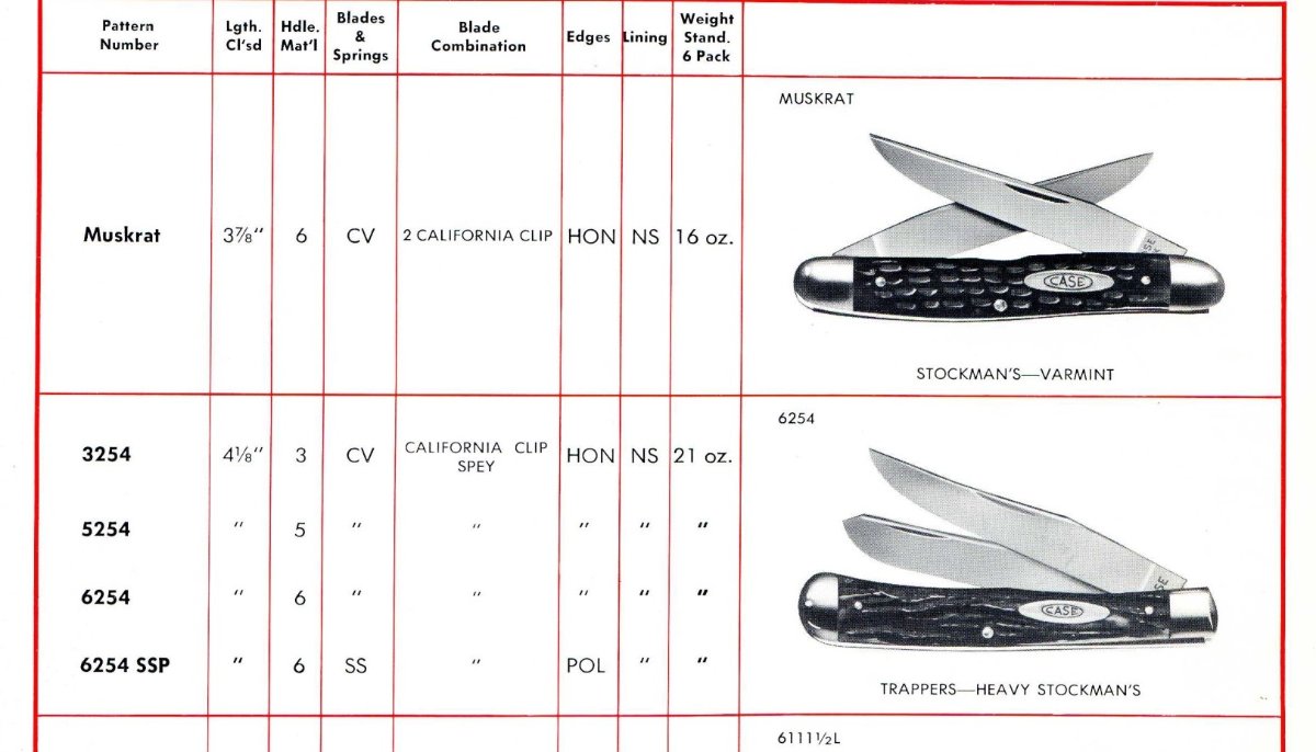

The the "common 54 master" has always been a California Clip. Period, case closed. At least that is what Case called it in every catalog from the Tested years to the present. Yes, Case has recently made other versions that can still be called "California Clip".Modern Slip Joints wrote: ↑Thu Jan 09, 2025 5:15 pm Count me among the confused but with an opinion none the less.
The research section here contradicts itself. It has drawings of the blades used by Case that include a cip point that looks like the common 54 Trapper master labeled clip point. However. in its description of pattern numbers it writes collectors call the '64 -'69 era muskrat blade a clip point to distinguish it from the common 54 master blade.
Five blade 54s made in the first decade of this century contain three long clip blades, the common 54 master, the long pull regular clip blade from the select series and a California clip blade that is much less broad and has a much finer point than the common 54 master blade. That "narrow" blade is undisputably a California clip. I have only seen it in five blade 54s.
Case catalog exceprt from Catalog #70 - 1970 era.

In viewing the illustration posted by Steve there is obviously a difference in the blade shape of the muskrat and the 54 trapper yet both are called California clip blades which leads me to believe that the term "California clip" is a style rather than a unique blade production.

Correct. A “clip” blade is one having the end “clipped” off to form a point. There is no standardized template of dimensions for any blade. A good example is the Case 83 “whittler” pattern, which has two clip blades. One long master clip blade and one short secondary clip blade. The “California Clip” (some cutleries called it a “Turkish Clip”) is simply a slender clip blade. It’s a style of blade
And when manufacturers make tooling updates/changes, typically minor (or sometimes major) improvements are made. It does not surprise me at all that there are slight variations over time in the dimensions of a given manufacturer’s “California Clip” blade. Nor that a “California Clip” style blade would differ from one pattern to another, even within a given cutlery.

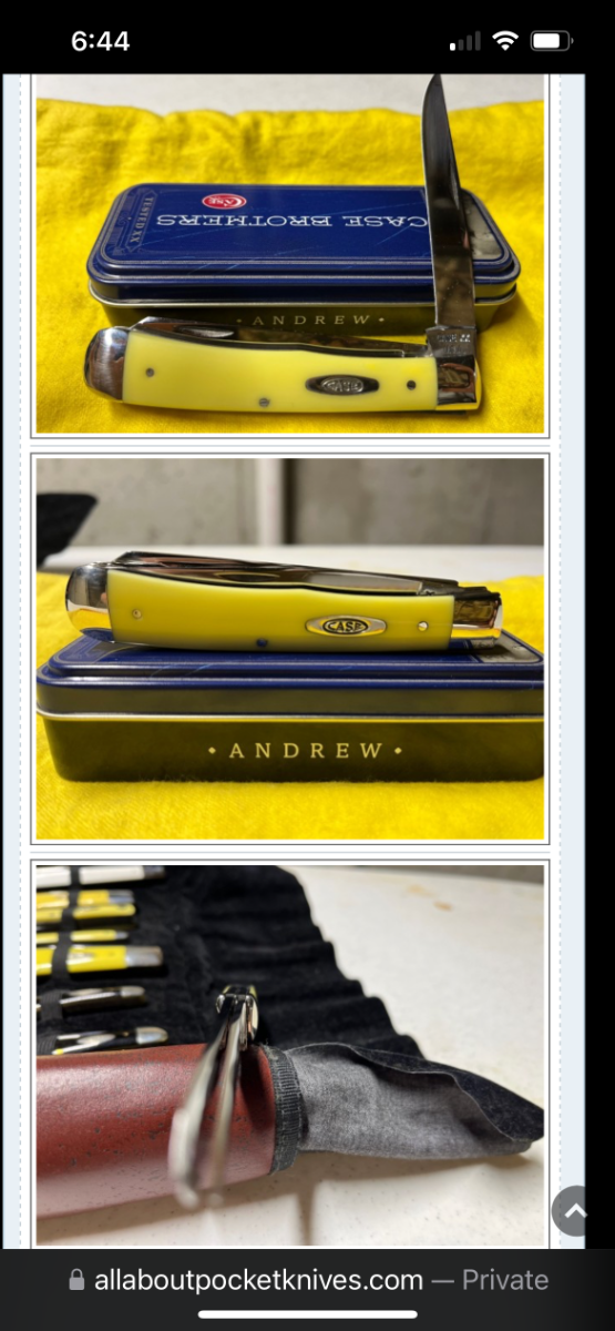

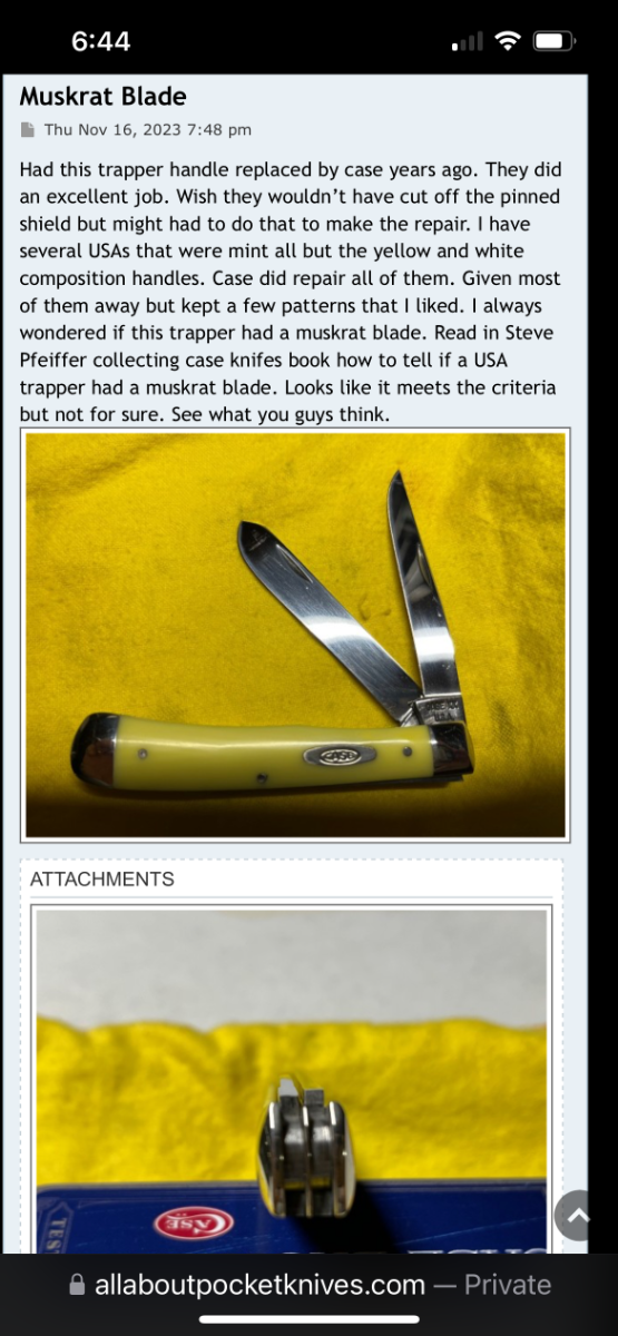

I posted this on the Case knife forum in November of 2023. Pictures show the different characteristics that it met to have a Muskrat blade. Steve Pfeiffer confirmed it to have the Muskrat blade. I still have the knife just haven’t found the right person to give it to.
