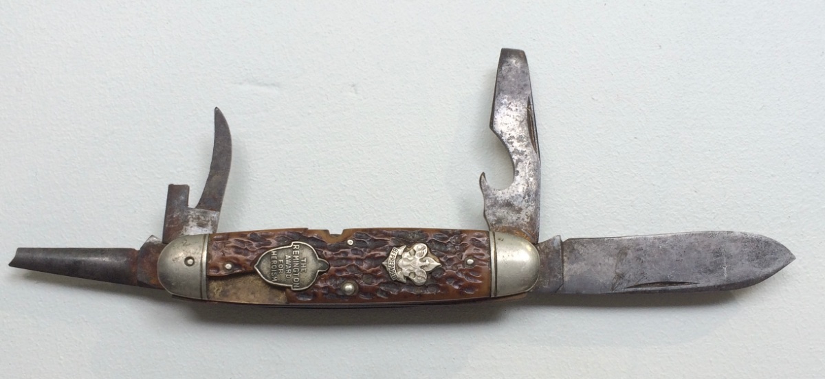

As long as it’s a 1-for-1 substitution, I have no problem with this change, but those in the know will know the knife has been apart.KaminskiJL wrote: ↑Sat Dec 28, 2024 8:10 pm…..I wonder though about those who modify knives by removing broken blades or otherwise changing the characteristics of the original knife?
in the case of this knife in my collection, I would never consider repairing the bail, can opener, awl/punch, or mark side handles; it has too much historical value left as-found.KaminskiJL wrote: ↑Sat Dec 28, 2024 8:10 pmfrom a collectibility standpoint is it better to leave the broken blade stubs in the knife or can they be removed without affecting the collectibility/value of the knife?
