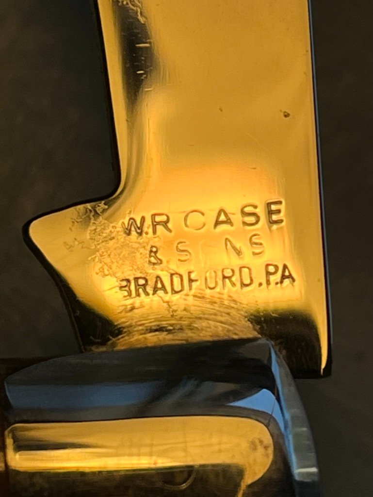

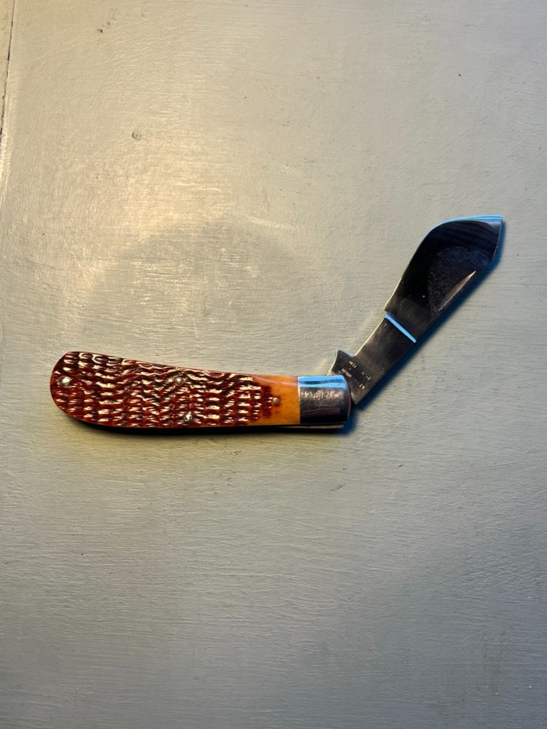

Hi, I purchased a Case brand knife at an auction and was told that it was possibly rare. I need help. I have searched and cannot verify if it is true or not. I am attaching pictures of the knife in hopes that someone can help me understand what it is. I was told that it is a "Cotton Sampler" or "Cotton Cutter". At the auction there was a lot of interest in it and bidding activity. If someone could point me in the the right direction I would deeply appreciate it. I would like to know more about the knife and possibly it's value. Thank you.

There is one pictured in Sargent's 7th edition but it shows an arched tang stamp and the Tested XX in a circle I don't think was used until the Bradford era. I myself would be a little suspect of the knife, of course I am by no means an expert. It shows a value of $1500 for the WR Case and Sons Cotton sampler.

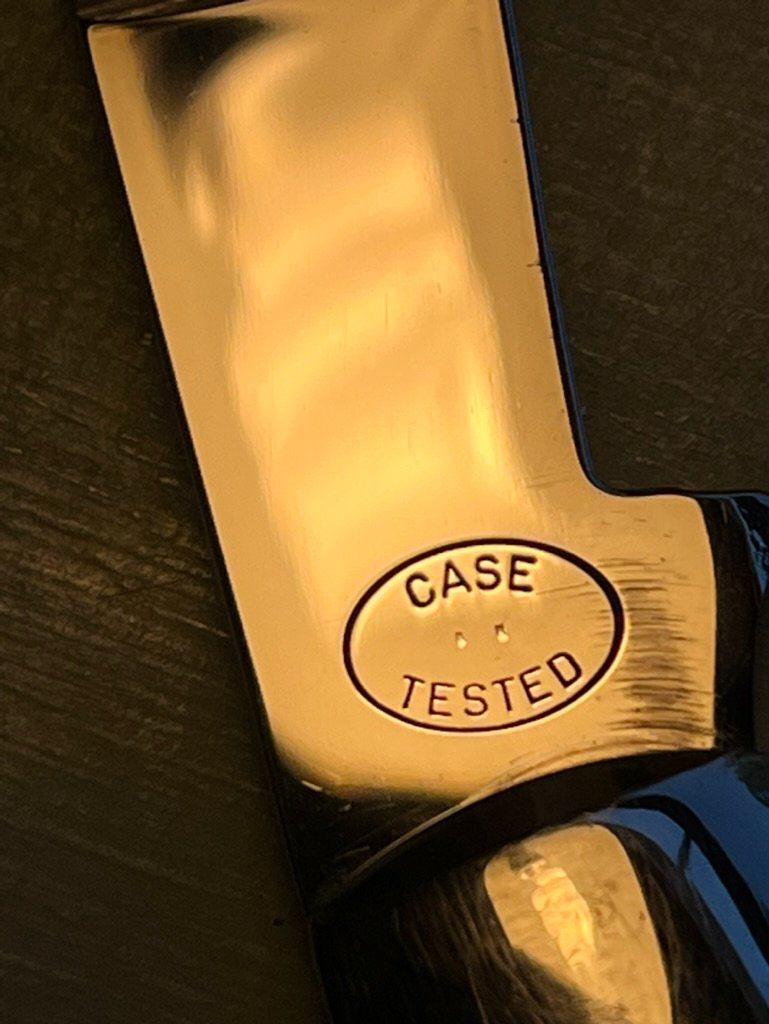

I'm far from expert but brand new looking bone on a knife with a heavily buffed blade makes me skeptical. In th AAPK research section the pre-1920 Case over Tested in a circle tang stamp has two Xs in the center, not two dots.

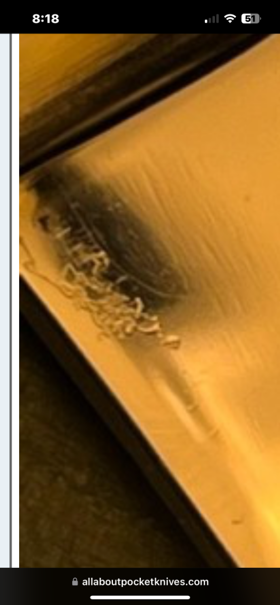

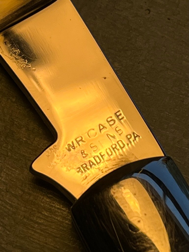

Tang stamp has been nearly removed by over polishing, and grinder marks next to the Case Tested stamp raise some questions. Someone has been at work trying to "improve" this knife.

At best, I believe that the knife has been both rehandled and heavily buffed, either of which would devalue it greatly.
At worst, it is a counterfeit.
There are definite signs that it is an older blade that has been buffed, but I don't know that it is a Case blade. The front looks slightly cold stamped, and both stamps look new to me. Buffing rarely cleans out the bottom of the imprint without wearing away the stamp itself.
Hopefully someone on here has an authentic Cotton Sampler and can compare the rest of the knife, but from what I can see I believe that it is not at all an authentic knife.

I'm not a Case expert by any means. But I have handled enough old knives to be suspicious of this one. The difference in condition of the stamps is concerning. One side is blasted, the other is crisp and clean.
At the very least I think I recognize those scratchy tool marks. That's what it looks like when you're using a Dremel to buff and polish but you get a little careless and scrape the spinning chuck against your blade or bolsters. This is the one thing that I'm an expert at

OP knife is a horrid fake. Lots of red flags, some already mentioned, but it is as simple as this: Case never owned (or used) the TESTED XX trademark during the time the W.R. CASE & SONS tang stamp was used (~1905 - 1914). TESTED XX was a trademark owned by Case Brothers Cutlery, a competitor of W.R. Case & Sons. W.R. Case & Sons acquired the rights to TESTED XX only after Case Brothers bankruptcy, about which time their stamp was changed to “CASE BRADFORD”.
If you find a knife marked W.R. CASE & SONS and TESTED or TESTED XX, it’s a counterfeit.

The evidence tells us that it is100% not factory and collector value is $0 however just as a broken clock is correct twice a day, your knife is functional as a $10 tool.

Yes, as others have pointed out, to me this one is an "across the room fake".
Two things about the cotton sampler pattern:
#1 - authentic antique cotton samplers are EXTREMELY rare in any brand. It may be considered the rarest hardest to find traditional pocket knife pattern.
#2 - cotton samplers in recent years have been widely faked - in both Case stamps and in others, like oddball hardware brands.

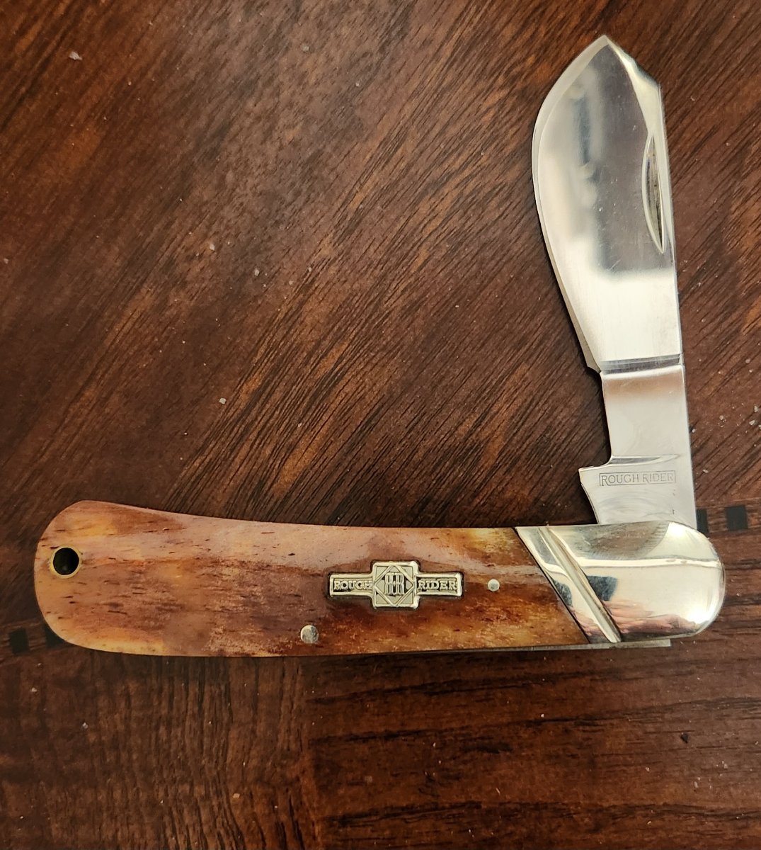

Regarding #2 above, this has been facilitated because a few modern knife companies - notably Bulldog and Rough Rider - have produced a lot of cotton samplers. Counterfeiters can restamp/rehandle these.
Faking of cotton samplers has gotten so bad that whenever someone contacts me or texts me saying that they have a vintage cotton sampler that they want me to look at - my immediate reaction is that there is a 99.9% chance that it is a modern fake.
