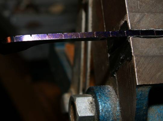

This is a series of pictures of the steps I took to create some filework. Hope it helps someone. I dreaded the first attempt because I hadn't thought it all out but now I can see my way clear and hope these pics encourage more people to try. Any critique, comments, criticisms or other ideas are weicome since I am just starting out on this.

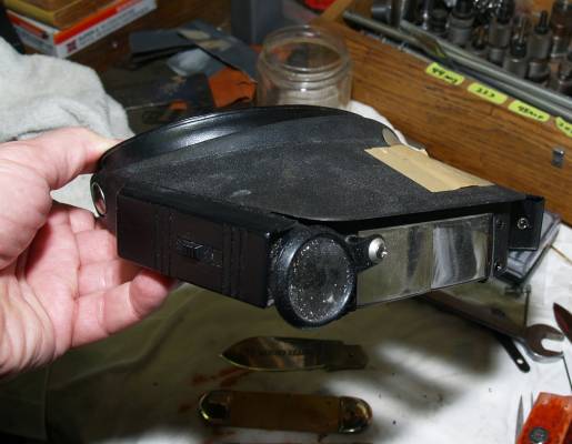

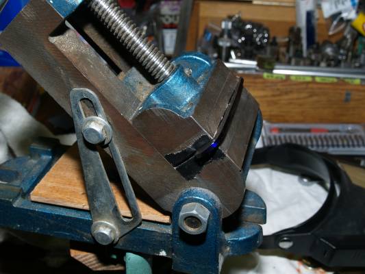

Good set of eyes
Good set of eyes

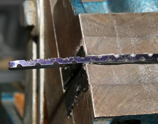

Good way to hold your work

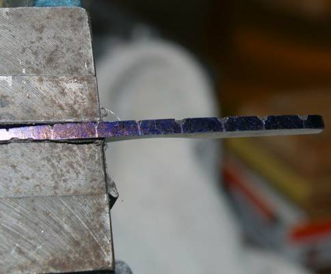

color the work surface with thick layer of felt tip marker or dye. Mark using divider/compass

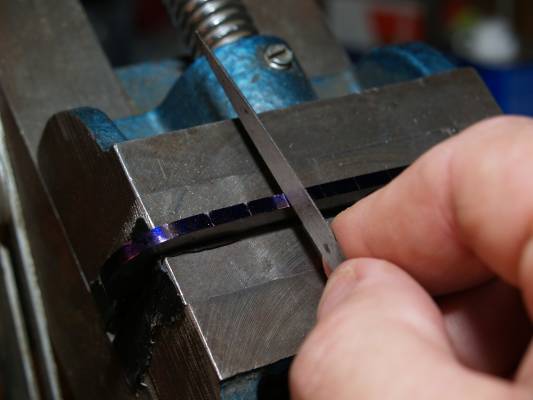

Start a small groove at each mark using a half round file, very important to be accurate and start file almost flat on working surface.

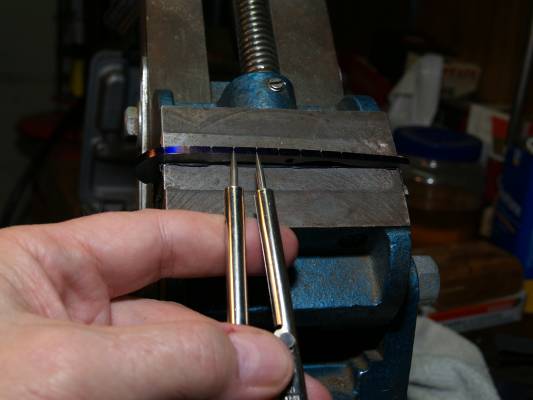

check work often with dividers to ensure accuracy
make grooves deeper using triangle needle file

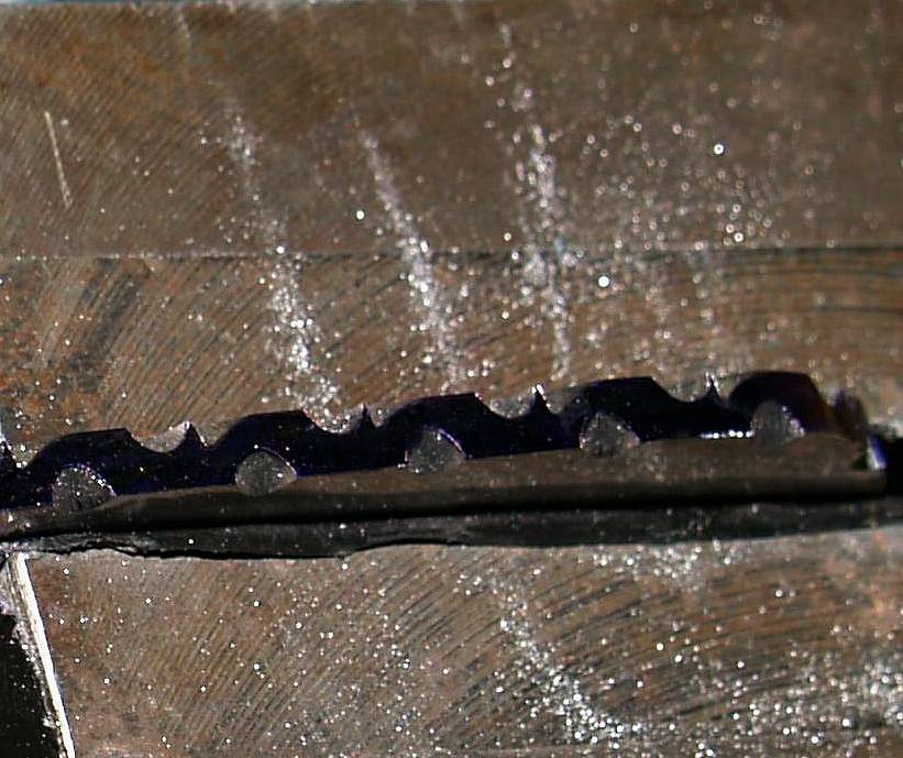

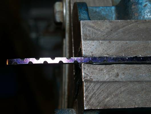

now use round needle file to make grooves as deep as half the stock and at 45 deg angle to work surface.
do same thing exactly half way between opposite side notches

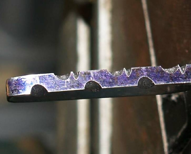

using halfround needlefile cut groove right next to u shape and same depth as round groove.

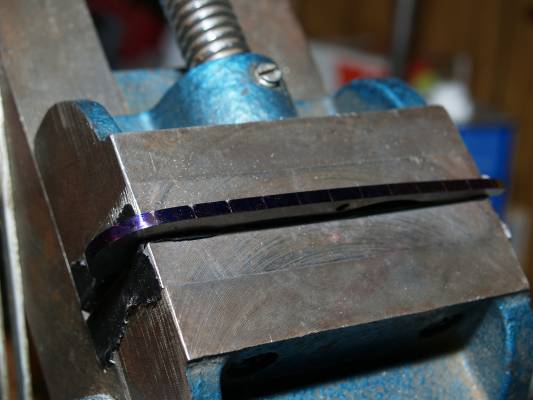

better view
better view

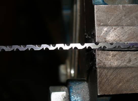

round groove just created over to the right

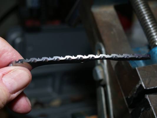

here is a picture of the project halfway done
needs polish
needs polish
