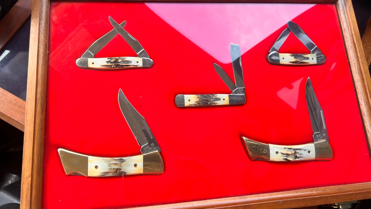

I need a little help identifying this set. This is a untouched collection. Came from case like this and had never touched or removed from the display

Welcome to AAPK!Bladeunner70 wrote: ↑Tue Jul 09, 2024 8:11 am I need a little help identifying this set. This is a untouched collection. Came from case like this and had never touched or removed from the display
I can't see the tang stamps on the knives clearly, but they are clear enough to see that there are a couple of different years of manufacture in the display case. What your knives have in common seems to be the handle material which appears to be stag.
Pictures, close ups of both side of the blade will reveal the information you may be seeking usually the front or mark side will reveal the year or era of manufacture and the back or pile side will identify the pattern information.
You have a great looking display!
Treefarmer

Re: Case xx set
Welcome to AAPK. Nice looking set, but I’m curious about your statement that it came from Case intact as is. Although it may be true, what evidence do you have to support that? Displays made in-house by Case typically have the Case company name embossed on them, either on the wood frame or in gold leaf or other decal on the glass. The knives in the display will typically all be from the same year of manufacture, or at most from two consecutive years. Hard to tell from your picture but I see knives from at least two or maybe three different years.
Just my anecdotal observations, which admittedly could be wrong. Not trying to pick an argument but curious to learn something new. Maybe someone here will recognize the set as you hope to learn.

Re: Case xx set
I tend to agree with Ken's assessment. Hard to tell for sure from the pictures, but the lockbacks on the bottom appear to have the Floating Dot stamps from 1994 (6 Dots) and the other three knives appear to be 4 Dot 1996 models. It is a beautiful set of knives, but I feel like they were put together in this display after they left the factory. I suppose Case could have put this group together for some special occasion, but I wouldn't think it's a regular production set. I could definitely be wrong as well, but either way, it is a nice looking group of Stags.Mumbleypeg wrote: ↑Tue Jul 09, 2024 3:12 pm Welcome to AAPK. Nice looking set, but I’m curious about your statement that it came from Case intact as is. Although it may be true, what evidence do you have to support that? Displays made in-house by Case typically have the Case company name embossed on them, either on the wood frame or in gold leaf or other decal on the glass. The knives in the display will typically all be from the same year of manufacture, or at most from two consecutive years. Hard to tell from your picture but I see knives from at least two or maybe three different years.
Just my anecdotal observations, which admittedly could be wrong. Not trying to pick an argument but curious to learn something new. Maybe someone here will recognize the set as you hope to learn.![]()
Kevin
