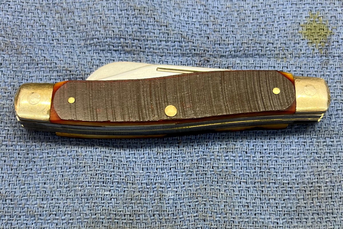

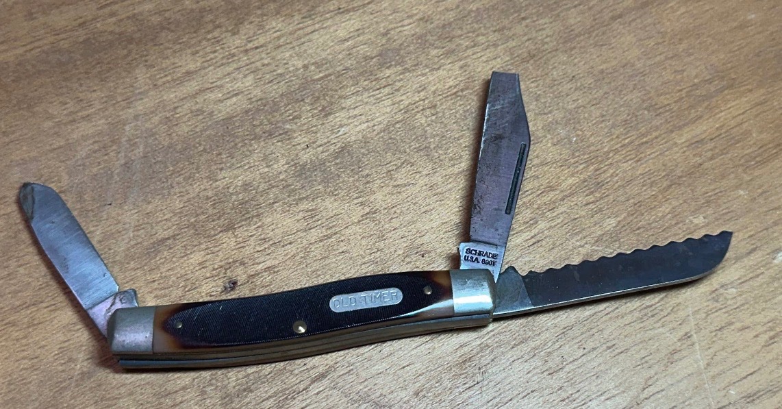

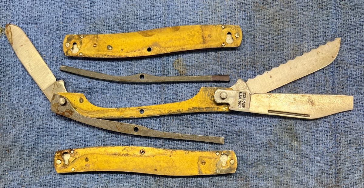

Here is the patient sitting in my ER.

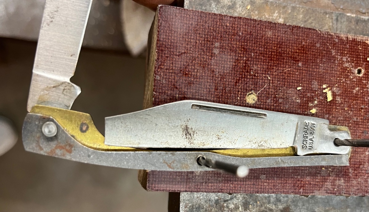

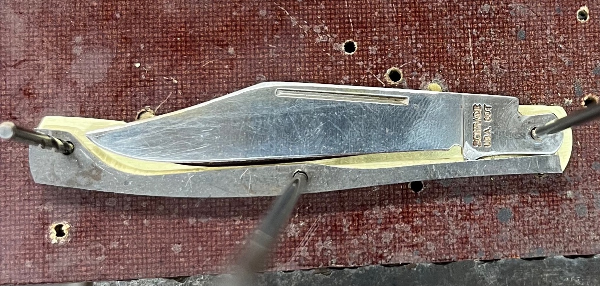

OK.....

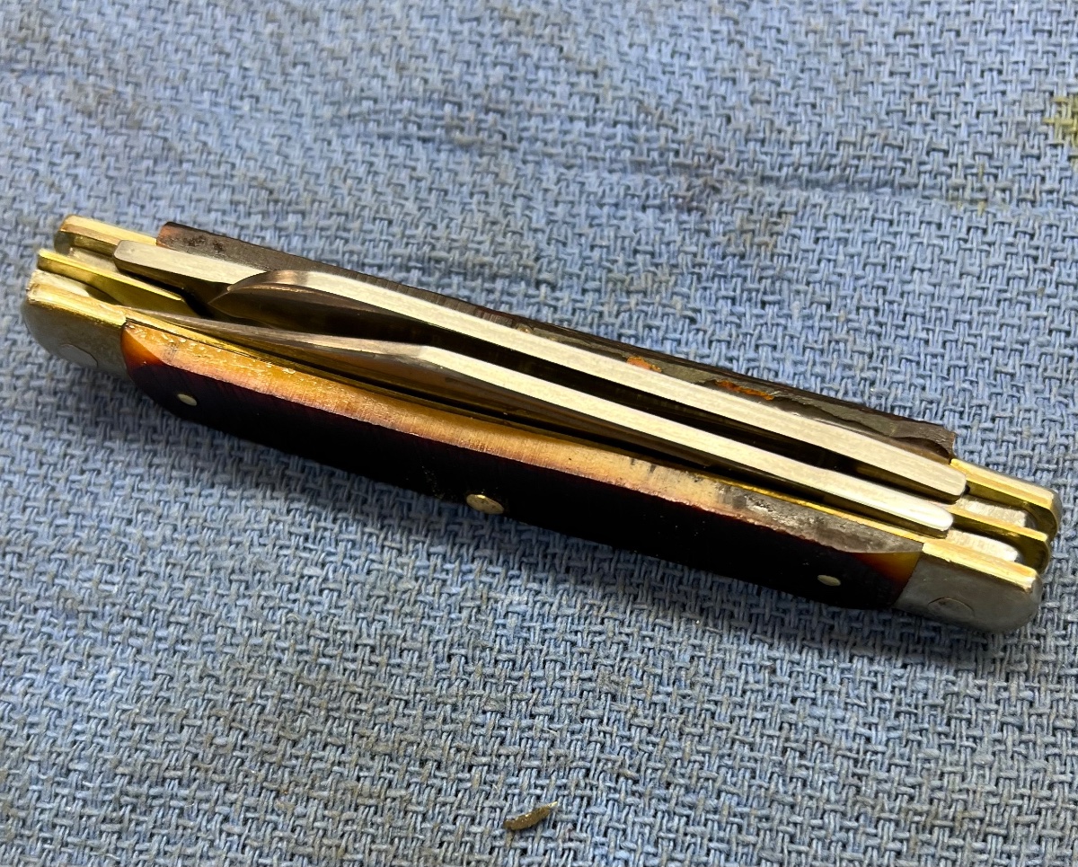

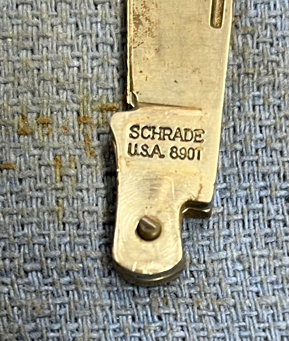

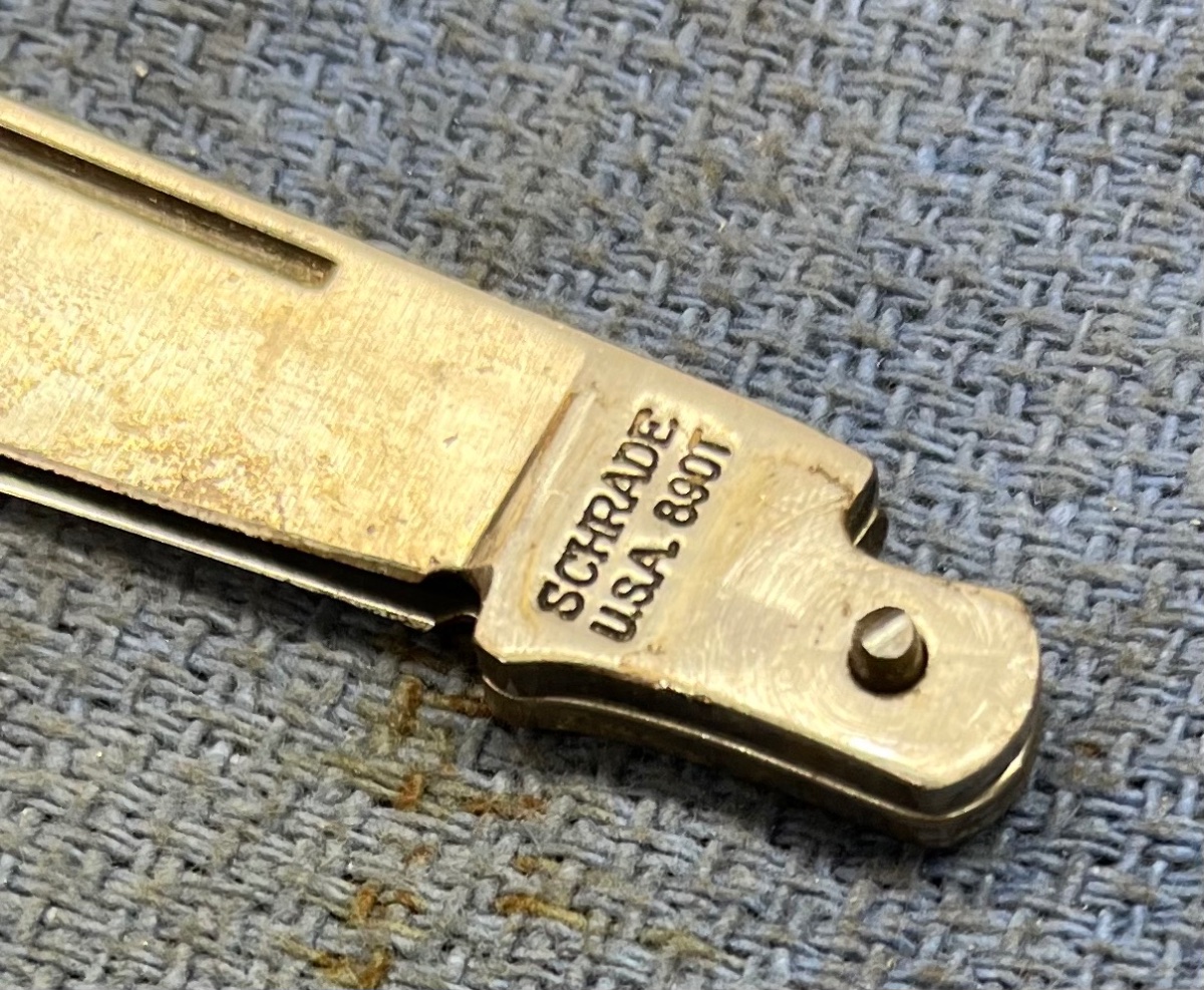

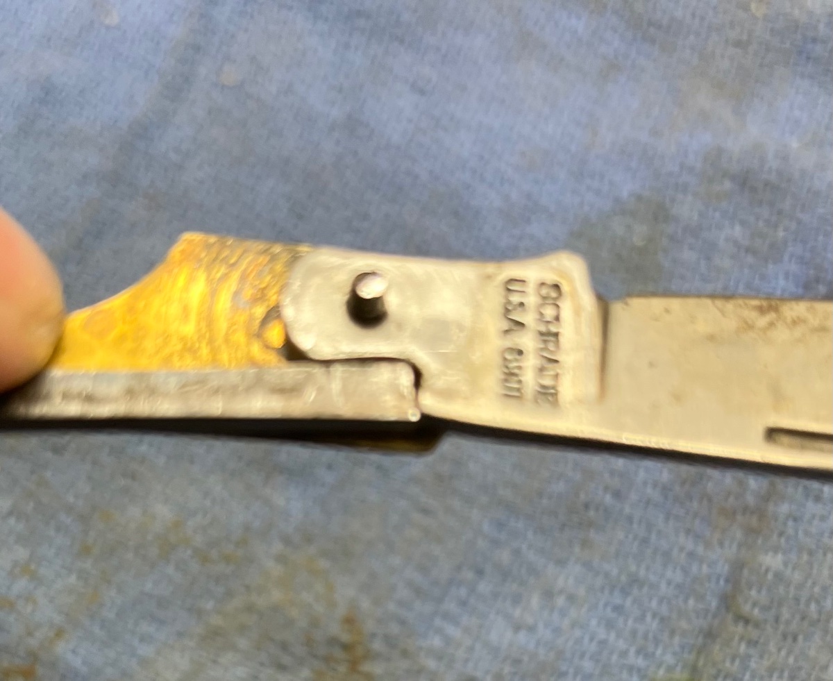

Yep.... Swinden construction..... which means you can't remove the main blade without cutting the Swinden pin.....

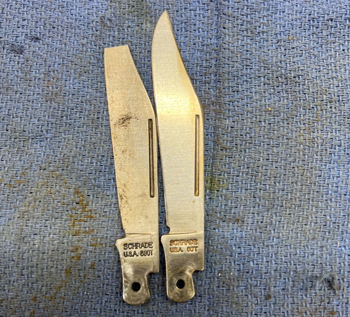

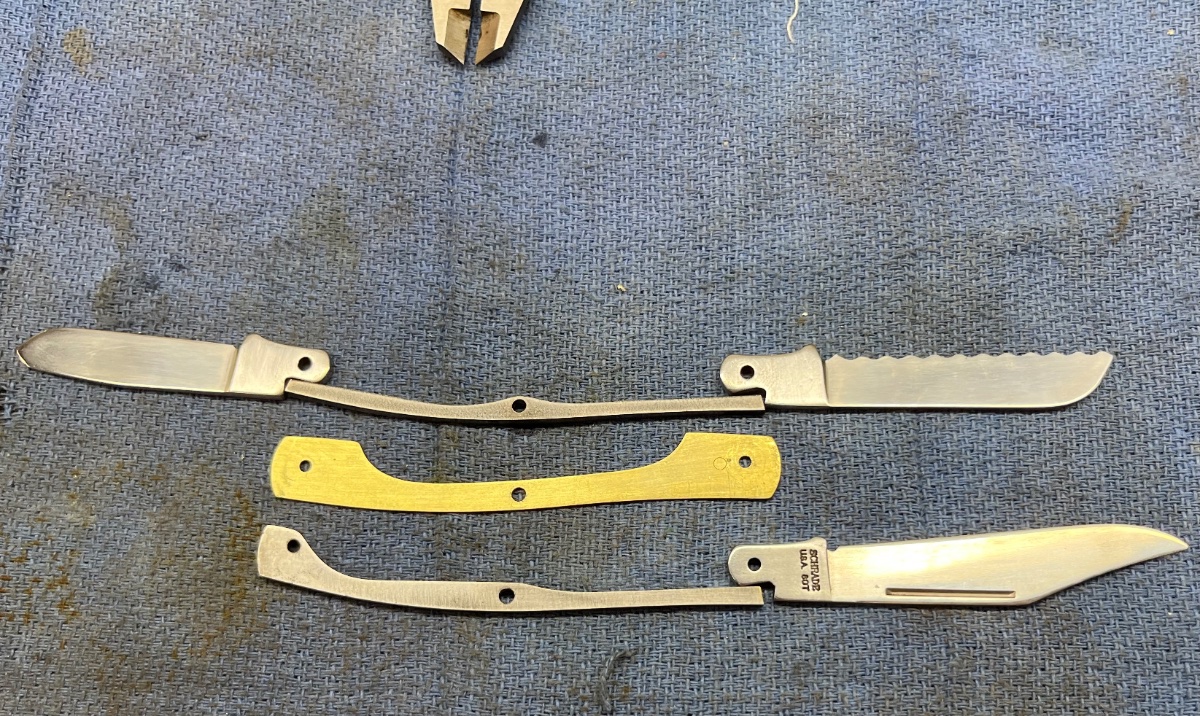

Here is the 89 OT blade compared to the 8OT blade......
(Sorry for the out of focus pic)..... Here is the 89OT blade compared to the 8OT blade in a basic mock-up with the old Swinden pin in place.
As things look..... I should be able to use the 8OT blade with a few minor adjustments for final fit.

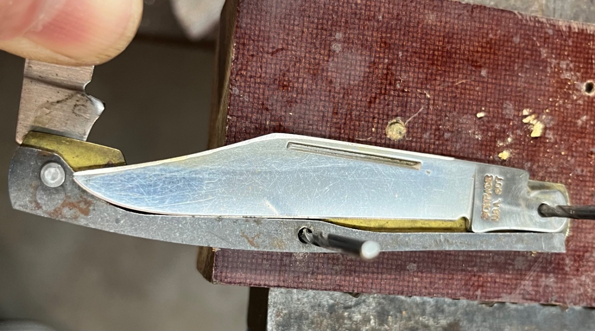

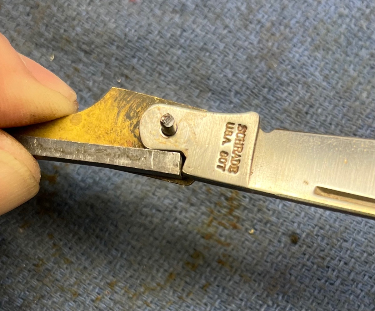

OK..... a quick mock-up shows the kick on the 8OT blade is a little shorter that the 89OT.
89OT in place....
Now.... the 8OT in place.....
The picture of the 8OT blade in place also reveals another possible problem. The blade tip on the 8OT blade might interfere with the spring (a good bit actually).
I know that the slack in the remaining Swinden pin might make this look worse than it really is BUT.... I can see a definite difference between the fit at the kick on the 89OT original blade and the 8OT blade that I want to sub in.

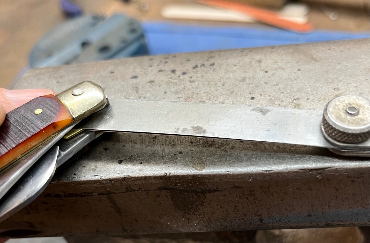

Here was my solution......
I have seen evidence of this done on older knives. I have seen where the kick was "stretched" and extended a bit by peening it. This sort of "mushrooms" the edge and extends it some. A few examples of this on older knives is very evident. It looked like some kicks were smashed in by a punch and leaving the shape of the end of the punch on the kick. I found it interesting that no attempt was made to hide or dress up this method of extending the kick.
SO..... I measured from the spine of the blade straight down to the kick. Then with some careful peening on both sides of the kick, I stretched the measurement out few thousandths. Then I carefully filed the edge flat for a good contact surface. The result was an extra 5 thousanths from the spine to the tip of the kick. After I got this new measurement established, I did a full mock up to check the clearance.
Here is the result, good clearances everywhere......
If you look at the kick you can see the area where I peened. It did change the thickness of the kick slightly since there is now a slight taper at the very edge where the kick meets the spring..... As you all know, it only takes a little change at the kick to get a lot of change at the tip of the blade. That was my intention by stretching out the metal just a little. Now I can sand the outer faces of the kick and get the shine back to the same as the rest of the tang.

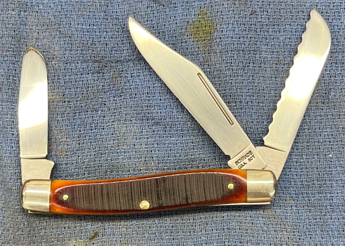

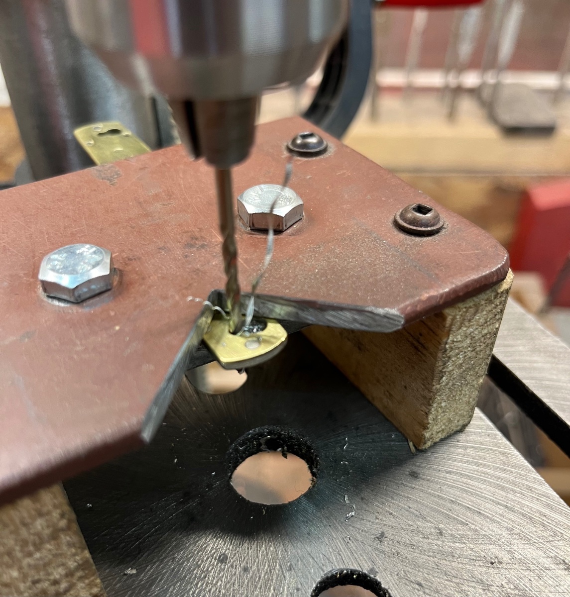

I did get a few things done yesterday afternoon. I cleaned up the blades and liners.

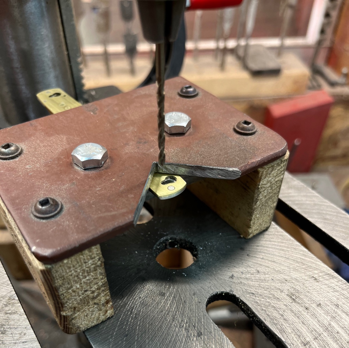

Then, I drilled my bolsters with the jig I made that was inspired by Muskratman. I love using this thing. It holds the bolsters square so you can drill the Swinden "keyhole" at the spot where the pin should be when I convert to pin construction.
Here is a shot of the blades. Getting the milling marks off the blades turned out to be a little more of a challenge than I expected. I hand sanded the blades all the way up to 2000 grit.
Next will be thinning out the bone to get a nice thin cover that will be the same thickness as the covers I removed.
More in a few days......
:D

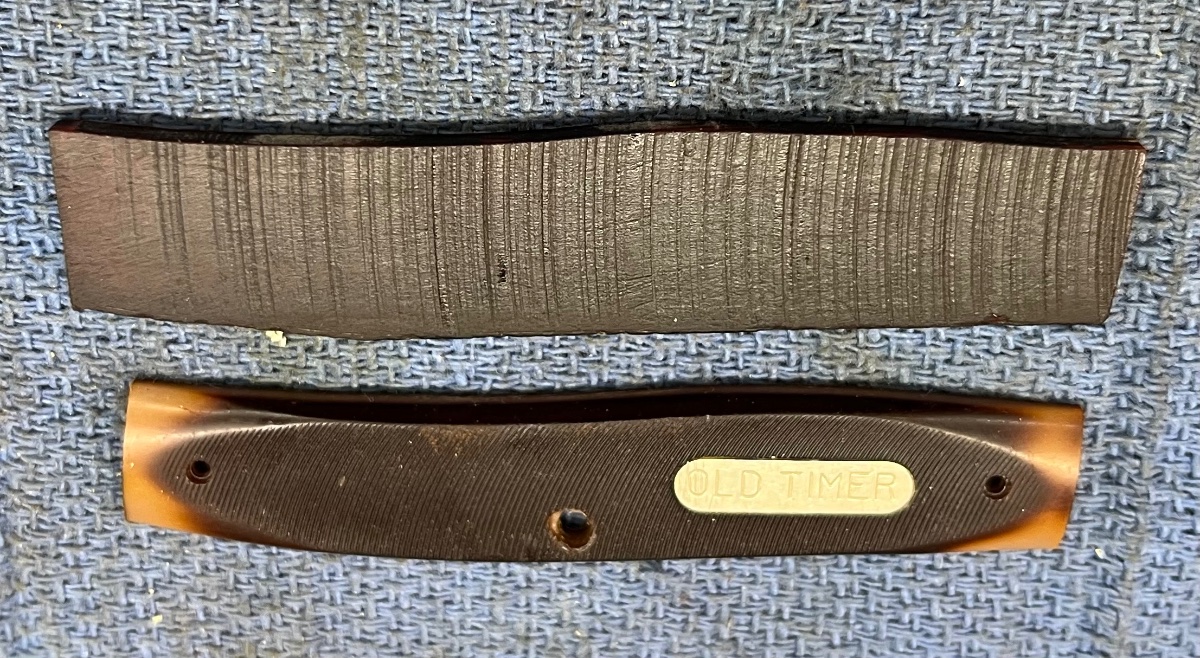

I didn't get the covers I put on last weekend to fit as well as I wanted so I figured I would go back to the drawing board.

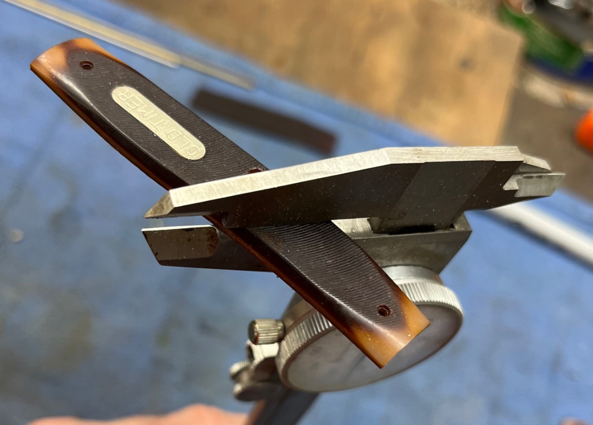

First, I scribed the shape of the cover onto a slab and used the band saw to cut out the rough shape.....

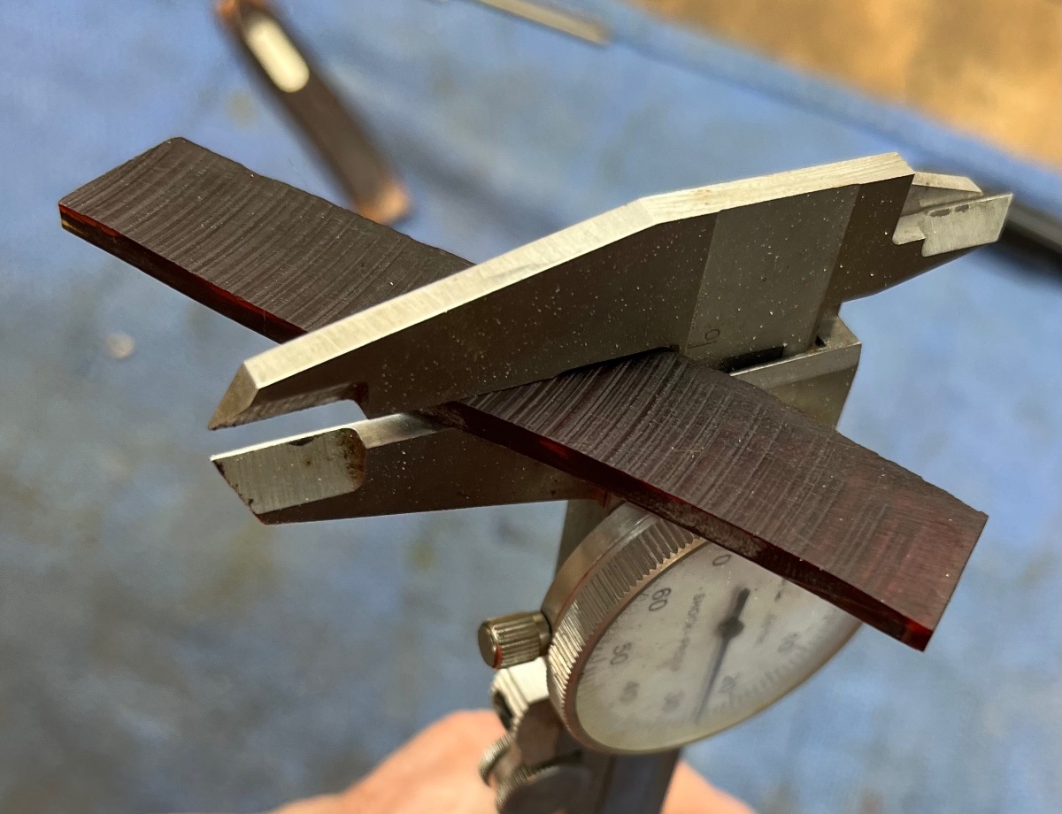

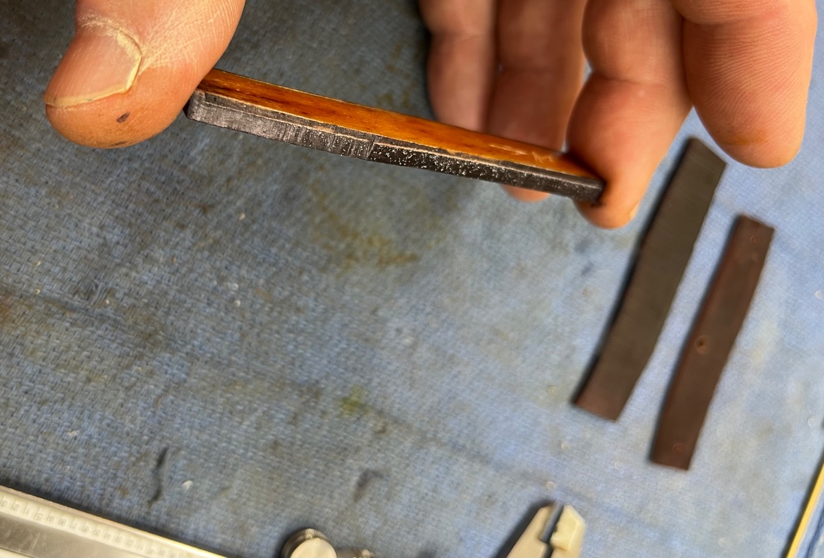

This time... I used a micrometer to check the thickness of the cover material.
I took the blank that I had cut to the basic shape of the original cover and scribed a line on the edge so I would have a sanding guide.....
Then, I took the cover blank and kept sanding until I got a blank that was the same thickness as the original cover.
After I got my thickness RIGHT THIS TIME....LOL.... I fitted the new cover to the liner, then glued it in place.
Now, after the glue dries, I can drill the cover pins and peen the covers onto the liners.

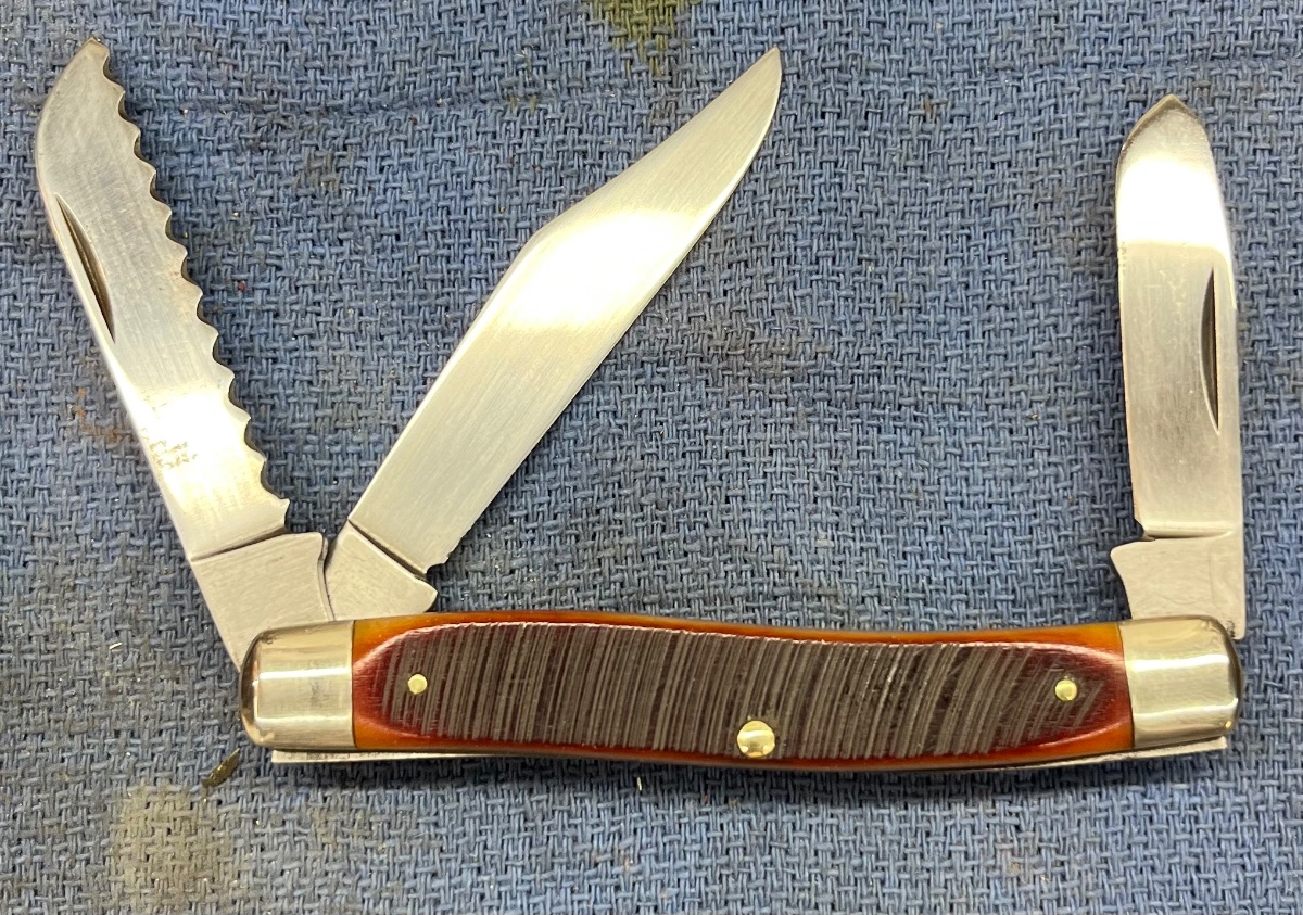

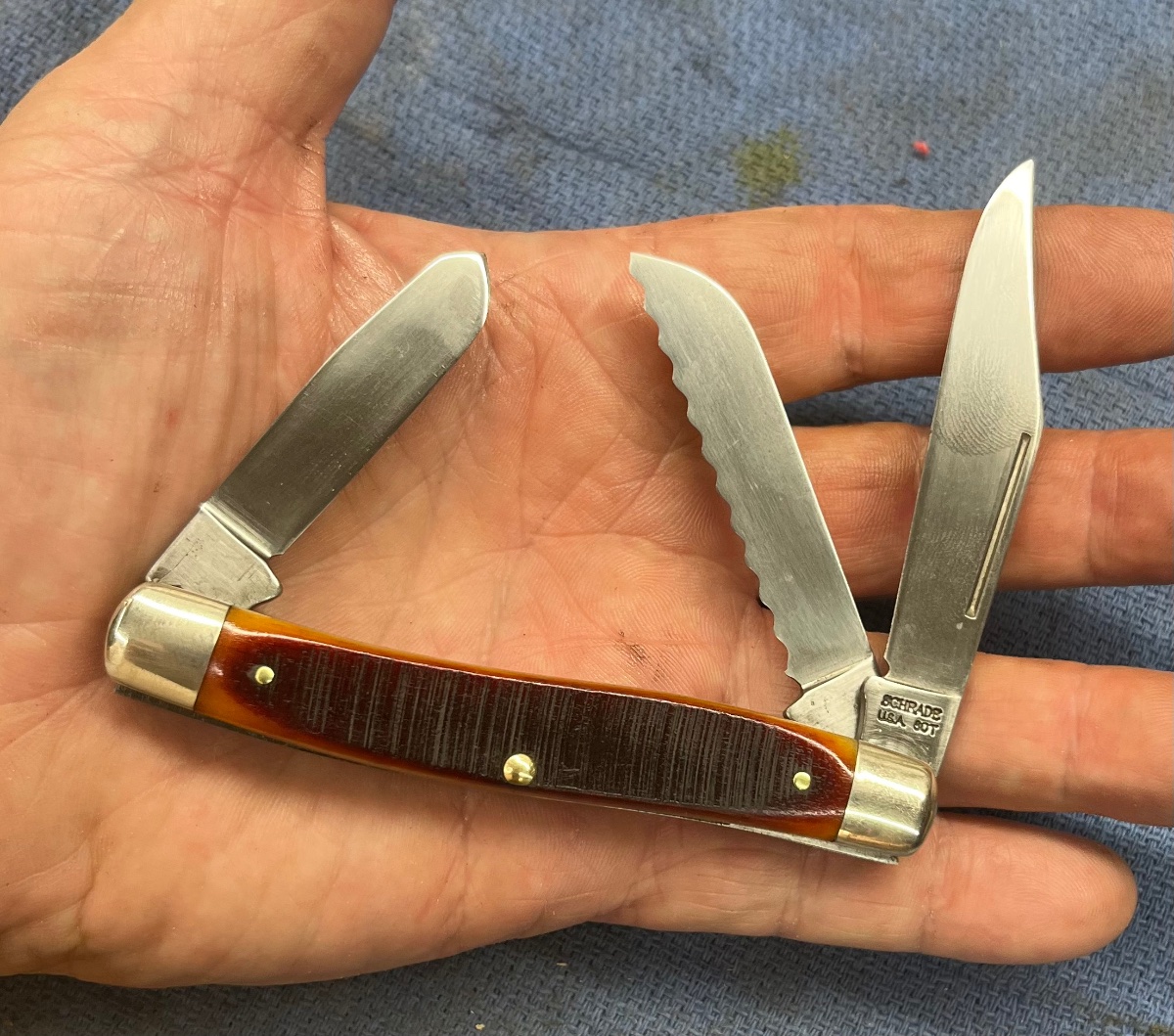

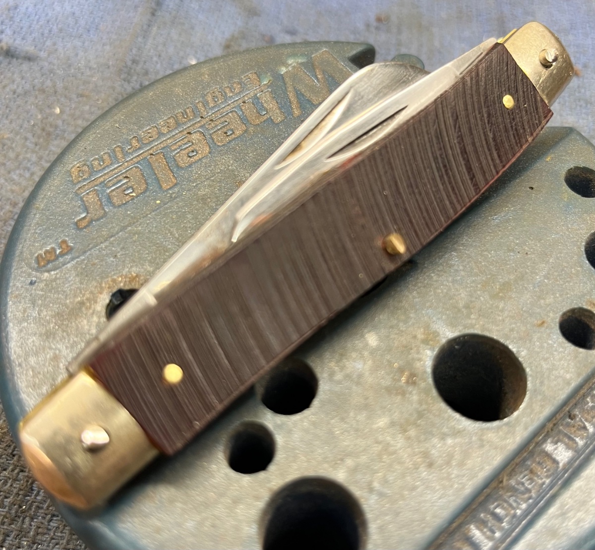

I actually got some time this afternoon to get out to my shop. Here is the final installment of this repair / mod.

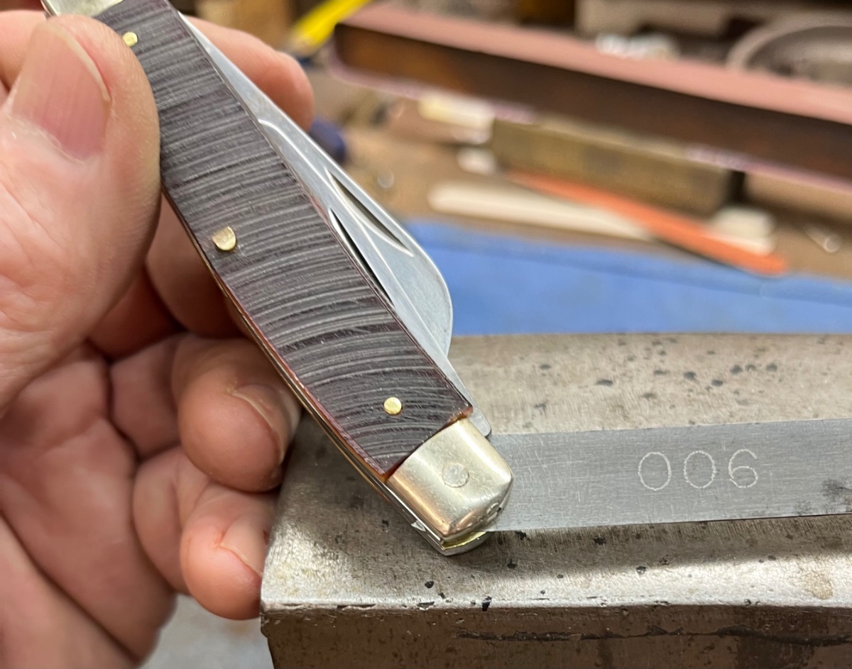

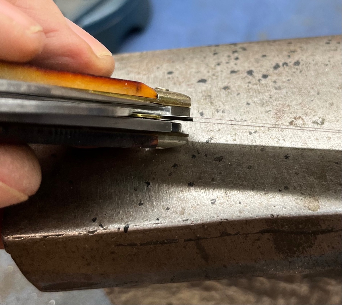

I got the pins in and cut off. Then comes the filing and peening of the pins.
It is very important to file the tops of the pins flat before peening....
I used 2 slackers before I started peening, one on either side of the center liner.......
Then I peened the bolster pins.....
Here she is with all the pins peened.....
Then came the final finishing and sanding.
Here is the final product.......
No more broken main blade. I guess this is an 8OT with that little bit extra!!!!
I hope this helps someone that wants to learn a little about folding knife repair. I ain't sayin' this is the right way or the only way..... This is just the way I do it. I hope y'all enjoyed the process.
:D
