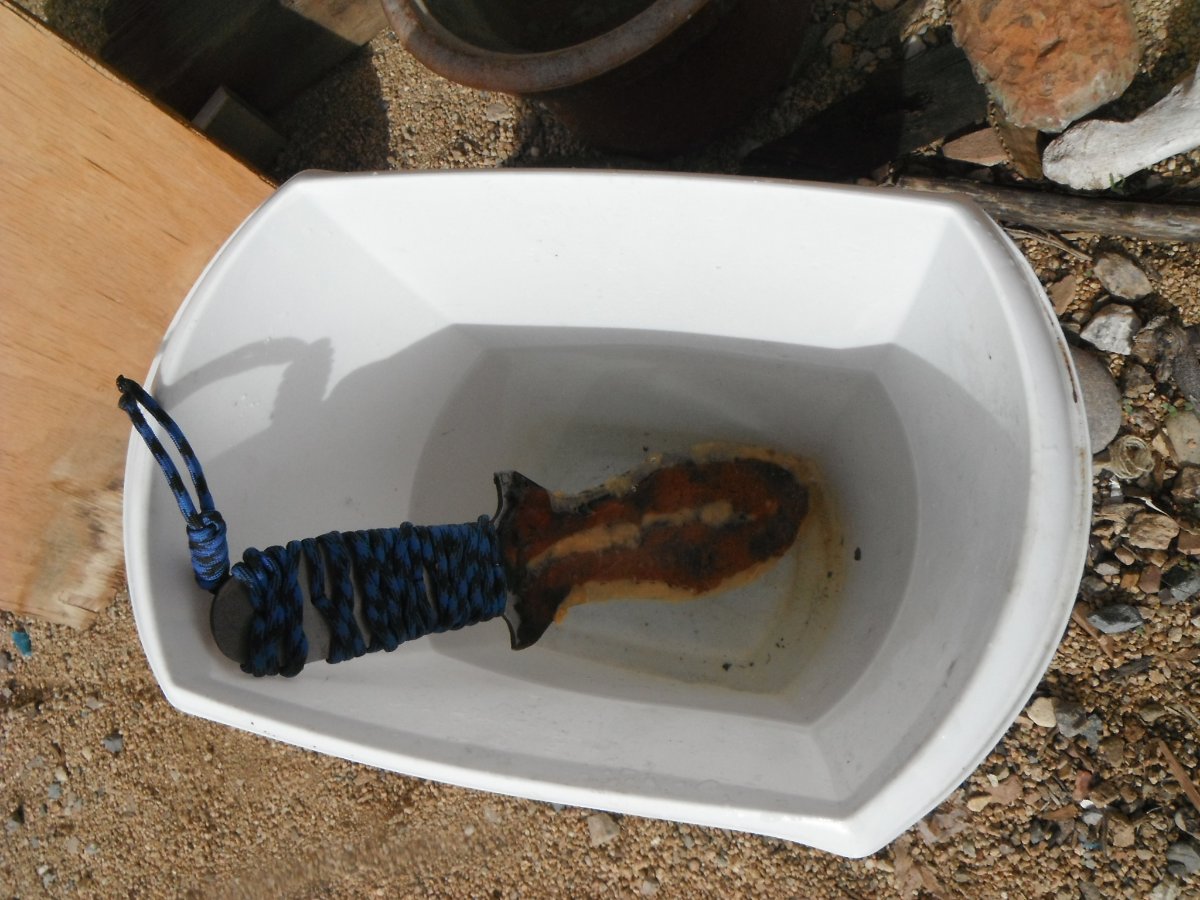

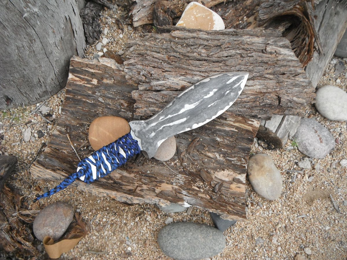

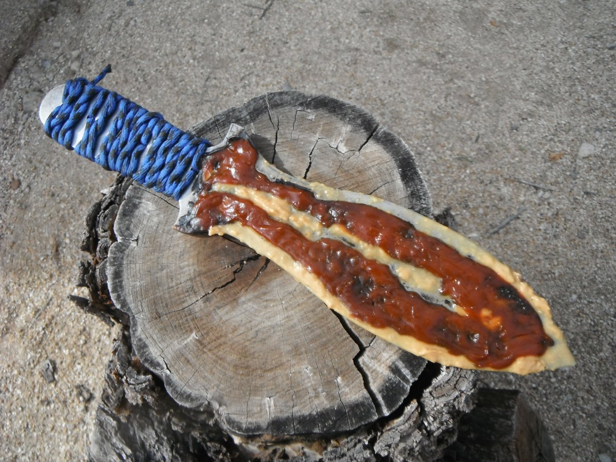

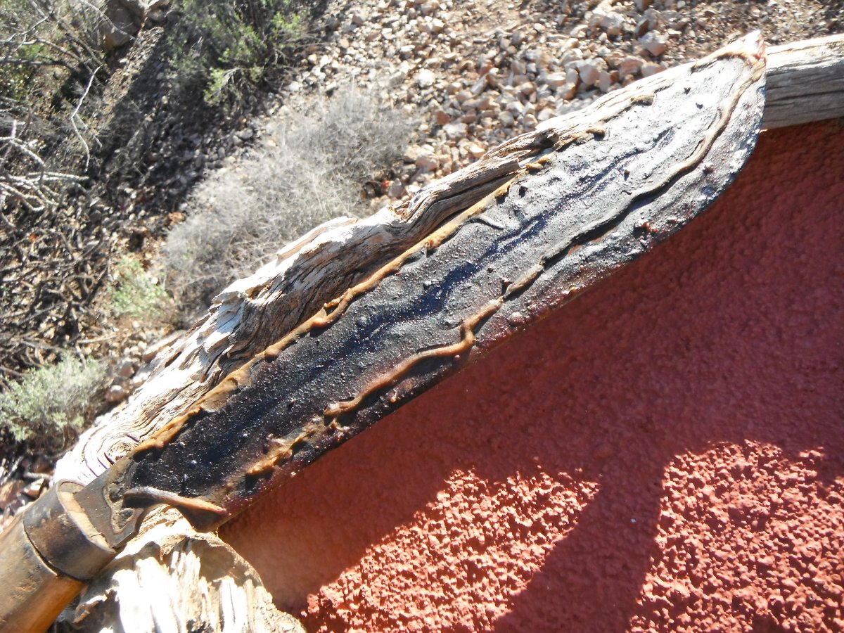

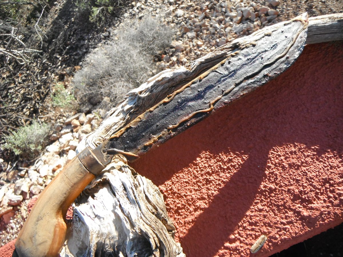

Experiments in Patinas.... Hienz 57, Spicy Mustard, White vinegar .... etc...etc...

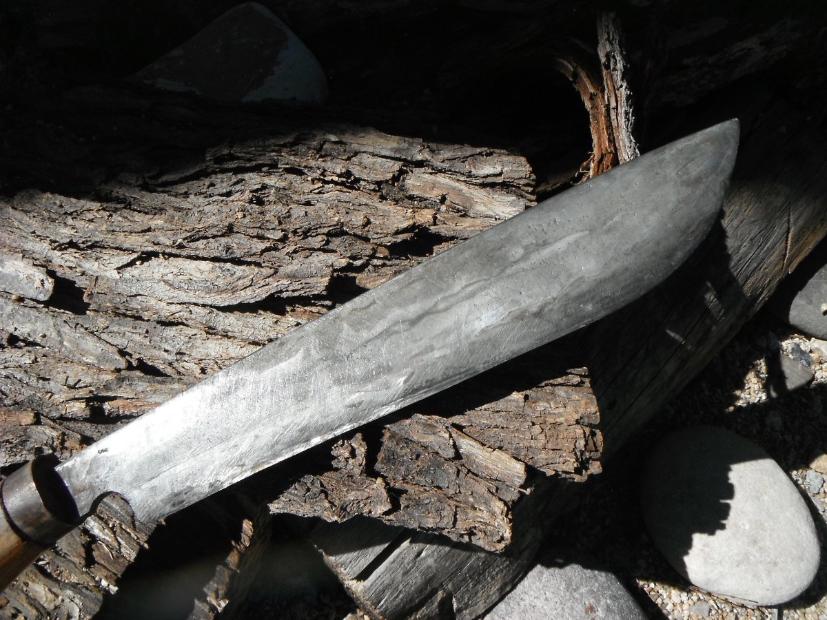

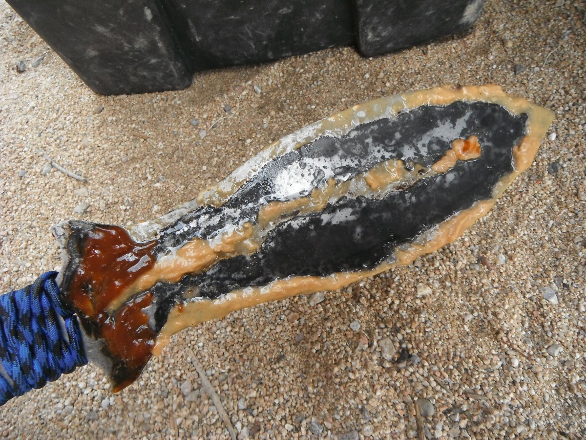

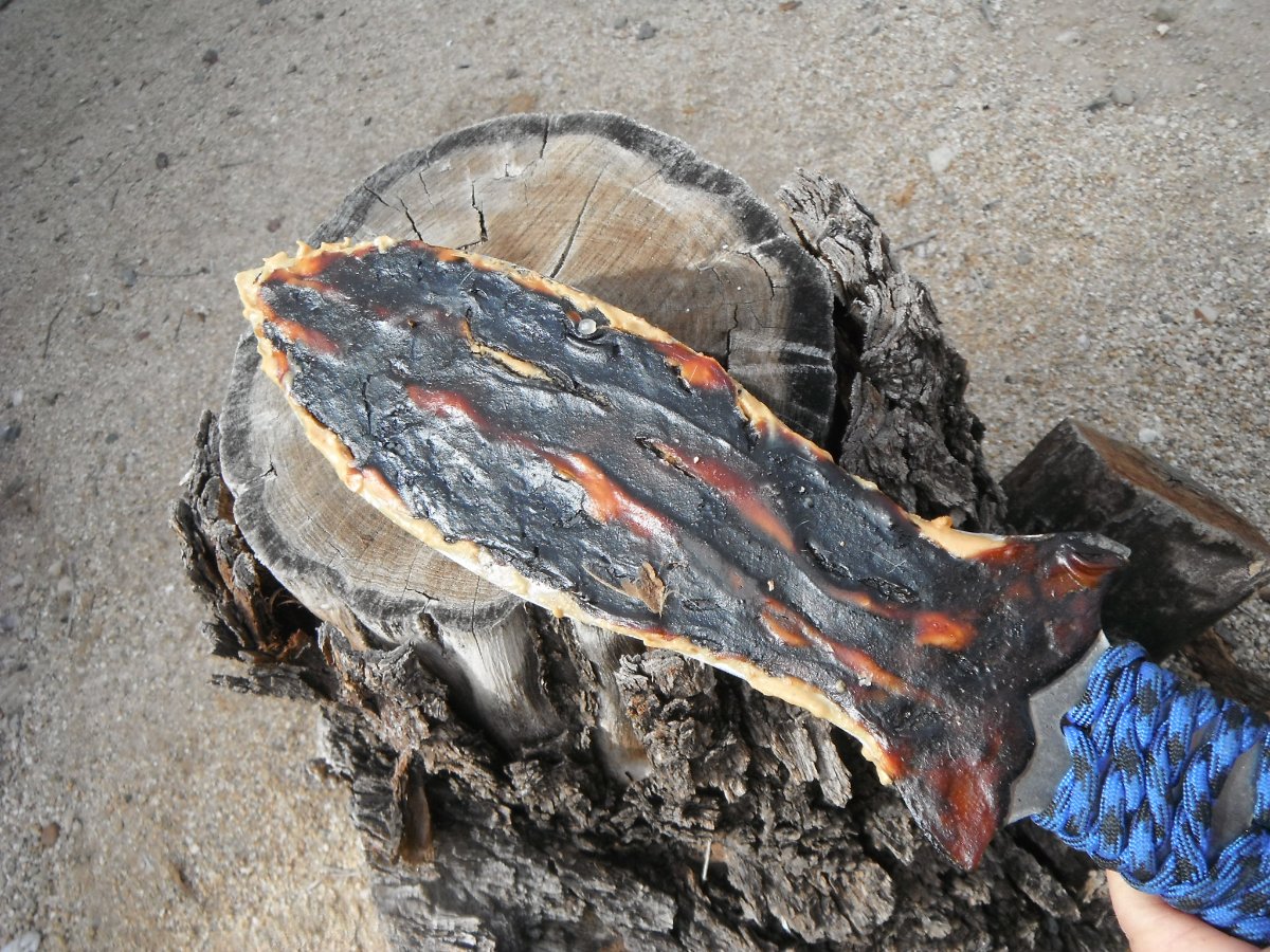

And more; Experiments in Patinas.... PeanutButter, Lemon juice, Hienz 57, Spicy Mustard, White vinegar .... etc...etc...

Re: Experiments in Patinas....
The experiments are great but with no labels on the photos or interpretations of the results I'm lost. How long was the blade exposed? Was the blade cleaned between exposures or am I seeing cumulative effects? What worked best in your opinion? What hardly worked at all? Was anything too aggressive and caused pitting? Some explanation and analysis is needed.

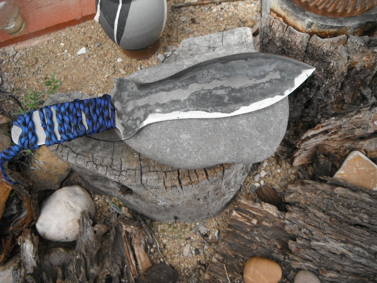

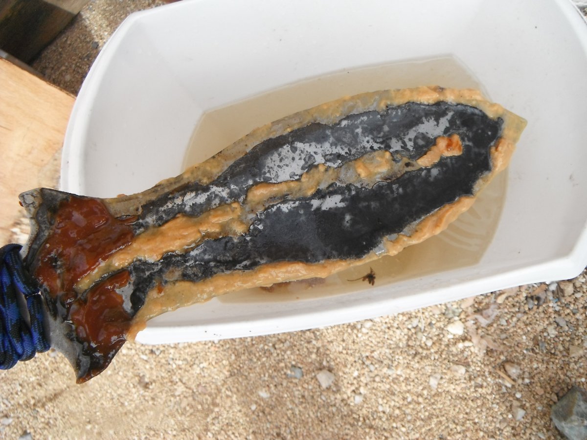

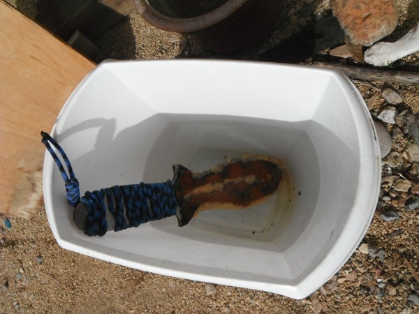

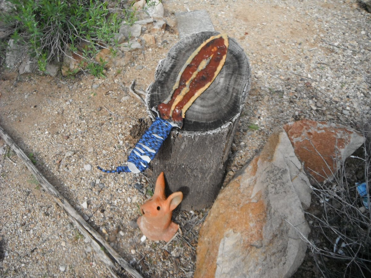

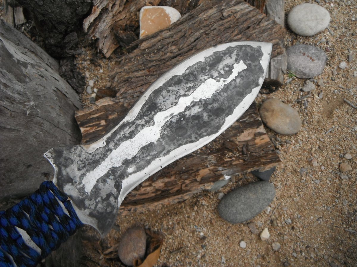

deo-pa wrote: ↑Mon Apr 01, 2024 12:03 pm The experiments are great but with no labels on the photos or interpretations of the results I'm lost. How long was the blade exposed? Was the blade cleaned between exposures or am I seeing cumulative effects? What worked best in your opinion? What hardly worked at all? Was anything too aggressive and caused pitting? Some explanation and analysis is needed.
Dennis
I found that to make a pattern I needed to put peanut butter where I did not want a reaction with the metal. So, to make wavy lines I would apply peanut butter on the blade edges and down the center. the peanut butter also holds the Mustard/acid on the blade and keeps it from running off. I then mix some white vinegar with mustard or ketchup and apply it to the bare metal. Just white vinegar alone seemed too aggressive and sometimes has darkened the metal more than I wanted, as did leaving the mixture on too long. I have not had a problem with any pitting so far.
I let it sit all day and overnight and that turned out to make too dark a stain for what I wanted. At that point I did clean the blade on a wire wheel to take off some of the dark patina. I think 2-4 hours might have been better. Where the metal was untouched on the double-edged dagger (by being covered with the peanut butter), I wanted to add some color, so I applied a paper towel soaked in lemon juice and left it on the metal for about an hour, to give it a lighter patina. It also left a sort of spotted pattern you can see in the pictures.
The main point I learned is that different mixes of staining liquids combined with different amounts of time the metal is exposed with the acids, make a more colorful patina, which is what I was trying to achieve... a mixture of light and dark patinas.

I like the effect of the wavy lines upon the blades. It is sort of a faux damascus!

I see as the "poor man's Damascus" ....

Good to read the experiments and results. I appreciate the info and pics and I like your results. Great stuff. I have used mustard and lemon juice for a base coat. It starts protecting the steel immediately and starts the coloration. I like it. Good post.

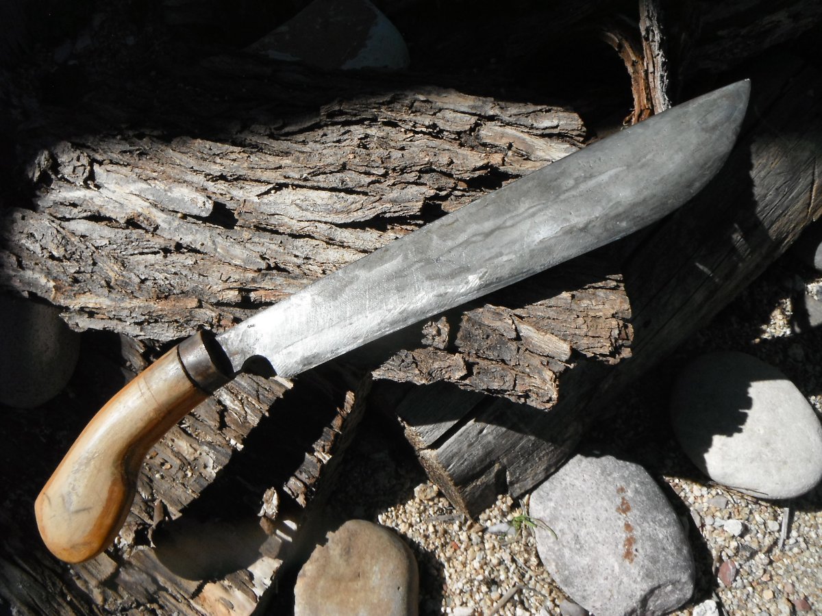

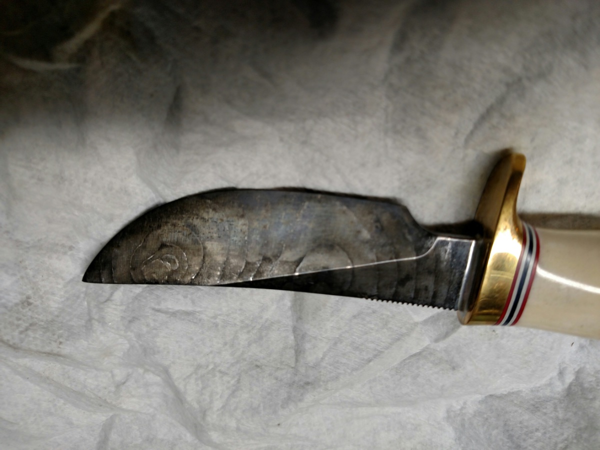

I like sticking small blades into large onions. Leave in a day or 2. This onion had a double center. It gives you the same pattern on both sides. Giving the allusion it goes all the way through

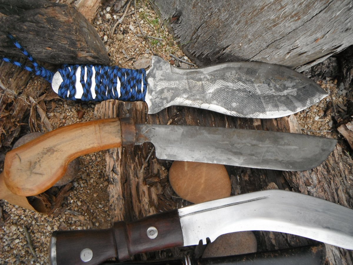

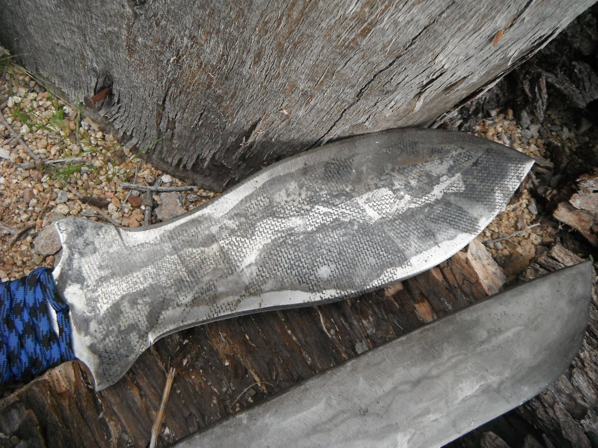

I found out that soaking a paper towel with a texture to it in lemon juice will produce that "mesh" pattern you can see on the dagger's blade. That was the second application of an acid, after the ketchup and vinegar was applied and removed.

That turned out nice!

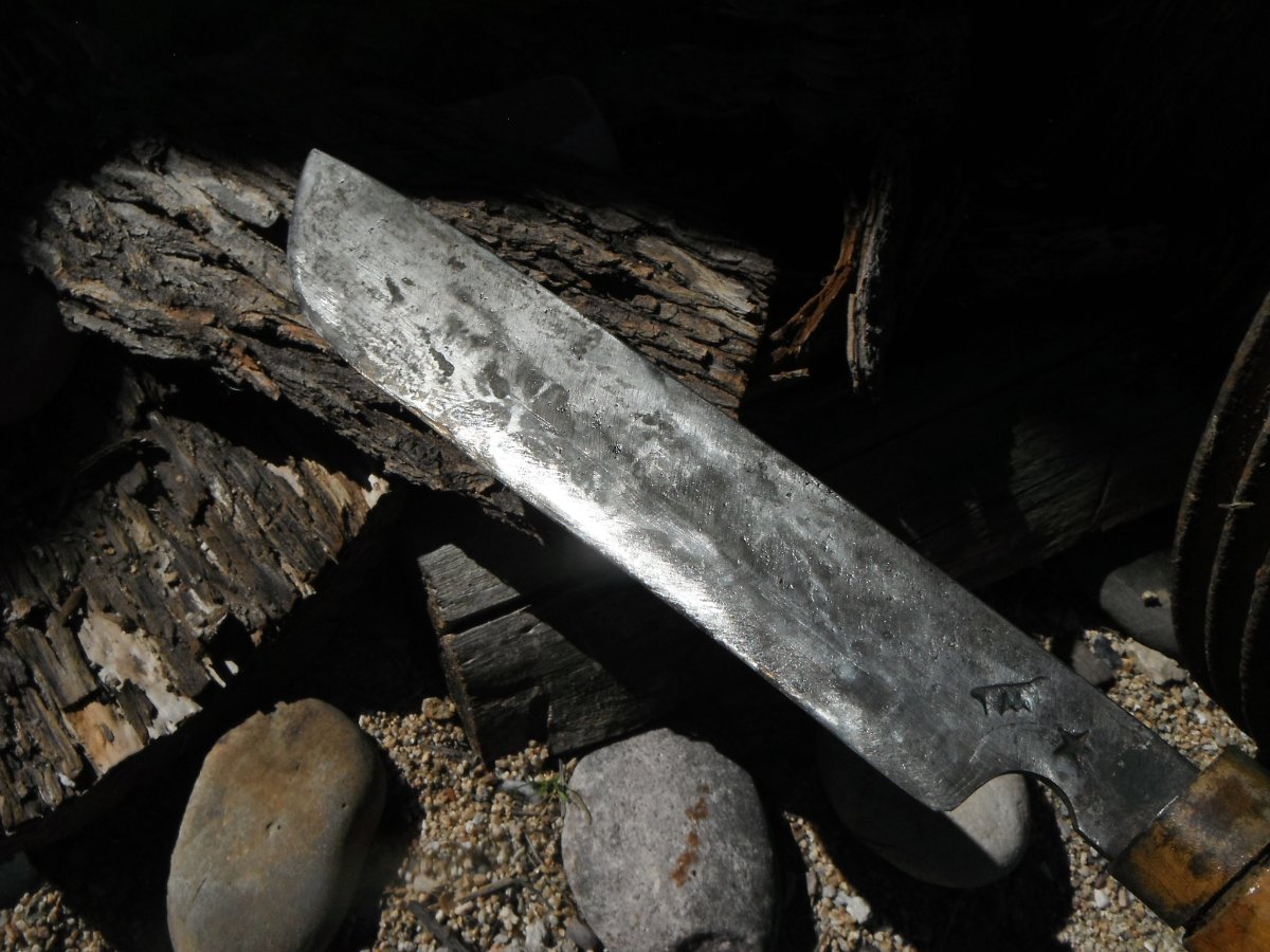

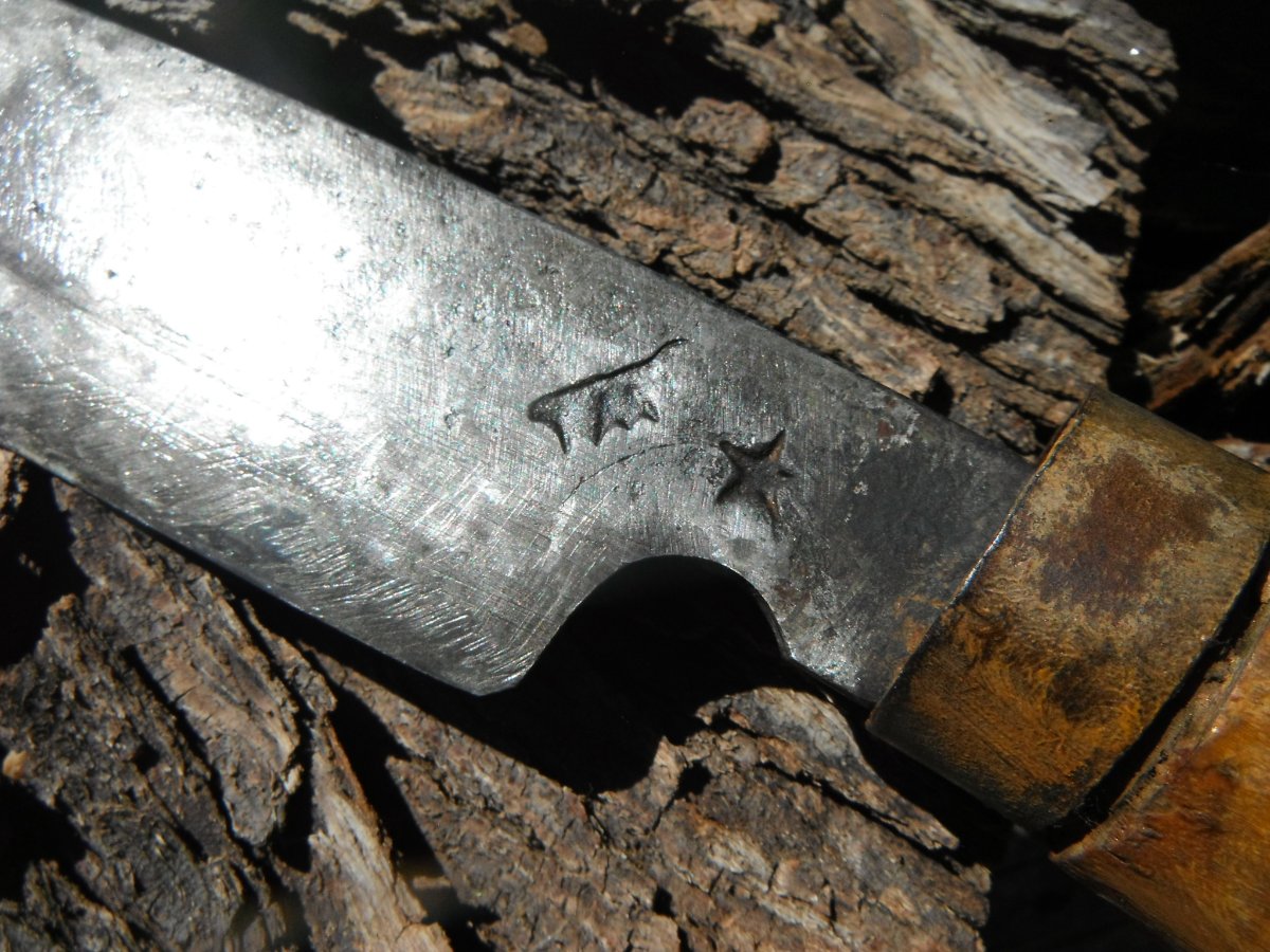

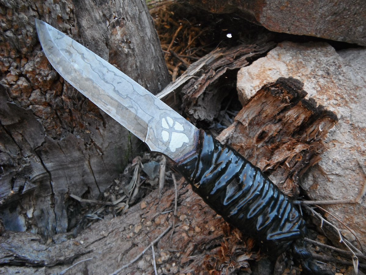

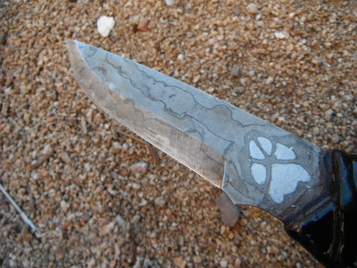

This was my first patina experiment. I used white vinegar as the acid and nail polish to block the areas I wanted unblemished. The paw was a cut-out of a tracing of my dog's footprint and then reduced in size on a copy machine. It was then copied onto copy on a paper with a sticky backing, then cutout and stuck to the blade to prevent the vinegar from reacting with the metal. So, after all that, I ended up with a very crisp outline of my dog's paw on the knife blade.
That came out nice! I like the paw.
