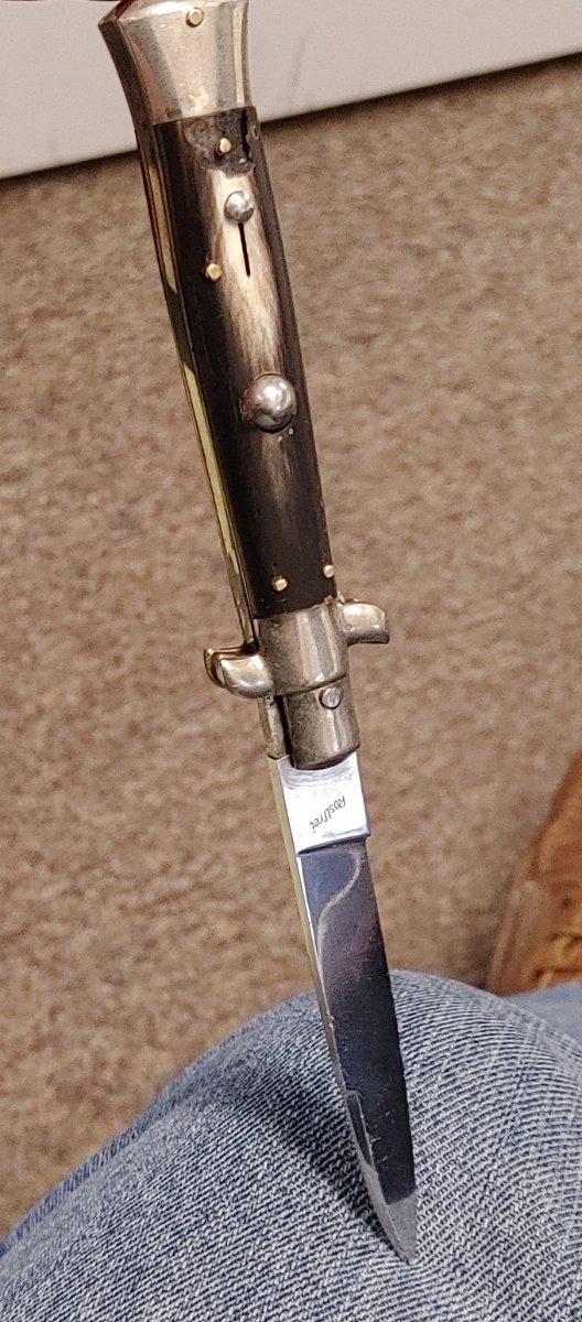

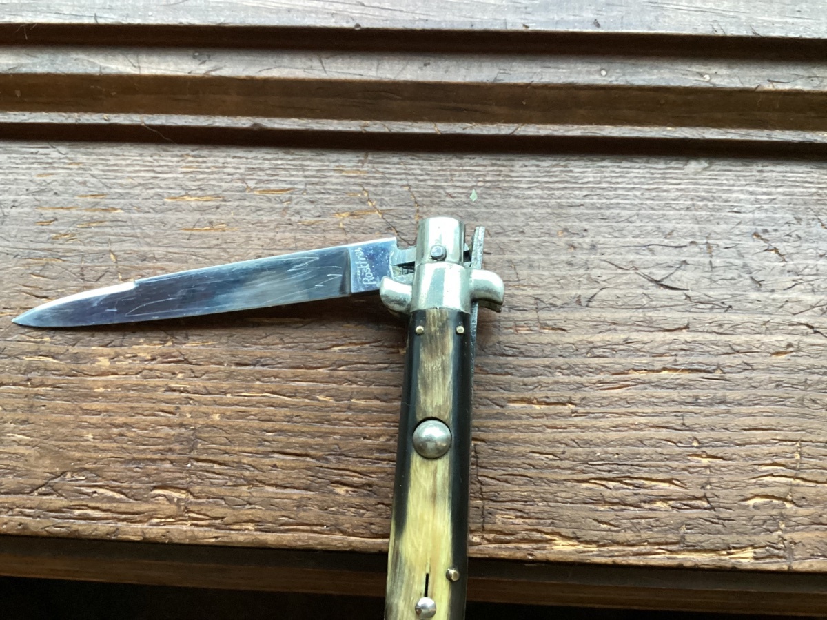

I have this recent find, the button close mechanism won't retain the blade. Its in nice shape overall despite the bug bite, the pin is very stable at that location.

Doesnt keep it open either, I can fold it closed without pushing the button in

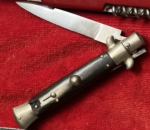

wiseguy wrote: Wed Feb 07, 2024 4:05 am If you rotate the blade closed, can you see the lock slot on the butt of the blade-tang ? If so, are the edges crisp ? Or chipped out/worn
I can try for better photos at home, here is a listing photo

That’s why I asked about the back spring. Is it strong enough to hold the tang down? Maybe ya got more than one prob.
