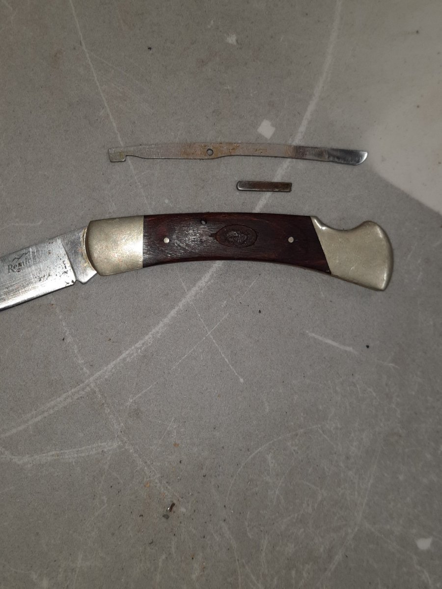

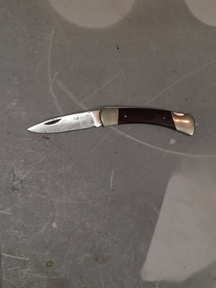

Hello,
I have a large chinese-made Remington 700 series lockback (looks like a Buck 110) that I inherited from my cousin when he passed. The spring on the knife is broken so the knife will not lock open or stay closed. I was able to remove the pin that the lock bar pivots on and shake out the broken piece of spring metal, however, I can't seem to locate the pin(s) that hold the two slabs together so I can remove the rest of the lock spring. Can anyone out there help with how I would locate the pins so I can completely disassemble the knife. I would also appreciate any advice on how to make and fit a new spring. Any help will be appreciated. I have attached some pictures so you can see my dilemma.

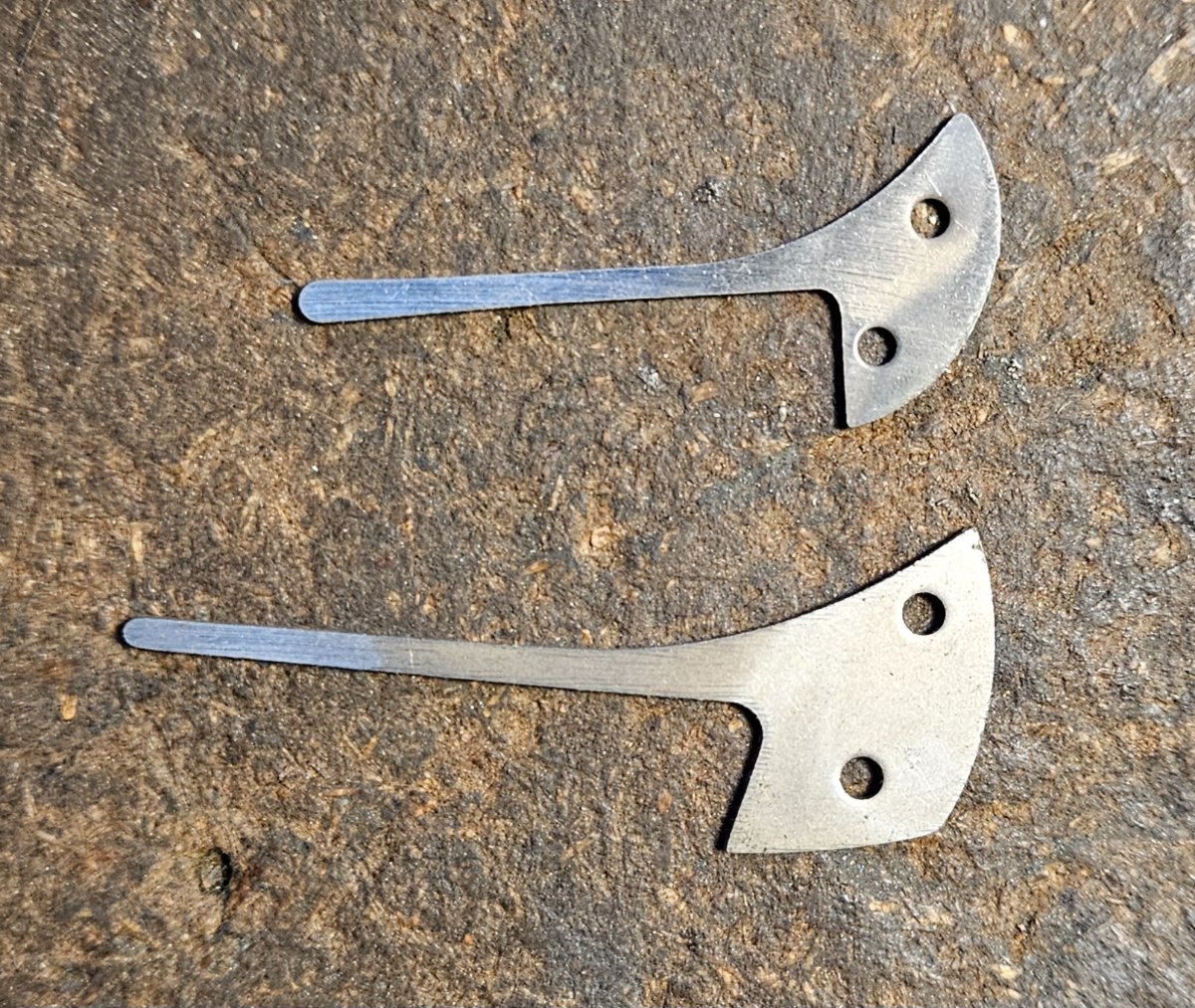

From the looks of it I think the spring in that knife is integral with the butt piece, like this;
You'd need to find a donor knife with the same spring as your knife as you'd have to replace that whole unit.

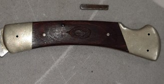

My $.02 - the pins are probably oriented as ea42 says but are blended in by sanding and polishing.
They should be somewhere like the image below, though not those exact locations.
You may be able to scuff up one side gently to see if you can make them appear. They're peened over so you may need to do a bit of grinding to get them to budge.

Thank you Glennbad and Bill, but I'm pretty sure that Eric is correct. When I removed the lock bar and took out the broken piece of spring I could not see any evidence of a pocket on the remaining piece of spring (I am calling it the spring base). Also, the piece of spring that I removed was rectangular in cross-section, not round like a typical spring rod. I could see the remaining piece inside the knife, but could not see any evidence of a pocket. Based on this observation I was assuming that the spring was some kind of 1 piece design. The pictures that Eric has provided seem to confirm what I was thinking. My plan was then to completely disassemble the knife and, since I would have both pieces of the spring, use them as a pattern to make a new spring. Failing that, I was going to machine a pocket into the spring base, re-install it, and insert a piece of spring steel (ala buck 110) as the new main spring. However, upon close examination I could not find any evidence of the brass pins used to hold the two slabs together. Is there some way to chemically treat the bolsters to expose the pins?
