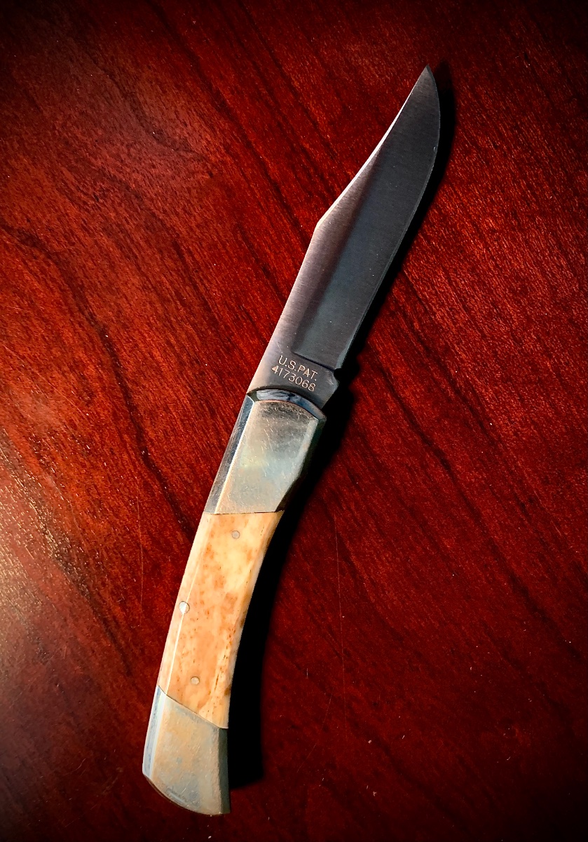

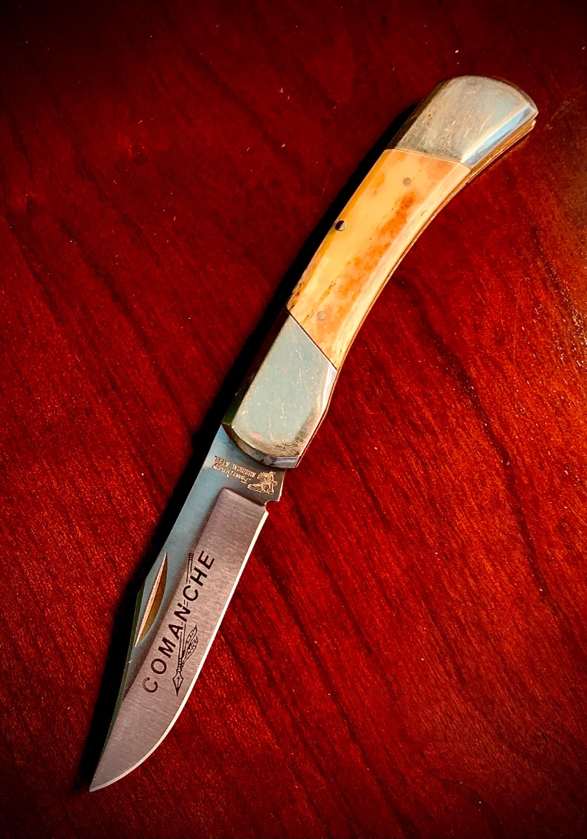

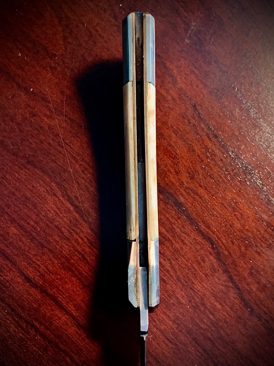

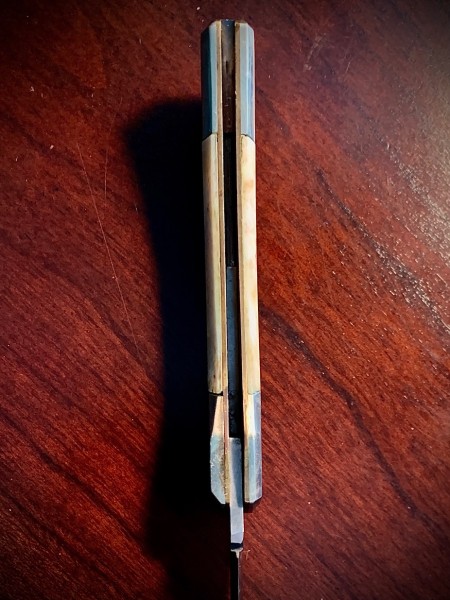

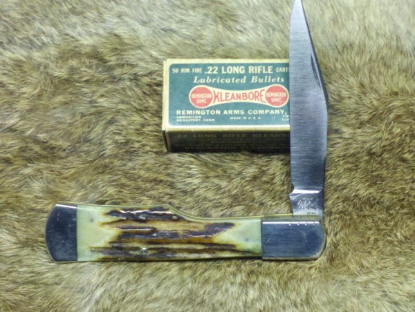

I am a newbie to knife collecting particularly to folders. I know I’m displaying my ignorance here, but I have acquired a Frost Cutlery Comanche that I could open, but cannot close. I know it is a bolster lock knife, but no matter how I push on this knife I cannot get it to close. I have been Uber careful when manipulating it but I cannot get it to budge. Any suggestions for the new guy? - pictures are attached.

Welcome to the forum. I sympathize with your problem. I had two knives with bolster locks in a collection of 470 knives I bought 9 years ago. Nearly sliced my thumb trying to get that thing closed. I think that is the fatal flaw of that design. You have to put a LOT of pressure on that bolster to get it to move and that can be dangerous giving how close it is to the cutting edge. All I can tell you is that you need to keep pushing in what ever direction that bolster will move and you will probably need to push on the blade to move it from the locked position. I would use the edge of a table to get that movement started once I got the bolster to move a little. It doesn’t move much to get it to unlock so a little movement is all it needs and that is why pushing on the blade with the table edge worked for me. I haven’t seen the video on this so there might be an easier way. The difficulty of closing that is why I sold mine and never bought another one. I wish you well.Bad Primer wrote: ↑Wed Dec 20, 2023 6:33 pm I am a newbie to knife collecting particularly to folders. I know I’m displaying my ignorance here, but I have acquired a Frost Cutlery Comanche that I could open, but cannot close. I know it is a bolster lock knife, but no matter how I push on this knife I cannot get it to close. I have been Uber careful when manipulating it but I cannot get it to budge. Any suggestions for the new guy? - pictures are attached.

...nobody has suggested penetrating oil ? I didn't get the sense that it had been tried yet, but that would be my 1st goto on the bolster hinge point.

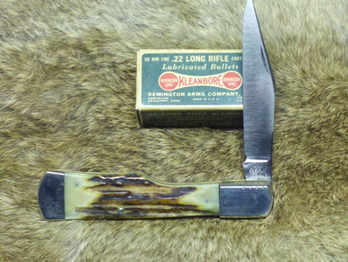

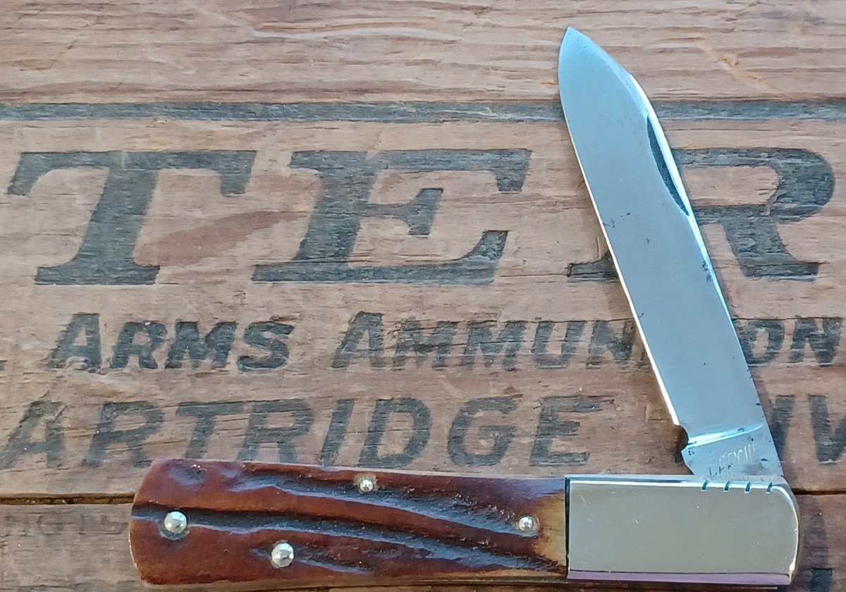

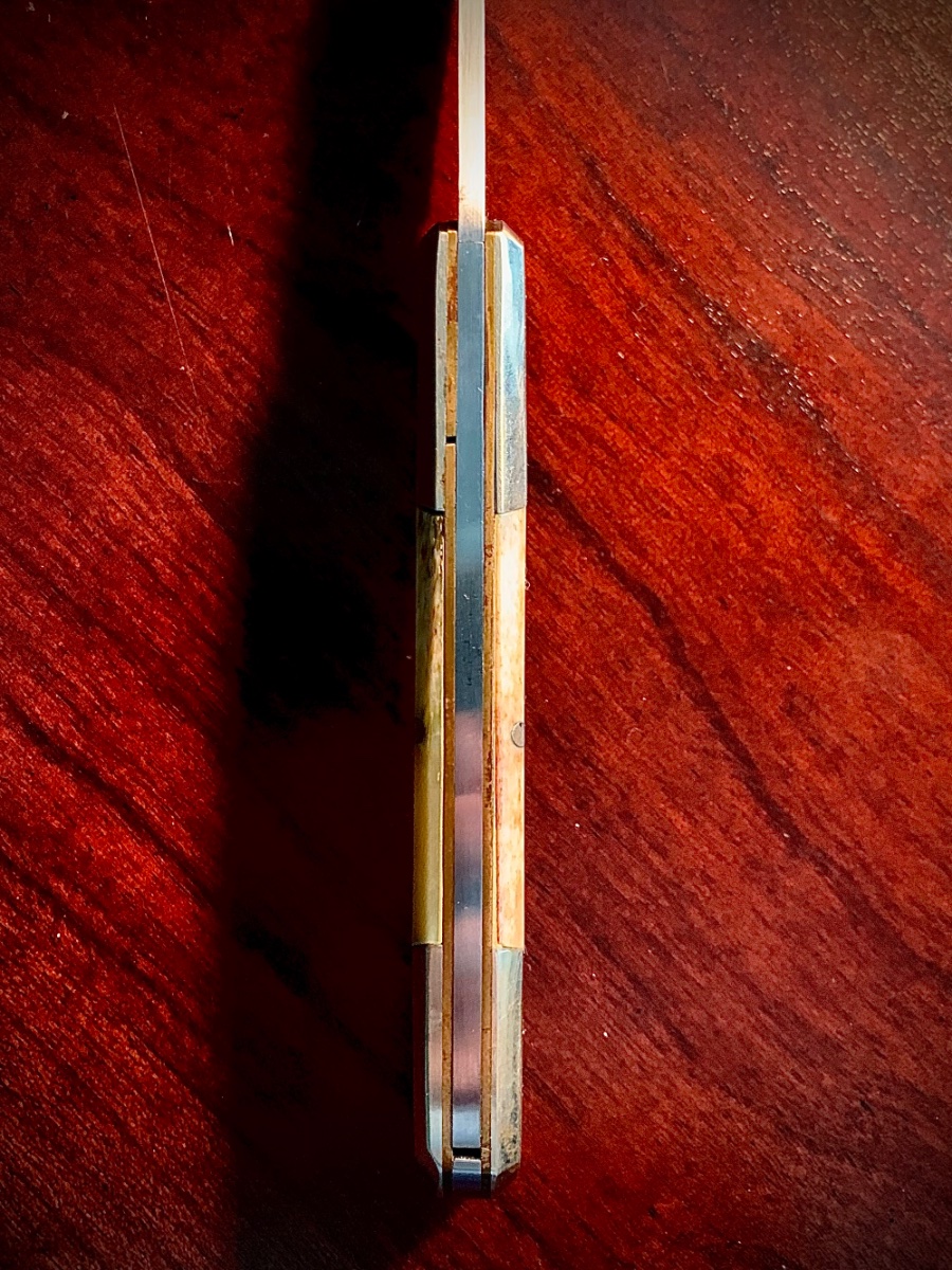

I have not read all the responses so if I am repeating what has already been said, I apologize. That is the Cargill bolster lock mechanism. I have collected Cargills for several years and have many of the bolster lock knives. The best advice I can give is that when you are pressing down on the bolster make sure you are not also pressing down on the liner. The liner does not move. Roll your thumb across the top of the bolster while pressing down and you should be just fine. That is assuming it is properly lubricated. Here is a bit of info regarding the Frost/Cargill bolster lock and a pic of an original cargill with the bolster lock.
