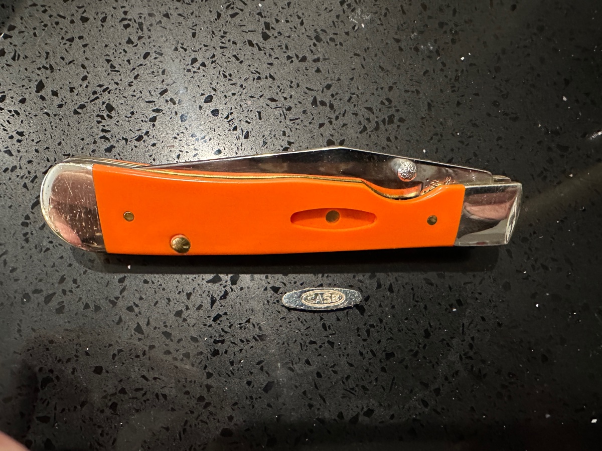

I dropped my Case Trapper Kickstart G10 and the badge popped out. Is there anything I need to consider before glueing it back in? Is there a particular glue I should use?

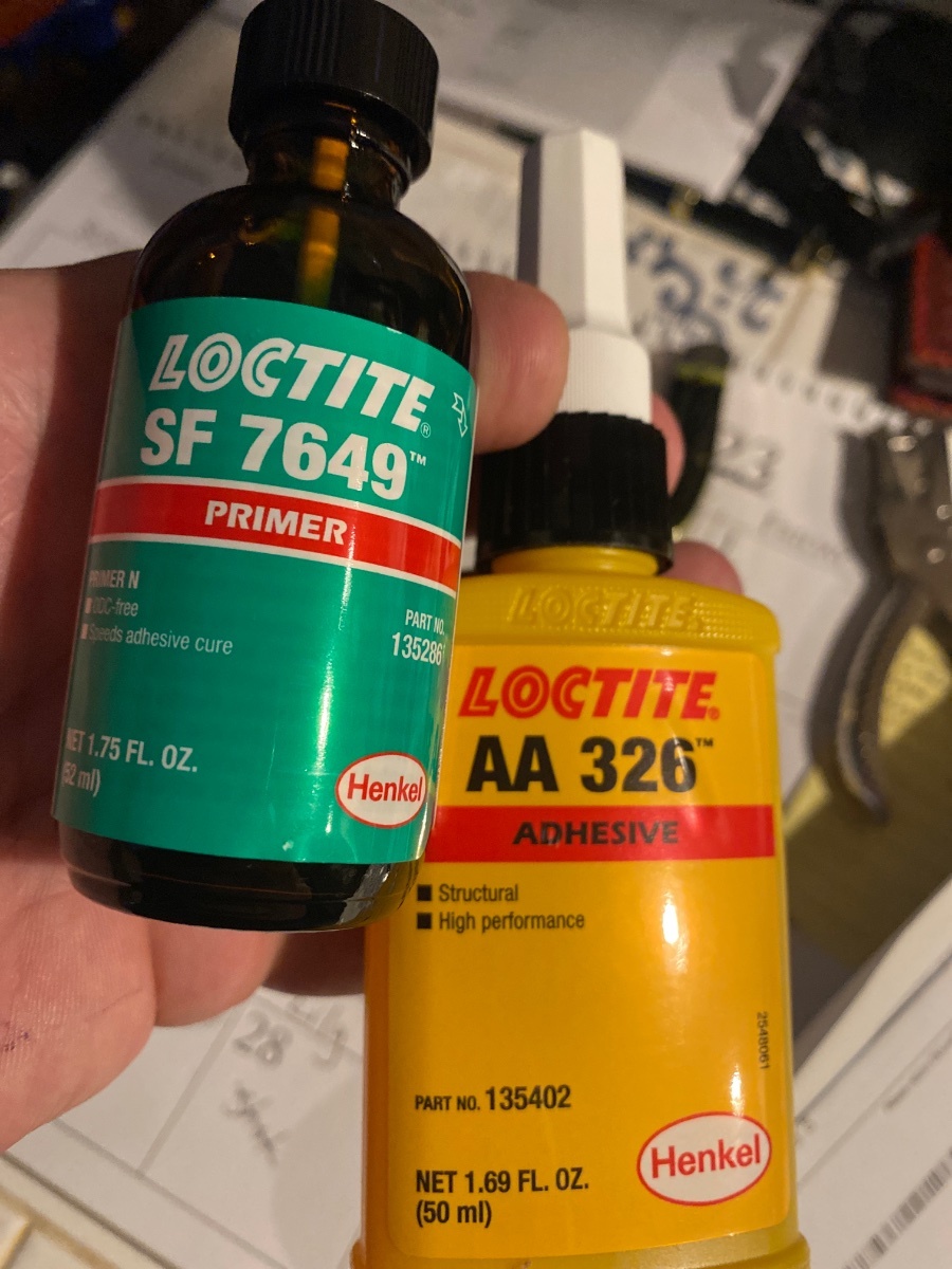

- XX Case XX
- Posts: 3623
- Location: California
Re: Case Knife badge popped out

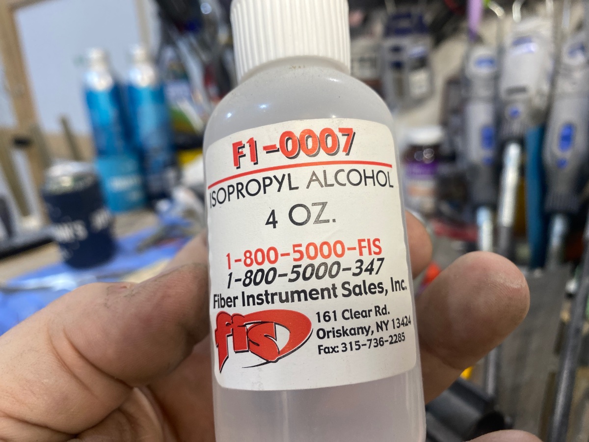

90% used for fiber optic cable cleaning.Reverand wrote: ↑Thu Dec 14, 2023 2:26 am I am a firm believer that surface prep is as important, of not more important, than the adhesive.

Kroger sells a pint bottle of 99% isopropyl alcohol for about $3 and Walmart has a 91% isopropyl alcohol for about the same price. I find there's really no difference between the two in terms of cleaning. It's inexpensive and one of the most effective cleaners I have found for knife work.
