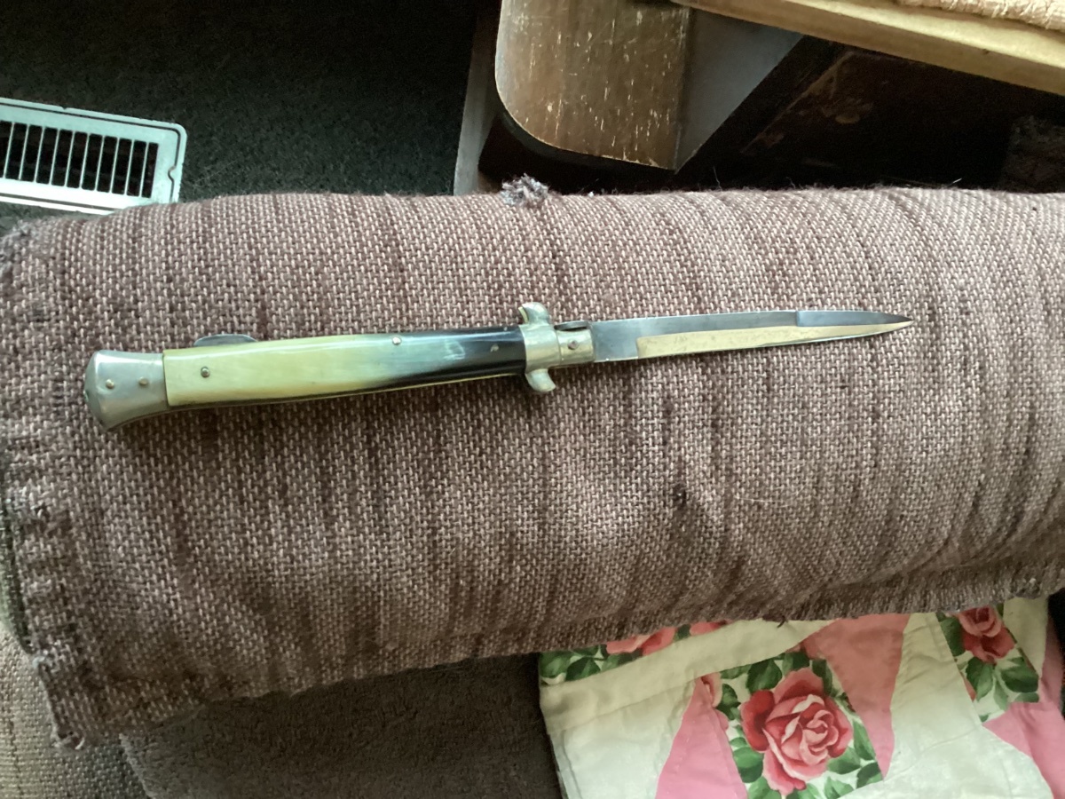

This is on its way to me.The only markings are STAINLESS ITALY on one side of the blade. It has a 3.25" blade. Any idea who made it? Age?
Bill DeShivs
Posts: 926
Joined: Sun Oct 07, 2012 4:57 am
Re: Stainless Italy
Post by Bill DeShivs »
Someone in China made it. It's not Italian.

Pops62
Posts: 31
Joined: Wed Dec 30, 2020 11:50 pm
Re: Stainless Italy
Post by Pops62 »
Thanks. Is that fairly common? Dang Chicoms.

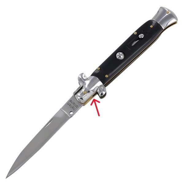

johns7076 wrote: Sun Nov 19, 2023 2:46 pm I understand the round vs flat spring, but how else can you tell China from Italy etc.
What really stands out to me about Pops knife are the silver handle pins (likely stainless steel). I have only ever seen brass handle pins or brass handle screws on genuine Italian stilettos (and I've seen a lot of Italian stilettos). This does not mean that the presence of brass handle pins or screws indicates an Italian knife (many Asian stilettos have brass pins), but silver pins tells me an Asian knife.
Another telltale sign to me for Asian-made stilettos are stainless steel liners. Most Italian stilettos have brass liners. There are some rare vintage Italian stilettos and custom-made stilettos with steel liners, and Due Buoi (Italy) used to produce limited numbers of stilettos with stainless steel liners, but if a factory-made Italian-style stiletto is new, and has stainless steel liners, I would assume that it is Asian. The vintage steel-lined stilettos, the custom-made ones, and the Due Buoi stilettos are distinct, and are not likely to be confused for a new Asian stiletto.

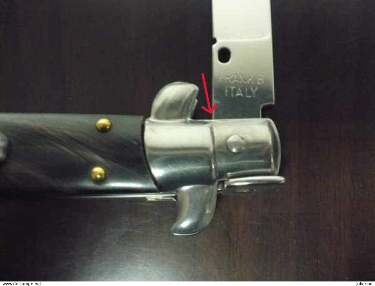

Over the past few years I've seen a lot of Asian-made stilettos with guard bolsters that have a sort of "melted" look. They lack the clean, crisp lines of the Italian stilettos, particularly the "step" in the bolster (the separation between the pivot section and the guard section, red arrows in pics). The first pic below shows an Asian stiletto (falsely marked "Italian") with the "melted" bolster. The bottom pic (genuine Italian, Frank Beltrame) shows the crisp line I'm referring to. However, just like with brass handle pins, bolsters with crisp lines do not automatically indicate a genuine Italian stiletto, but a "melted" bolster does clearly indicate an Asian-made stiletto.
Pops knife also lacks the crisp "step" line in the guard bolsters.
Those are some of the characteristics of Asian-made stilettos that stand out to me.
