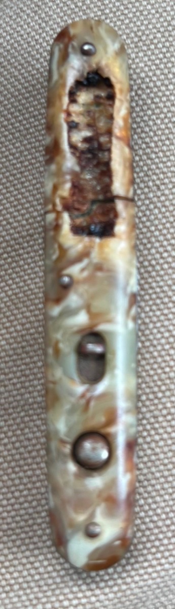

I doubt that this has any bearing on what you are describing, but another aspect of outgassing that I have noticed is that thinner pieces of celluloid tend to be more stable than the thicker pieces.
As an example, on this George Schrade Presto that I bought to restore, you can see that the celluloid still looks good on all the parts where it is thin and hollowed out beneath, yet has deteriorated badly in all of the thick parts.
Celluloid wraps on shell-handles knives are another example - I have never heard of one of those outgassing.
