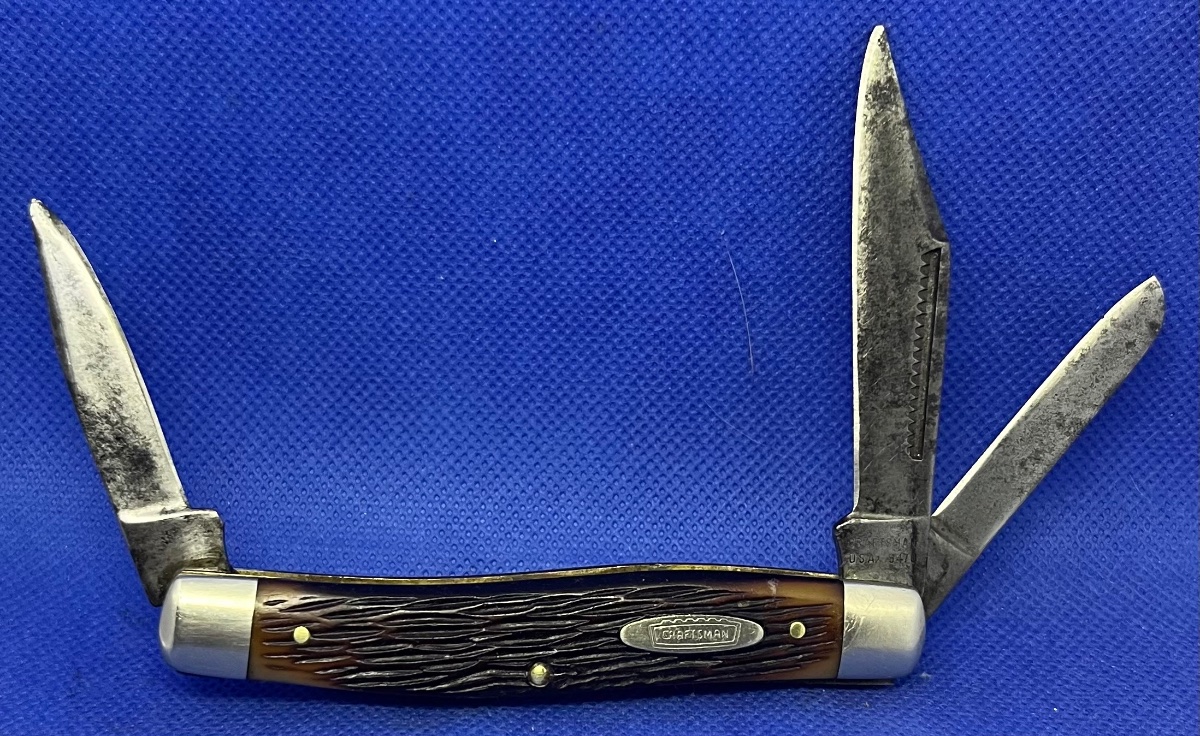

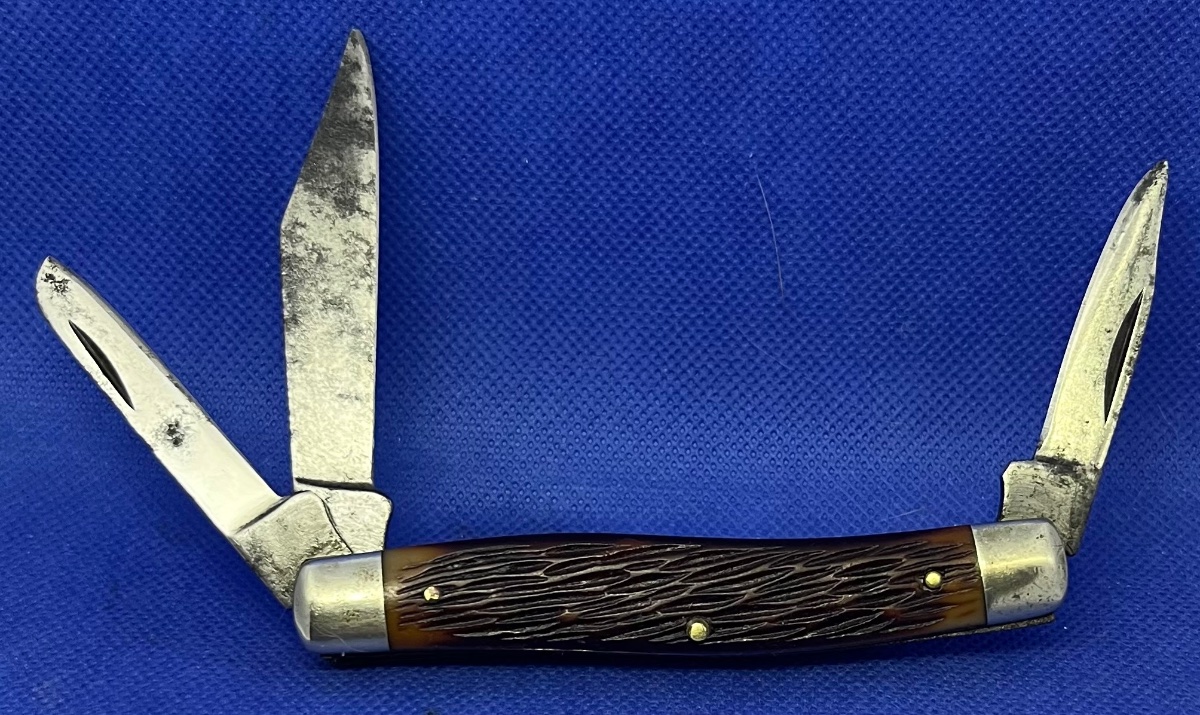

The main and coping blade were both tipped, both small blades were badly worn, and there was a chip missing from the front handle. The small blades had some heavy rust and were difficult to open.
I did not have to disassemble the knife.
I patched the handle, cleaned and reshaped all three blades. I removed as much of the rust as I dared, but there is some deep pitting left. After some good soaking in mineral oil, all three blades have good walk and talk!
The spey was worn so oddly that I reshaped it into a small clip blade (it was almost that shape already!), and the coping blade was reshaped into a spey.

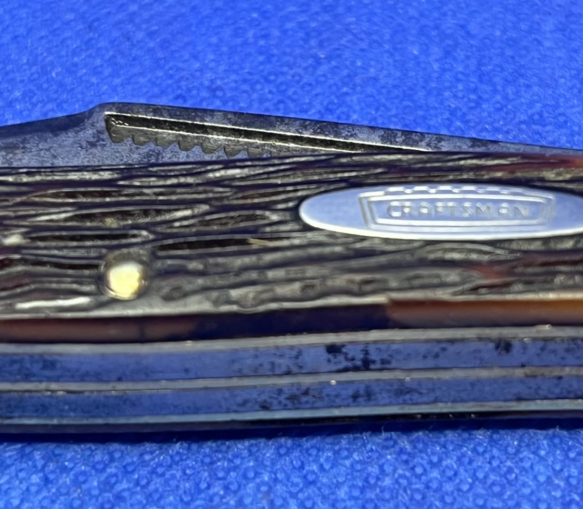

The color on the handle patch is the best job that I have done so far. The jigging is not as smooth as I would like, but I wouldn't notice it if I hadn't done it myself.

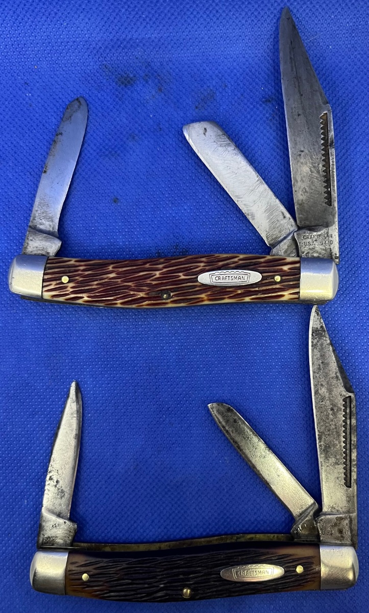

The last picture compares it to a similar Craftsman 9470 that I often EDC. I enjoy mine, except the handles are much uglier than his. The color on mine has an odd pink hue that I don't like, but haven't replaced yet.
Refreshed 9470 mark side
Refreshed 9470 pile side
Handle patch
Handle patch

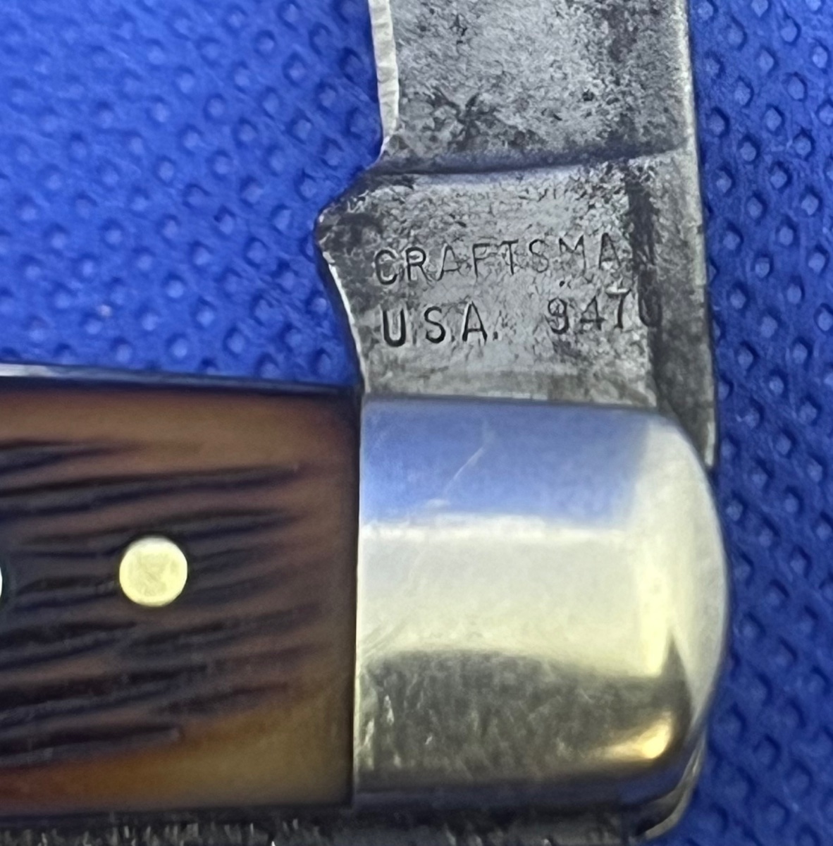

Tang stamp
Tang stamp
Comparison
Comparison
