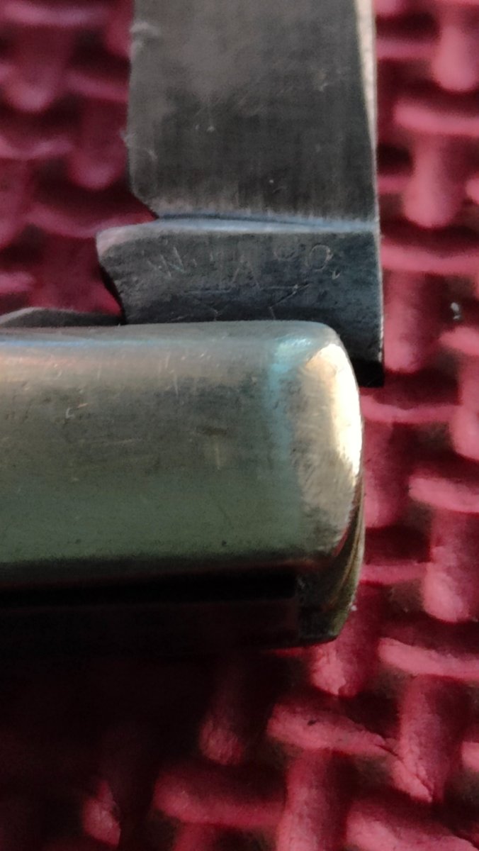

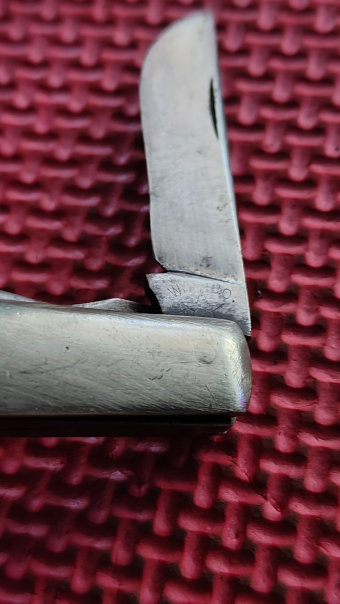

I have a BUNCH of rooster nutters, most of them have the same stainless handle even though they are made by different companies or at least tang stmaped to different companies, like Ulster, Jack knife Ben, Kutmaster. I found one that is more original with rounded edges. The tang stamp is pretty worn though and so I cant find much on it so Can you help me identify this knife? Starts with W ends in Co and has a star on tang

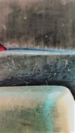

Enhanced it a bit. Still hard to make out. A picture of the whole knife might help too..

Nice one. Looks like it could be: WYETH HDW. & MFG. CO., St. Louis, MO. USA & Germany. Hardware dealer 1859-1989 J.O

Show us the whole knife. Looks like a Barlow pattern bolster? O'.

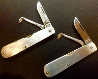

The OP says it is one of those stainless steel handled veterinary knives (All stainless including handle covers, so it can be sterilized in boiling water). Says it’s like a rooster nutter, but the blade in the picture looks like a regular spay blade.
A picture of the whole knife would be interesting but in this case probably not much help in determining the maker. A lot of companies made veterinary knives. My first thought on seeing the stamp was W. HDW. Co., which would be Wyeth. Böker stamped a star on knives they made for Primble, don’t know if they did it elsewhere.

Some veterinary knives have all stainless steel construction. Not all of them do. The main identifying trait of a veterinary knife is the blades/tools it has, for surgical purposes like neutering an animal. See these examples (not my knives). As for other examples you listed, if they have all steel construction they should be capable of sterilization in boiling water, but that may have been incidental rather than the primary intent of using steel for handle covers. However they are not “veterinary knives”. For example I have seen eating set knives having all stainless steel construction, made to be sterilized by boiling.rustof wrote: ↑Thu Aug 31, 2023 4:39 pmOK so a couple of things struck out to me....first - when you say veterinary knives do you mean you could have any other pattern type of knife (I have camp knives, swiss army knives, lockbacks, etc) with stainless steel handles are called "veterinary"? I've been trying to find out what to call a knife like that for a while now...Mumbleypeg wrote: ↑Mon Aug 28, 2023 11:22 pm The OP says it is one of those stainless steel handled veterinary knives (All stainless including handle covers, so it can be sterilized in boiling water). Says it’s like a rooster nutter, but the blade in the picture looks like a regular spay blade.

I will have to run across that knife again to upload more pics, but I had 2 tubs of knives. Then I also had a collection of veterinary blades and rooster nutters. My husband inherited these knives from his father who had a degree in poultry science from A&M. He had a collection of nutters. He had a friend who collected knives that passed away, he paid the widow for his collection. That guy Mike was a veterinarian and collected all things sharp. He had an extensive collection of veterinary blades. He had also started at the letter A in Goins and gone through it to Z. That is why you see so many lesser known makers from the early 1900's. Back to veterinary blades, that blade with the star, I found in with the vet stuff and it does have a nutter, is a spay blade the same as a castrator?
