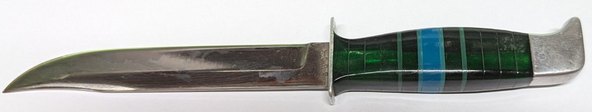

If I were sharpening this knife, which is a bit on the "special" side, I would only use hand sharpening since I would not trust myself. Not that I would use this knife, too afraid. It has been in the family a very long time:
And yes, that is a Buck 105 with a green and blue lucite handle. I initially assumed that my grandfather had rehandled it because I was not able to find one for sale no matter how hard I looked (before I was told what it really is).
Most other knives, if they really need work I am likely to use a belt sander of sorts and then I almost always move to the Spyderco. My daughter asked me to sharpen her Kershaw that came with a very nice edge and it was not nice when she asked me. The blade angle was larger than 15 degrees and I was making slow progress bringing the edge down by hand so I grabbed one of my Worksharp belt sharpeners (for the knife in question I chose the older version with the narrow belt and very quickly I had a refined bevel. I do manage a very nice edge off just that but I am usually more refined off the Spyderco for the final.
