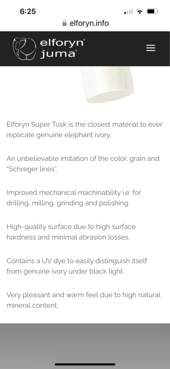

I had never heard of it either so I googled it. Looks like a visual would be hard to tell but I have never seen any to know if I can or cannot tell by visual inspection. I bet it still fails the "hot pin" test. I also don't think it is much to worry about at this point since there only seems to be one source in the US now. I also think that any honest knife maker would say what material was used and it's unlikely to be used in restoration of antiques. Evidently it only is made to mimic elephant ivory, not walrus or other ivories.

I had not heard of Super Tusk until this post.
One website claims that it does contain a UV dye, so that ot will glow under a backlight.

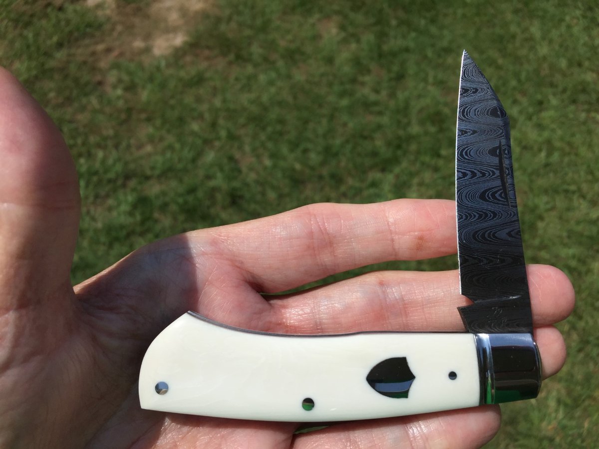

This is the knife in question.

Larryburford wrote: Sat Jun 03, 2023 4:11 pm This is the knife in question.
Sure looks a lot like Elephant Ivory, I can see how it would be easy to confuse. Great looking knife either way 8) and, FWIW, at least you'll have no need to worry about the many legal/ethical issues/hassles often associated with genuine ivory. ::undecided::
Who is the maker?

Pablo Castellani of Brazil was the knife maker

Larryburford wrote: Sun Jun 04, 2023 11:24 pm Pablo Castellani of Brazil was the knife maker
It looks pretty new. So fairly serious laws would have been broken it it were real ivory and shipped internationally. You may be out the price you were were paying for real ivory, but at least you are not on the hook for a $50,000 dollar fine for violating the ivory trade laws.

Good looking knife for sure.

Oh boy! That's a nice looking knife Larry. Was it supposed to be antique ivory or interior mastodon or mammoth ivory?

If they could put just a hint of that aged yellowing.
