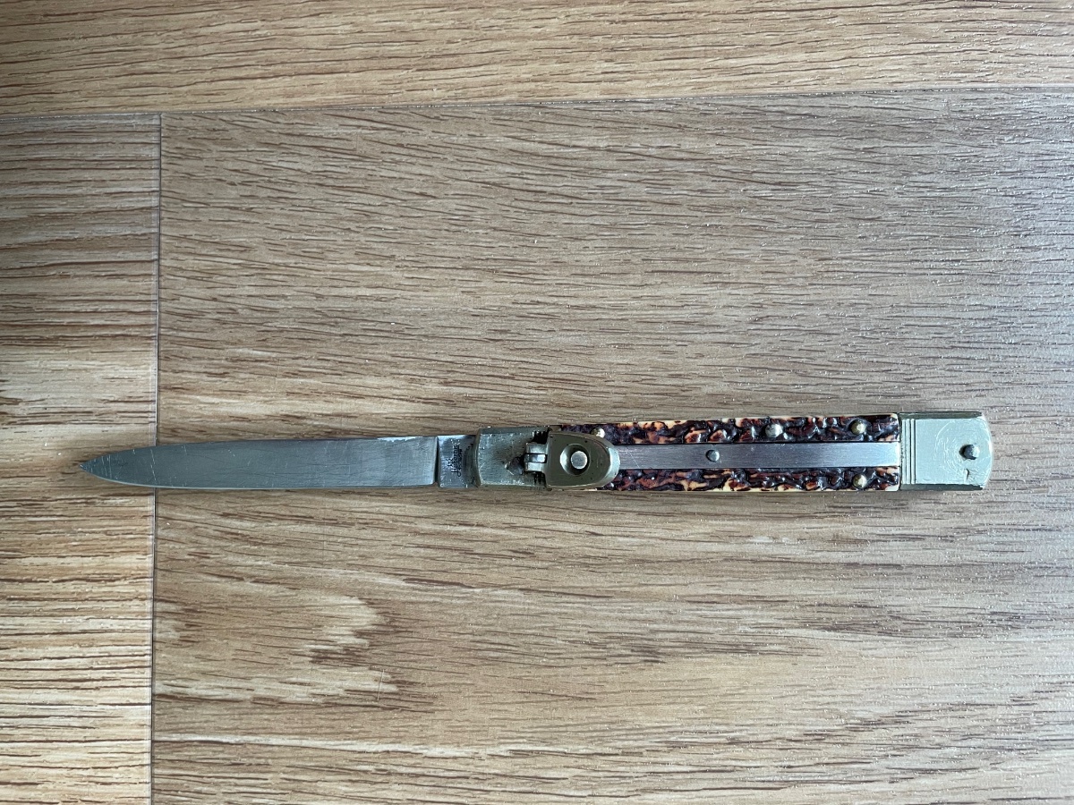

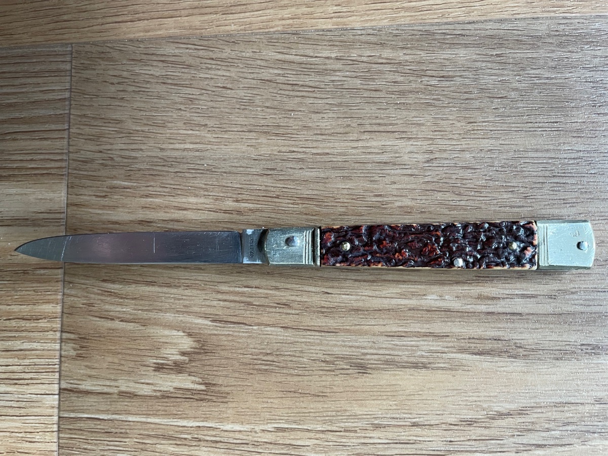

I recently bought a non-functioning, simulated stag, tang-stamped Hubertus slim off of eBay.
After I received the well-used knife, it had a number of issues that needed to be addressed, besides the missing spring.
After disassembly, I was able to make and install a working spring (staked in place). With the help of a master welder, and after some hand file and Dremel work, I was able to address significant blade “peek”.
Thanks to information, I found here and elsewhere, I ended up with a nice old carry knife that also “shows” well! (I chose not to attempt to address the fact that the blade is not centered in the frame since operation is near perfect and the blade is tight.)
As I mentioned, the knife has simulated stag scales, perhaps celluloid. Liners are steel and the blade is “rostfrei”-(stainless).
Does anyone have any info on this Hubertus model with faux stag scales?
Thanks!

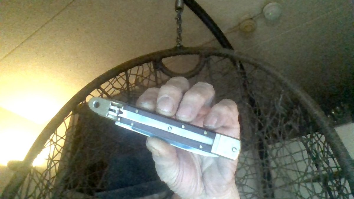

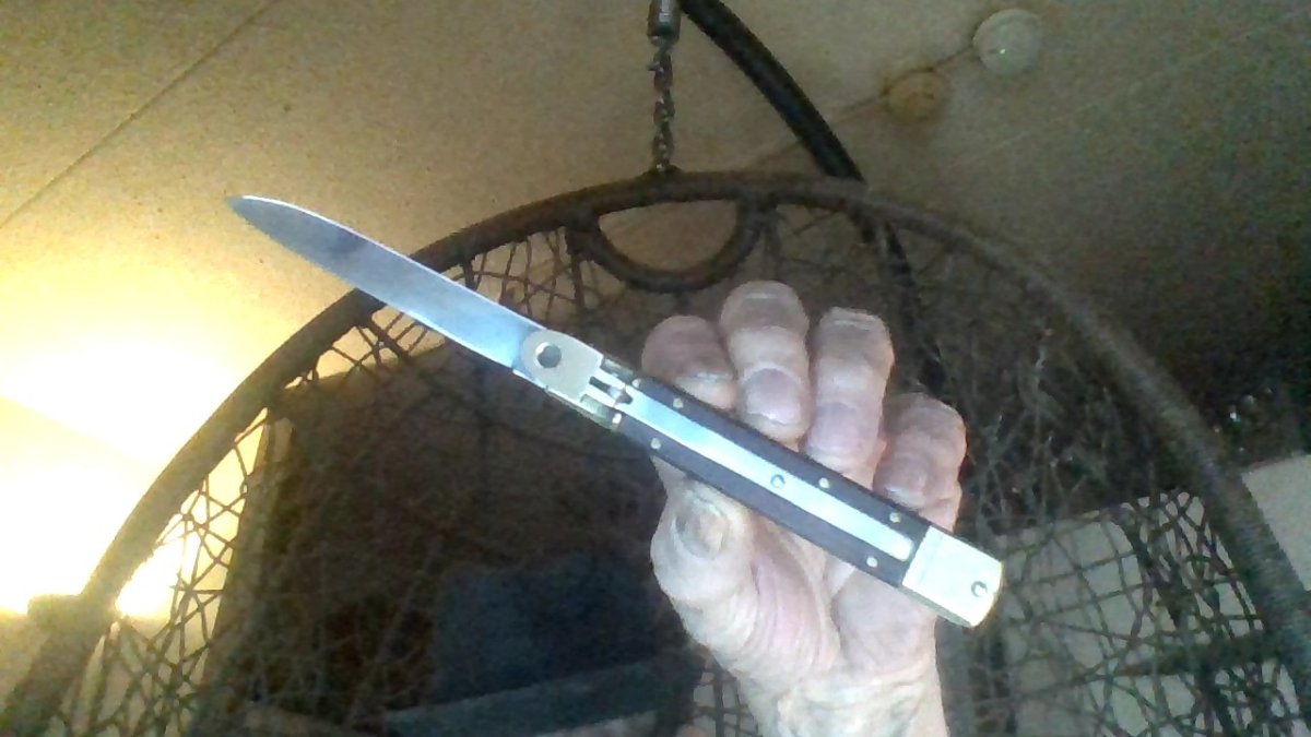

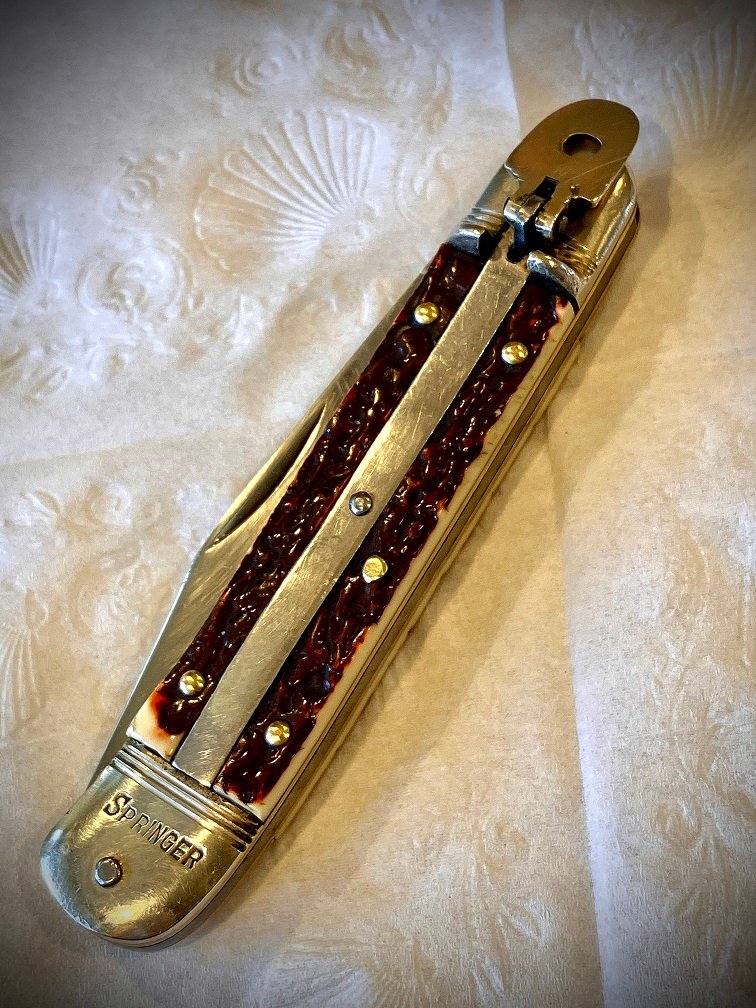

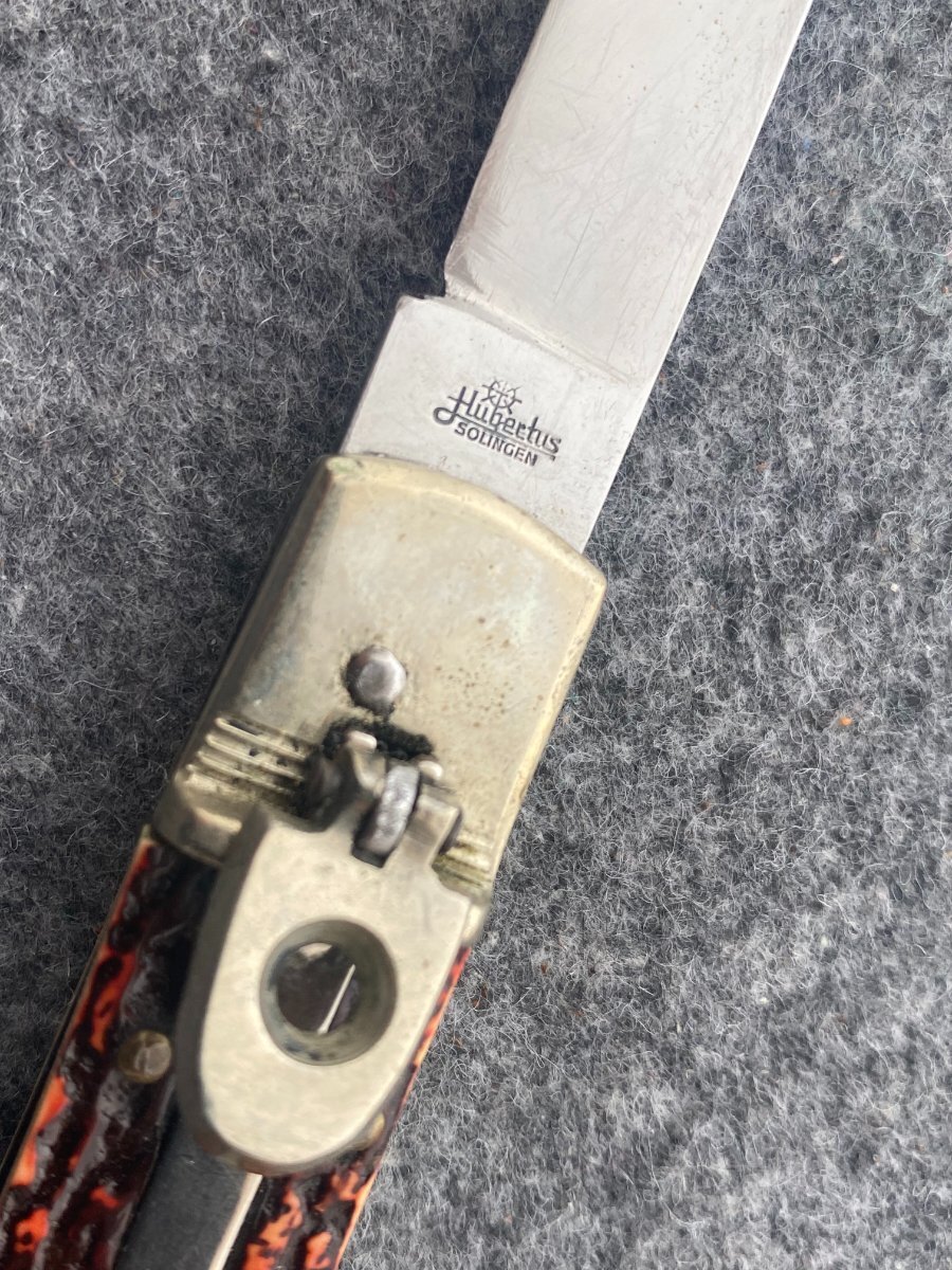

I can't tell you much about your knife, but I included a picture of my "Slim" with Rosewood covers for comparison.
It does seem unlikely to me that Hubertus would use faux stag and not the real-deal, but who knows.
My understanding is that lever locks with a fixed rivet installed in the metal strip running down the front of the knife like yours has are originals, and models with a screw in the strip are clones.
I am also under the impression that legitimate knives have brass liners whereas clones have steel liners.
Could you please post a close-up picture of the stamp on the tang?

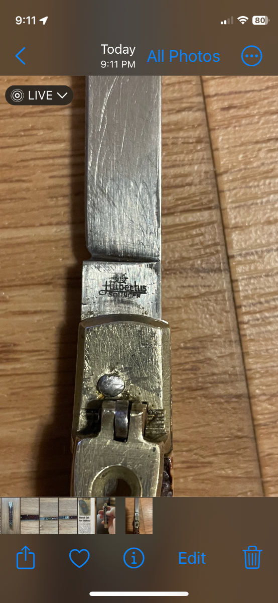

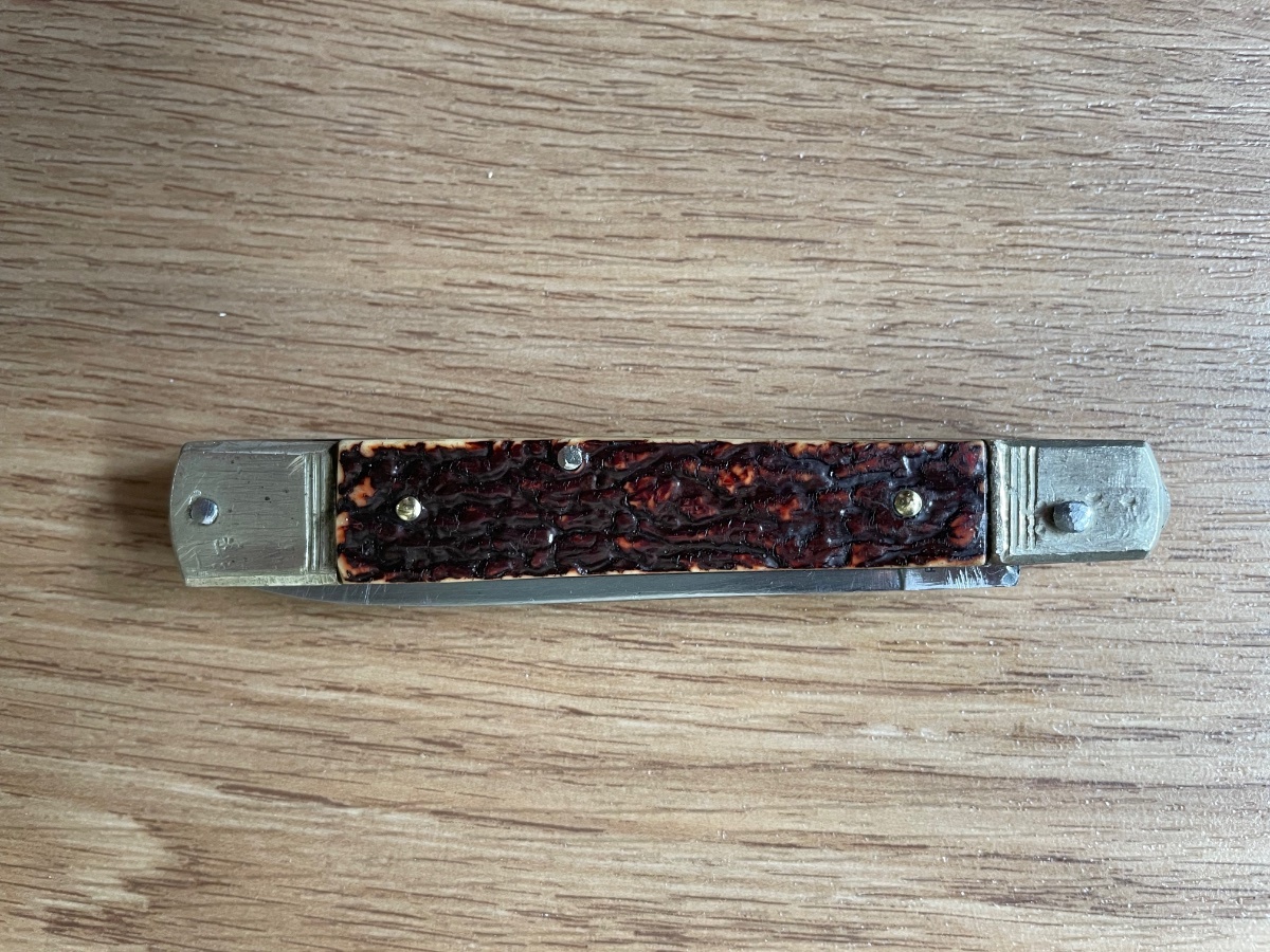

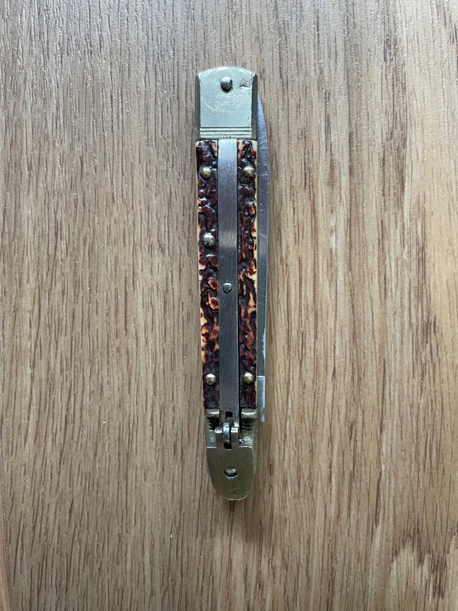

Thanks for your response, madmarco, and the photos of your Hubertus slim. I’m posting the close up of the tang stamp.
I’m aware that Hubertus made a “springer” model with steel liners and faux stag scales as I read on AAPK posts. That one was called a “Handwerkermesser”, which is roughly translated to mean “working man’s knife “.

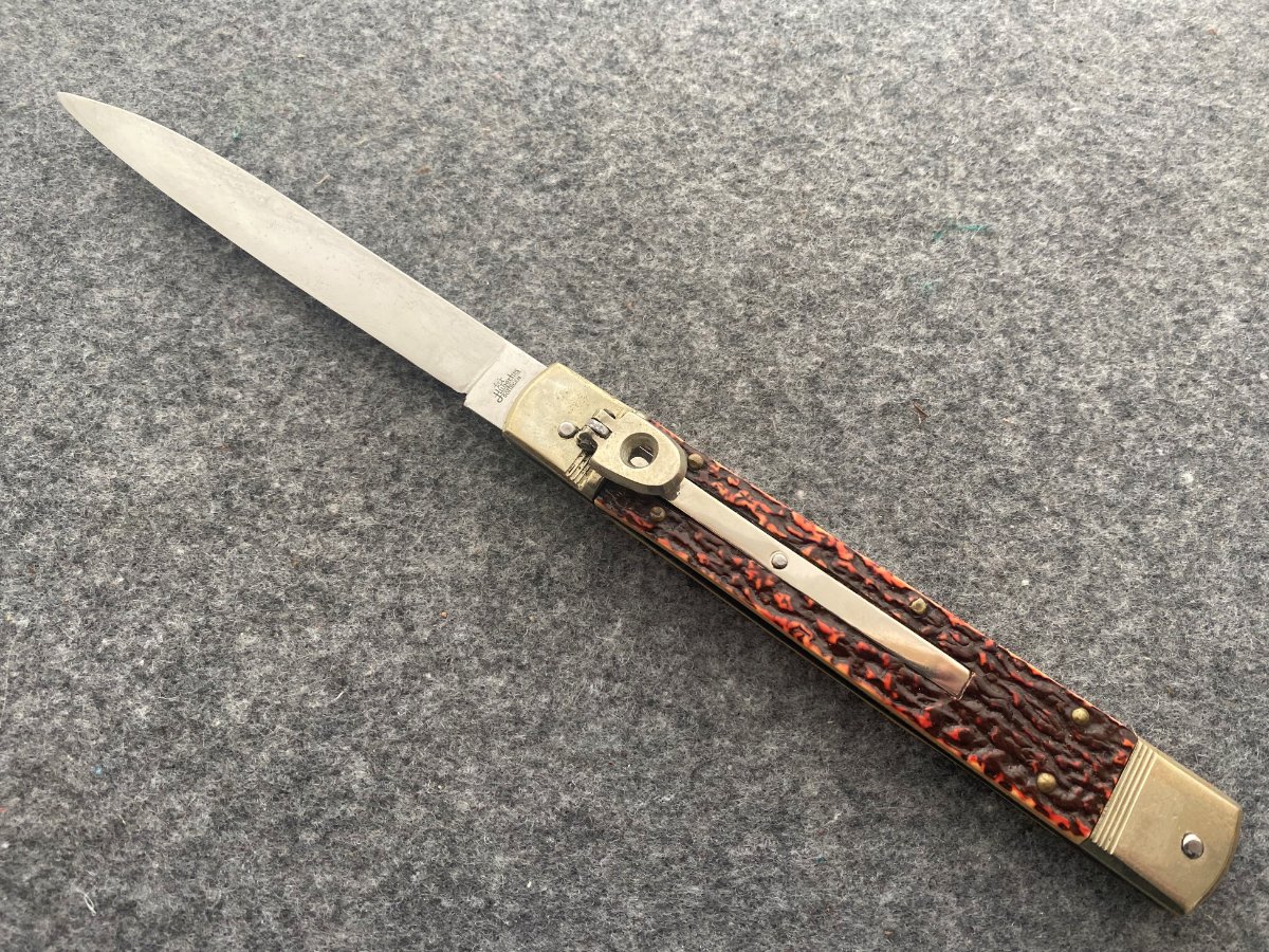

I've had a number of early examples Tang Stamped with faux Stag. Just sold this 10cm. Personally I think it was just to offer a lower priced version.

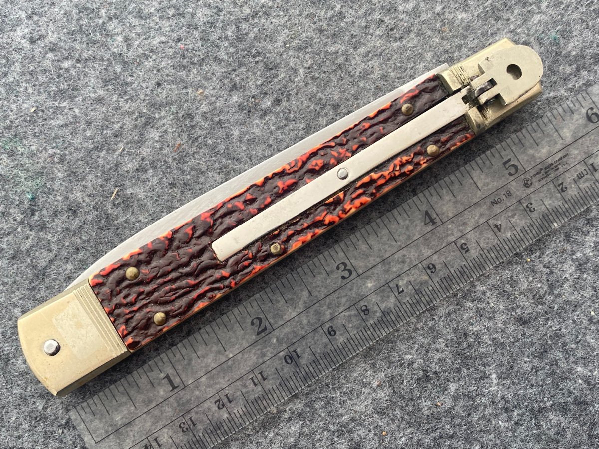

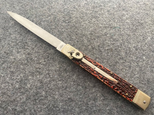

I don't believe the handles are celluloid but rather some type of plastic. Liners are nickel silver. Here is one that is 14 CM closed. Fires hard and locks up positive.

Very nice 14 cm slim! Interestingly, the liners on my 12 cm slim are definitely steel.
(I had the knife completely apart to address the flaws I described. I was surprised.)

My mistake on the liners of my knife. The liners are steel as well.
