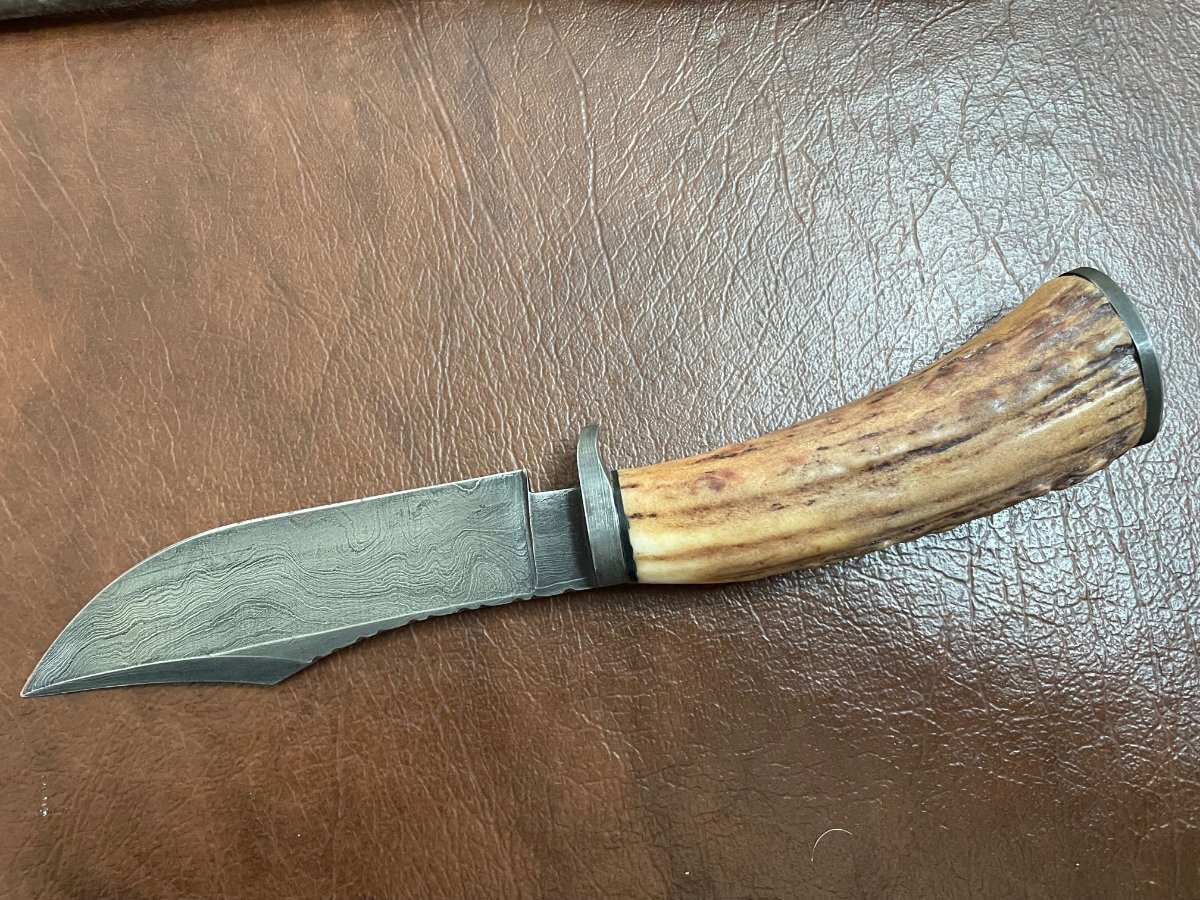

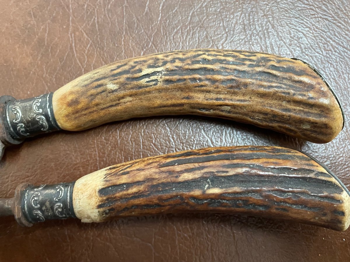

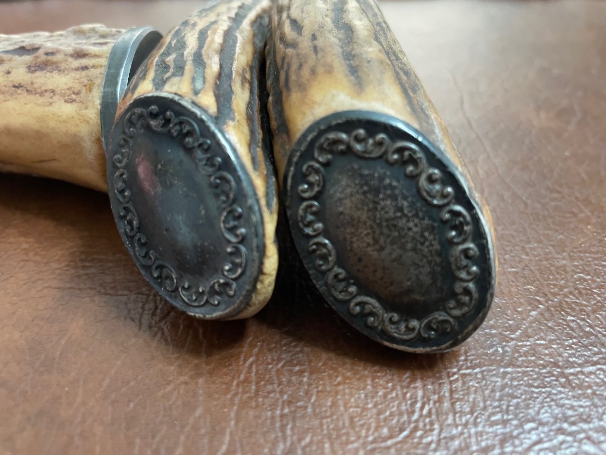

I bought this roached out carving set to recycle the nice old stag. The custom hunter below was made for me by Guild Member,Frank McGowan about 20 years ago from another old carving set. At that time I spent many hours trying to extract the tang from the handle. Whatever the "Cutlers' Cement" those old guys used was really hard to deal with. Wonder if anyone has a tip or an easier method of extracting those tangs. Any help would be greatly appreciated. I may just slab them for pocket knife handles but I'd like to have them whole if I could. J.O.

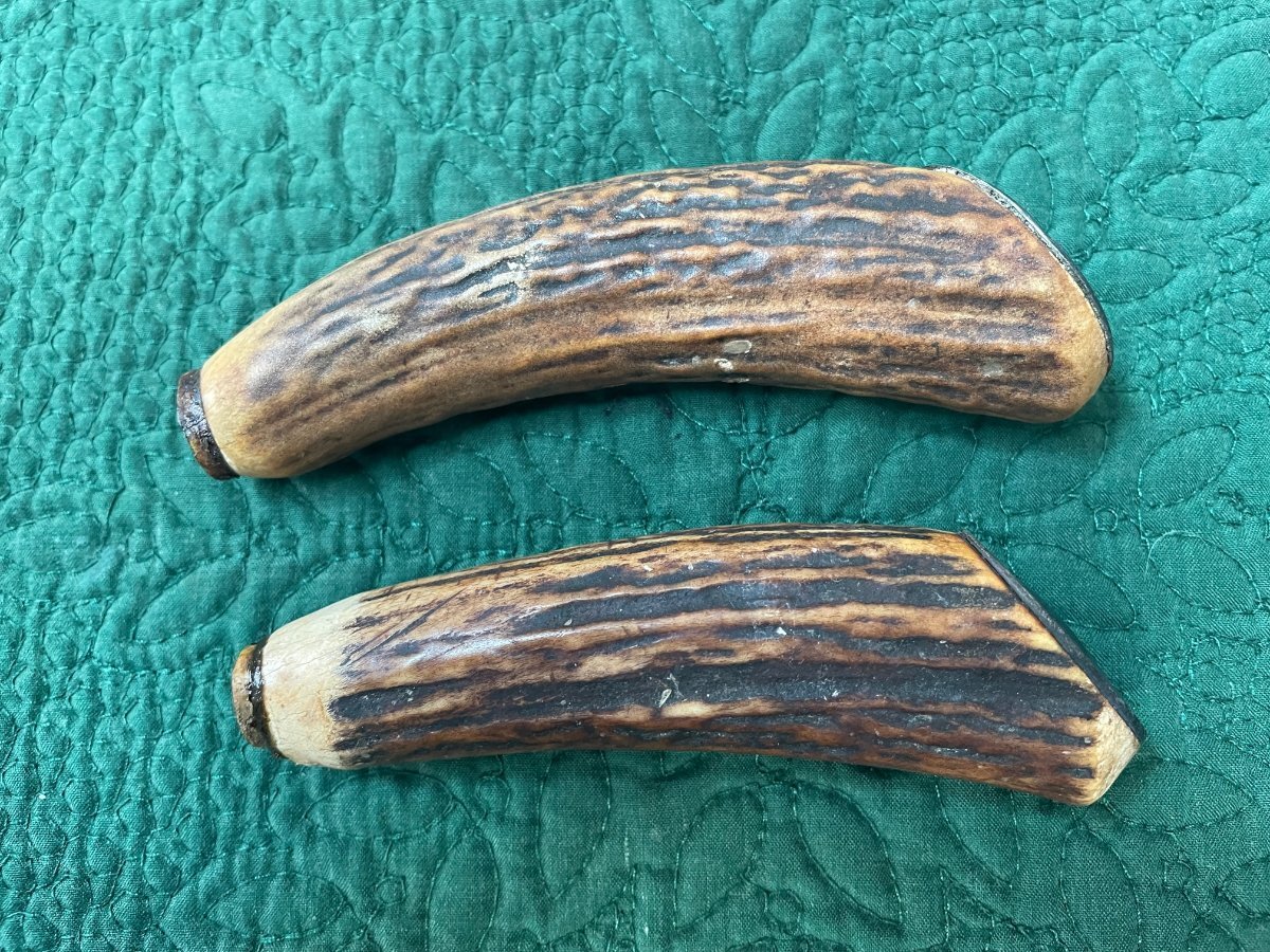

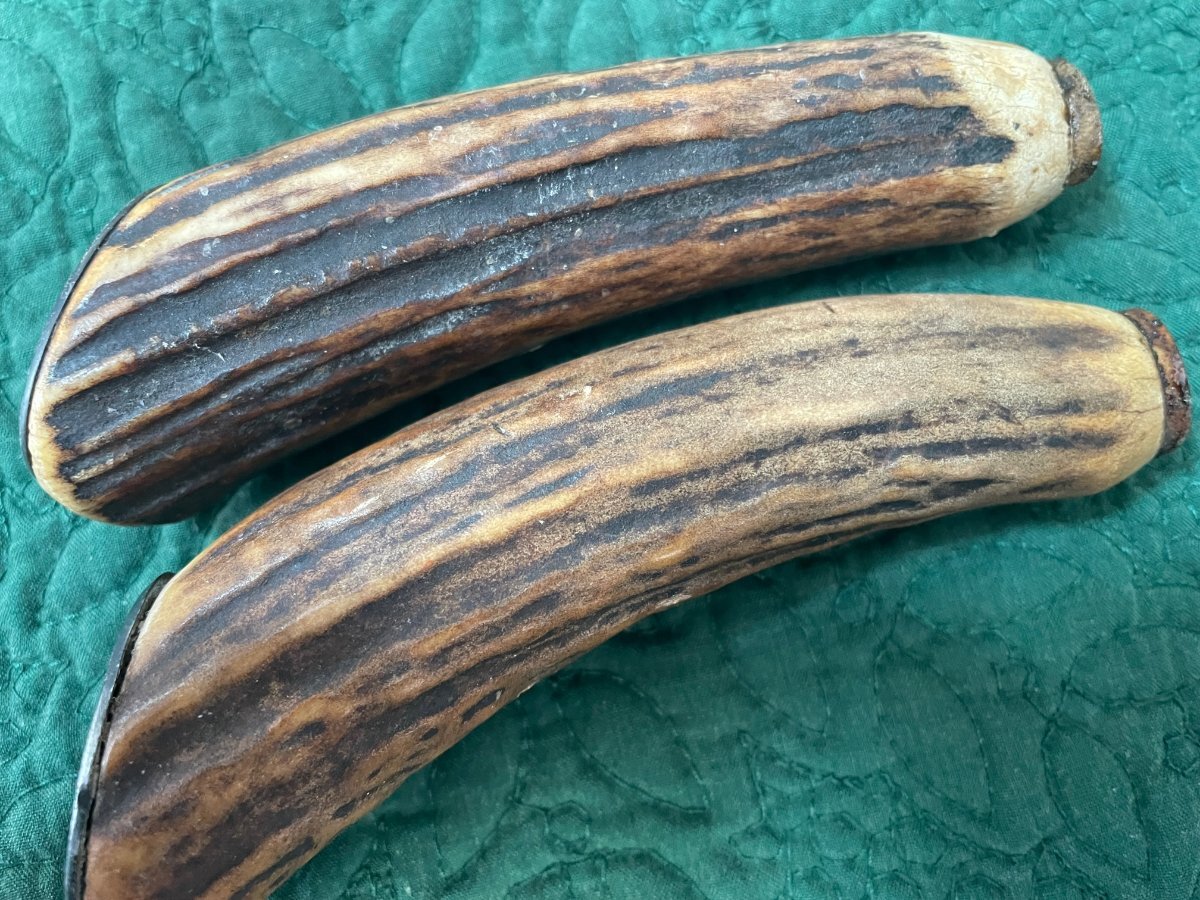

Just an update. Dale, your tips worked perfectly. I froze them and the knife did loosen up some. I worked the torch about three-four inches from the hilts and the cement began bubbling out slowly for about 3 or 4 minutes. When I torqued the blade and the steel with channel locks they both worried out rather easily, and the stag is totally unaffected. Great method, especially compared to my struggles in the past.

Lovely stag. Can't wait to see what they go on.Ridgegrass wrote: ↑Wed May 10, 2023 2:30 pm Just an update. Dale, your tips worked perfectly. I froze them and the knife did loosen up some. I worked the torch about three-four inches from the hilts and the cement began bubbling out slowly for about 3 or 4 minutes. When I torqued the blade and the steel with channel locks they both worried out rather easily, and the stag is totally unaffected. Great method, especially compared to my struggles in the past.and
