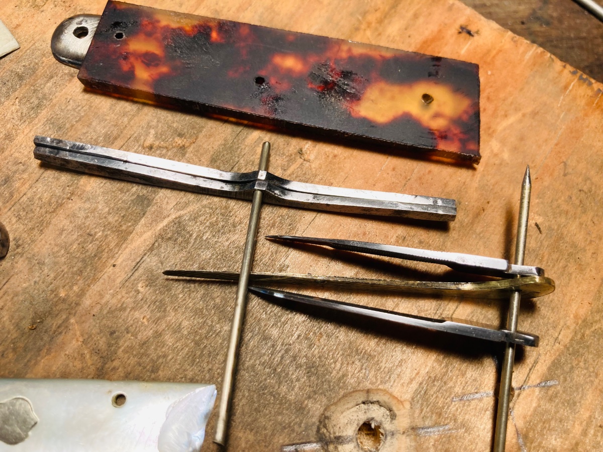

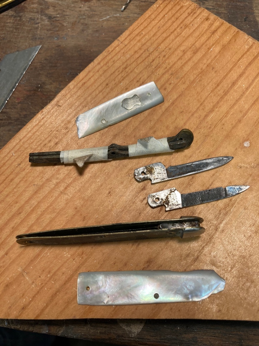

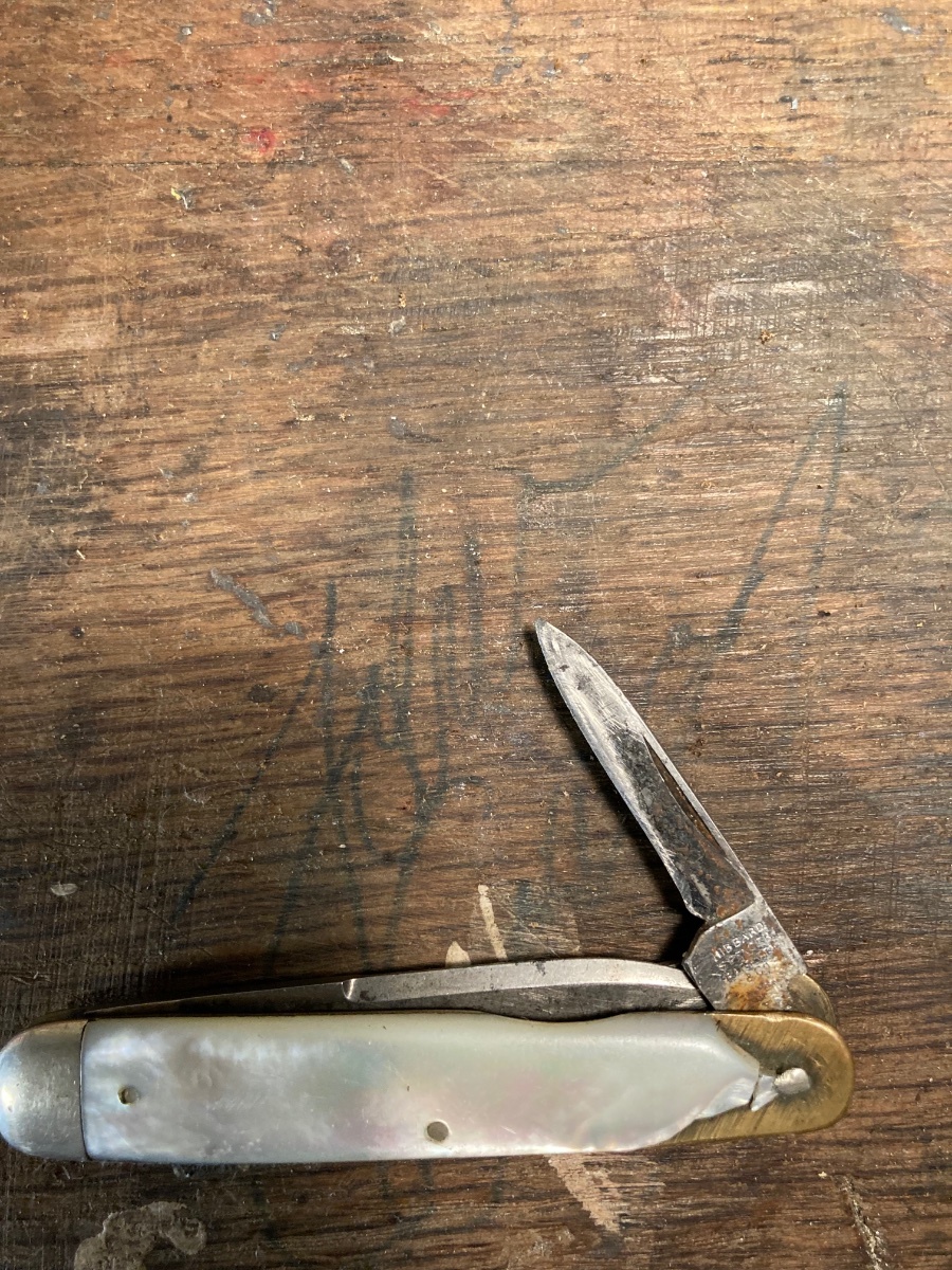

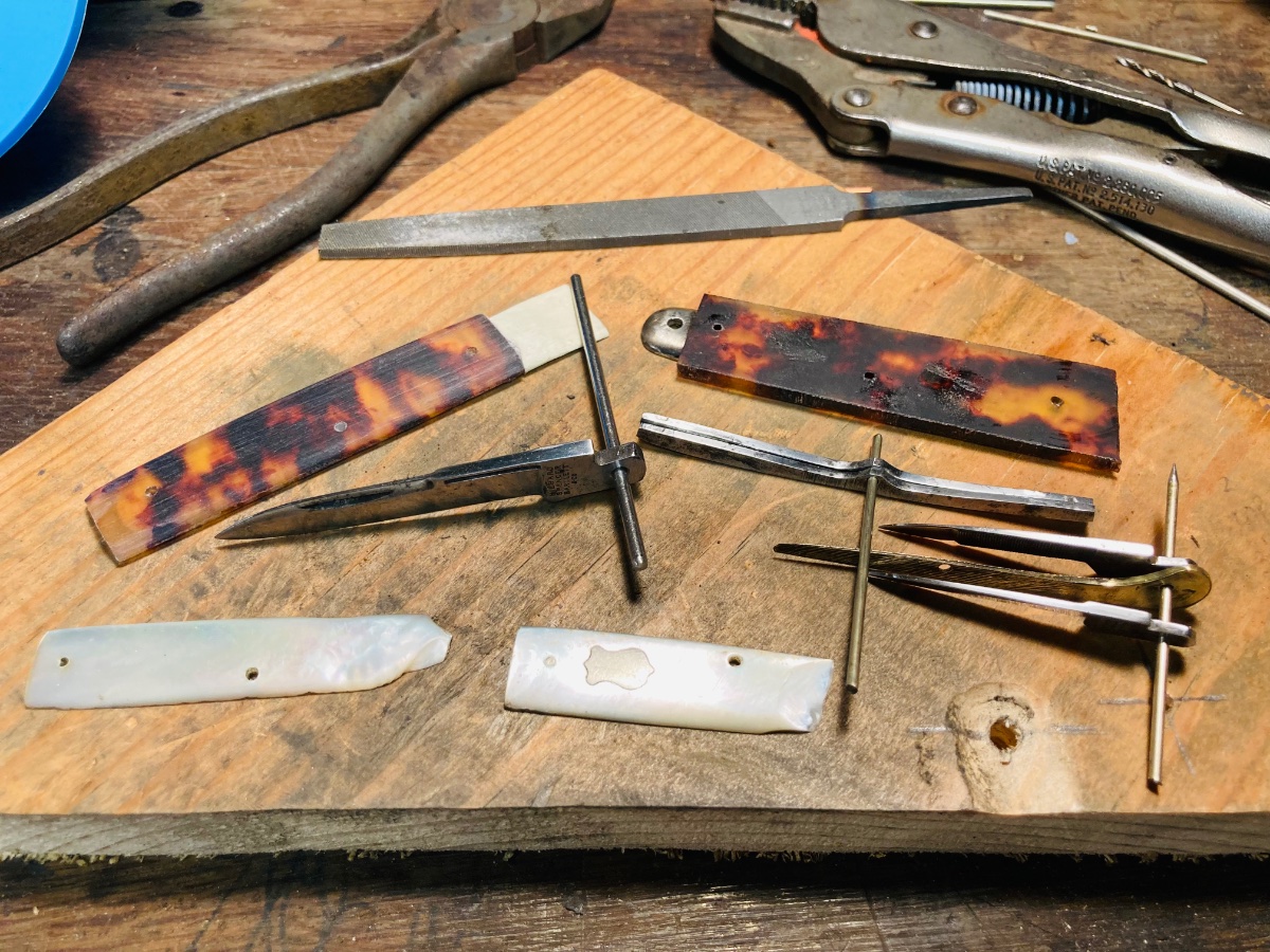

I’m attempting a 1st time repair a HSB whittler with broken pearl scales. Knife is apart and I’m cleaning everything up. Gonna replace the pearl with faux tortoise shell. I’ll update later with better pics and progress.

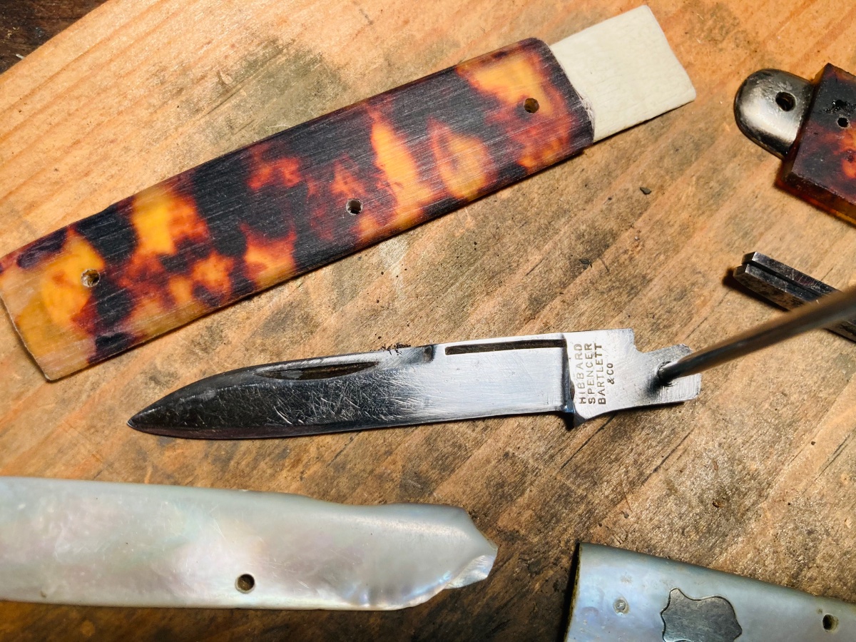

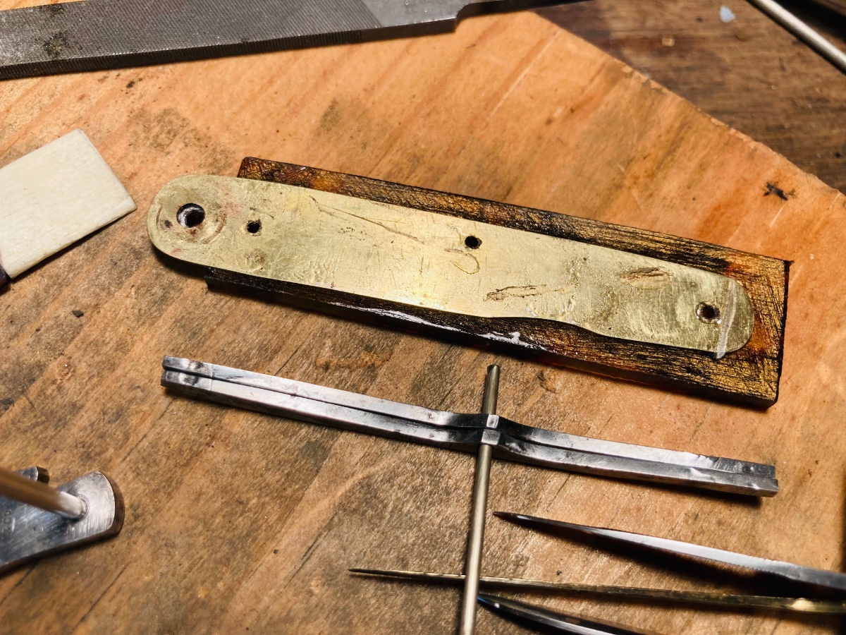

Thanks Herb, I am gonna give it my best shot! Got the scales glued on to the liners today. I’ll keep this post updated for sure.

Didn’t have the right size bolster pins in nickel so I drilled out bolsters and they both broke loose from the brass liners. I ordered and received a solder/flux kit and soldered them back on. That was a challenge for sure but got it done. I did this step before I fitted the scales and epoxied them on.

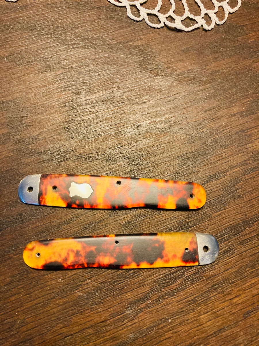

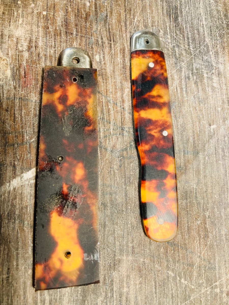

Both scales are epoxied on and I got 1 sanded down today close to ready. Still have to sand the other one and attempt to cut for the shield, ugh, stay tuned!!

Hooked up the foredom to inlay the shield. Got it cut out and shield in. Will post a pic tomorrow.

Post by Oledadsknives »

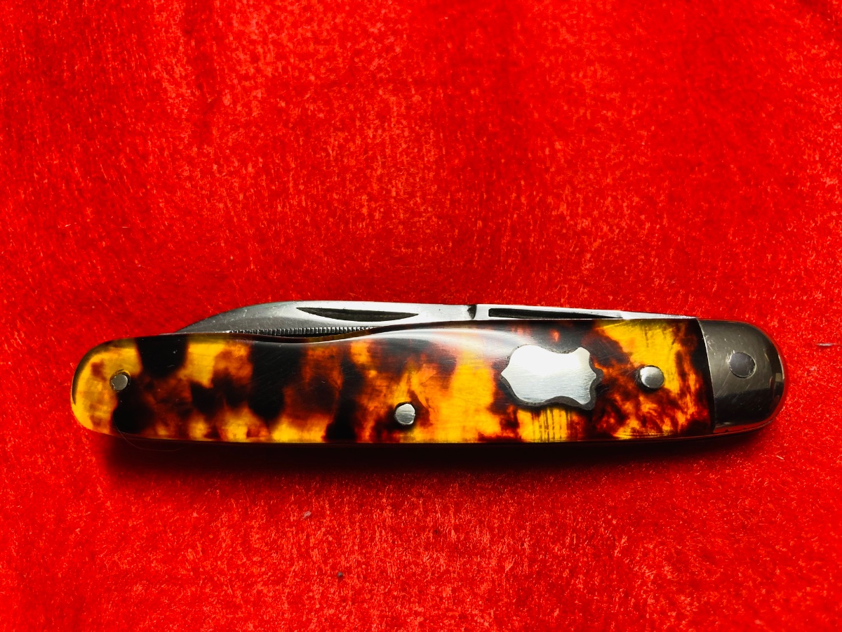

Got the shield in, a slight bit off but in!

Got the shield installed, a little off but it is in!

Reverand
Posts: 4473
Location: Pisgah, AL
Re: Hibbard Spencer Bartlett repair
Post by Reverand »
The shield inletting looks perfect, Jimbo!

Oledadsknives
Posts: 942
Joined: Mon Nov 21, 2022 3:25 pm
Location: Bama
Ha, not perfect Reverand but I’m pleased with my first time try with a foredom. I had to fill in some bad cuts but they don’t show too bad. Thanks for the confidence builder!
Sorry didn’t mean to post the handle pics twice.

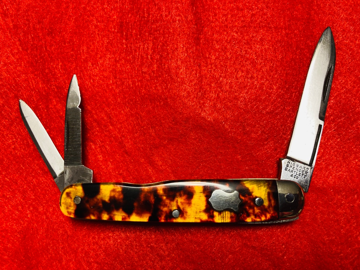

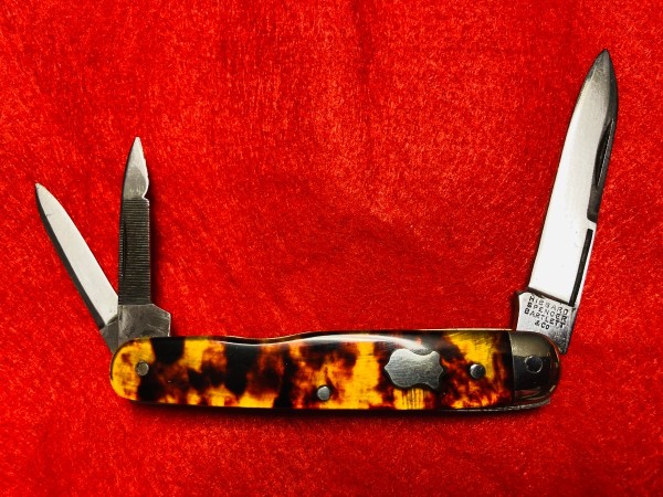

Here is the final product. By the way I learned alot on this journey. Knife came out fair but I had to pin it over once. I’m happy with it though. A word of advice, Make sure if you have to drill for larger pins that you have everything perfectly square when you drill. I tried to turn a stainless pin down for the main and decided to drill the bolsters and liners and main for a .094 pin. Bad mistake! Drilled the rest of the pin holes for .062. I got er done but it was a major hassle for sure.

Reverand
Posts: 4473
Post by Reverand »
Looks sweet! That faux tortoise shell looks so much like the real thing!

Thanks reverand, I enjoyed working with it mainly because it’s not brittle like pearl would have been so I could beat on them pins! Ha! I couldn’t get the bolster pins to disappear so I’ll have to work on that in the future.
