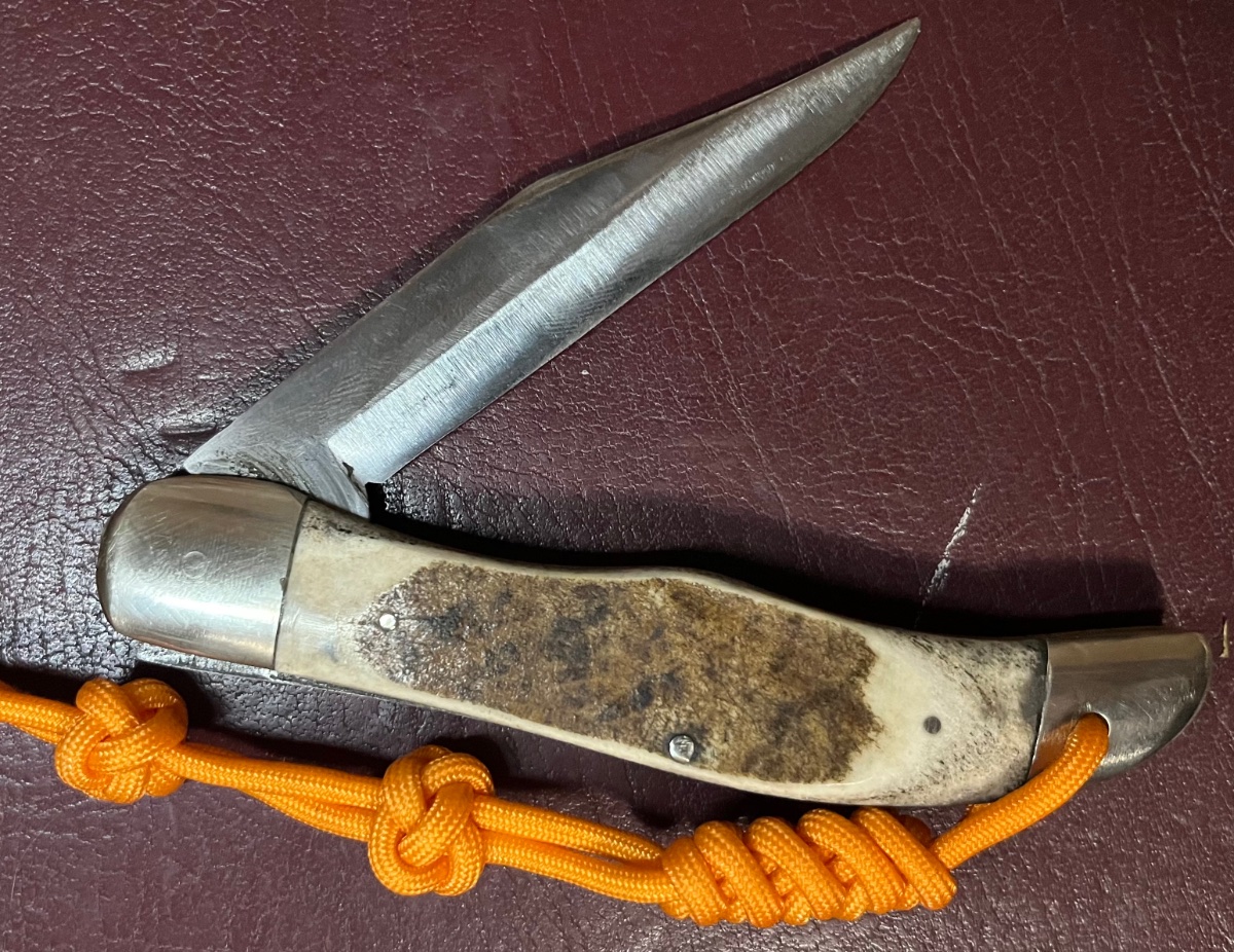

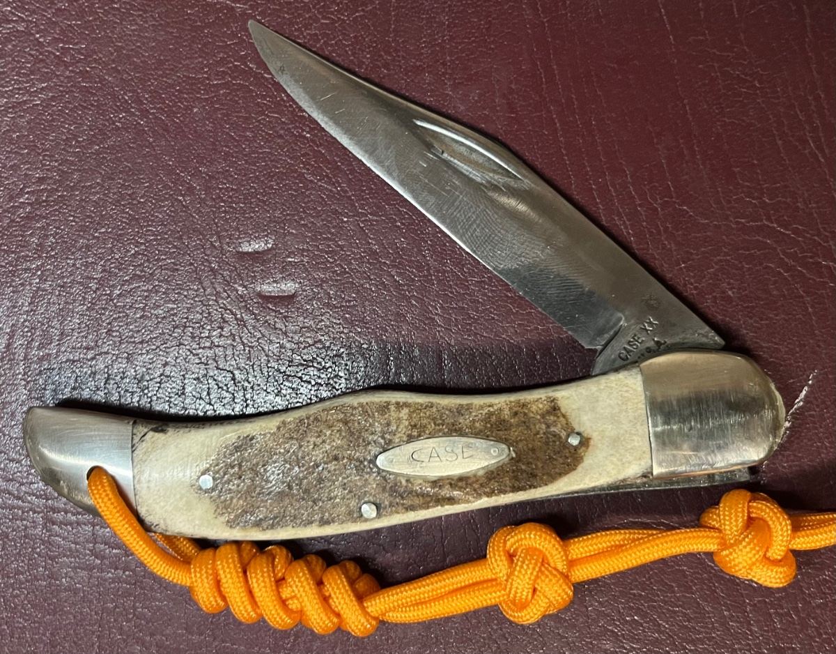

I began this knife rehab a few months ago, and finalized it today. I am not as happy with it as I had hoped, all due to the nature of Moose Antler as a handle material.

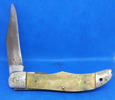

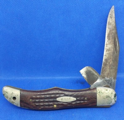

It is a 1974 Case 6265 SAB folding hunter that had been badly abused.
Here are the "before" pics: I removed the broken blade, cleaned up a lot of rust and pitting on the clip blade, and put Moose antler slabs on it. There was only a thin layer of hard antler, so the pith showed through in places. I thought that I could seal it before buffing and make it okay, but even sanding put black particles in the pith. I tried hand sanding and sealing the pith with CA glue, but black crud built up no matter what I tried. So, lesson learned on trying Moose as an alternative.

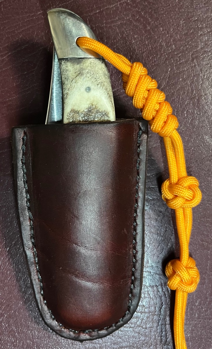

Still, it looks better now than it did! I can always go back and rehandle it in something else later, but for now I consider it finished. I even made a leather half-sized belt sheath that holds it pretty well, and practiced up on some lanyard knots to complete the ensemble!

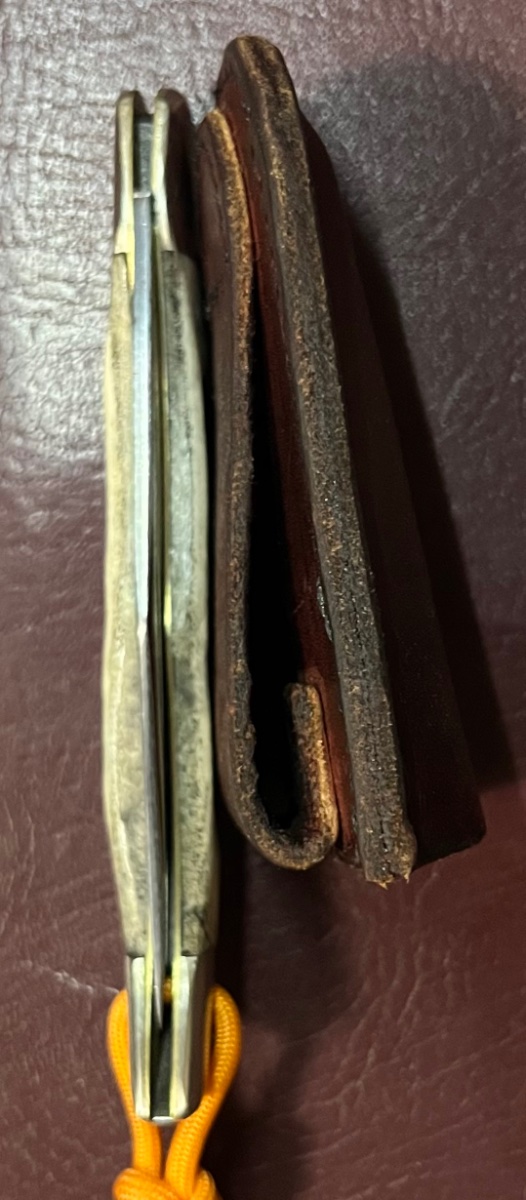

How about a well shot so we can see how thick the slabs are ....

I thinned them down on the back side trying to get rid of most of the pith. They came from the same piece of antler that I split down the center with a hacksaw.
Still, I may experiment with Moose again in the future, perhaps on something smaller, and may try experiments with stabilizing it first.
Here is that well shot (slightly out of focus. Sorry!) Not much thicker than original.
