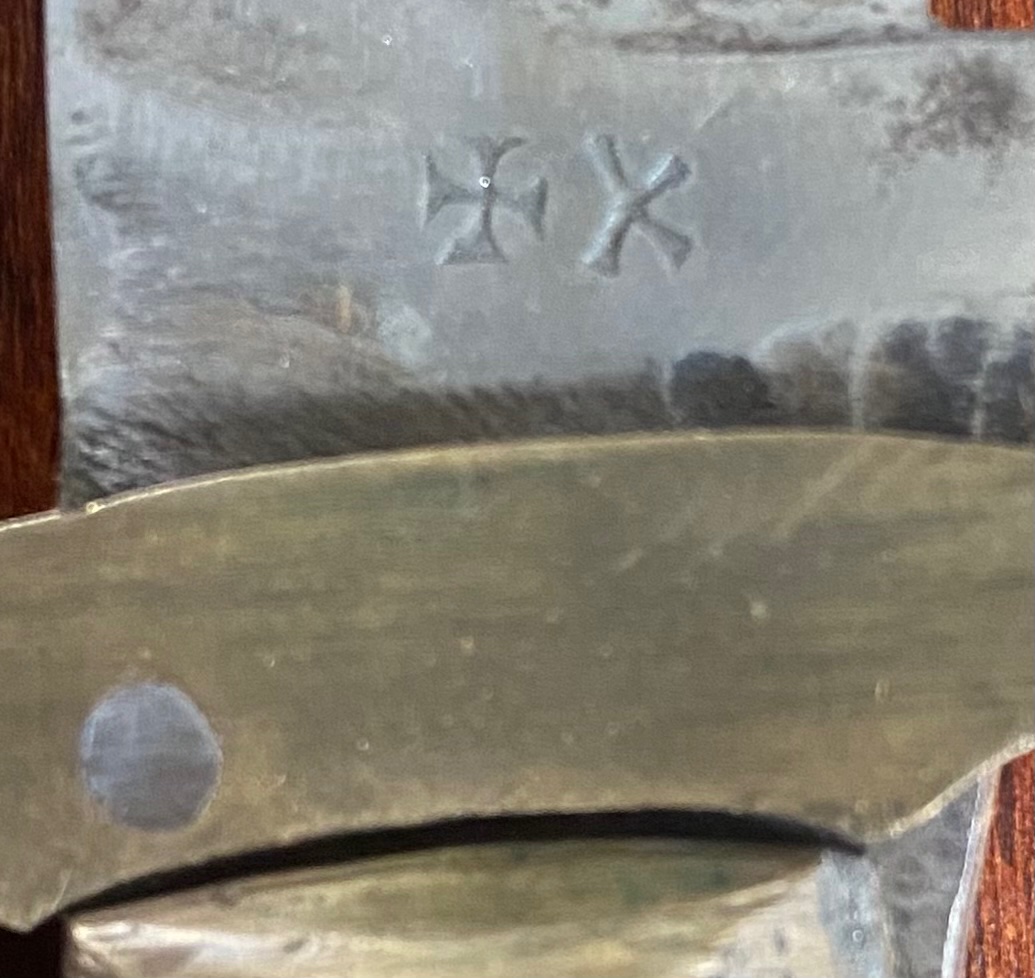

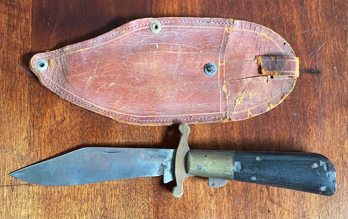

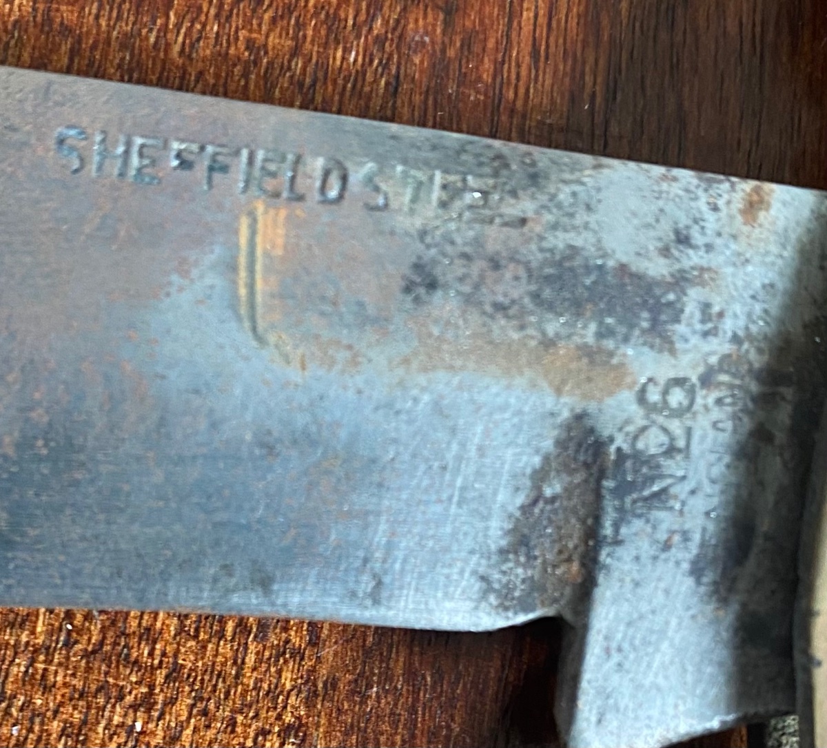

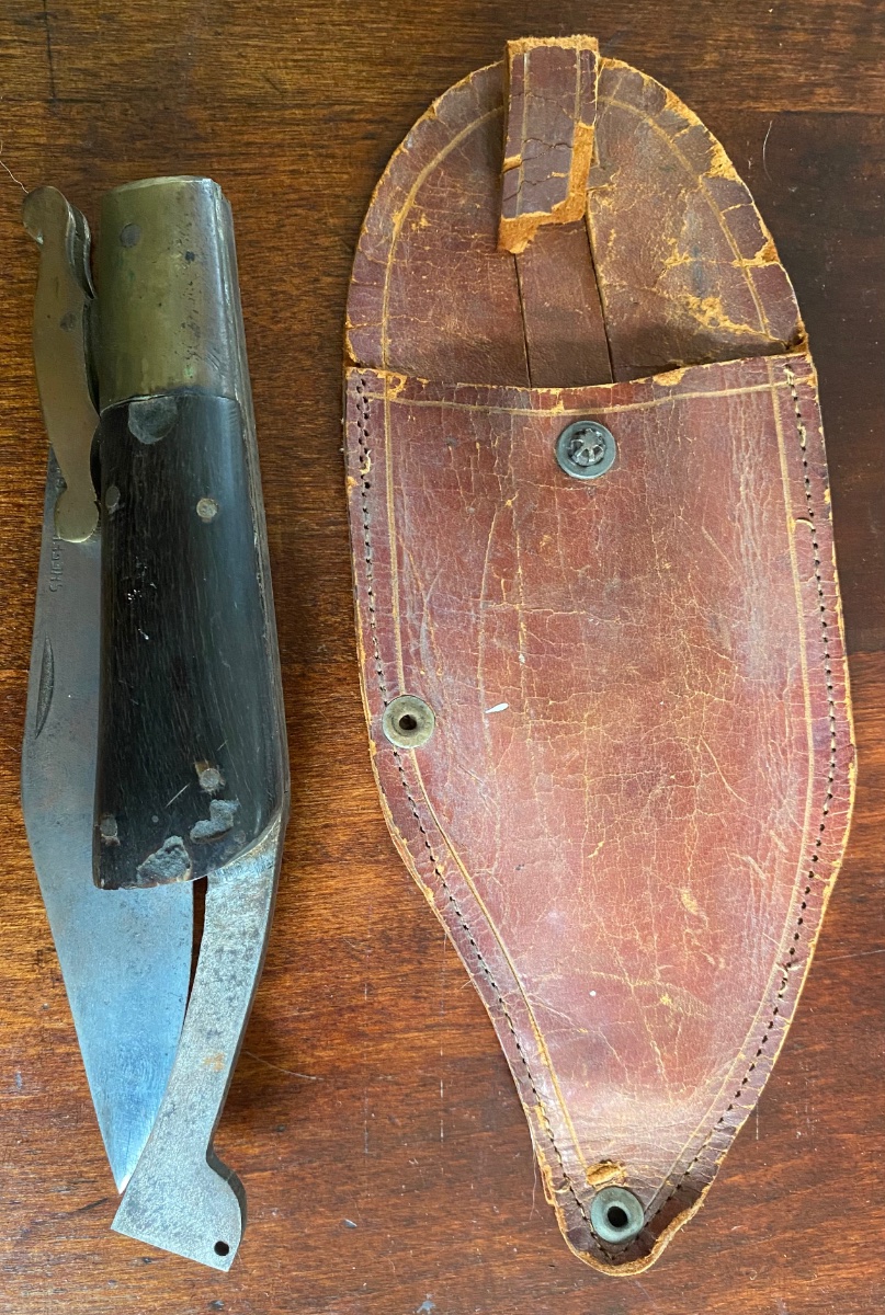

Just got this in an antique shop for $50 this morning and thought it a fair price. I see these marks on pretty much anything Sheffield so I’m not sure. Is this from Joseph Rogers and if so, when would it date from? Also, would this be called a folding Bowie or folding Hunter? Unfolded it’s 10” open, 6.5” closed. Thanks for your feedback.

Sorry no too rough around the edges. Looks like a collonial copy

Knife was made in India, likely post WW2. Lots of these around with spurious Sheffield markings and ridiculous marks to imitate Joseph Rodgers. Sadly, I think you paid top dollar for it. You will not find those marks on anything actually made in Sheffield.

Also the spelling of Sheffield. The first f could be an e or an f. So SHEFFIELD or SHEEFIELD.

Joseph Rogers would never have produced such a knife.

I would say that is an old India or Pakistan job...maybe all the way back to colonial times...the overall finish is definitely not Sheffield!
