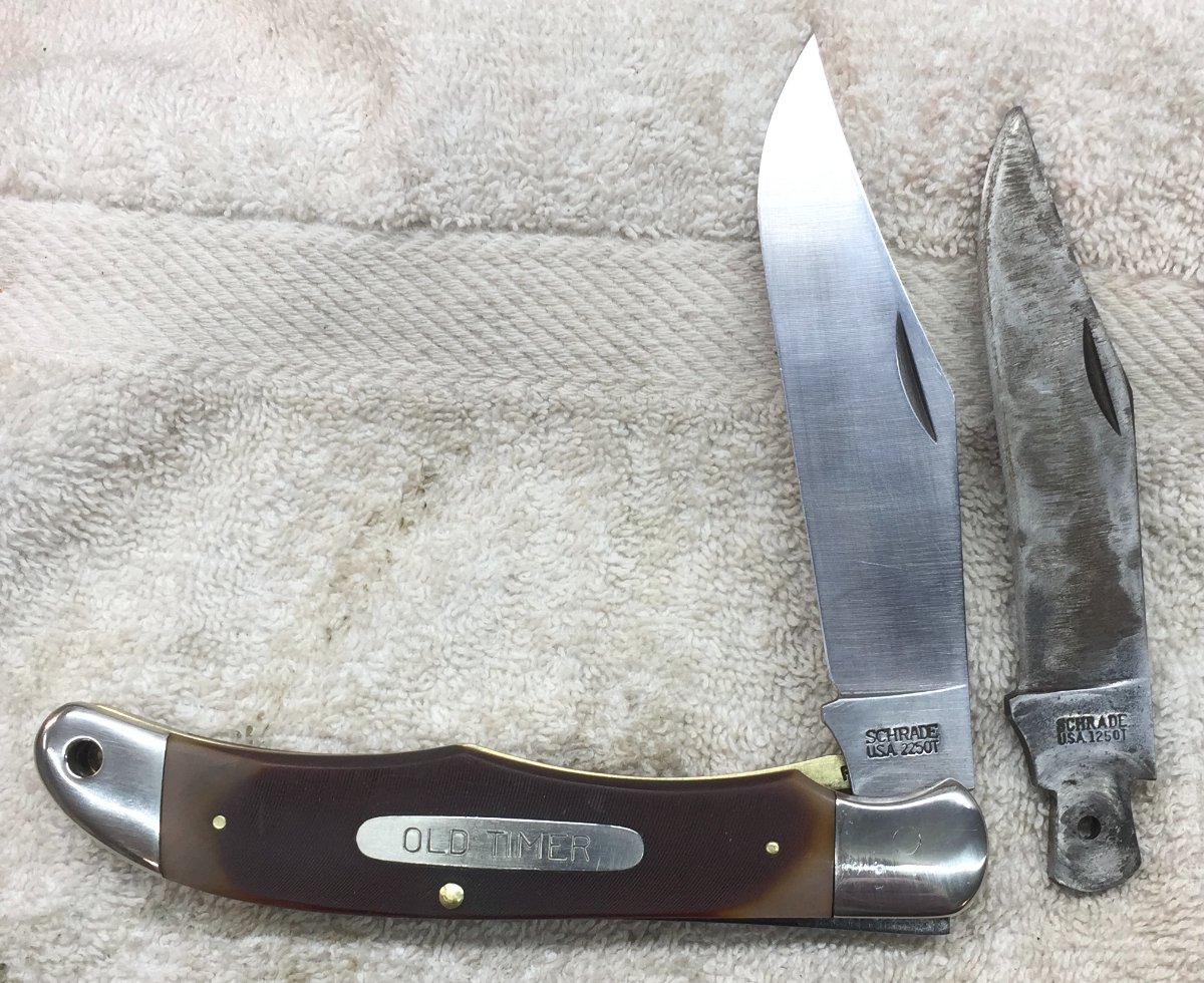

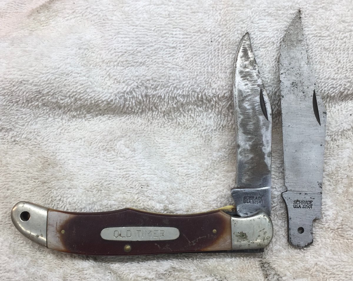

Here is a recent project I just finished. I had this 125OT with a TERRIBLE blade. It has a great spring that gave a beautiful walk and talk.

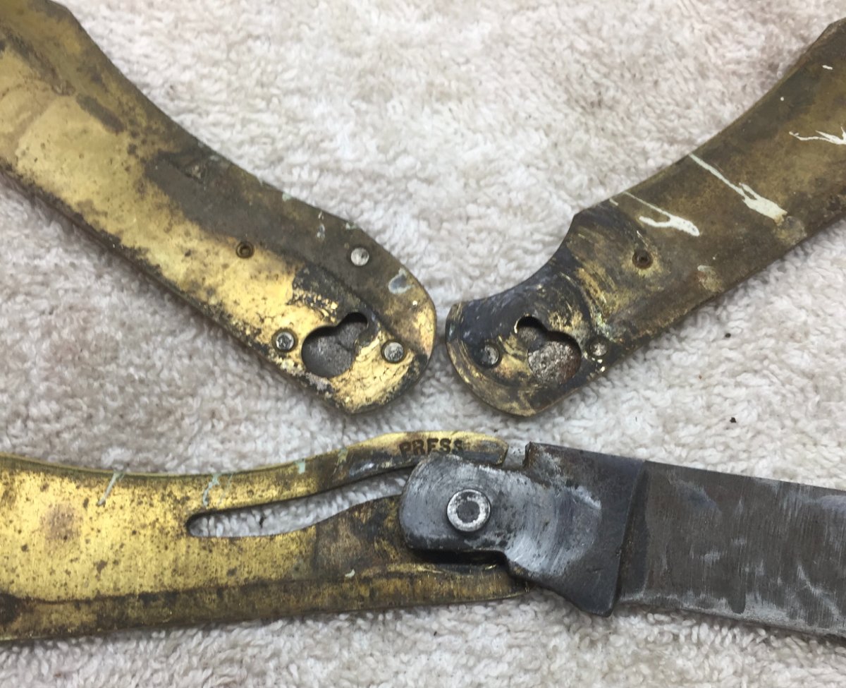

I had a 225OT blade and at first glance.... they look the same.

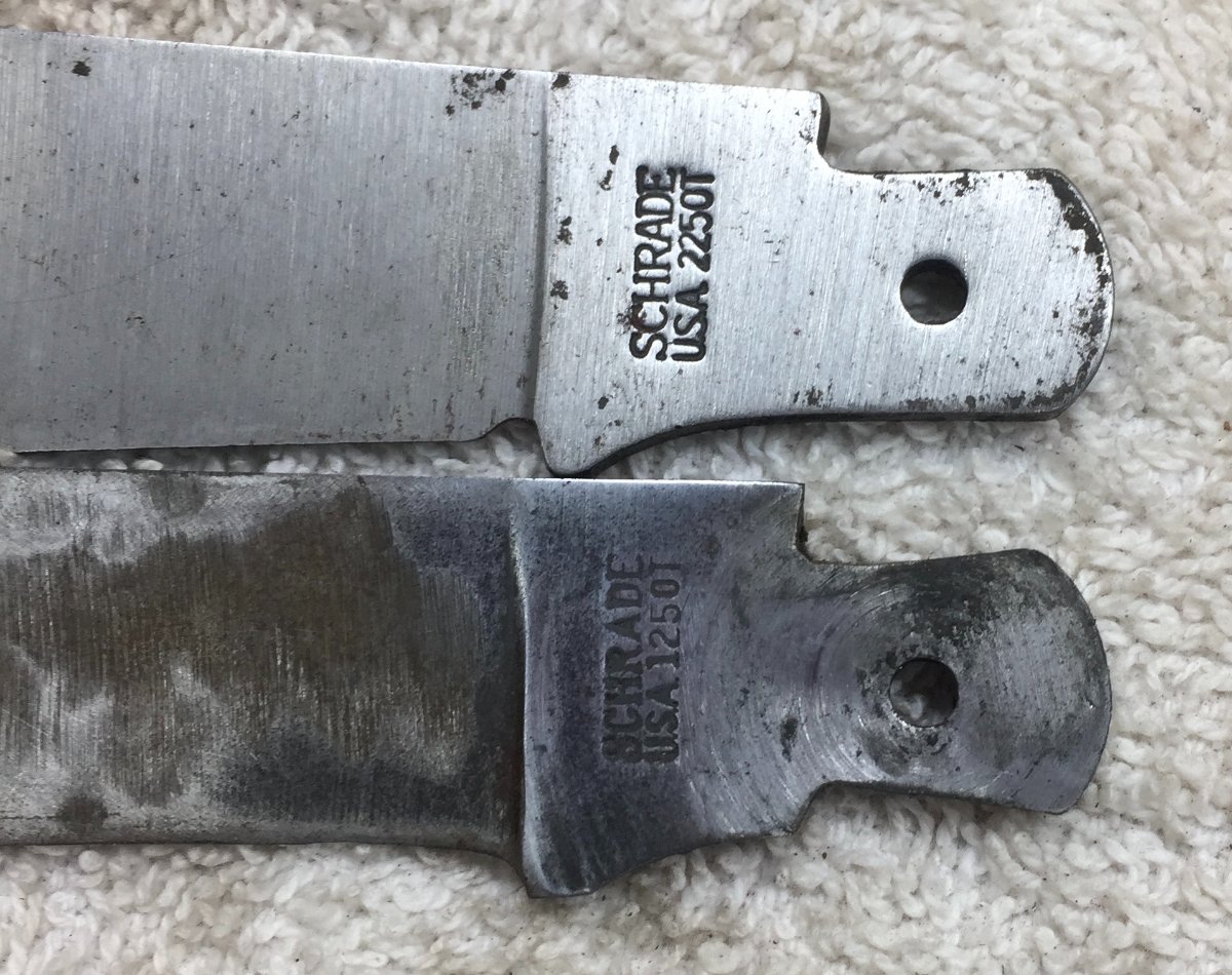

After I got it apart I saw the difference in the blades...... the 125OT blade has a notch for the liner lock to slip into.
(edit)... so I filed the 225OT blade to match the 125OT blade.

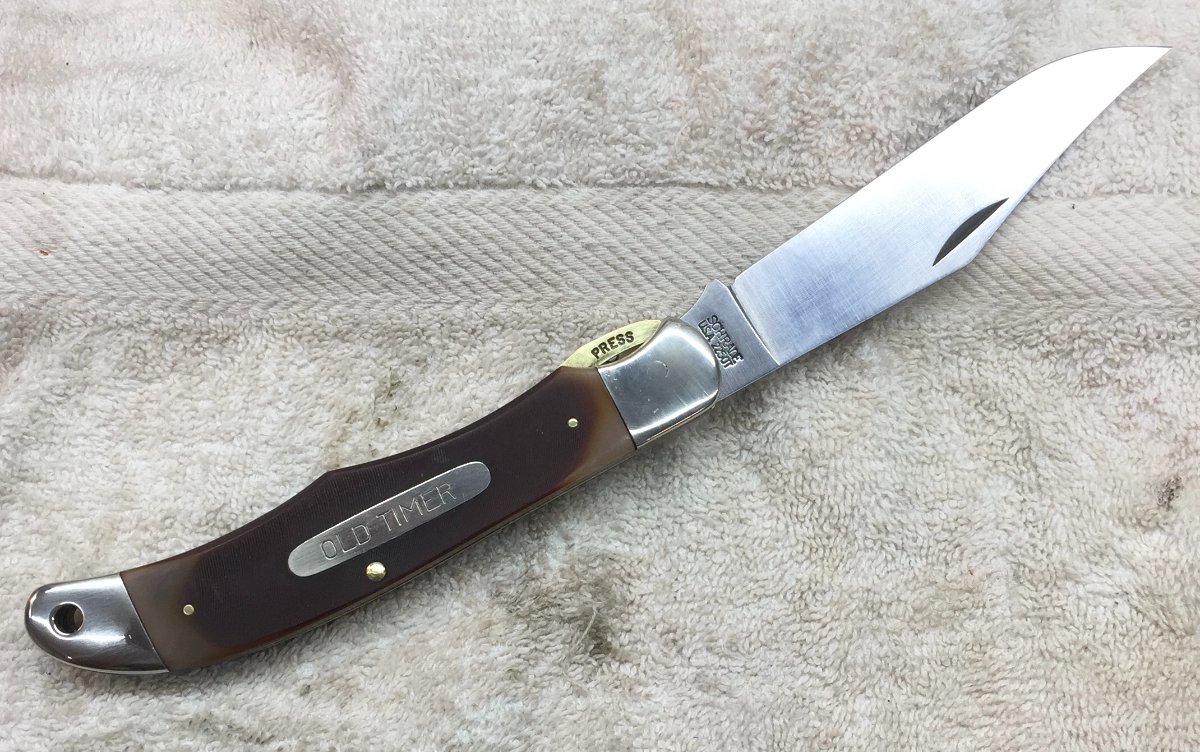

SO.... after a good clean up and reassembly, I once again have a nice Old Timer liner lock knife...(even if the pattern number on the blade is wrong....LOL)

Hongkonger wrote: Thu Oct 06, 2022 11:29 am Does it close up well? Did you have to rework the clip?
Beautiful proportions.
Yes on both accounts.
After I filed the liner lock notch into the 225OT blade, it became EXACTLY like the 125OT blade.
SO.... it folds, walks, talks and performs just like it did when it came from the Schrade factory.
::tu::

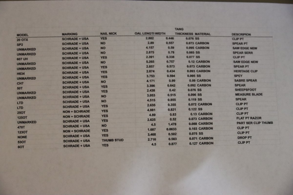

If anyone needs a 125OT I have 1 new one left and 4 25OT left plus 75 or so other models blades all USA made. PM with what you are looking for I just got in 25lbs of USA Schrade blades. Just came in today so still sorting them but here is a partial list
