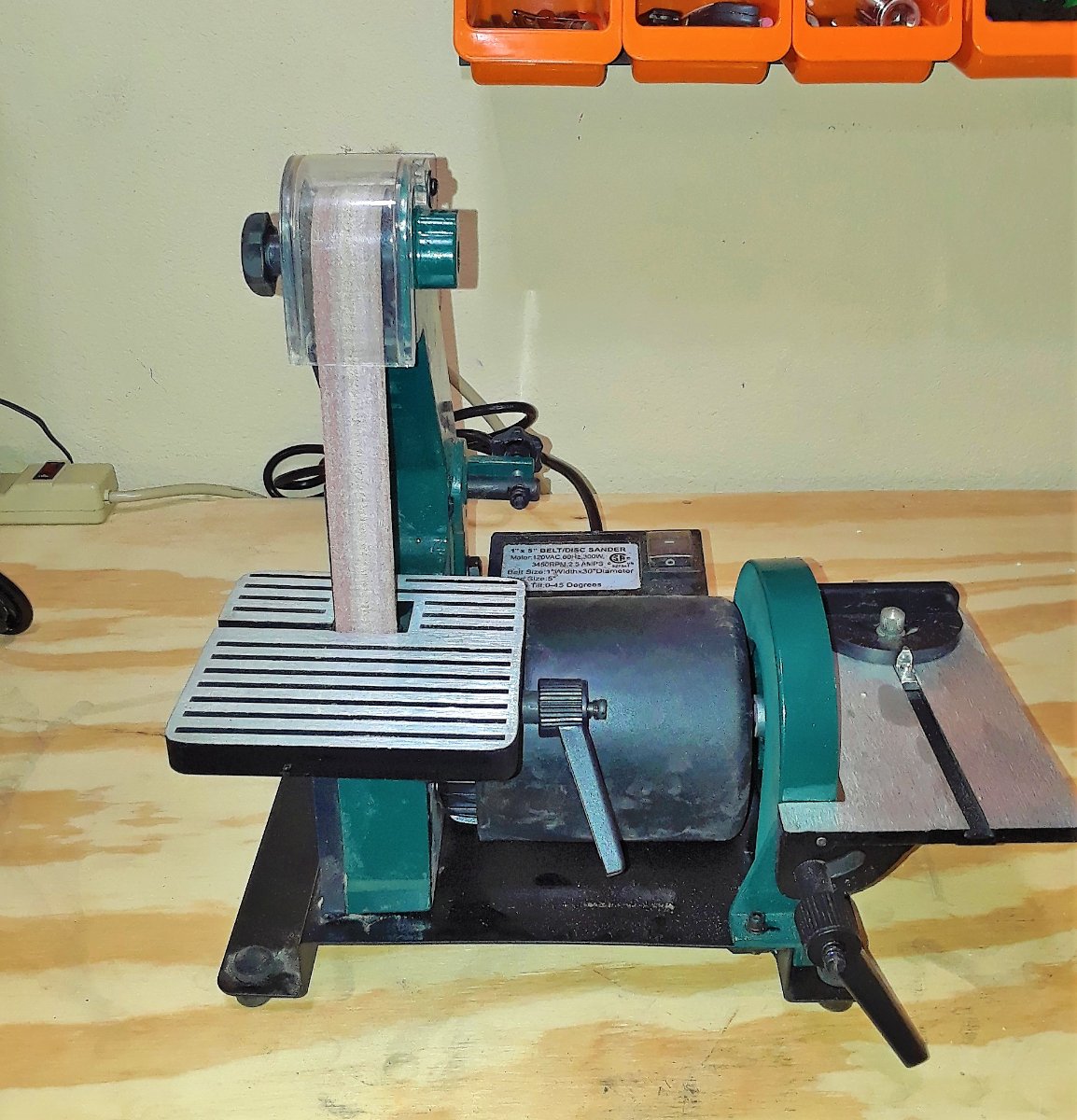

I may be late to the party, but I just discovered "Curry Custom Cutlery" on YouTube, and I am learning a lot from his videos.
I am still using a Harbor Freight 1x30 belt sander, and I love his tips on tuning these up for better performance.
I will probably not upgrade the motor or rollers. I would prefer to spend that money in building a 2x72 someday. But I do plan on tuning mine up just as he shows in this first video:
https://youtu.be/IjZWfEzJjA4

Thank you Reverand for posting that video. That just happens to be the same brand of sander that I have except I also have the disc sander on the end....

It all sounds logical about the tensioner however with mine loosened to slide freely, the tensioner bounces back and forth against the spring causing bad vibrations in the whole unit causing it to move around on the table despite the rubber feet. I'm sure this is caused by the main drive wheel being out of round and causing the rapid pulsing/ vibrations in the tensioner wheel. The only way to stop the horrible vibration was to tighten the tensioner bolt. Then the grinder runs smoothly but it is more difficult to change belts.Reverand wrote: ↑Wed Sep 21, 2022 1:09 pm I may be late to the party, but I just discovered "Curry Custom Cutlery" on YouTube, and I am learning a lot from his videos.
