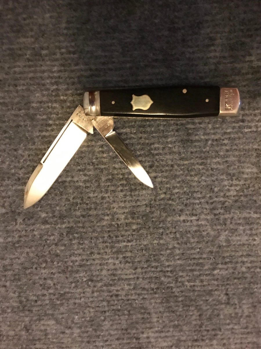

old KK small ding. Harold

I can't help with your question Harold, but that sure is a nice knife. Could we please see some pictures with the blade/s open? Thx! 8)

Yes not very good pictures. I had this for years. It has been posted before. Harold

Looks like a nice crown jack, I have it's brother in bone. Regarding your dilemma, I'd just leave it as is. No real way to repair it without it being noticeable and I and many others would rather see original with a small imperfection than seeing a repair.

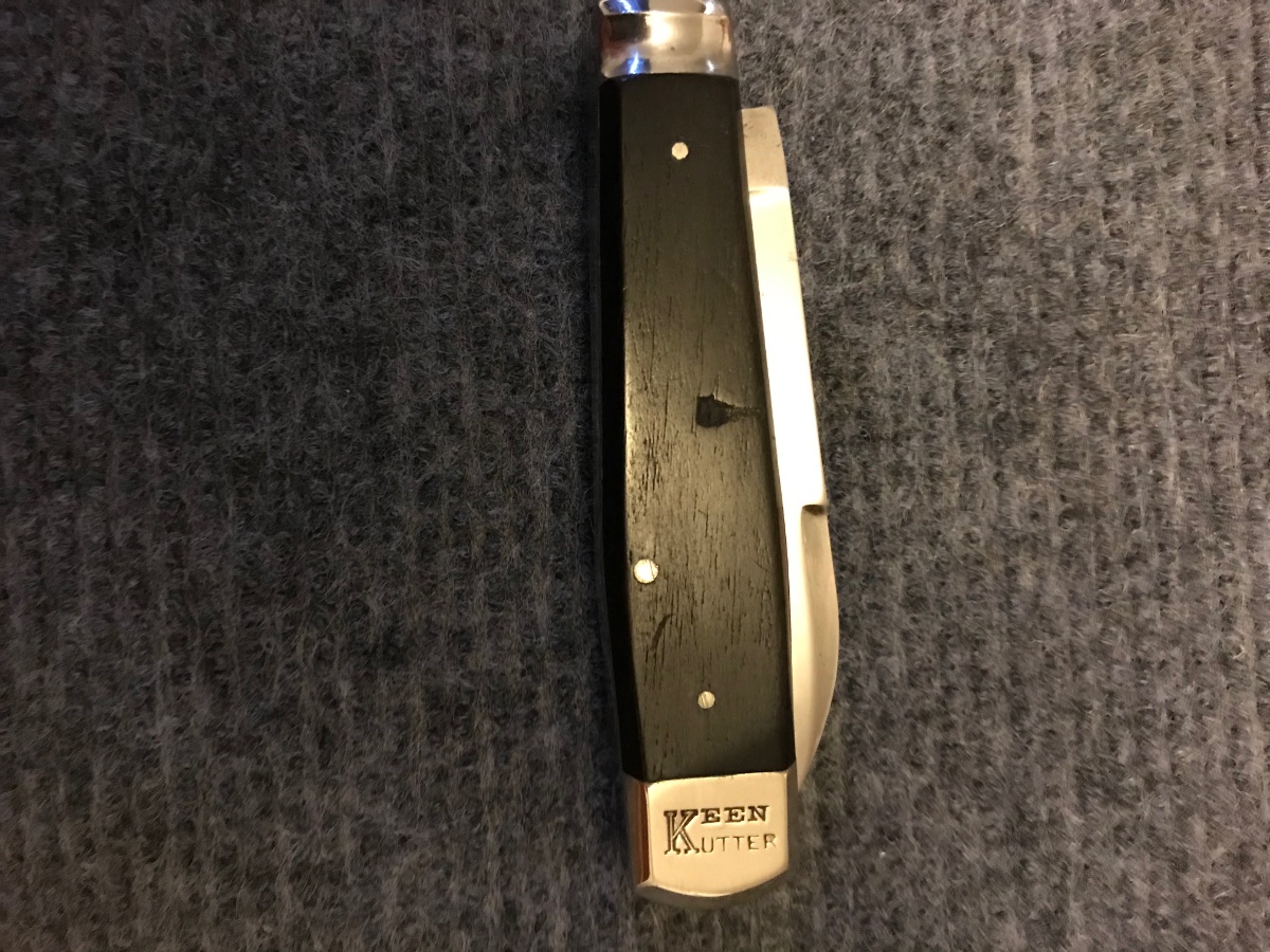

I do agree with Gene. However, if it bothers you that much, you could take some 2-part epoxy and mix in some ebony dust. You'd have to sand it down properly, and you would probably still see the fix.

The wood can probably be swelled back in to position.
Soak a drop of water into the ding, then use the corner of a damp washcloth over the ding.
Place a hot soldering iron on the washcloth until it steams. Check the wood. Repeat until the wood is swollen back in place-or as swollen as it will get.
Wait a few days until it's dry and file sand the raised wood back down.
