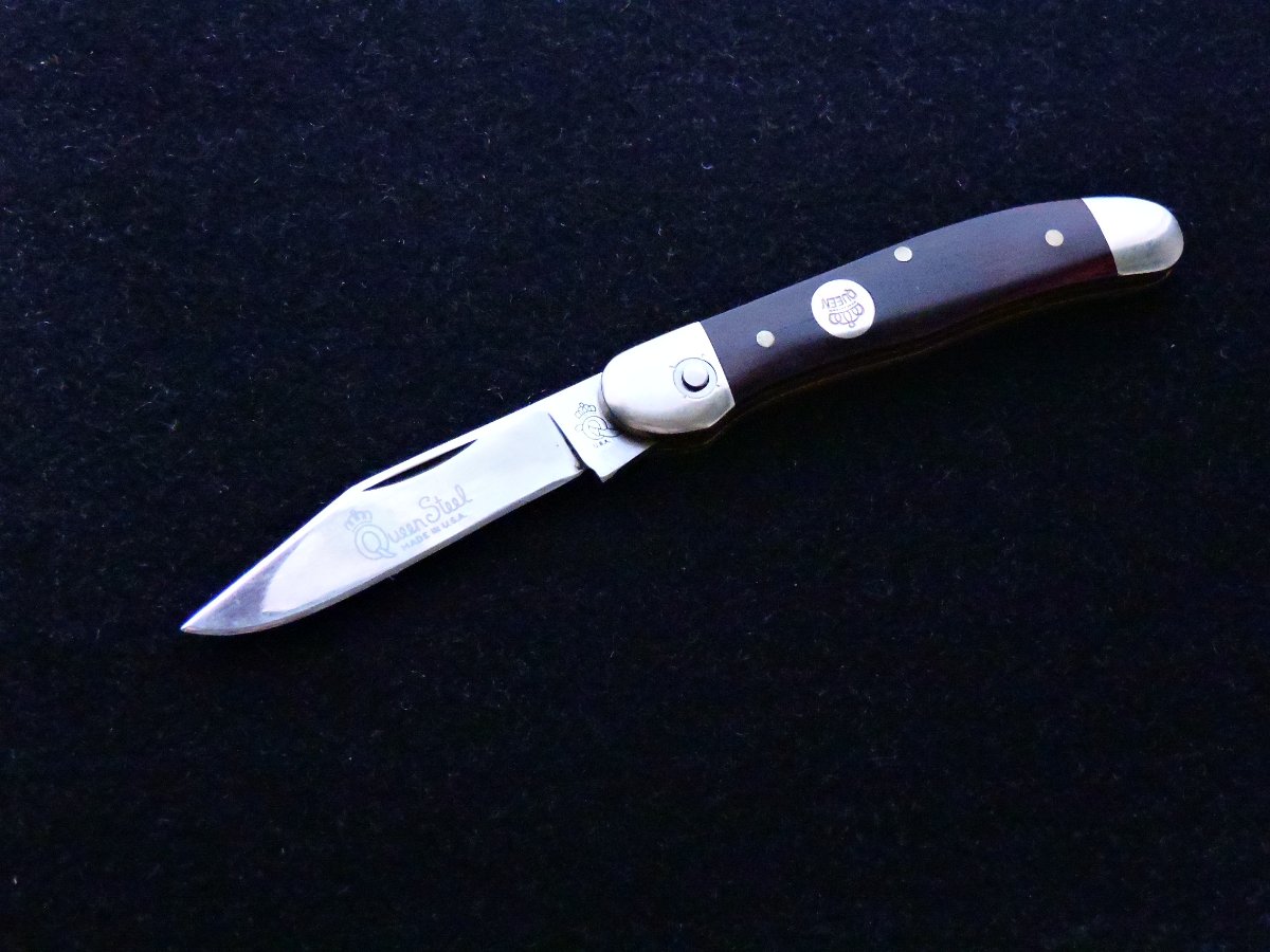

Re: How do I open this Boker knife?
Post by FRJ »
This Queen jack is something someone might mistake for a switch.
Of course it has the nail nick, but it locks open and the button must be pushed to close the blade.
I've never seen another like it. 3 3/4".

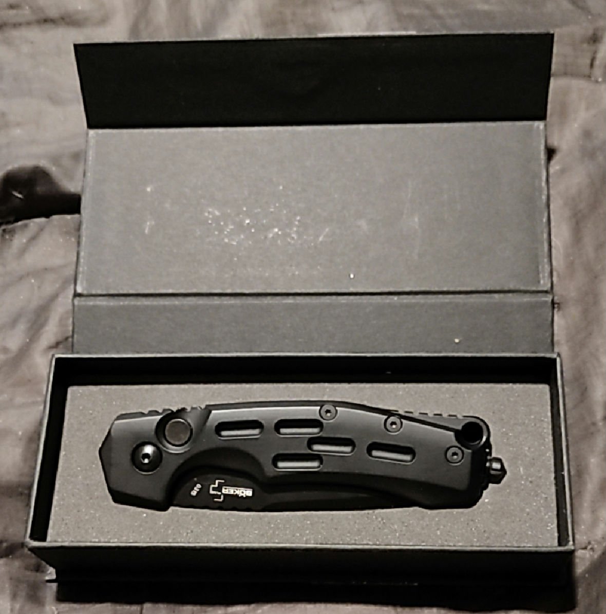

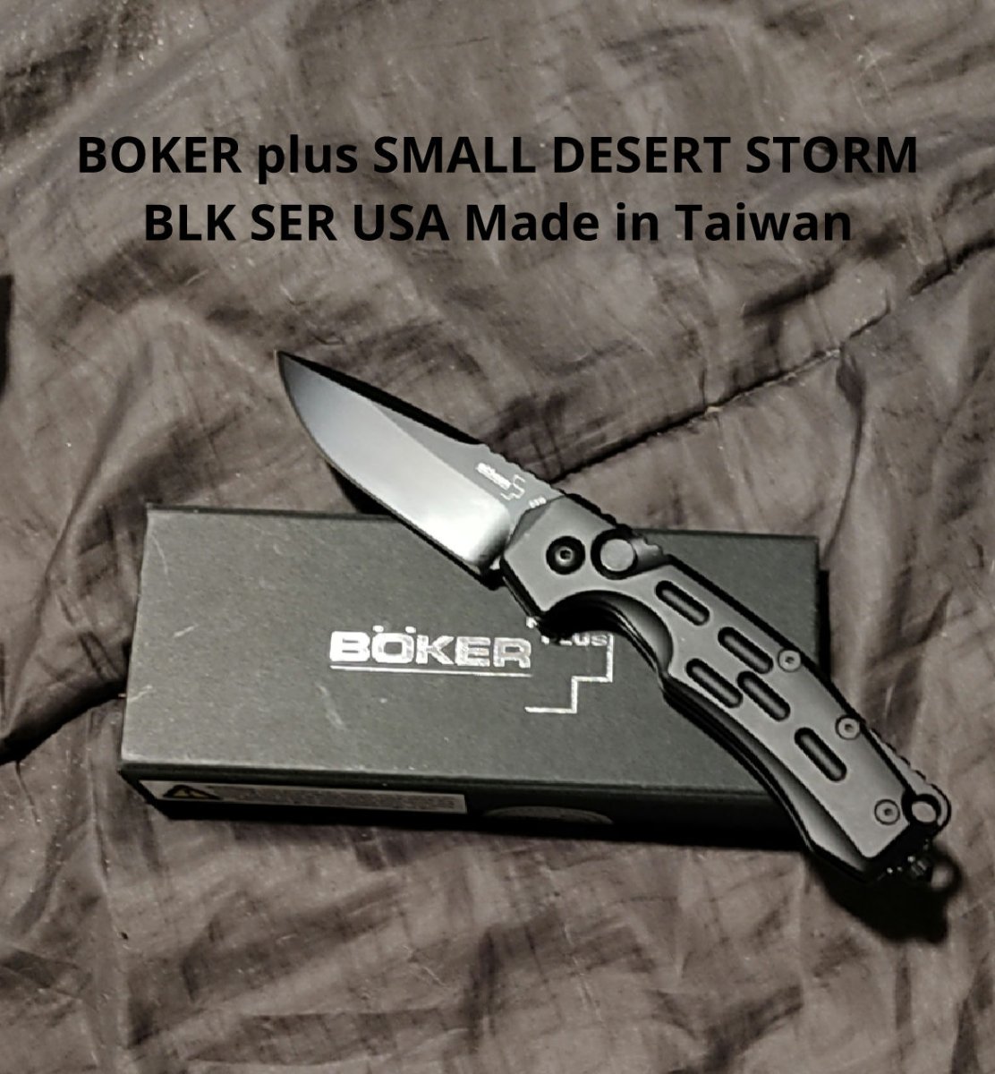

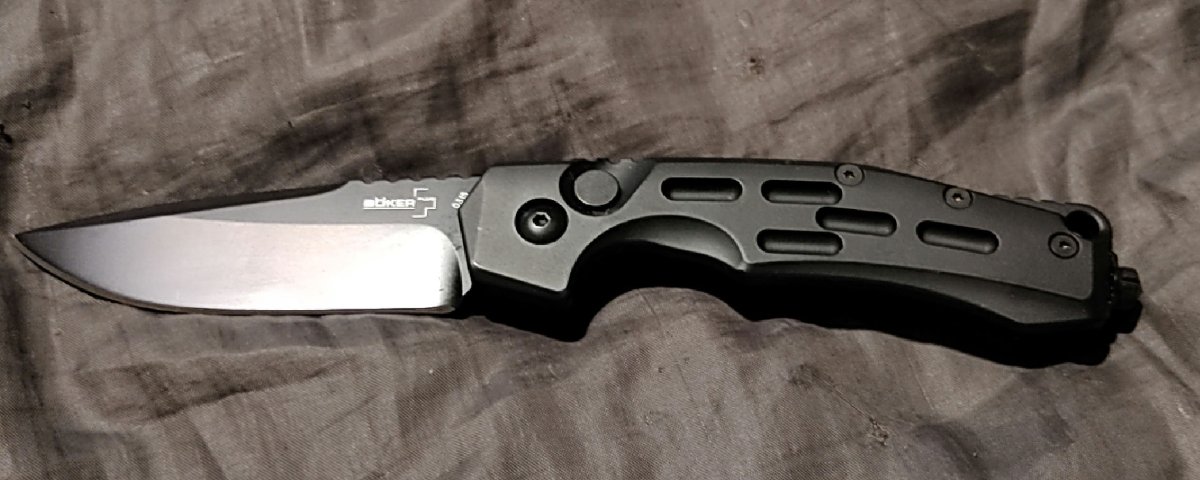

abricru
Posts: 2
Joined: Fri Jun 03, 2022 2:55 am
Post by abricru »
I took a pictures of it. You have to press the button to open, but it takes a good bit of pulling to get the blade out. I love the way it looks, but it's not what I was expecting. Thanks for all the help.
Post by ea42 »
Blade HQ mentions that knife as being the Desert Storm in their description but I believe it's actually the Thunderstorm, Like Samb mentioned above they're auto-ready but off the shelf from Boker they're manual open.
These might work if you want to try the conversion yourself. If the blade already has a hole for the spring it should be an easy conversion:
https://bladeops.com/replacement-spring ... to-2-pack/
These would also work but they seem to be out of stock:
A video:
https://www.youtube.com/watch?v=71Z0Wpn1TVE
Eric
Post by C-WADE7 »
If it is hard to open manually also, the screw at the blade pivot may be over tightened causing it to drag/bind. It looks like a Allen head(back side is likely the same) try to loosen it ever so slightly.
Post by ea42 »
C-WADE7 wrote: Sat Jun 04, 2022 1:07 pm If it is hard to open manually also, the screw at the blade pivot may be over tightened causing it to drag/bind. It looks like a Allen head(back side is likely the same) try to loosen it ever so slightly.
I think those are Torx screws.
Eric
C-WADE7
Posts: 1875
Post by C-WADE7 »
ea42 wrote: Sat Jun 04, 2022 3:17 pm
Eric
Hard to say, middle pic didn’t look like it had the torx points, either way I recommend loosening them.
