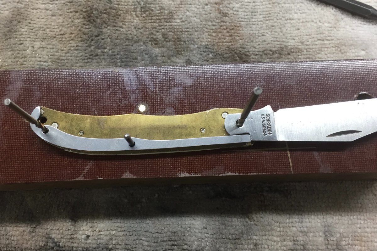

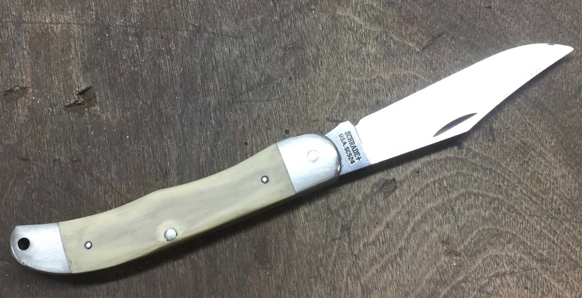

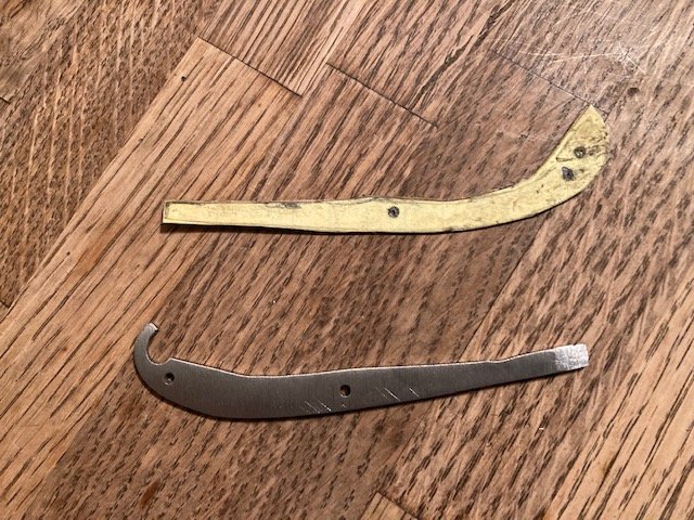

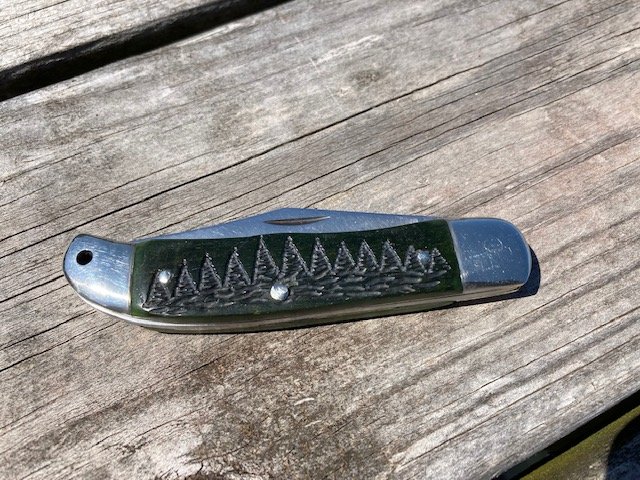

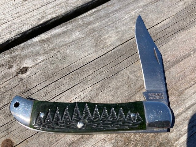

I am going to blame Jeff and Mike for this build. They got me fired up with Jeff's 123ot and Mikes Statue of Liberty builds. I went on eBay and purchased a Schrade SC524 blade and liners. I made a spring out of a lawn mower blade and put this together. I still have to buff it out and sharpen the blade but it's a prototype I had to take it apart several times to fit the spring. Now that I have a template for the spring, I can improve the handles.With all the great ideas I get from all the knife builders I can't stop ::dang:: ::dang::
Thank for looking
Nev

Great job on a great pattern!

The 123's and the 524's seem to go for a premium when they show up on E-Bay. Blades and handles are still available from a couple of sources but the springs aren't. Making one is a great solution.
Jeff

Great job ! I had thought about old mower blade for spring material but hadn’t tried it . Thanks for that !

Rdubya21 wrote: Sun Apr 17, 2022 12:27 pm Great job ! I had thought about old mower blade for spring material but hadn’t tried it . Thanks for that !
Rdubya21
I tried 01 steel for a 125ot. But after 3 attempts I could not get the heat treat correct. So I had used a mower blade before and it worked with out heat treat. So I tried it again. Best thing is to find a old blade in the same thickness you need. I used a blade off a 60'' tractor deck it was thick. It took me some time to grind it to the correct thickness. Grind and cool grind and cool. ::dang:: Save yourself some time.
Hope that helps. ::handshake::
Nev

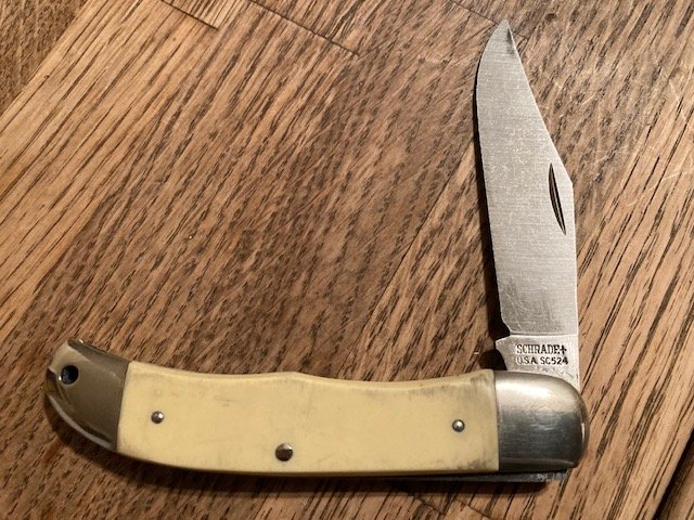

I took the spring out of the china knife and YES... it does fit.
I put this one together this afternoon. I have more finish work BUT.... the spring sure seems to fit well.

Meridian_Mike wrote: Sun Apr 17, 2022 11:41 pm Nev....
:D
Thanks for the information. The seller of the knife parts said a China 123ot would not work. So now we know. I will keep a look out for junk China 123ots
Nev

Nev52 wrote: Mon Apr 18, 2022 11:44 am
Nev
They are out there.... a dime a dozen.
They usually range in the $18 neighborhood..... shipped!

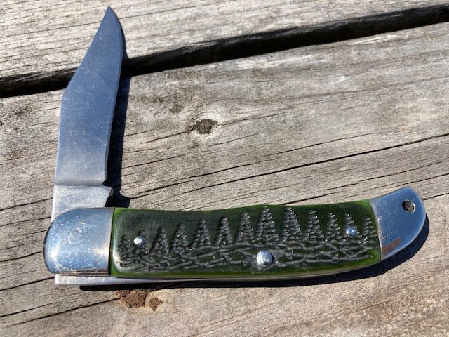

Since I got the knife done and all the bugs out of making a spring. I decided to rehandle it in bone. Only one small issue I cracked it at the rocker pin ::dang:: But I think it looks alright.
Nev

I always liked that hunter green tree jig, but never did anything with the set I had. Looks cool!

Post by Reverand »
That looks great!
And knowing that you made the spring is really cool.

Meridian_Mike
Posts: 5041
Location: Mississippi
Re: Schrade Sc524
Post by Meridian_Mike »
VERY nice!
I like that jigging pattern!
Beautiful work!

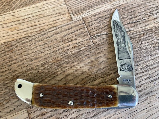

I got the idea of this from Meridian Mike ::hmm:: Statue of Liberty Schrade. I used Bourbon Aberdeen bone handles from Culpepper.Not really the pop I expected but it turned out ok.
Just thought I would share.
Nev

Re: Schrade Sc524
Post by glennbad »
Nev52 wrote: Fri Apr 22, 2022 12:44 pm I got the idea of this from Meridian Mike ::hmm:: Statue of Liberty Schrade. I used Bourbon Aberdeen bone handles from Culpepper.Not really the pop I expected but it turned out ok.
Looks pretty darn nice to me!

glennbad wrote: Fri Apr 22, 2022 1:02 pm
Me as well.

Meridian_Mike
Posts: 5041
Re: Schrade Sc524
Nice work Nev!
I like your version of the Statue of Liberty knife!
