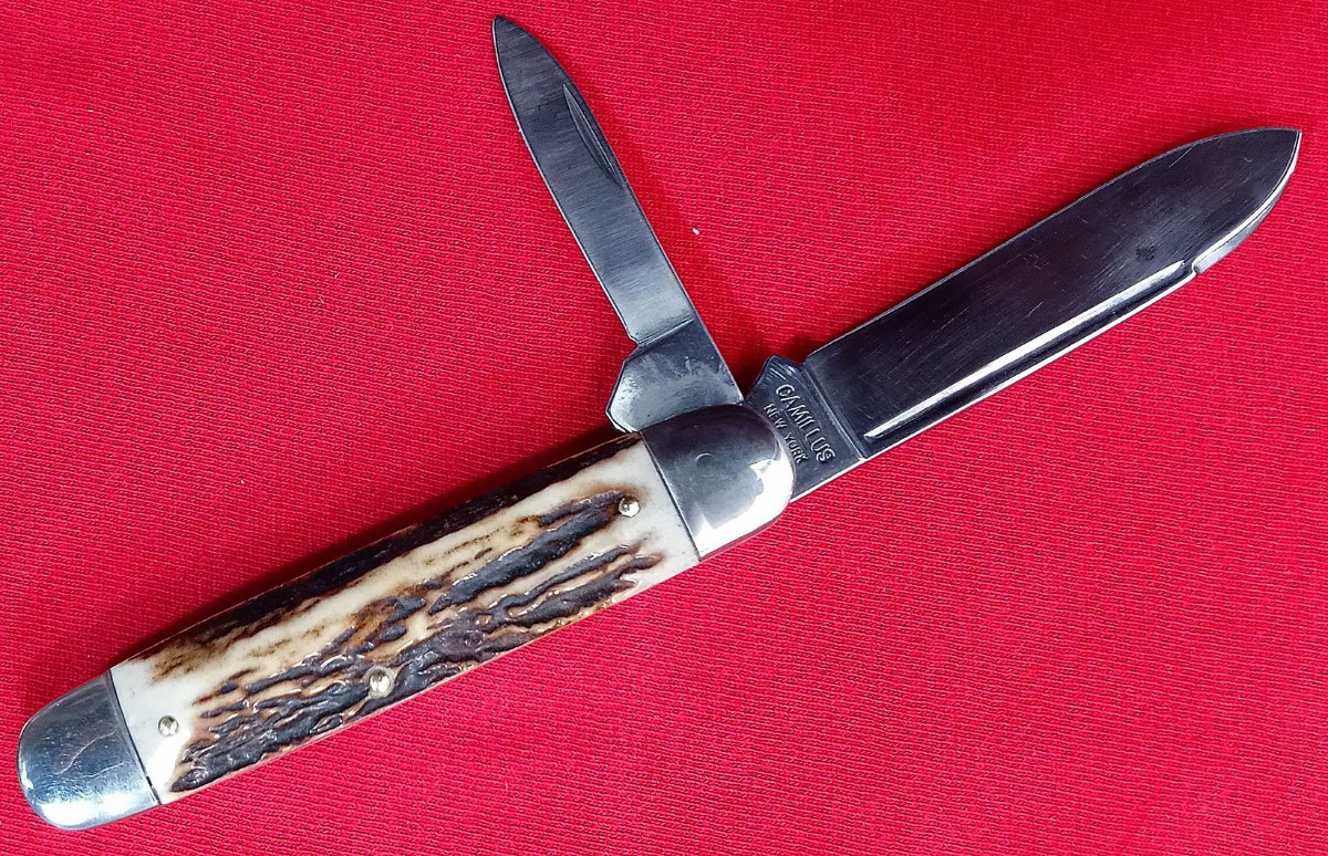

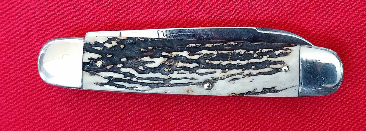

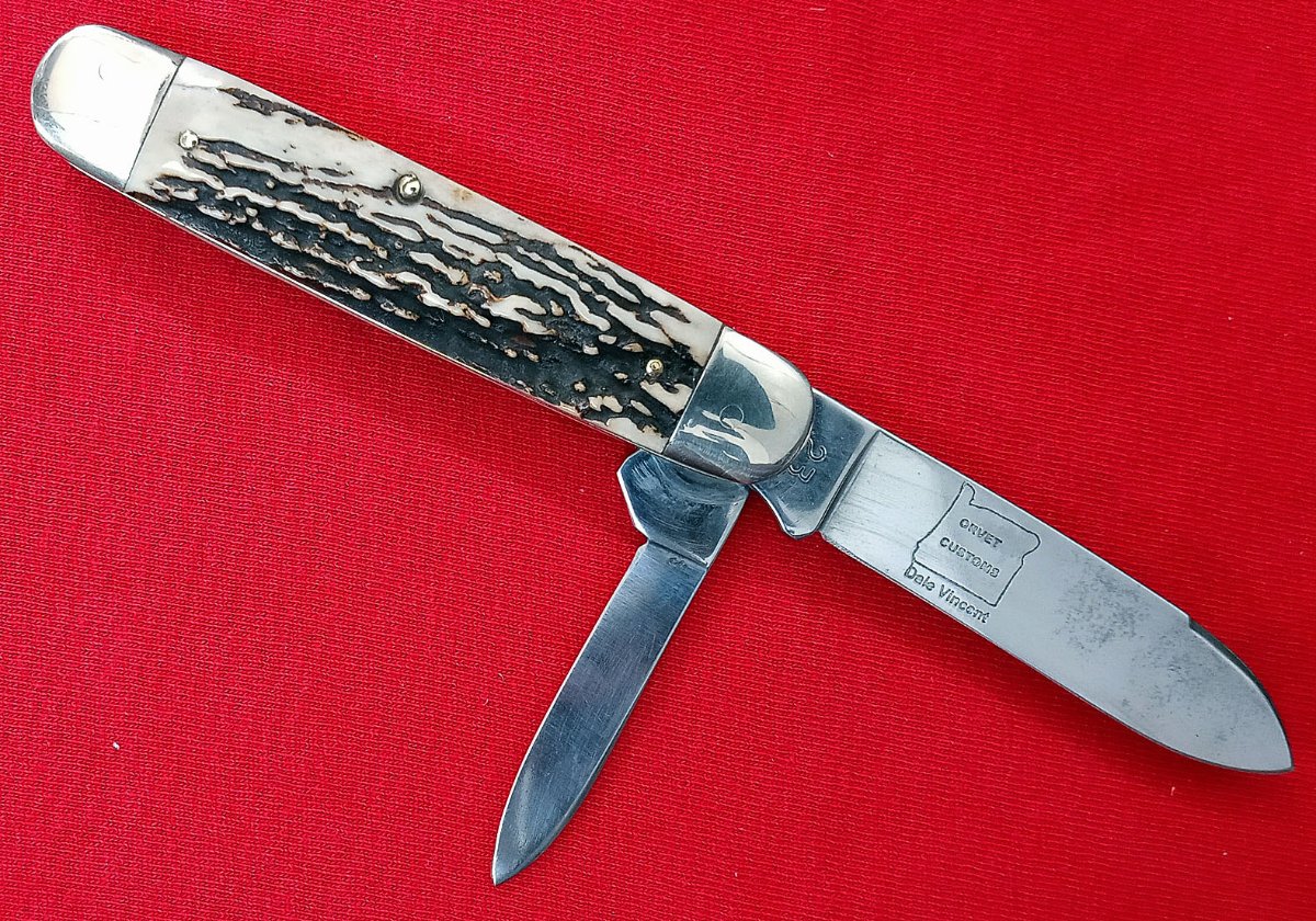

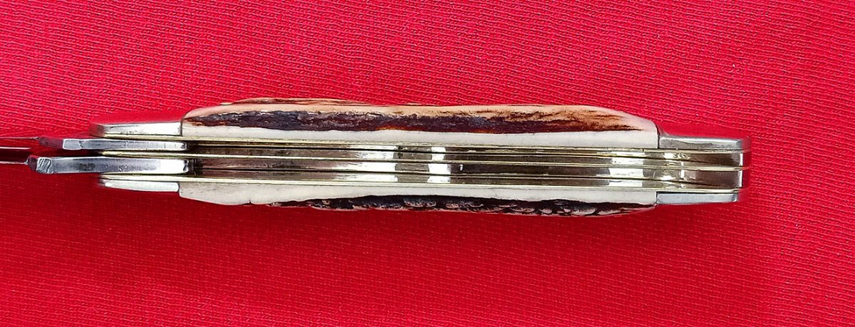

Camillus called their #23 a "Large Equal End Jack." The first listing I see a bit is in the 1946 catalog and it may well have been manufactured prior to the war as well. Most of these that I have seen have advertising on them and have handles made of French ivory celluloid. French ivory celluloid seems to be a bit more stable than some of the other celluloid patterns I have seen, but I have encountered a number of knives with French ivory handles that are well into the offgassing process. This particular handle was beginning to shrink and I knew it was not long for this world given its current state.
I took the knife apart and removed the handles, cleaned and polished the inside of the knife then reassembled it with sandbar stag.
Kind of a basic re-handle, but I like the results!

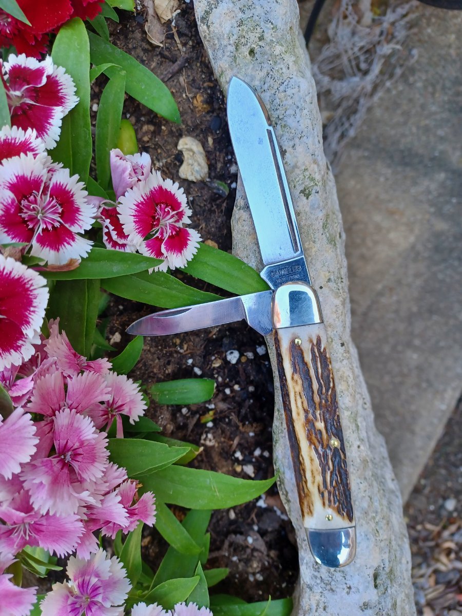

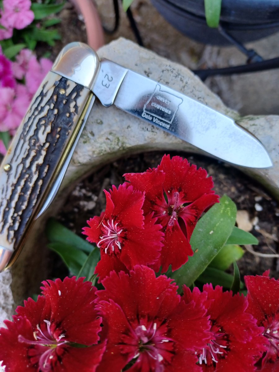

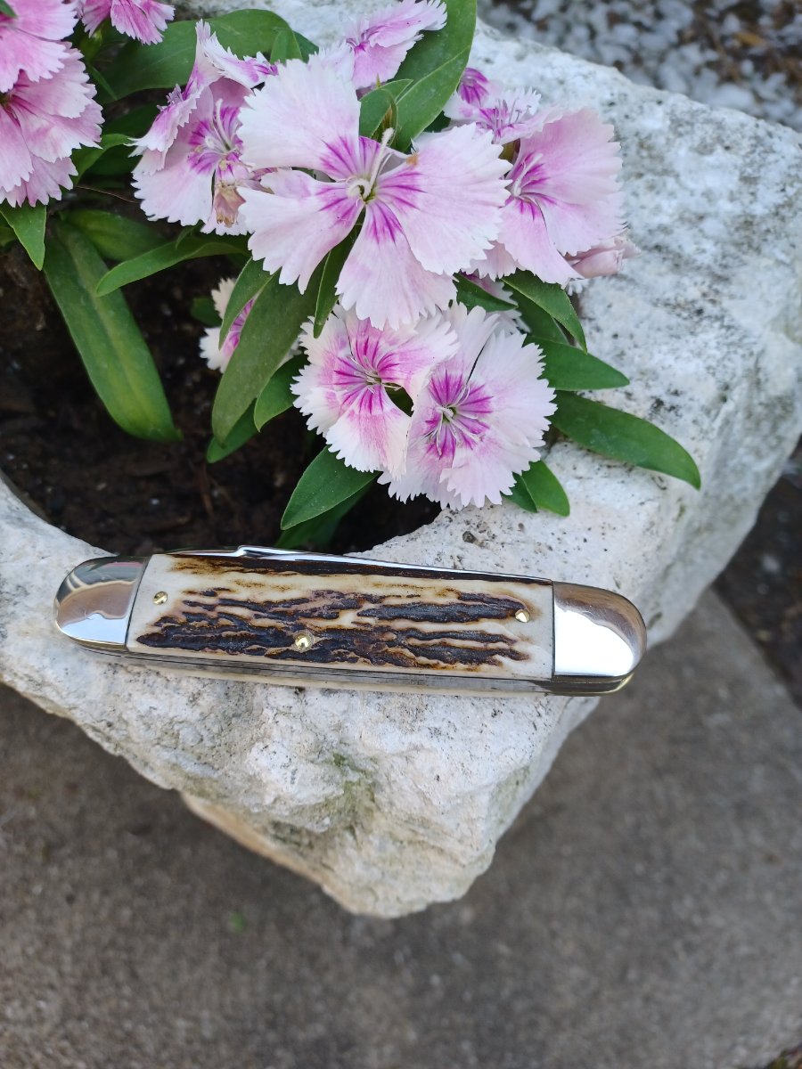

I was fortunate enough to purchase this knife from Dale. He did a great job on it. I received it yesterday and here are a few fresh pics.

MAN.... I like the photography you have done.
The background really sets off the beauty of the knife!

My goodness doglegg. A very fine knife; very fine photos. A great combination.

Thank Mike, QS, Philip. Dale's work and my wife's flowers and I get to enjoy both. ::handshake::
