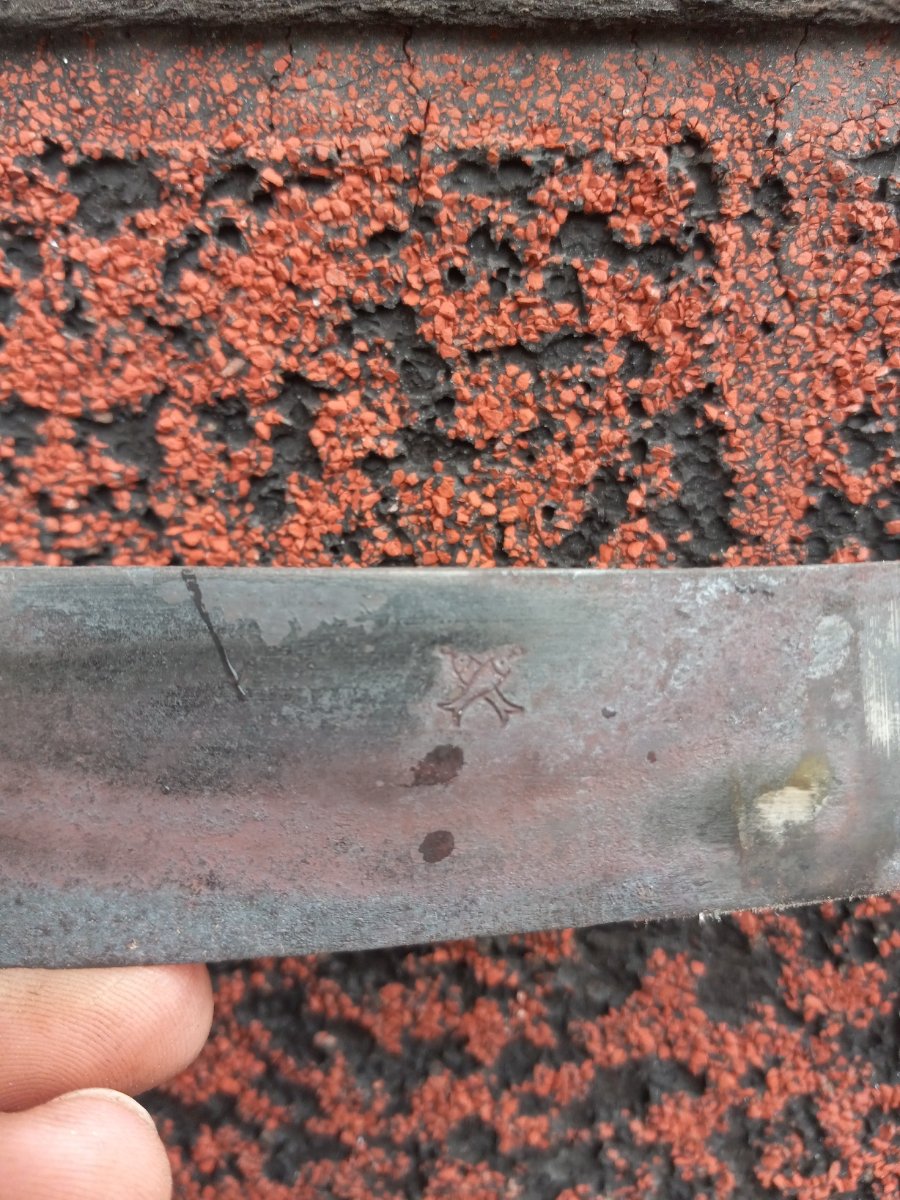

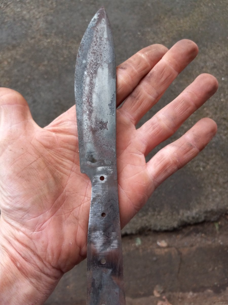

I have a knife in my shop that survived a fire. Has some sentimental value to the owner so We are trying to see if we can salvage it. There is a makers mark on it of 2 crossed fish. It's believed to be commercially made . Does anyone know the maker with a crossed fish stamp?

Per Goin's
Joseph Allen & Sons, Sheffield England c1864-1953
used the symbol of 2 crossed fish in 1880 and manufactured "Bowie" type knives
Hope that helps
Hope that helps

Interesting. Thanks all! I'm told this knife had stag handles and it had copper pins that I cut off it when it arrived in my shop.

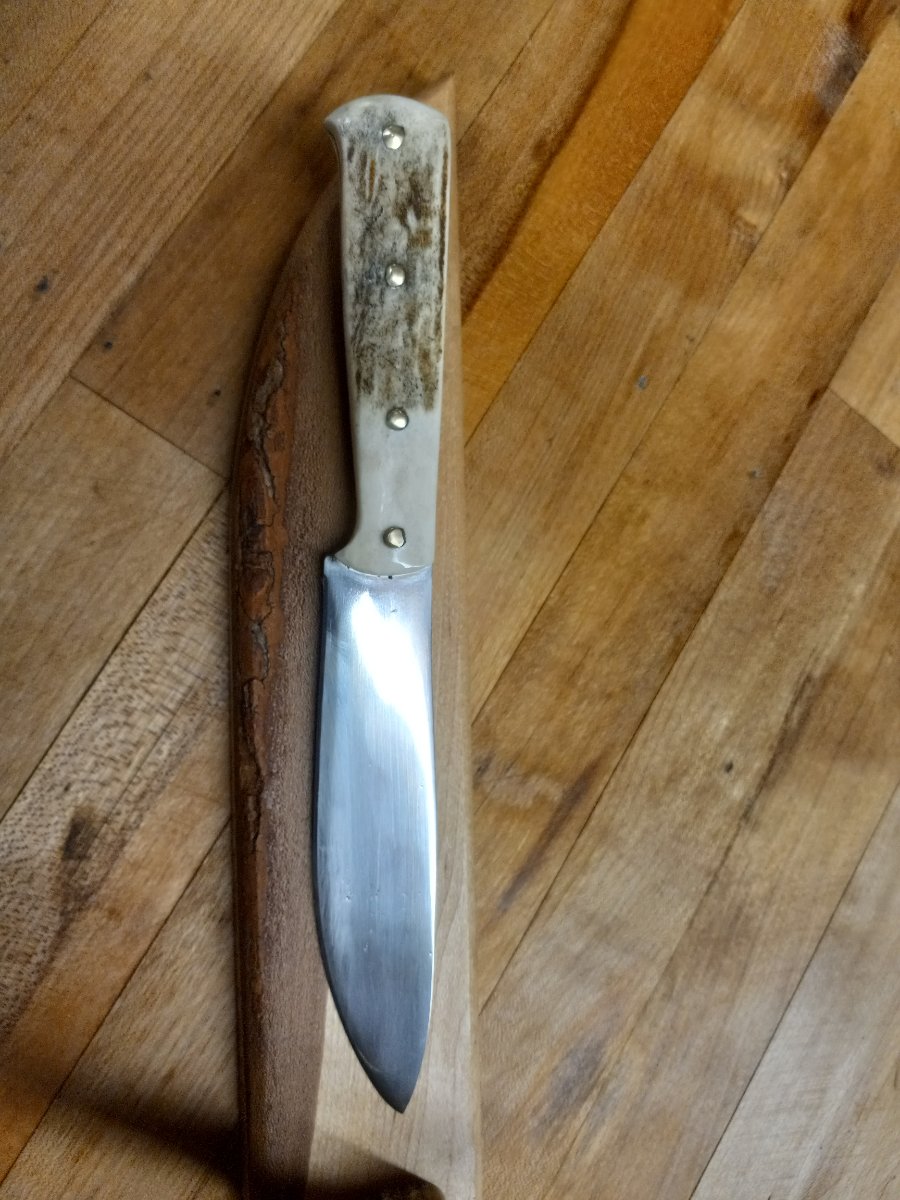

Rossr
- Posts: 575
- Joined: Sat Feb 22, 2020 12:08 pm
Re: Anyone familiar with a crossed fish symbol knife maker

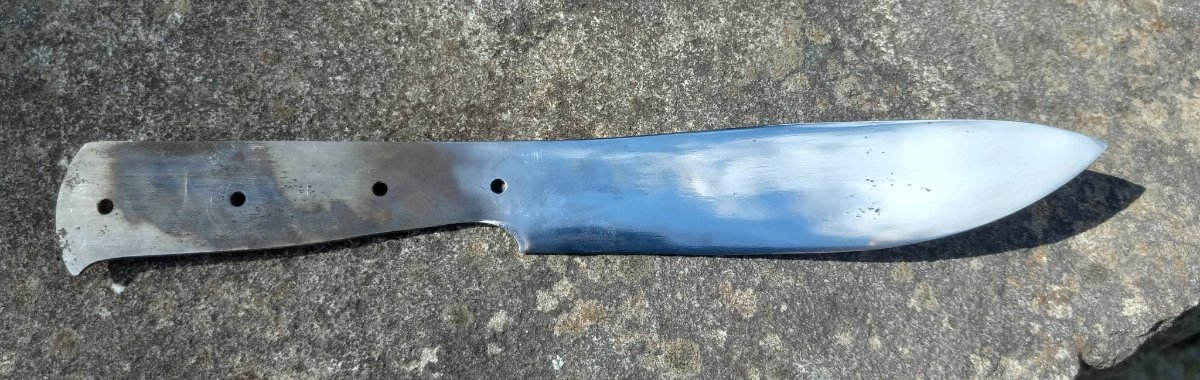

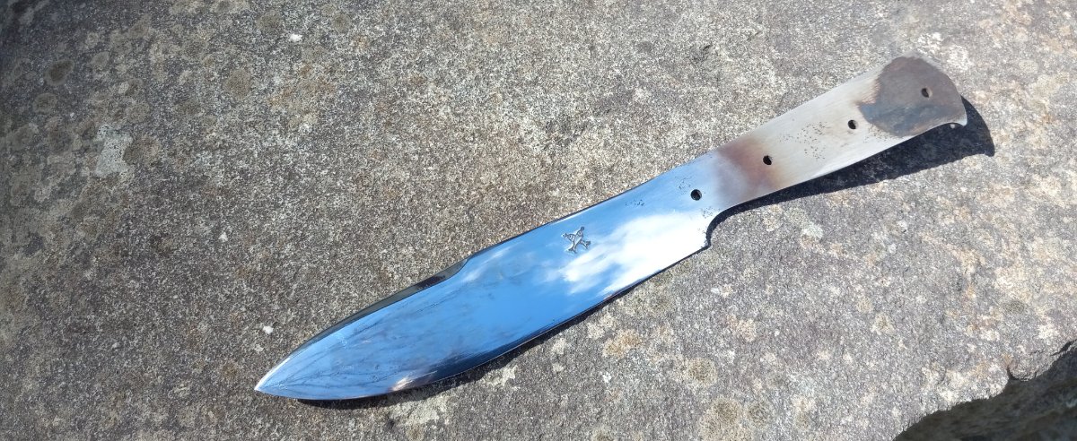

Thought I'd post some progress shots. I was able to reheatreat the blade and it came out functional, passed rhe brass rod test meaning I could slide it over a brass rod and the metal deflects and goes back in place and doesn't chip. It's a carbon steel of some type. Cleaned up well imo, some small pitting left but I didn't dare grind more off so I didn't lose the blade all together.
Just needs handles now and it's done.
Ross
Ross

- Jeffinn
- Posts: 2091
- Joined: Fri Nov 10, 2017 3:16 am
- Location: Roseville, Mi
That cleaned up nice!

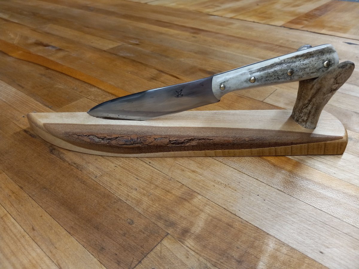

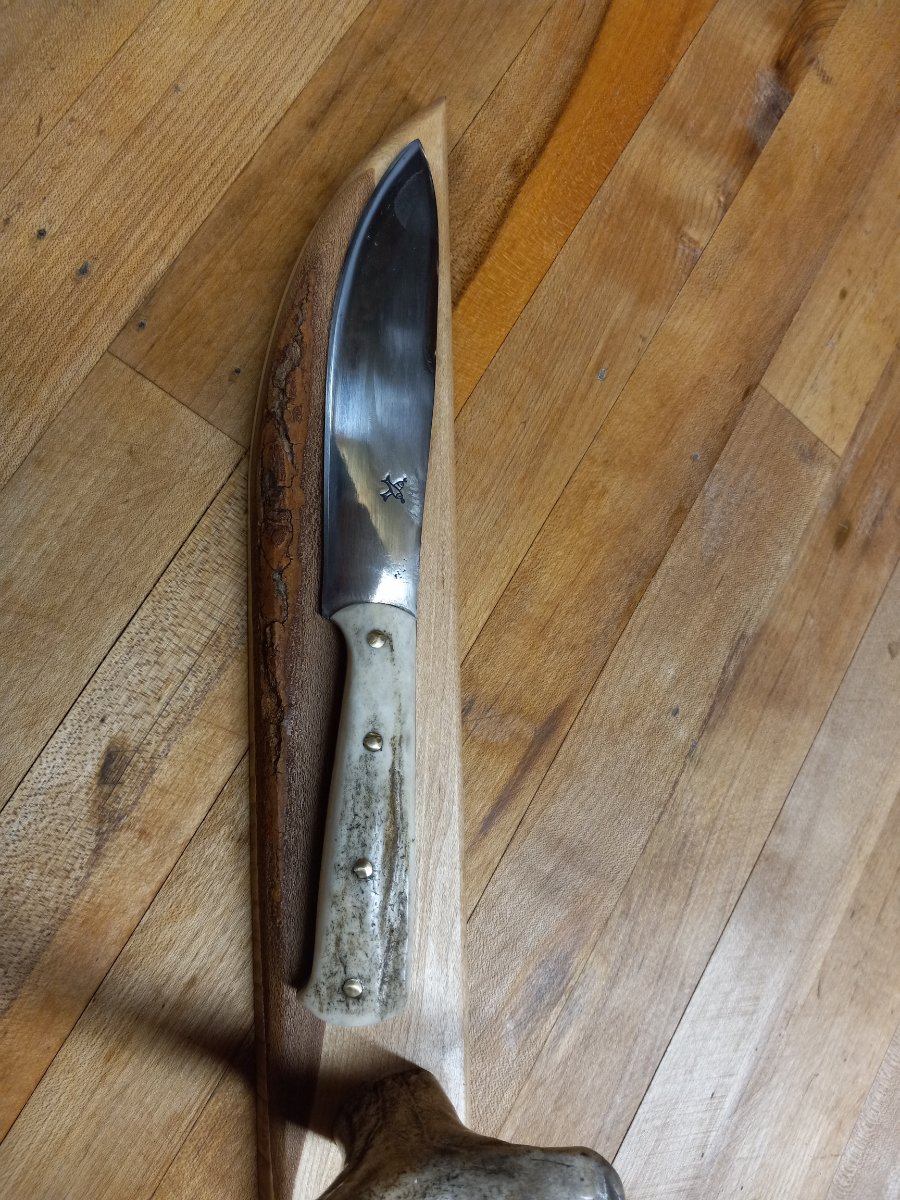

Rossr
- Posts: 575

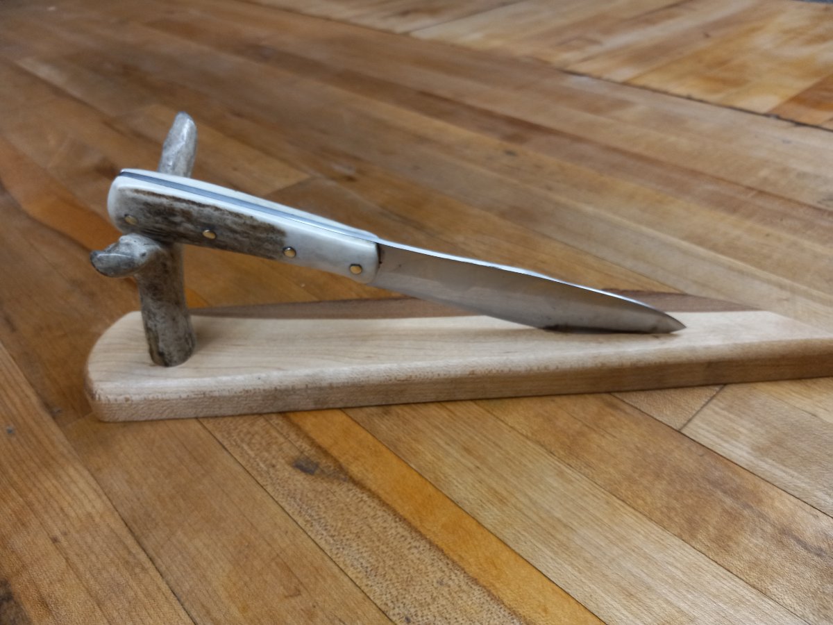

Finally got some scales on this one. Here is the finished product

- bighomer
- Posts: 10792
- Location: N.mid.Tn.
My goodness gracious that's a fine job, gorgeous knife that's a great save, thanks for posting the follow up.
x1000.
rustyoldknife
- Posts: 796
- Joined: Wed Feb 20, 2019 6:07 pm
- Location: SE Pennsylvania
Beautiful Job, that is a fantastic save, and great looking knife
Rossr
- Posts: 575
Thank you the customer was very happy too.
