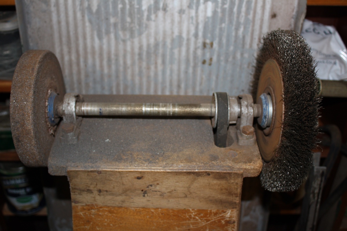

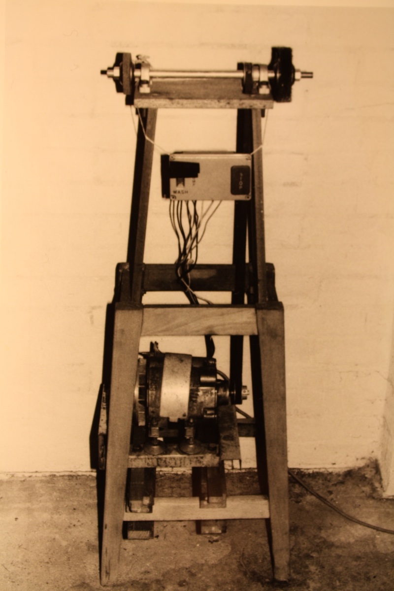

I made my own power grinder and wire wheel nearly forty years ago. The photograph shows it under construction, a Picador shaft driven by a Hoover single tub washing machine motor. The frame is a wooden stool with the top built up. The sides were clad with plywood. It is now fitted with an 8'' wire wheel and 6'' abrasive wheel. There are no guards but neither has the work on a lathe. With some things one has to be careful. I wear glasses so always have eye protection. The wire wheel has ben well used so the ends of the wires are not a sharp as they once were, making it less aggressive. The shaft was geared to run moderately slowly so as to be certain not to drive the stone above its maximum safe rotation speed. Commercially made bench grinders run too fast for my liking. One has more control with slower revolving stones.
The wiring of the washing machine motor was complicated so while being removed it was kept connected to its switch panel. The 'On' switch was up to work the wringer and down to work the tub paddle wheel. I use the tub option! Conveniently the switch panel incorporates a large red stop button. Considering this motor had already had a life in a washing machine it has lasted remarkably well. The V drive belt, a car fan belt, has never needed its tension adjusting. When first fitted it was done with packing under the motor.
This grinder was originally made to clean the mitres of 3/16inch angle iron for welding, when making a road trailer. The angle iron was from old bed frames. In turn the trailer is used to move reclaimed materials. Recycled materials being used to recycle materials, a philosophy that leaves money for collecting. It is something one sees in the developing world. For example, ship breaking at Gdani Beach in Pakistan is done with equipment and tools salvaged from the ships. In the West it is something that has been left behind but climate change is forcing a reappraisal of how we use our resources.
Many a useable washing machine motor goes for scrap and it already has a pulley wheel on its shaft, asking to be used for something else. Replacement brushes are easily obtainable and you know the motor will run on local mains voltage, 240Volts A/C here. I was once given a 110Volt DC sewing machine motor. Sadly it would not run on A/C. I had to dump it but not without first removing its pulley wheel.
