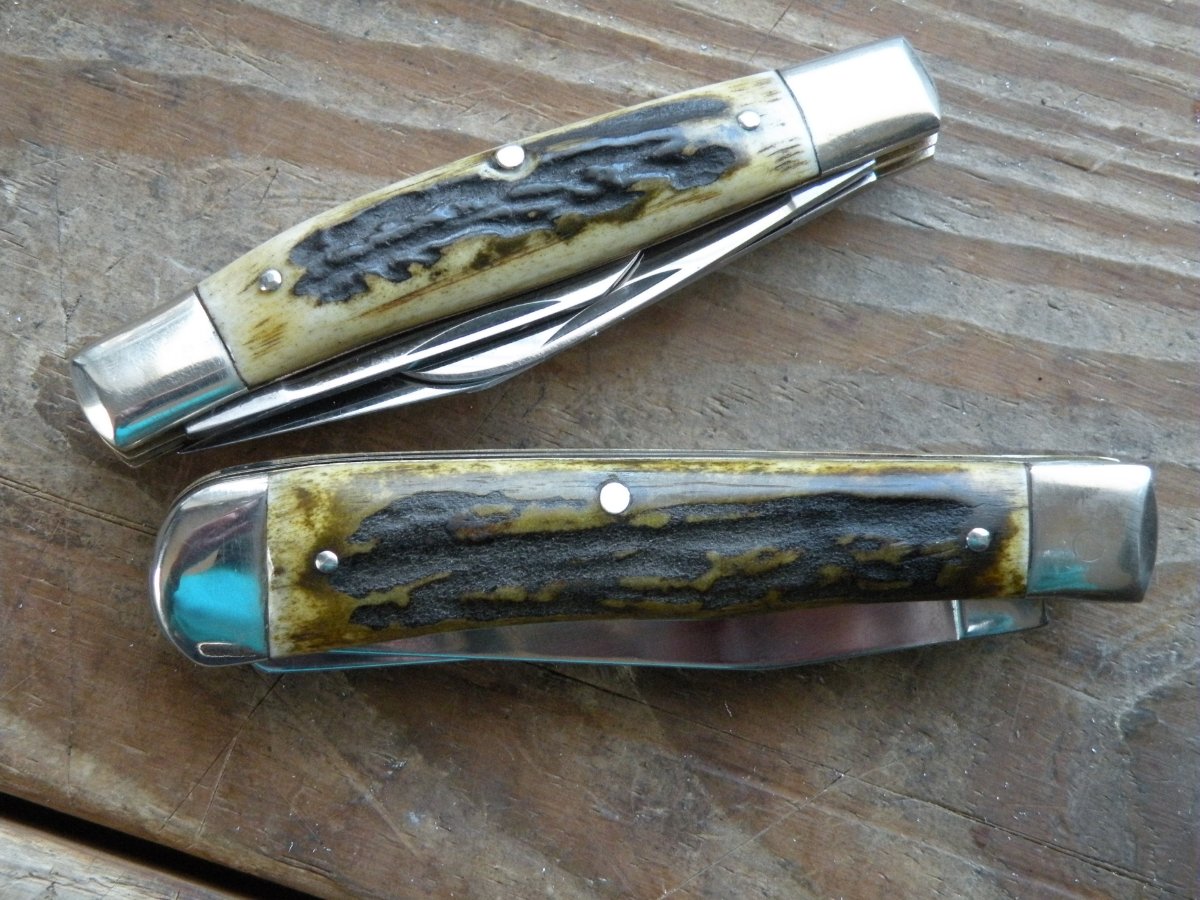

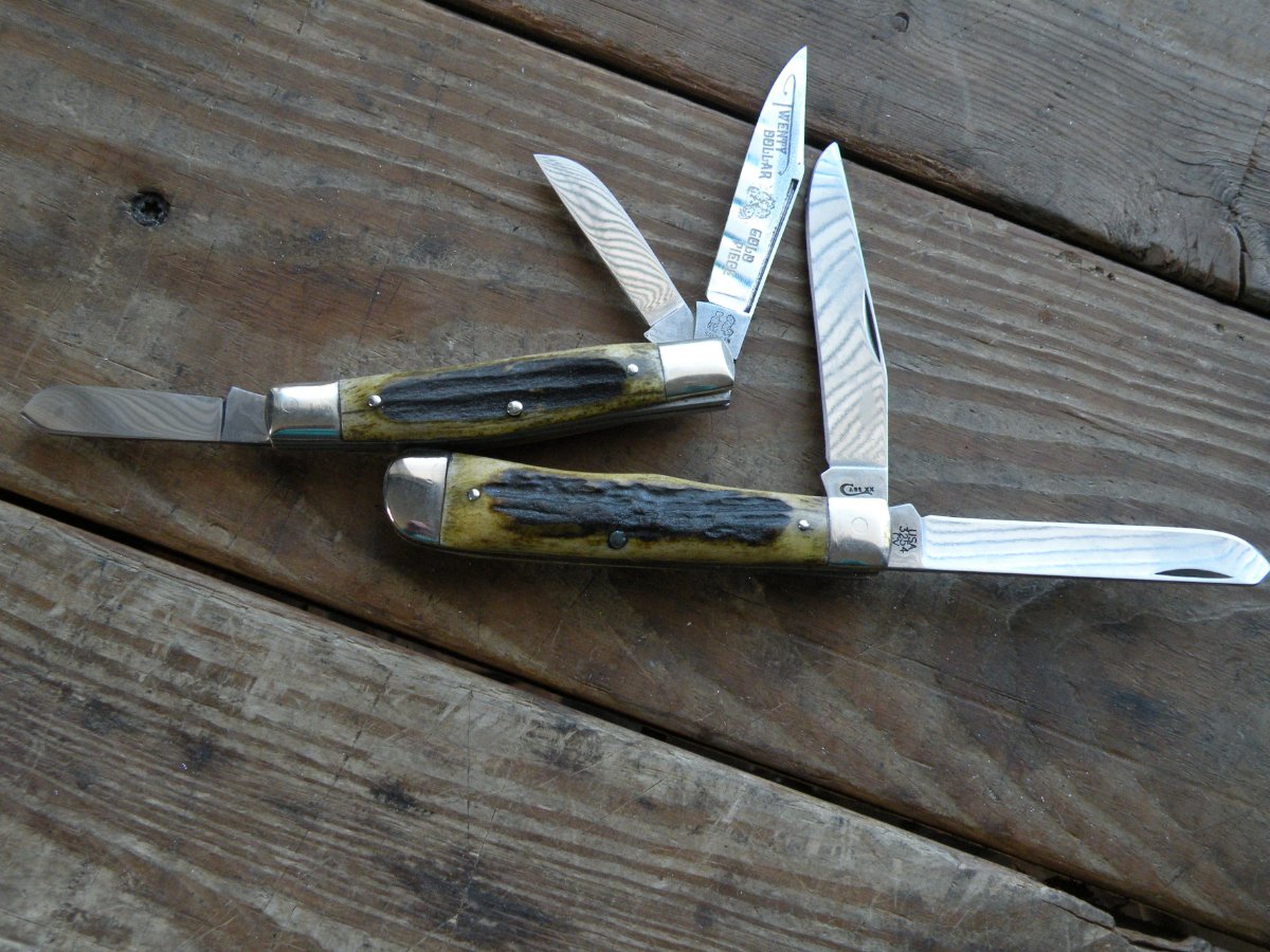

I've been thinking about trying to work with stag for a long time, but for a variety of lame reasons I haven't tried it, until now. I just recently scored a big bunch of sambar seconds, so here are my first 2 attempts. The Frank Buster stockman had outgassing celluloid scales, that unfortunately weren't caught in time when I got it, and had just started to eat away at the clip. You can see the residual pitting in the last pic. (I'll probably try a little more elbow grease on that pitted area.) The Case trapper had yellow delrin scales that the owner had used for practice with an engraving tool. (Really, I'm not making this up and I have 3 more like it that I got from him and are waiting to be rehandled.) Other than the damage to each knife I just described, they both look to be totally unused. I've always been attracted to thick stag, but I'm thinking maybe I went a little bit overboard on these two? Now I just need to figure out how to cut the shield inlays in stag.

I don’t think you went overboard. They both look pretty darn nice!
I’m not a huge stag fan. I work with it from time to time but it’s not high on my list of handle products to use. I don’t hate it, I’m just not drawn to it.
Anyway, nice work Herb, they both great!
Jeff
Jeff

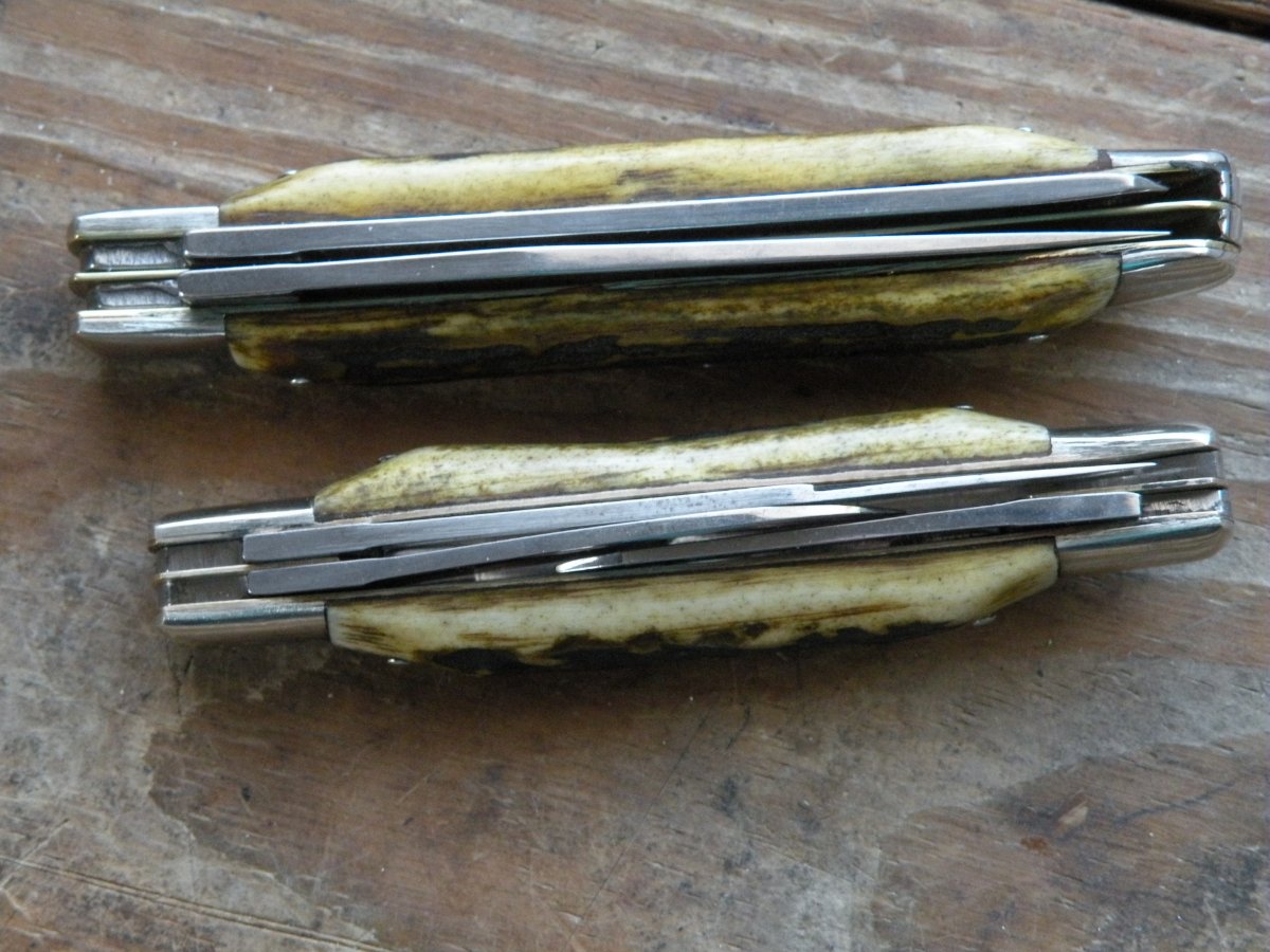

I think they both look just right. Not too thick. Not too thin. Good measure IMHO!
I love Stag!
Anyways, you did a fine job on those two!

I'm just the opposite, I LOVE working with stag!
I'm not a fan of PHAT stag, but I understand there are those that are.

I’m with Glenn, personally I like thinner stag. But that said, you did an outstanding job. Those look very nice, better than new.
