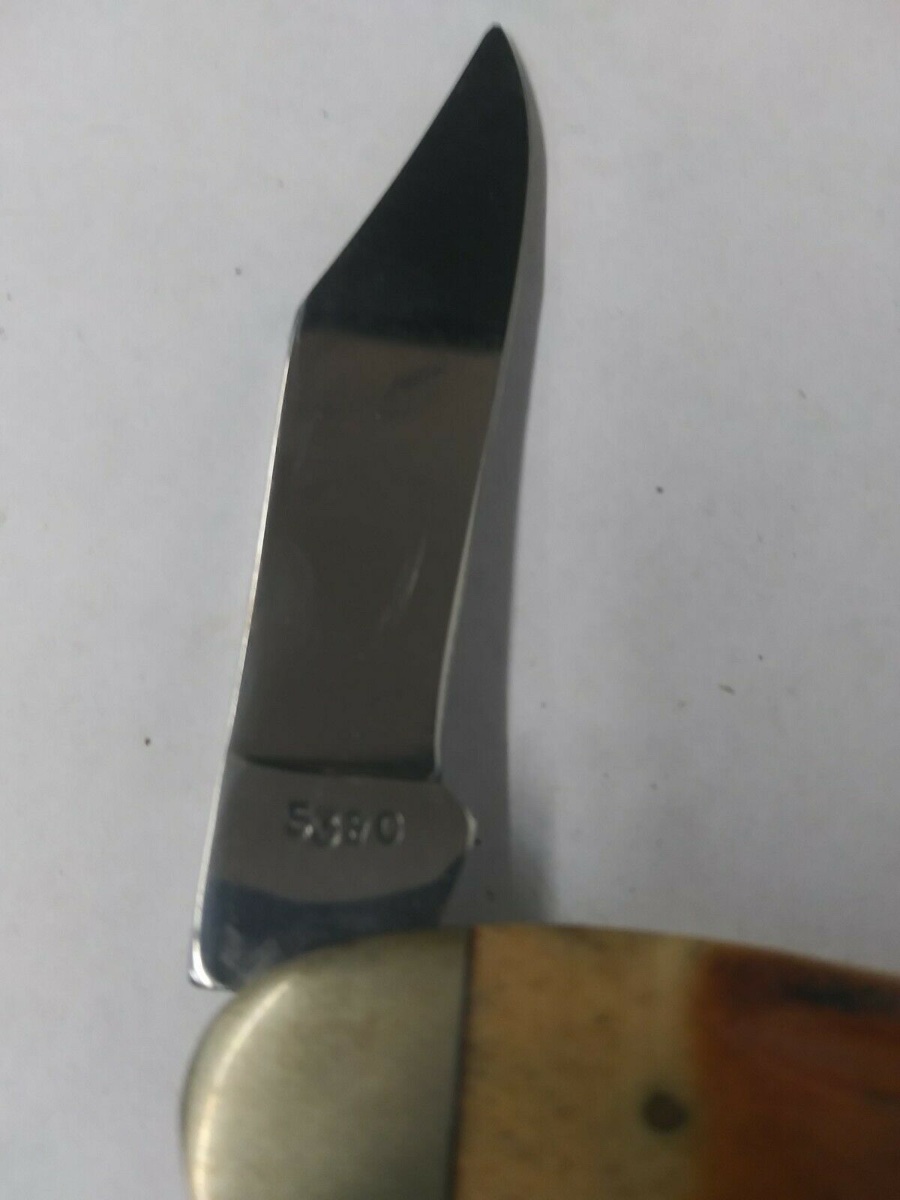

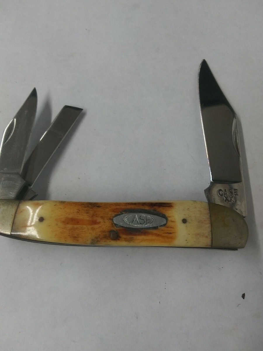

For posterity, here are some of the seller’s pictures from the listing. https://www.ebay.com/itm/234381532675?h ... Sww2Fh5c9f
Note the crudely stamped pattern number, rounded ends on the E and X’s, and indications of a shaved tang, where the end of the shoulder grind line curves upward near the blade spine (happens when metal is grinded off the tang to remove the original stamp). Inletting of the stag around the shield placement is crude also.

- Posts: 8617
Re: Case XX 5380
Case closed on that one!

- treefarmer
- Posts: 15162
Re: Case XX 5380
Who ever mounted the shield did a marvelous job.

Re: Case XX 5380
Eee gads, looks like Packy Stan did the stag to boot!
Nice cold stamped mark and randomly stamped pattern number, just like Case never did.
