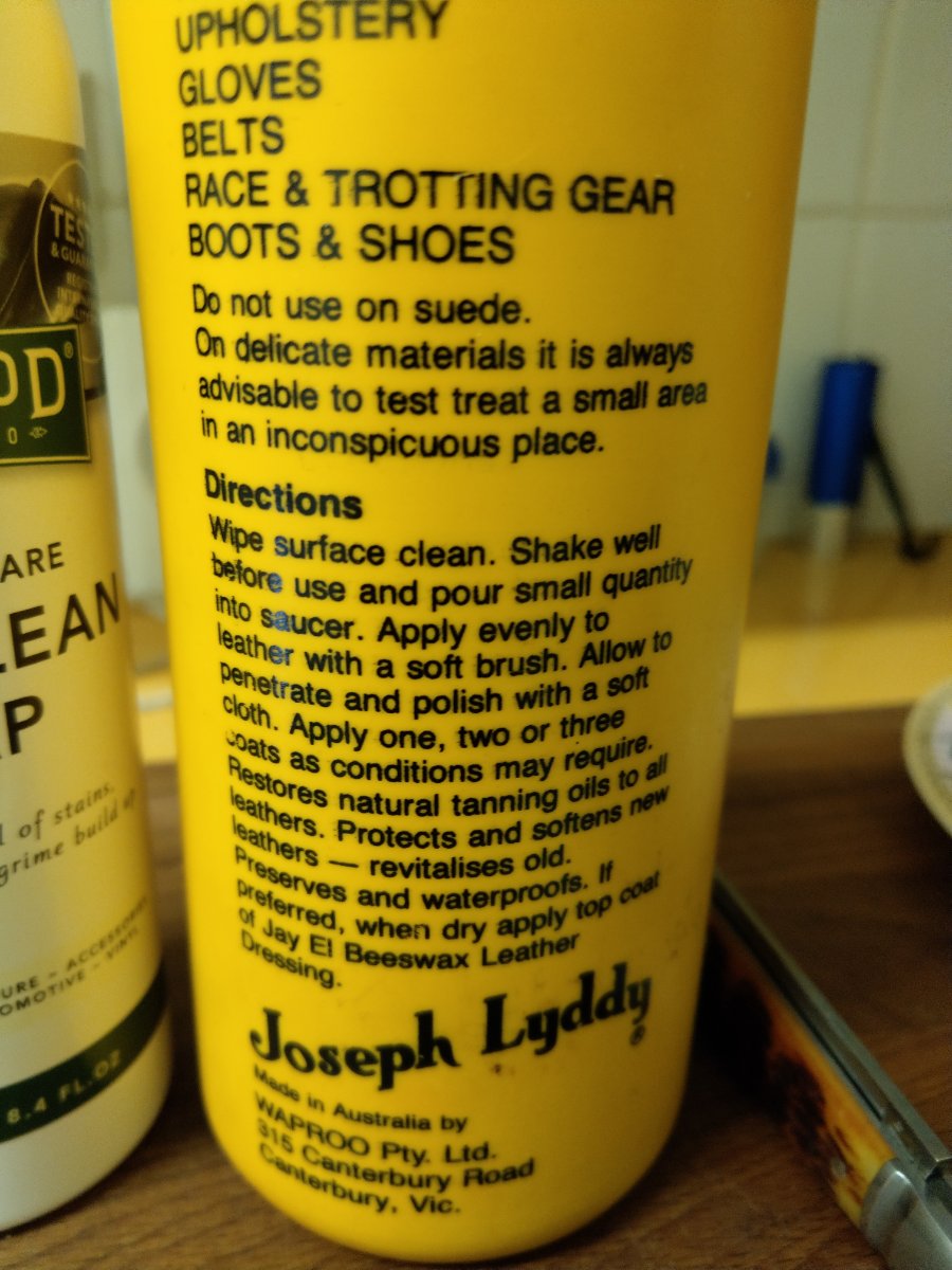

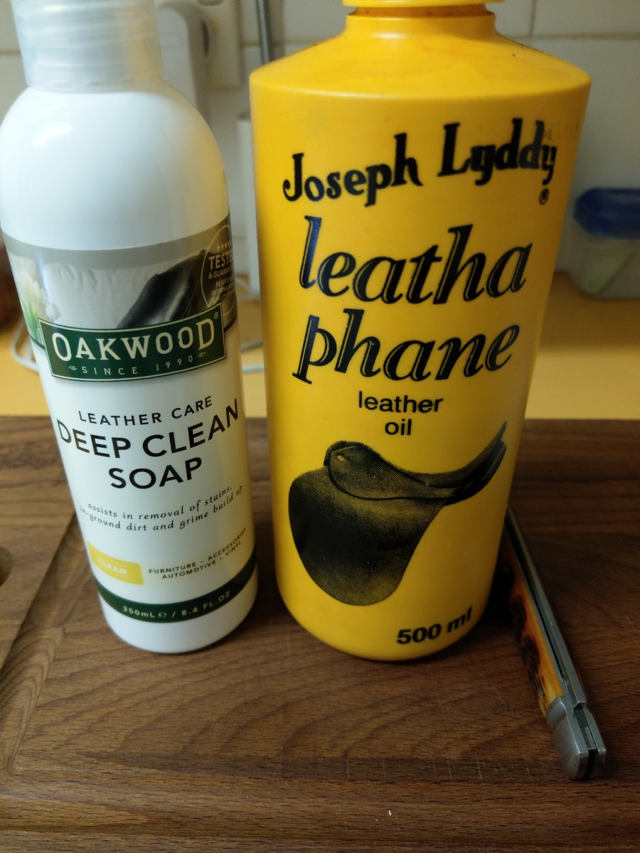

My friend i can help you there, had great success with this method on really dried out leather. As Ken stated get yourself some saddle soap or leather cleaner can be sourced at a good saddlery or horse gear supplier. And some good leather conditioner, a reputable supplier will give you the right advise as to what is best for your needs. Give the leather a really good clean with the saddle soap, and old toothbrush is ideal, my take a couple of goes just make sure it dries between coats. Then just lather on the conditioner, and let soak in and dry, then keep reapplying, may take several coats. Will completely reinvigorate your sheath. This is what i use, but won't be available over there, but you will be able to source something similar. ::tu:: I have had this conditioner for over 25 years and still going strong, a little goes a long way, and is great on work boots. This stuff has been made here for over 100 years so they must be doing something right. If you need any help just ask. ::tu:: ::tu:: ::tu:: ::handshake::
Not sure if that is available in North America. There are a lot of very good substitutes here though.

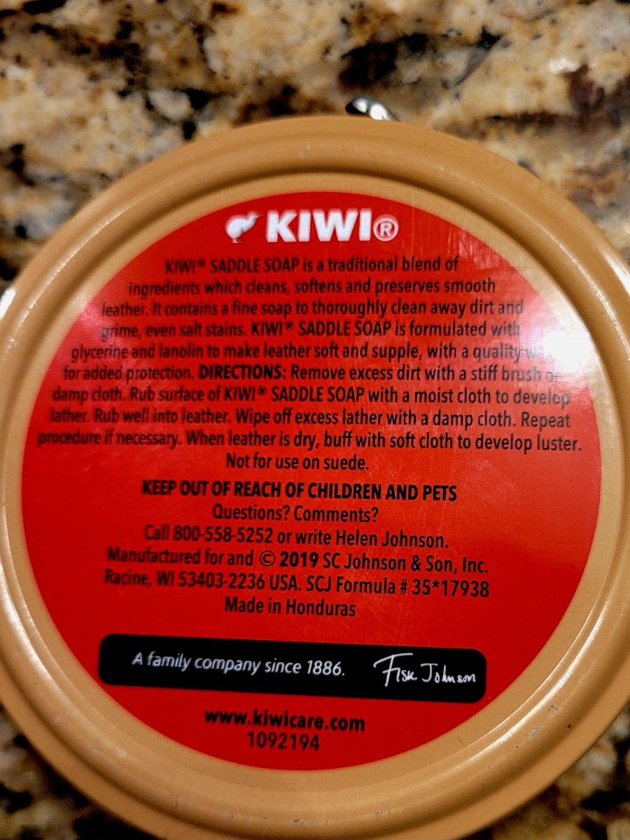

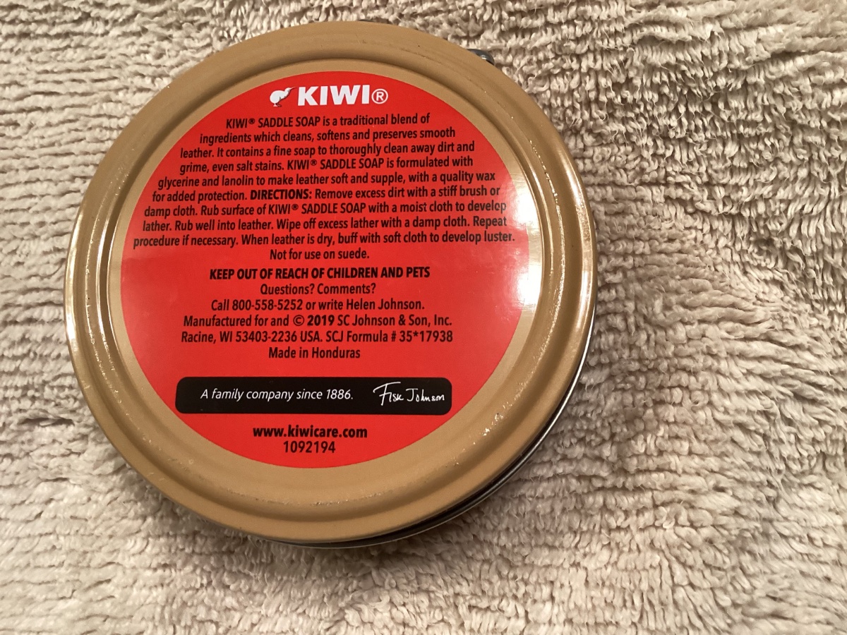

All I know is what I read on the product label, and my personal experience using the product. The saddle soap I use, in addition to soap for cleaning, says it is "formulated with glycerin and lanolin to make leather soft and supple".
Works great for me. Maybe your brand contains only soap? ::shrug:: If you read ALL of my post, I also referred to using other leather conditioning products in addition to saddle soap.

Kiwi brand saddle soap
