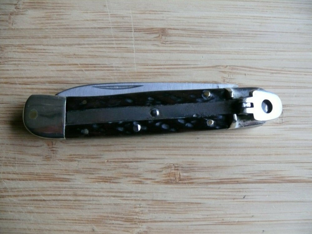

Hi friends,
I'm sure someone out there has or has had a knife like this one before. I have bid on several of them just out of curiousity but have never been able to buy any. Seems they are pretty popular among collectors over here. ::hmm::
So my question is, how do these knives work? Is the lever on the side just a locking device or is it a release because the description says "spring assisted"? ::shrug:: Follow up question..., if it is a type of switch blade, (which I don't know,) is it best to store them opened to take the pressure off the spring? ::shrug:: Third & last question, why the metal band all the way down one side of the handle? This seems to be standard on these types of knives. ::hmm::
Thanks for the Info! ::handshake:: I appreciate it! ::nod:: :D

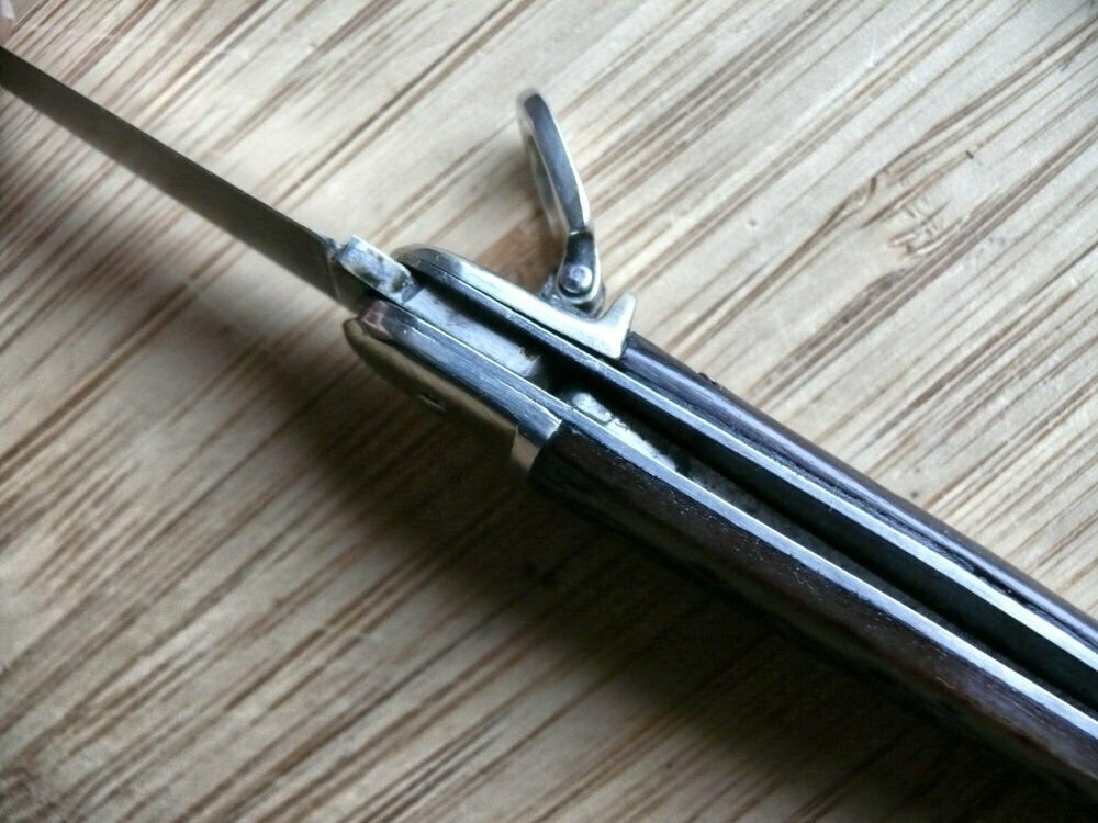

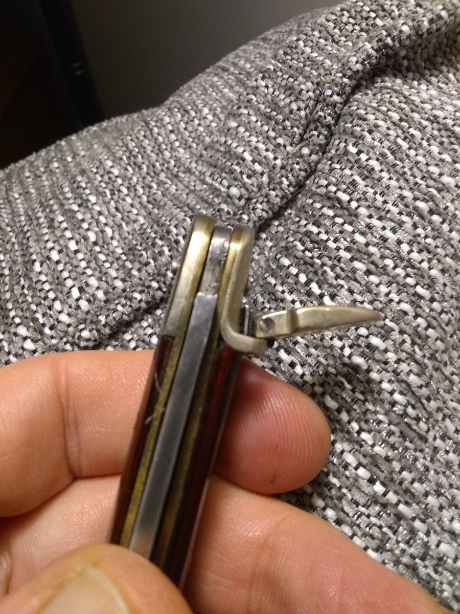

Posts: 21541
Re: So how do these knives work?

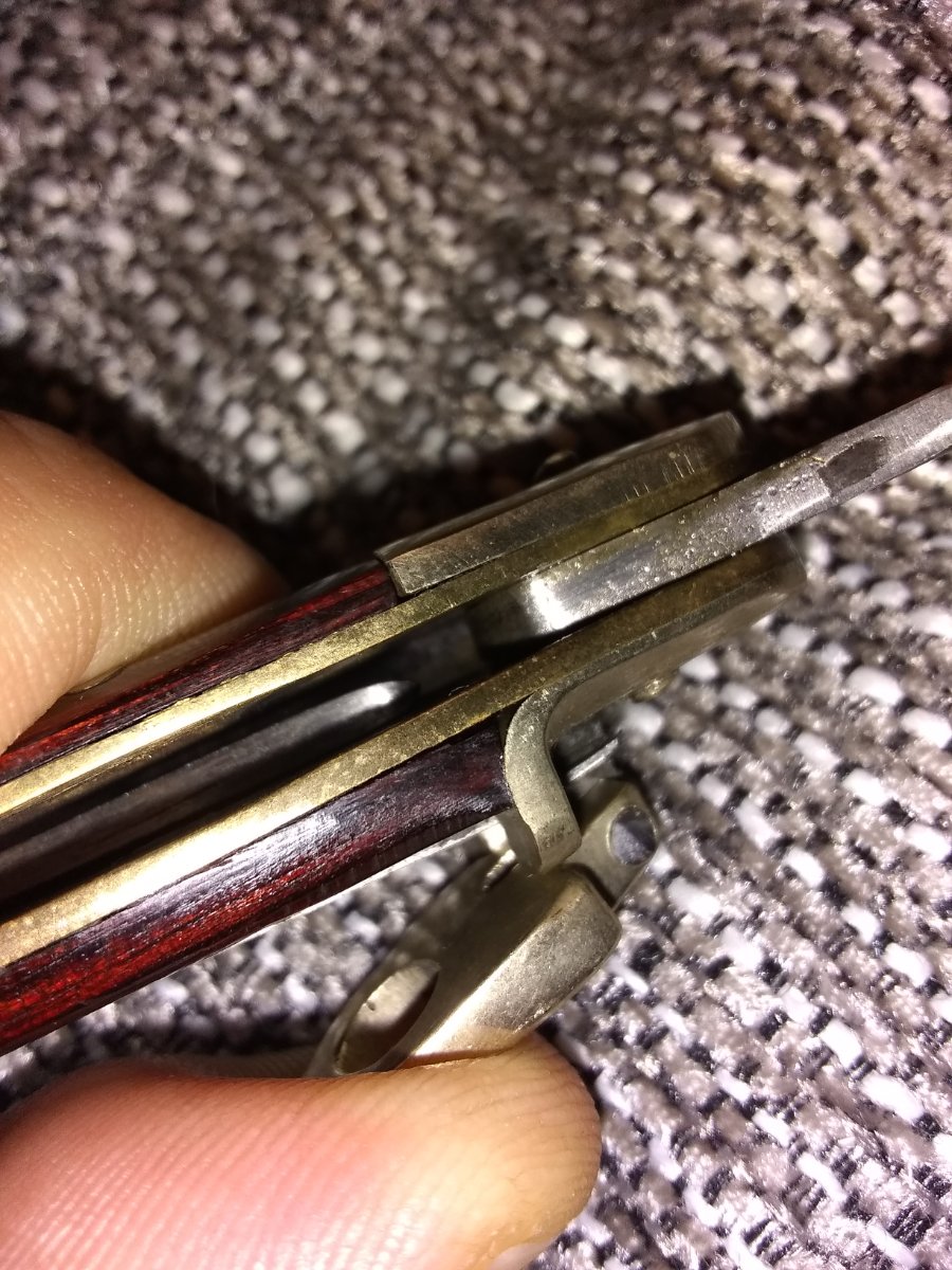

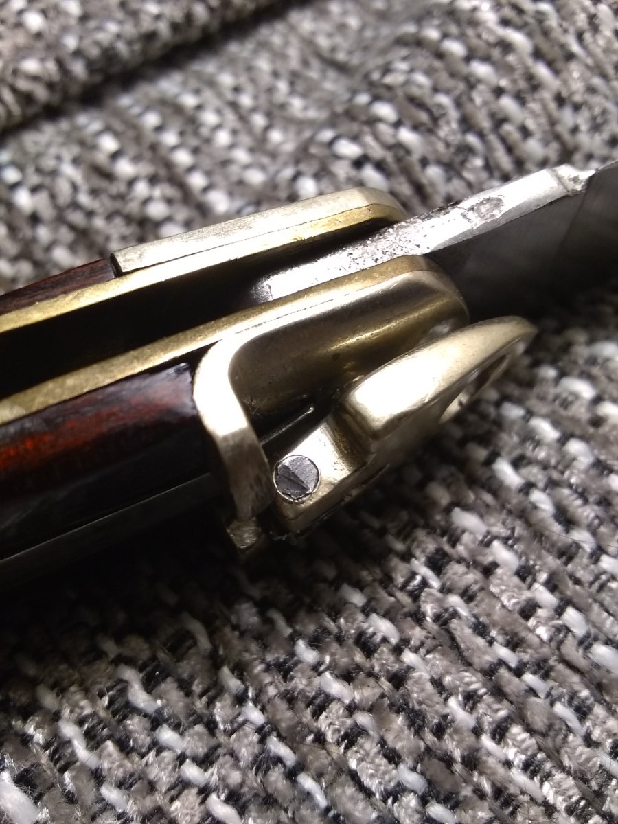

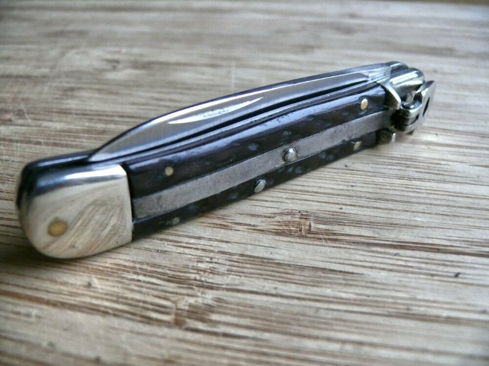

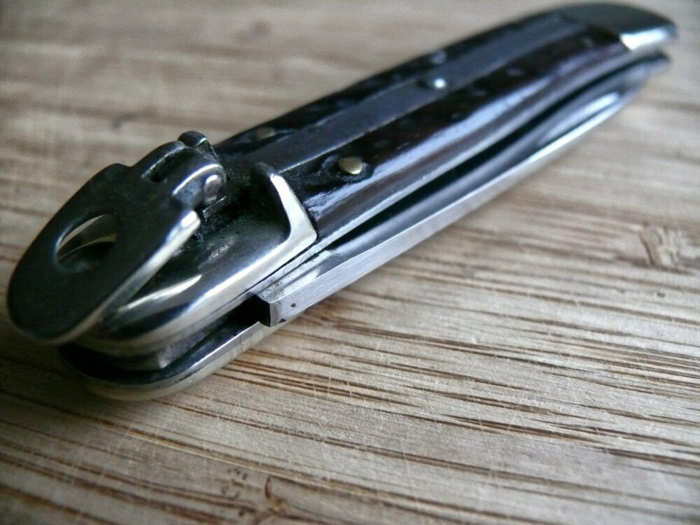

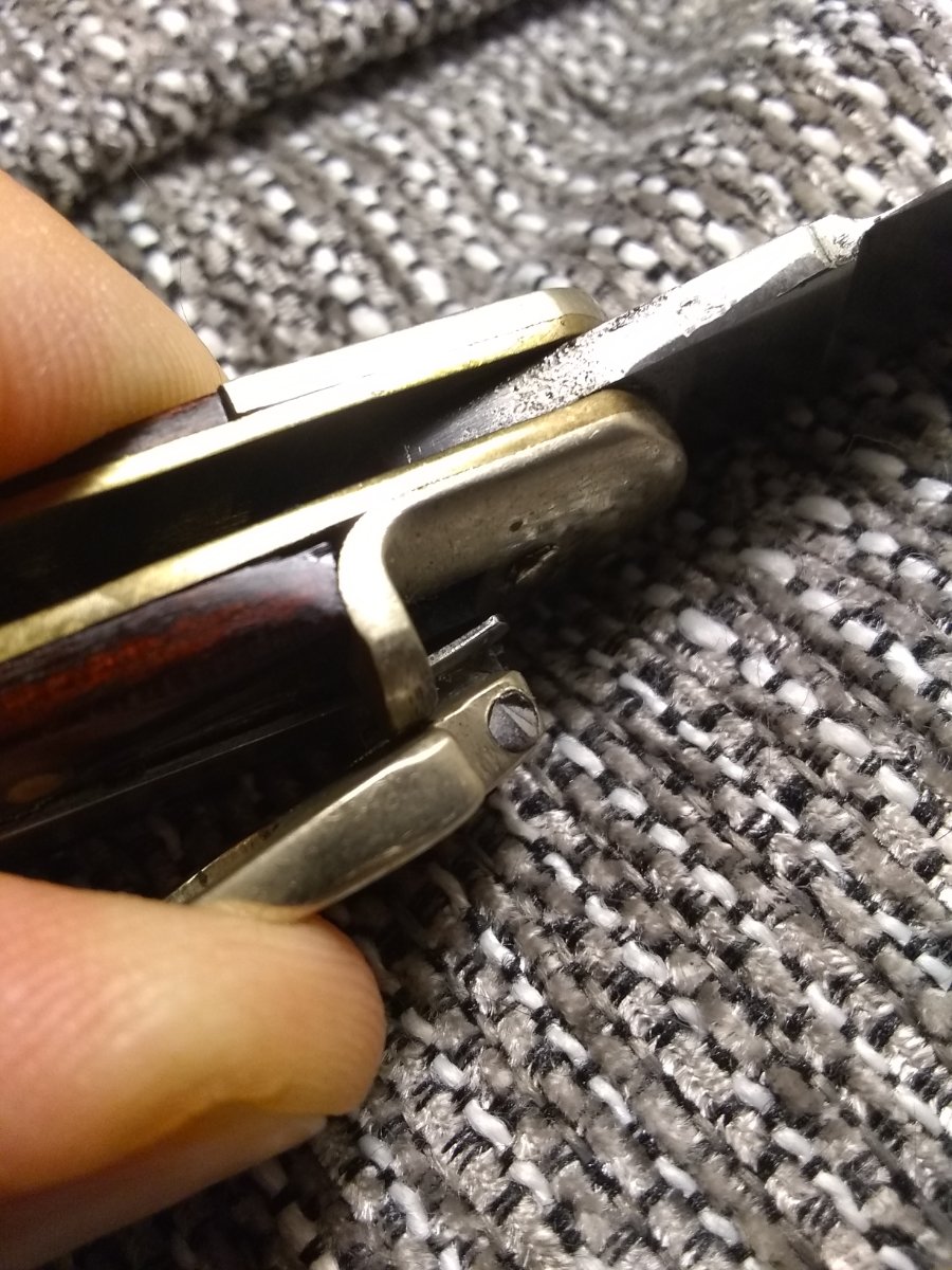

Tom, hope you can see from my pictures how this switch works.
The lever/trigger is attached to the spring on the outside of the handle, there's also a thicker spring inside of the blade well. When the trigger is pushed, the outside spring flexes and the pin locking the blade in place is pulled outward, allowing the blade to spring open, and then it locks in the open position. To close, you press the trigger which flexes the outside spring again and it allows the pin to move outward, releasing the blade which can now be manually closed and locked, with resistance against the blade from the blade well spring. You can see a circular hole in the blade below where a tang stamp would normally be in my 4th picture, just above the bolster.
Hope this helps!
