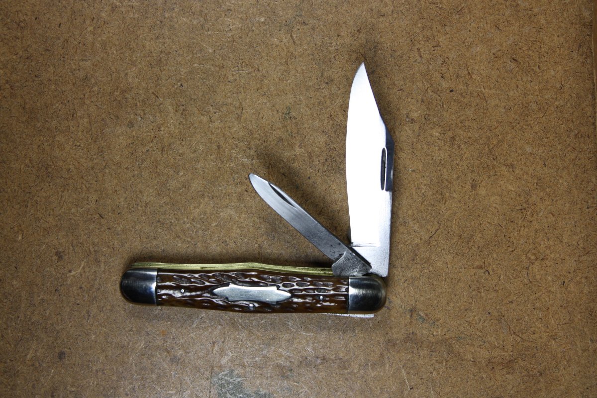

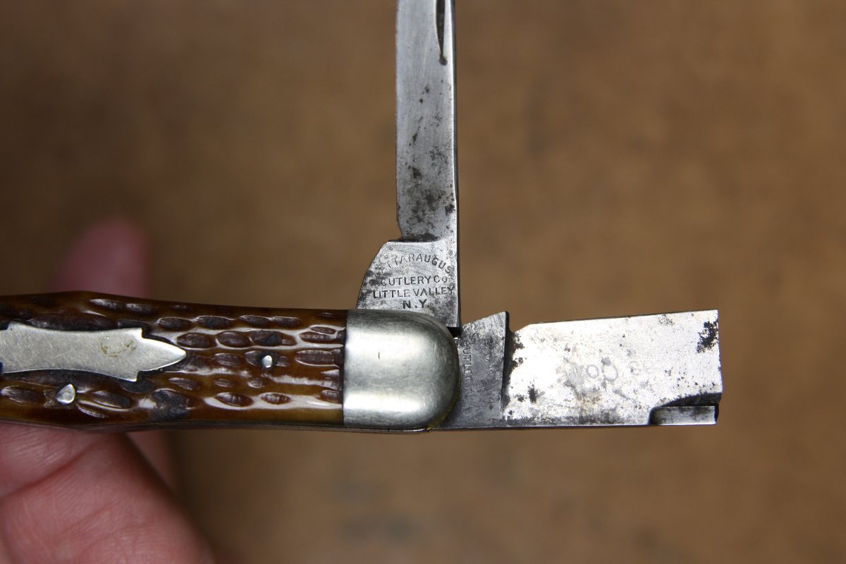

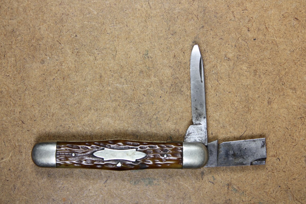

Most of you guys have something like this, a pile of knives laying on the back of your bench waiting for a donor, parts, or an idea. This was one of those. I bought it at the fleamarket out of a 1 dollar box a year ago and put it in the pile hoping to find a blade for it. Nothing materialized, so yesterday I took it up and decided to just make a replacement for the broken master blade. Since both of the blades are marked Cattaraugus, it will not lose its identity by replacing one blade. I believe this is a 22279, 3 1/2" OAL, even though neither blade is stamped. I bought it because the original bone is in really nice shape.

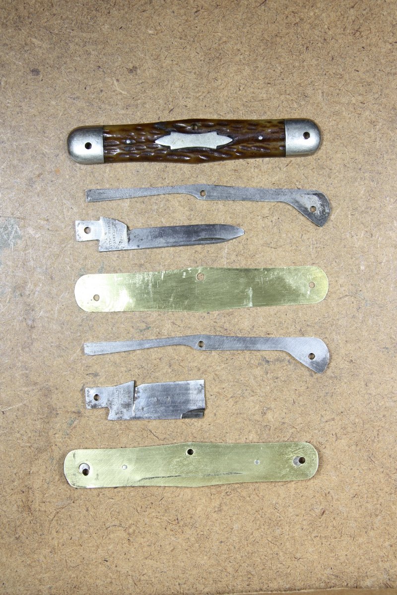

Apart and cleaned up

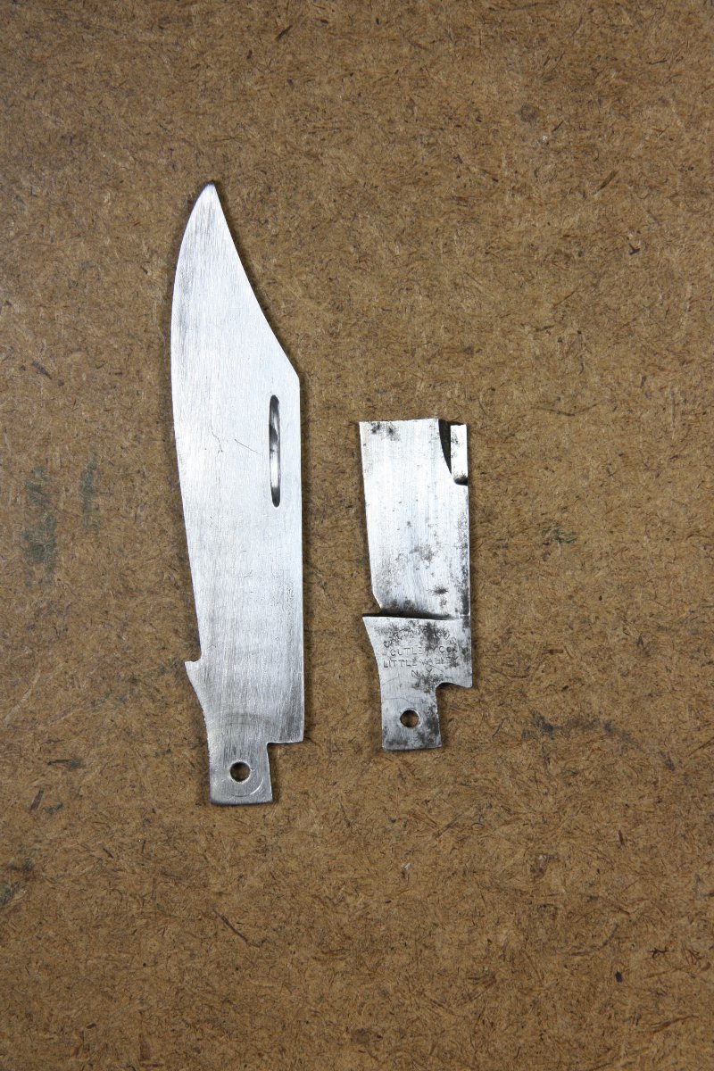

Blank cut out with pull roughed in
The 1095 really took a razor edge from the Lansky

Clip blade with some 'belly' to it. Reminds me of a PAL cattle knife.

royal0014 wrote: Fri Nov 12, 2021 10:36 am Not too shabby
::tu::
Thanks. I try to make the blade the max that will fit into the bladewell to allow for future wear and sharpening. You probably noticed that I messed up and forgot to add the choil to the blade.
