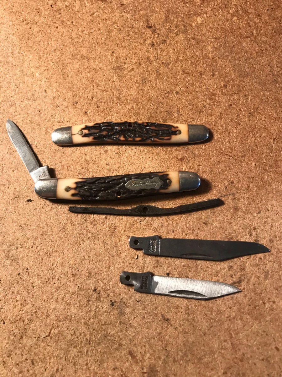

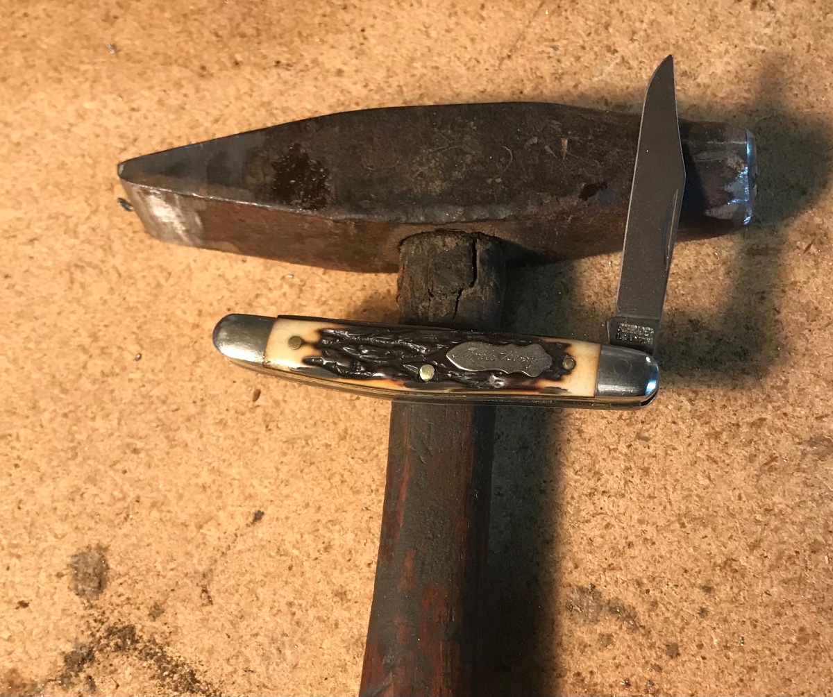

I spent a few hours in the Knife Shop this morning - for the first time in many, many months. I spent the first two hours just cleaning and organizing, then got to work on a couple of Schrade knives.
I forgot to get a "before" pic on this Uncle Henry, but you can see the original worn-out Main blade down below.

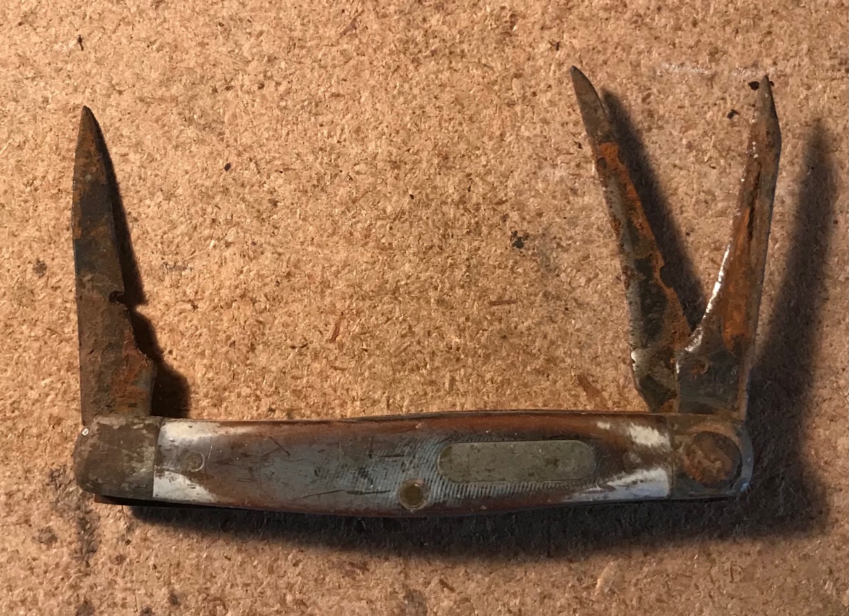

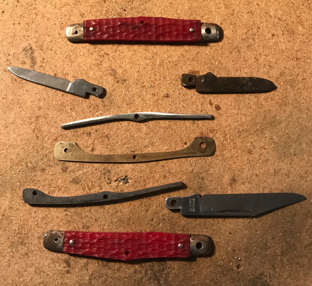

I counter-sunk my pivot holes slightly too much, and my pin would not disappear. I left the Swinden rivet on the other end. I started on an Old Timer 340T, one of the worst that I have ever seen. I did not get finished with it before I had to stop for the day, but you can expect pictures in the upcoming weeks. The handles would have been good, had I cleaned them, but I get bored with brown sawcut delrin, so I am trying out some red Aberdeen bone. I did not have all of the correct blades in my stash of new Schrade parts, so it will be a Franenknife. Someone had pinned the Main with a nail, and Had made a large hole. I had to drill everything on that end for 1/8".
Still, I am hopeful that this one turns out well!

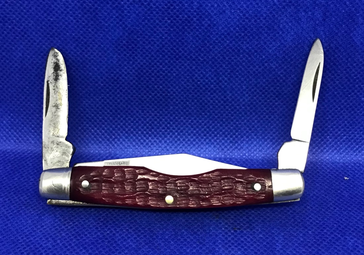

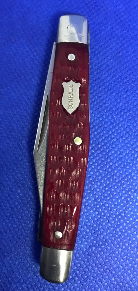

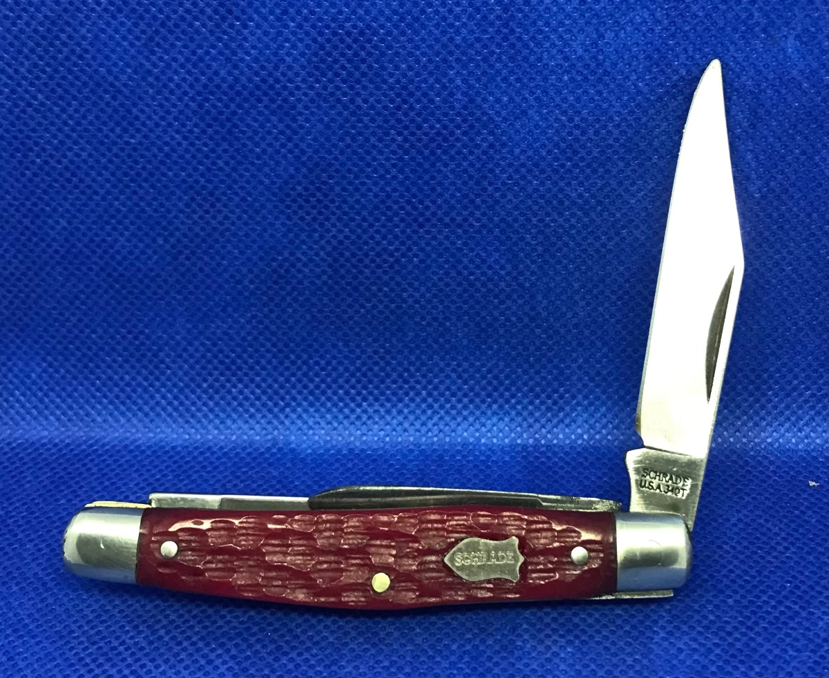

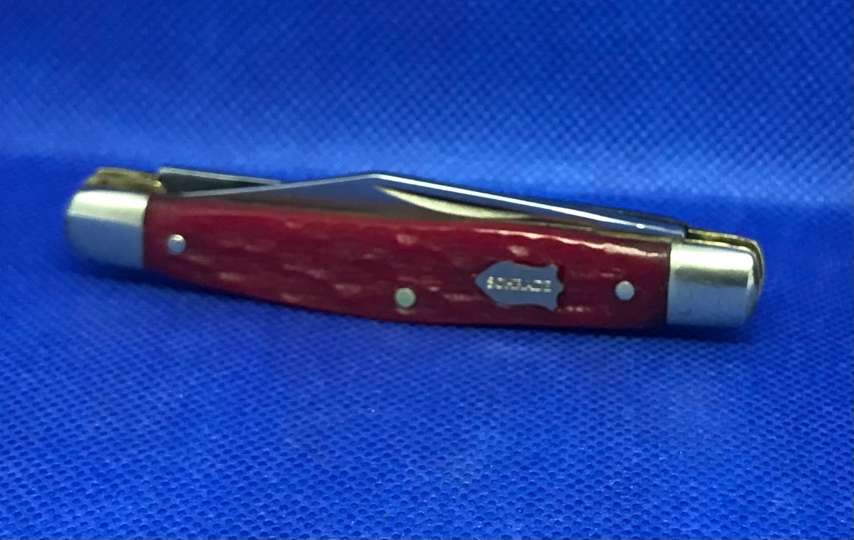

I got home early from work and finished 'er up!
Every knife mechanic says that we learn a little bit more from each knife, and that was certainly true here. I learned that I should have just replaced the Main and then left off the two smaller blades. Since they were not the exact blades for this frame, the fit is off and there is some blade rub that I cannot fix. Heck, the blade that sits behind the main is not even a Schrade blade!
This was the first shield that I have inlaid, and though it is a bit crooked I am still proud of how it looks.

Looks good Reverend.

She's real purty now, great job!

Very nice Reverand!
The pins are NICELY done... Do you have a spinner?
That right there is the kind of restoration I enjoy
GREAT job!
GREAT job!

I have a set that was thoughtfully given to me by Jeffinn. I have tried it a few times with varying success, but I don't really like using it. It seems like it was designed foe larger pin stock, or something. Instead, I have followed his and other's advice and begun working on my peening skills.Meridian_Mike wrote: ↑Wed Nov 10, 2021 12:36 pm Very nice Reverand!
GREAT job!
Thank you for the compliment though!
I just got a new 1x30 sander (Harbor Freight) and I enjoy using it, but I did make some permanent marks on the knife by getting against the edge of the belt at the wrong angle.
Now, I have to brush up on my sanding skills!

WOW.... those pins look REALLY nice!
I always have a problem with the pin "heads" that are down inside the craters in the "jig" patterns.
Great job on getting those pins so nicely done!
