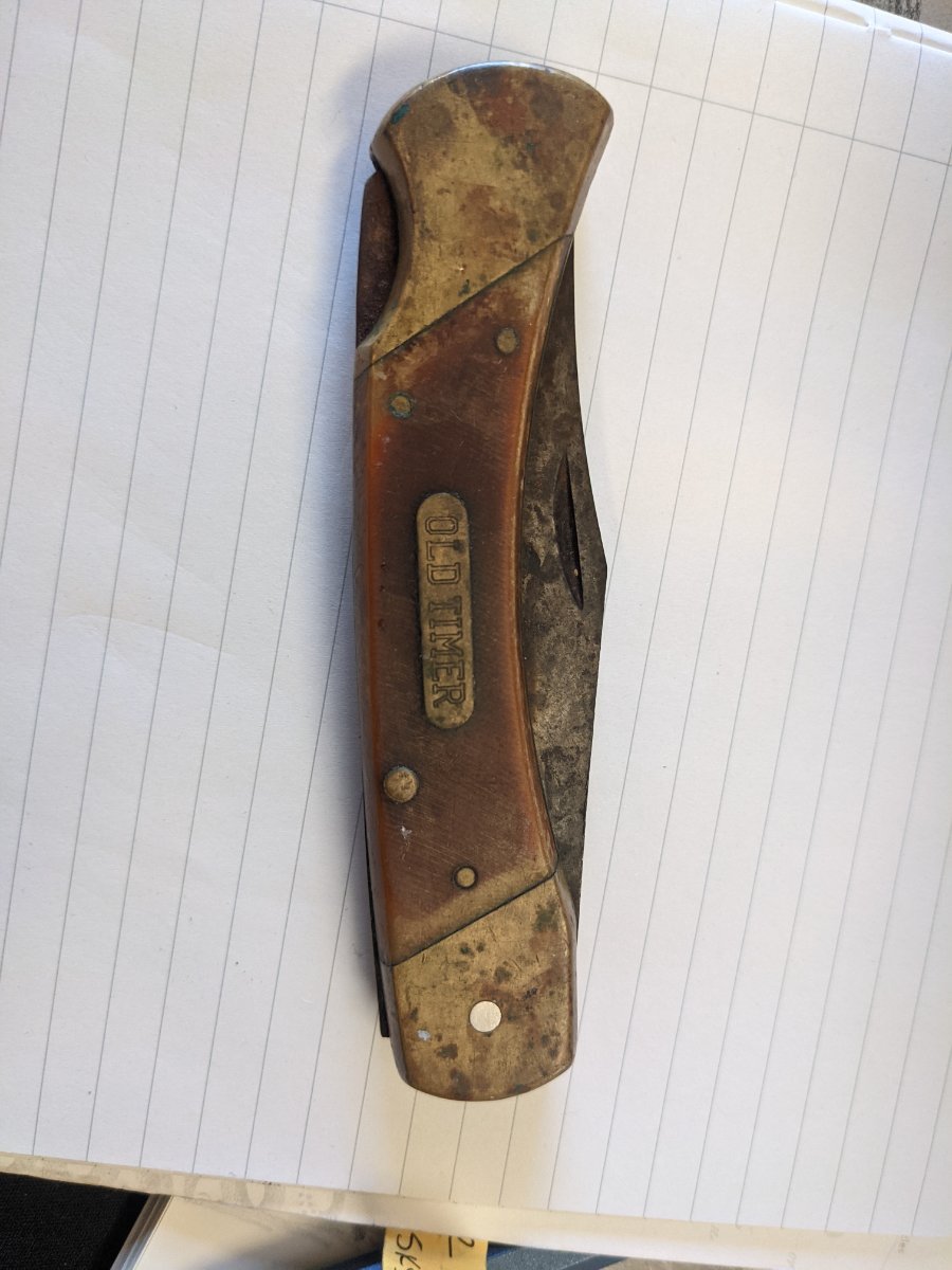

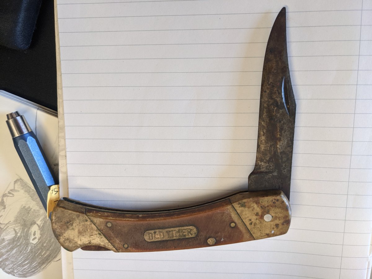

Hi folks,
New to this forum, but I'm looking for your expertise! I recently came into the possession of my late grandpa's pocket knife, and I'm curious about repairing and restoring it. The big problem with it is the lockback doesn't function. It seems stuck in place and doesn't lock the blade in position. Additionally, the blade is a bit wobbly.
From what I can tell, it's an early run (4-pin) Old Timer 7-OT.
I have no idea where to even begin in this process! If I could get the blade solid and locking into place that'd be good enough for me, but if you reckon it's not worth the effort I'll likely just frame it.

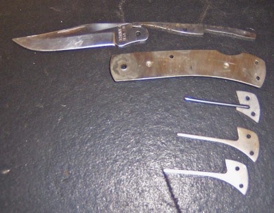

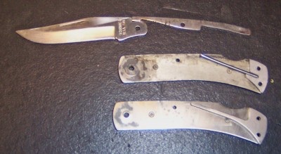

If cleaning your knife doesn't restore the lock function, then you probably need a new spring.
There were two different types of spring that shred used on their lock backs. The original one piece spring get fit into a notch cut into the spacer that holds the two halves of the knife apart at the rear.
The newer style Springs were two flat Springs that fit together making the spacer and the springs.
I am not home right now so I can't get to the pictures on my computer and show you what the different springs look like, but if you look at the spacer between the two rear bolsters and you can see a line down the middle of the spacer, then you have the newer style Springs.

orvet wrote: Fri Oct 22, 2021 2:06 am If cleaning your knife doesn't restore the lock function, then you probably need a new spring.

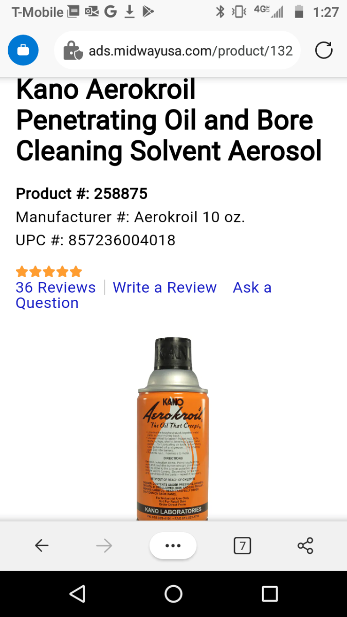

Posts: 21489
Re: How to restore/repair Grandpa's Old Timer
If you can't find PB Blaster, this Kroil stuff works well. We had an old drill press that sat in a barn for 20 years and rusted tight. Within a week this stuff loosened it up.
