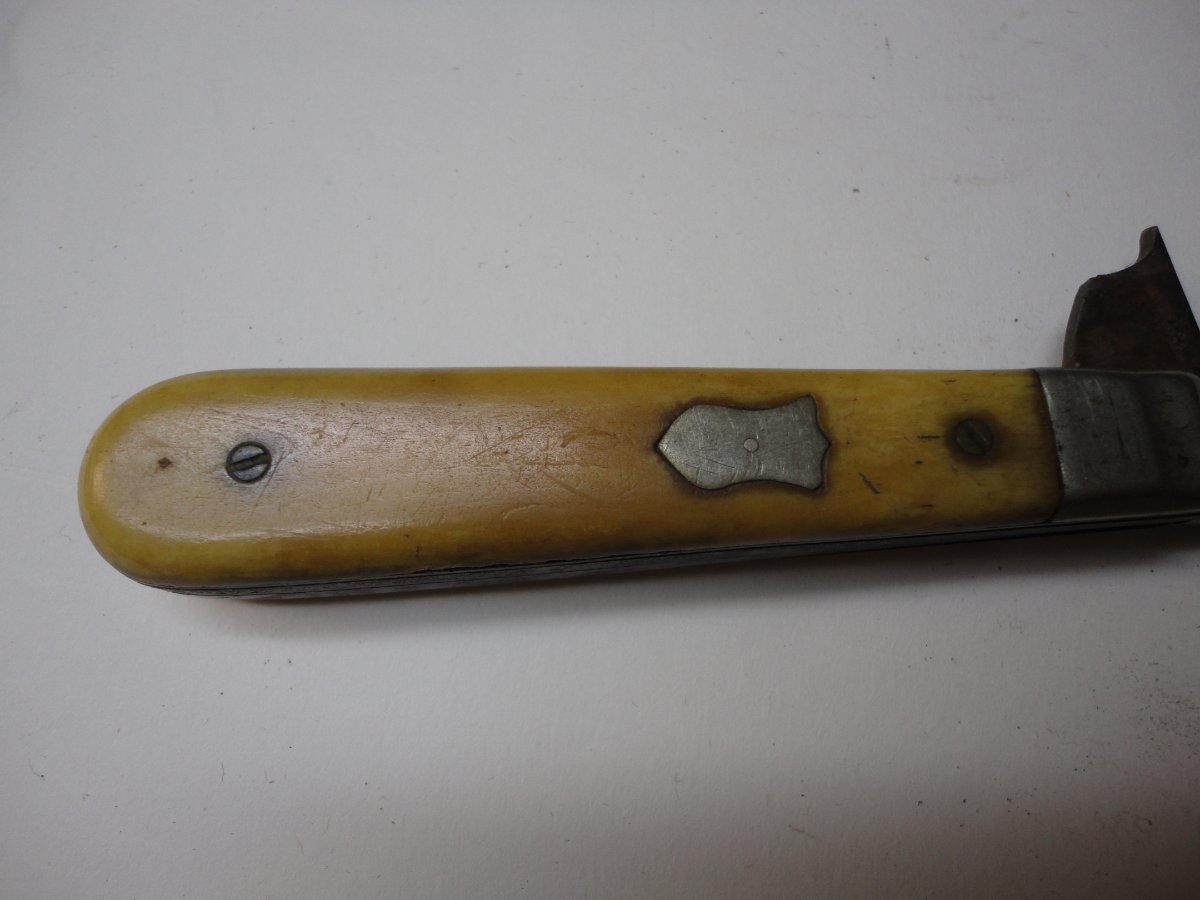

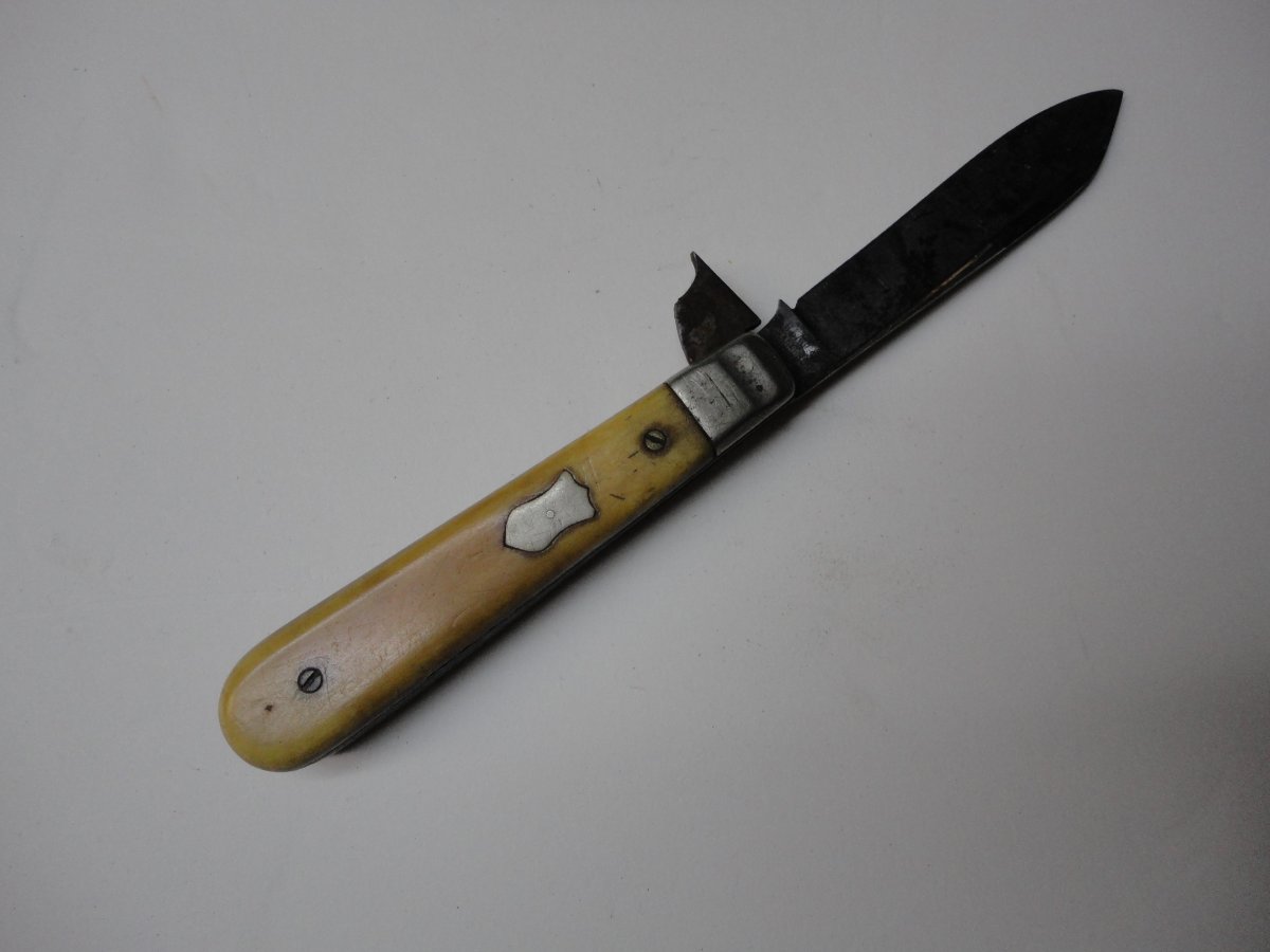

Hello.
I need help in identifying my W.R. Case Bradford Pa. Knife . It has no numbers anywhere.
Yes, one blade is broken.
Thanks
Mumbleypeg
Posts: 15716
Location: Republic of Texas
Re: W.R. Case Bradford Pa. Knife Identification.
Post by Mumbleypeg »
What is the closed length?

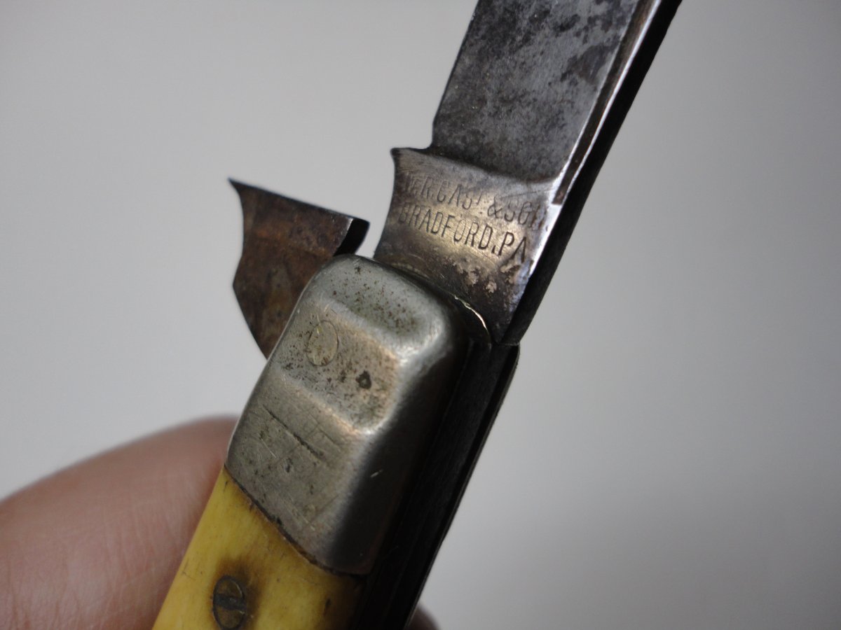

Edit: Never mind. The stamp on the knife appears to be W.R. CASE & SON, which was used from 1902-1903. During which time the company did not make their own knives, but had them made on contract by others. Relatively few with that stamp exist and I know of no catalogs documenting the patterns offered - Sargent’s Guide has a few pictures. The knife has screws holding the covers on, which is a hallmark of Miller Brothers knives. Thus I’m going to speculate the knife may have been made for W.R. Case by Miller Brothers. Unusual knife, nice find!

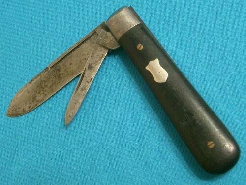

Post by grisuno »
Ken,
I found this Miller Brothers knife that is very similar. Whats left of my blade matches the blade on this knife.
This knife has different bolsters but everything else matches pretty well.
I would like to sell as i am not a knife collector.

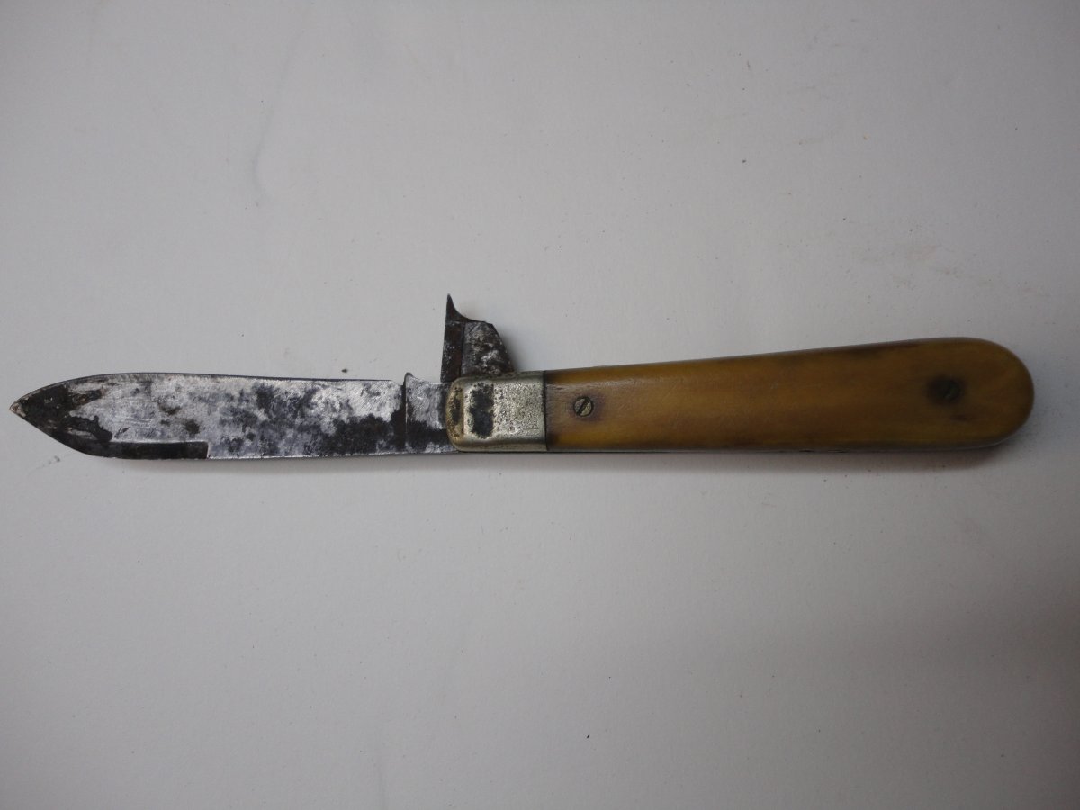

In all of my years collecting, I have never heard of a Case knife made by Miller Brothers. If you look closely, you can see the blades have likely been swapped out as evidenced by the pin in the bolster not being finished properly. It's a Miller Brothers knife that had a blade swap many years ago.

Mumbleypeg wrote: Sat Oct 09, 2021 3:28 pm What is the closed length?
The tang stamp is incomplete, it is missing the last "S" in SONS. The Bradford stamp is proof. This knife was made after the Little Valley plant burned in 1912. Case was definitely making their own knives at this point.

You could be right that the S is missing on the OP knife, and that a Case blade has been placed in a Miller Brothers frame. Those are certainly possibilities.. As I said, it MAY have been made by Miller Brothers. I've never seen a Case made by Miller Brothers either, but there's a lot I haven't seen, especially from that time period. ::shrug:
As for the rest, I think you're conflating Case Brothers with W.R. Case. Russ Case left Case Brothers and started W.R. Case & Son in Bradford in 1902. The first couple of years he operated as a jobber. According to Sargent's some of the knives stamped W.R. Case & Son were stamped Bradford, and some were not. Having the Bradford stamp does not indicate it could not be a W.R. CASE & SON.
The Case Brothers factory in Little Valley burned in 1912, not the W.R. Case factory. Not sure how that has any bearing on the stamps on the OP knife.
