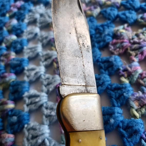

I received an Olcut knife several years ago
from my late wife. It had belonged to her late older brother and I guess its called the deerslayer...folding with the yellowish pearl curved handle and very little wear on the blade, though tarnished a bit. I see people mentioning stars on either side of the name, but mine has a star at end of name.
At the start of the name is what appears to be a shark figure or a small tree limb or twig shape. A sort of curvy line with 3 small lines on it laterally. One side of the handle grip is stamped in bold letters "CALIFORNIA" as if it were sold as some kind of souvenir. Are these really from the early 20th century as mentioned here? I find it amazing to be so old and still not lost in the woods, worn down or having breaks in the grip. If this is true, I guess this is the knife I will pass on to my grandson one day. If any of the more serious collectors can give me any other info, I'd really love to know more. Glad I found this group. I have a small collection of knives and swords that I'd like to learn more about.

Your cool large clasp folding hunter was likely made in the 1930s this model is not in the early Union Cut catalog although I have never heard of an Olcut catalog. I do have Union Cut price lists with Olcuts listed. I have a couple of these with the KA-BAR mark. Yours had the one star worn off and what you call a twig is either a scratch or rust mark, it is not from the factory. Regarding the CALIFORNIA, it could have been the model name or made as a souvenir. I have a few Union Cut knives with YELLOWSTONE PARK embossed in the celluloid. I also have an Olcut "cherry tree chopper" with EVEREADY embossed in the handle but eveready is listed as a model name in the price lists. I also have seen Union Cut celluloid handled knives with the owner's name factory embossed in the handle. Cool old knife.
