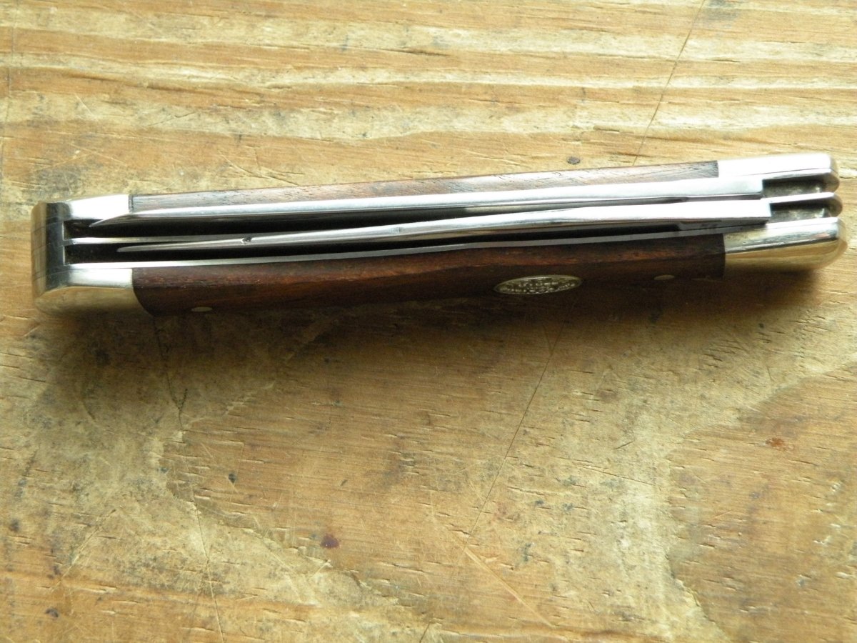

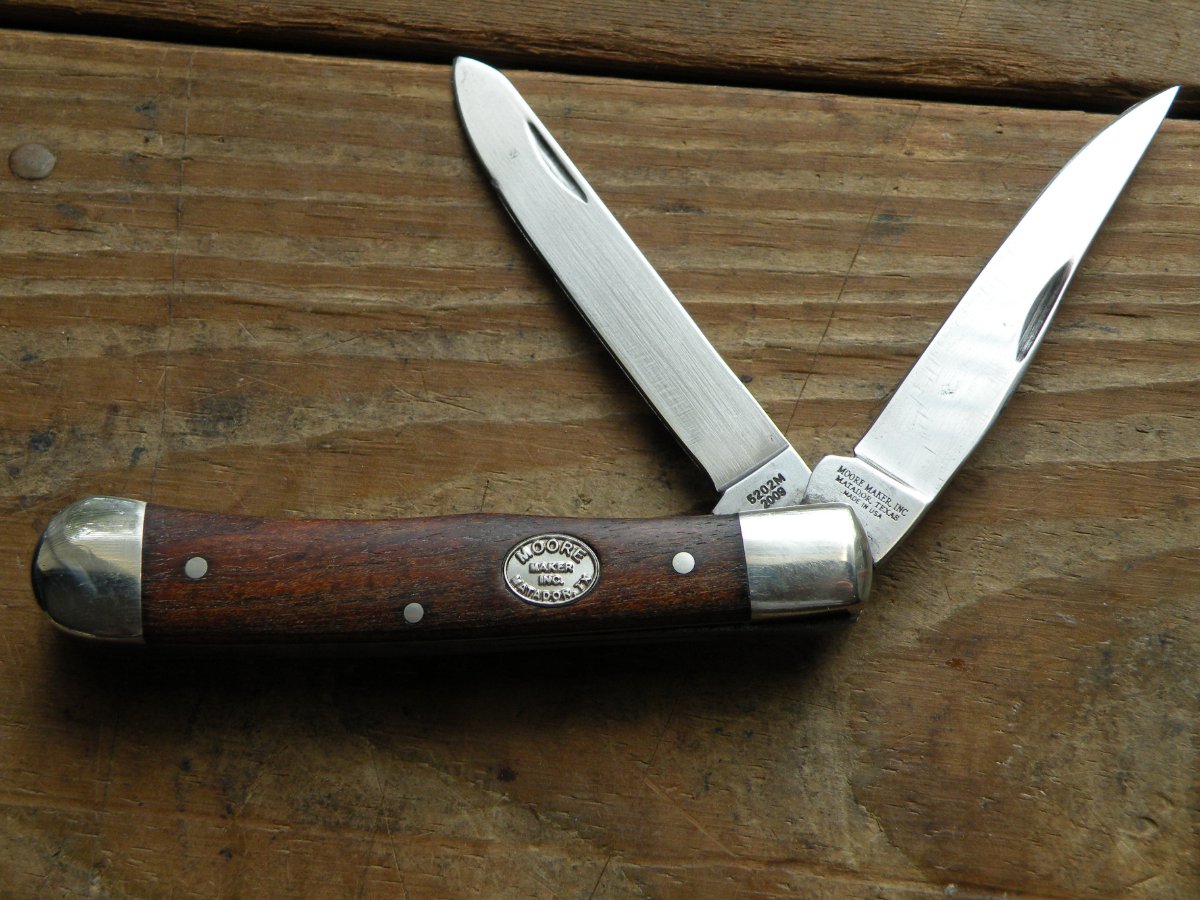

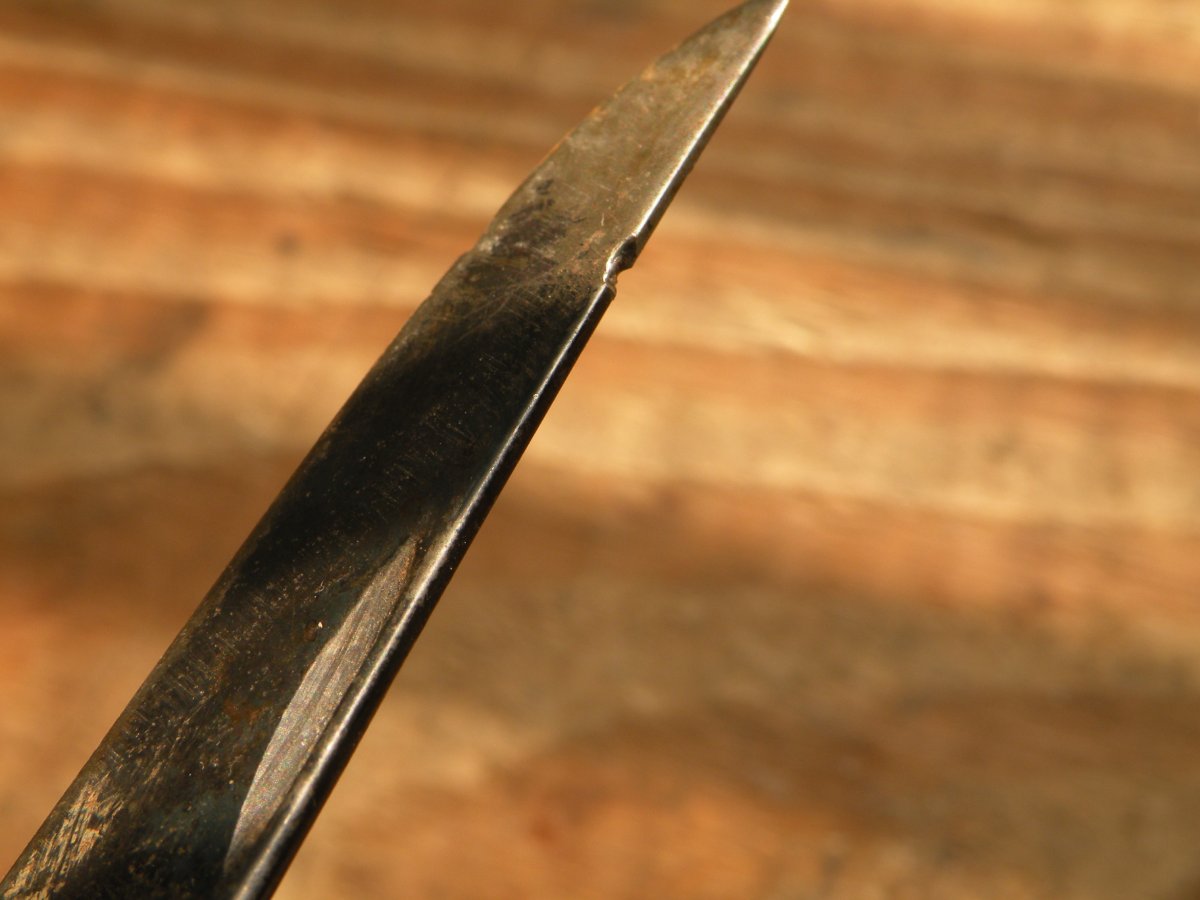

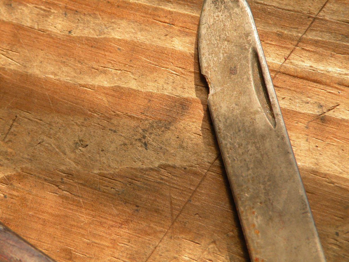

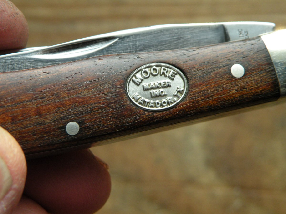

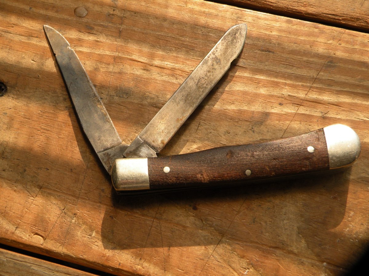

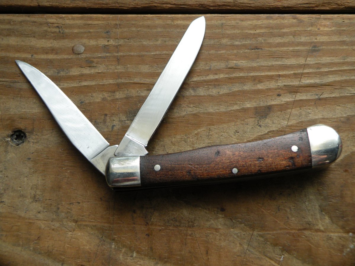

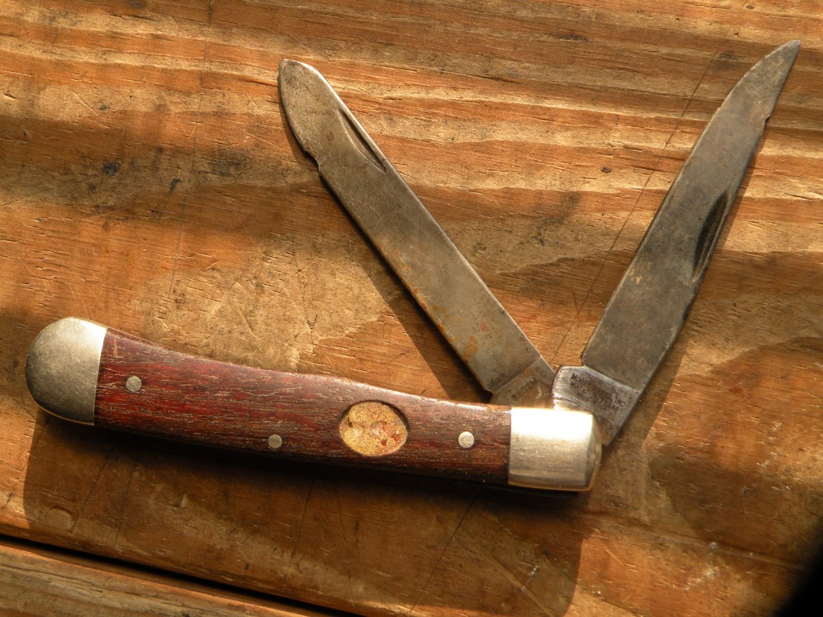

I bought this trapper made by Canal Street for Moore Maker a couple of weeks ago from Steve for a very reasonable price. I planned to disassemble it and give it a total restoration with new smooth bone scales, but I decided to try a good cleaning and some "TLC" first. (I still may go back and rehandle it in smooth bone, maybe hunter green.) The first 4 pics are before and the next 4 after. I have never owned a Canal Street knife before and am very impressed with the quality. Anyway, I removed most of the "flea bites" and scratches from the blades and the old finish from the wood scales. Phil very kindly sent me a new MM shield (thank you again Phil !) and I just gave the bare wood a good coat of wax. The new shield was just a tad too large and sat up a bit too "proud", so I did a bit of excavating and it now sits flush with the scales just the way I like it. Still not sure if I will ditch the old, beat up wood scales, but I am very happy with the knife!

Great job Herb, it looks fantastic! Those handles are mesquite from Wayland Moore's own ranch so there's a bit of history there for sure. Much more than some random cow's shin.

I don't think that you could go wrong either way. But, then again, there is a lot of wisdom In knowing when to stop improving something. That looks mighty nice now!

You have to keep that wood, it just oozes character, looks sensational, and now that you know it's provenance it would be criminal to replace it.

To clean the wood, did you just sand them back then wax? However you did it, you have done a great job.

Thanks Cudgee. I had a hunch that might be mesquite. Yes, I sanded it with very fine sandpaper, gave it a good, hard rub with rubbing alcohol and then hit it with a coat of Butcher's wax. Now that I know what it is for sure, I will definitely leave it alone. Thanks for the good advice!

Herb you've done an amazing job in transforming that ugly duckling into a beautiful swan.
It looks better than I ever imagined it could.

Nice work Herb!
That is a good looking knife as it sits now for sure!
Great job of working out the nips in the blades and the wood looks vibrant and clean!

Nice job! I The wood turned out great. almost considered buying it as a user, but my knife redo skills aren't good enough. I thought I could probably never get those chips out without making a mess out of the blades and taking away too much metal.

There is a lot of satisfaction in cleaning up a neglected old knife.
You did a wonderful job, handle looks great with a proper shield in place and the ding in the spay has disappeared.

If you expand the pictures and look carefully, you can see that I couldn't quite get all of the flea bites (chips) and scratches out of the blades. I try to stop when any more metal removed would significantly alter the lines of the blade or make it look molested. It's a balancing act and most of the time the best I try to do is "tone down" the chips, coarse grinder marks, deep scratches or other damage. I'm with you, it is hard to believe that someone would mistreat a knife like this that badly. But, I see it all the time.cody6268 wrote: βWed Jul 14, 2021 3:55 pm Nice job! I The wood turned out great. almost considered buying it as a user, but my knife redo skills aren't good enough. I thought I could probably never get those chips out without making a mess out of the blades and taking away too much metal.

Being a Canal Street collector, I'm very familiar with most, if not all, of the standard Canal Street patterns. I'm also well aware that Canal Street made knives for Moore Makers. This knife is a twin to the Canal Street Full Moon Trapper as far as frame and blade shape go. In addition to all that, I acquired a small assortment of shields that came from the Canal Street factory when it closed. Among them were a couple of the Moore Maker shields, one of which now graces Herbs refurbished knife.
