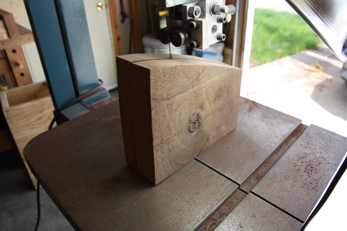

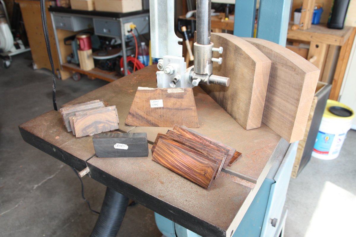

I had been running low on handle material at the end of the winter months, so today while it was fairly warm and the wind was not blowing 30mph right in the face I had the bandsaw out and cut about 60 slabs to restock the handle material box. The material included, coca bola, ironwood, bloodwood, gunstock,ebony, a little bit of stag, and some walnut for turning projects.
Some 7 1/4" thick walnut for turning jar lids and other projects. This is an old 18 inch Reliant bandsaw and with a 1/4" x 6 tpi blade the 1 1/2 hp motor cuts thru the hard wood like butter.

That's the coca bola on the lower right, ironwood at the rear and upper left, ebony in center, and the two bigger pieces are walnut.

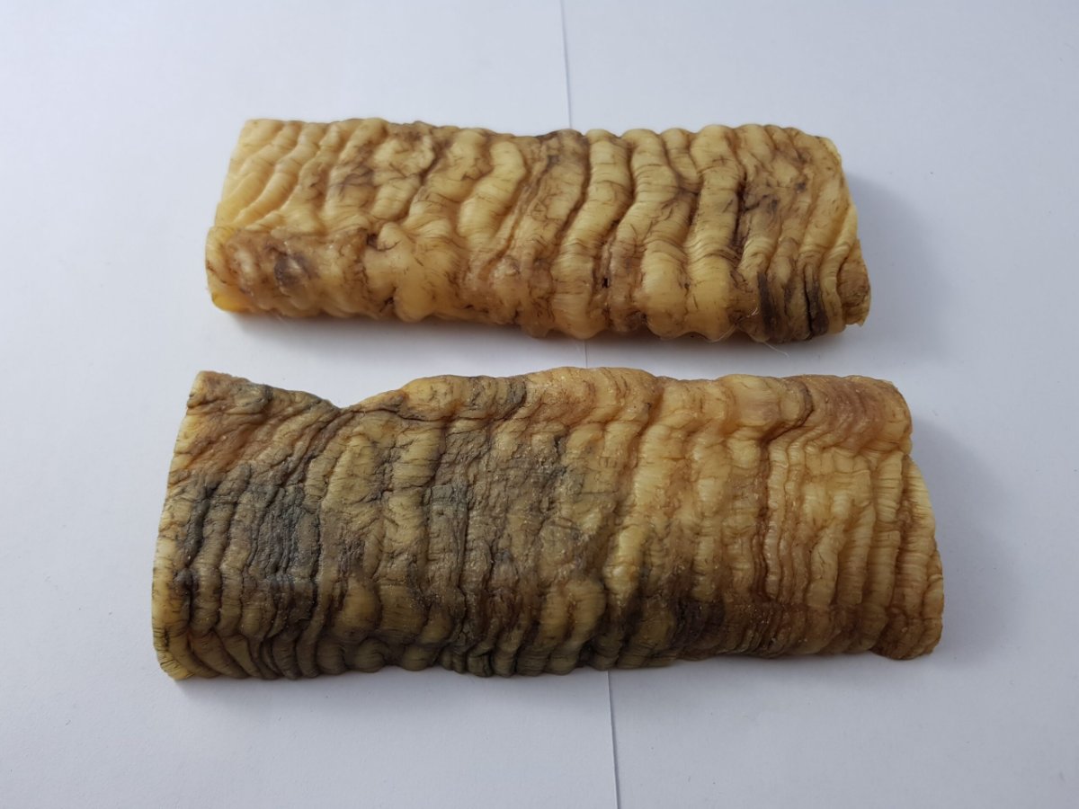

You have some beautiful supplies of wood there. I don't have the room to do anything like you are doing, but saw these on a website that i buy from that are knife makers and forgers suppliers. Thought members viewing this thread might find them interesting. 2 Merino Ram Horn Slabs, they would make beautiful knife handles/covers. ::tu::

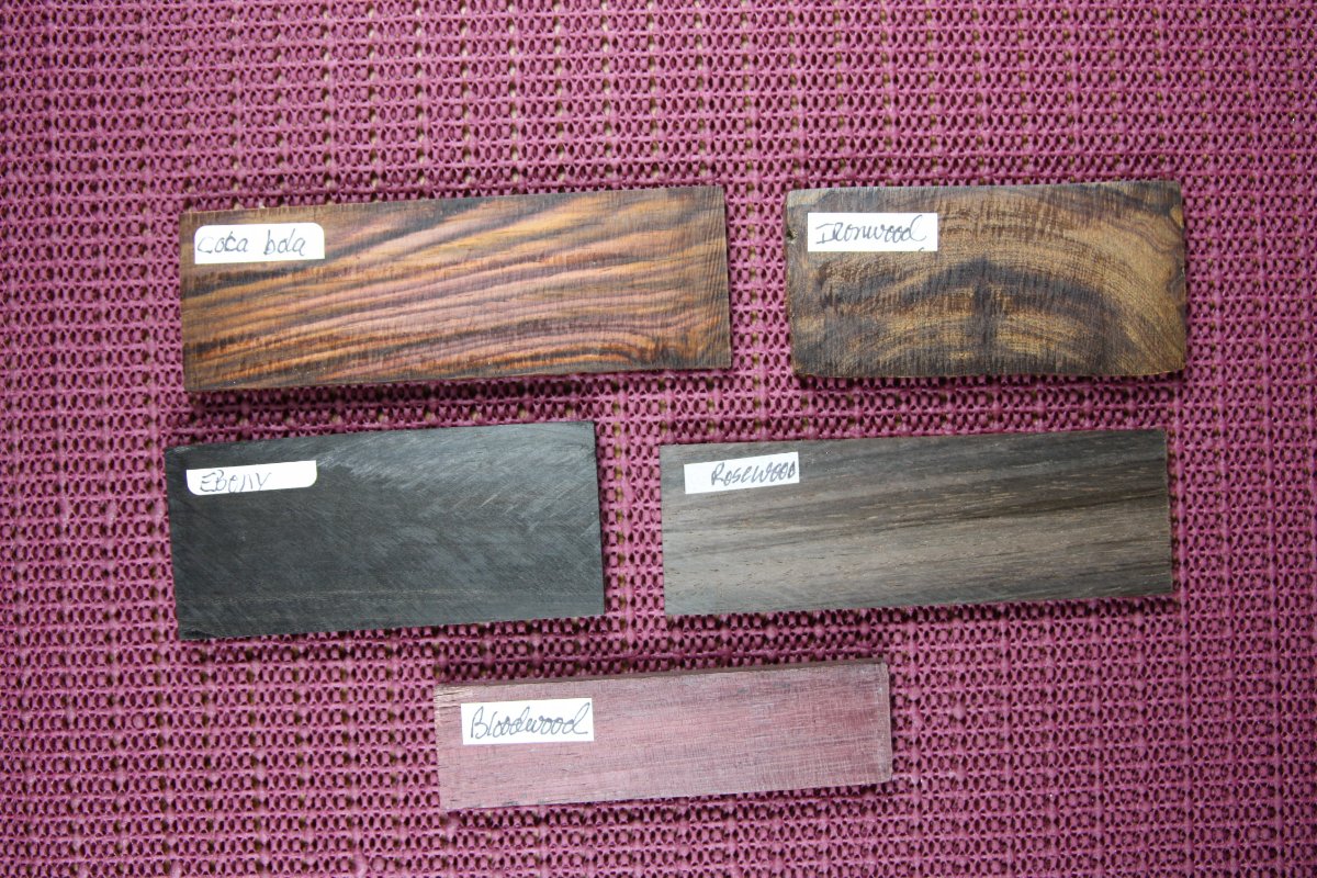

I should have shown some of the freshly cut slabs for comparison. This particular piece of coca bola had more pronounced lighter colored streaking than other pieces I have had.

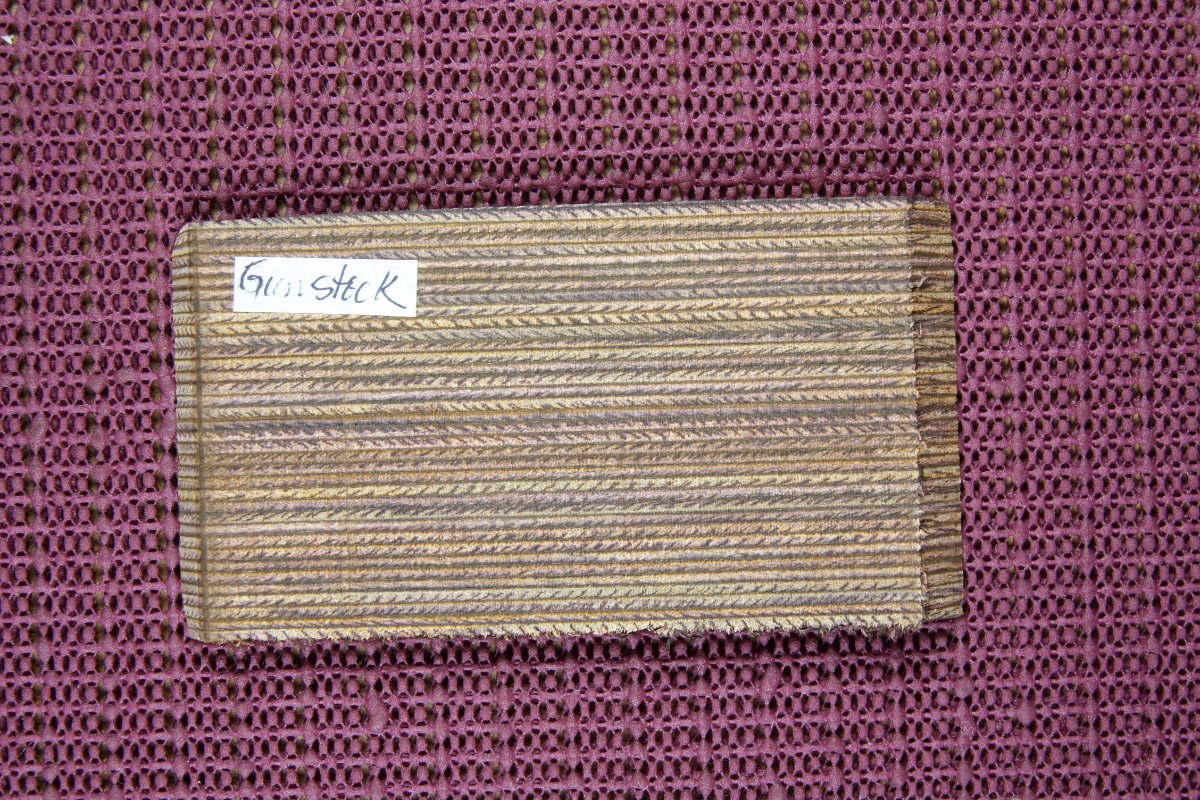

And the gunstock, scrap cutoffs from laminated rifle stocks.
Yes, the rams horn is some interesting stuff. I have worked American Bison horn, and water buffalo horn, but as yet no rams horn. I also have had some Australian lacewood that I made a turned pocket watch from. As I remember it, that wood was difficult to work, wanted to splinter and required a lot of sanding to get a good surface.

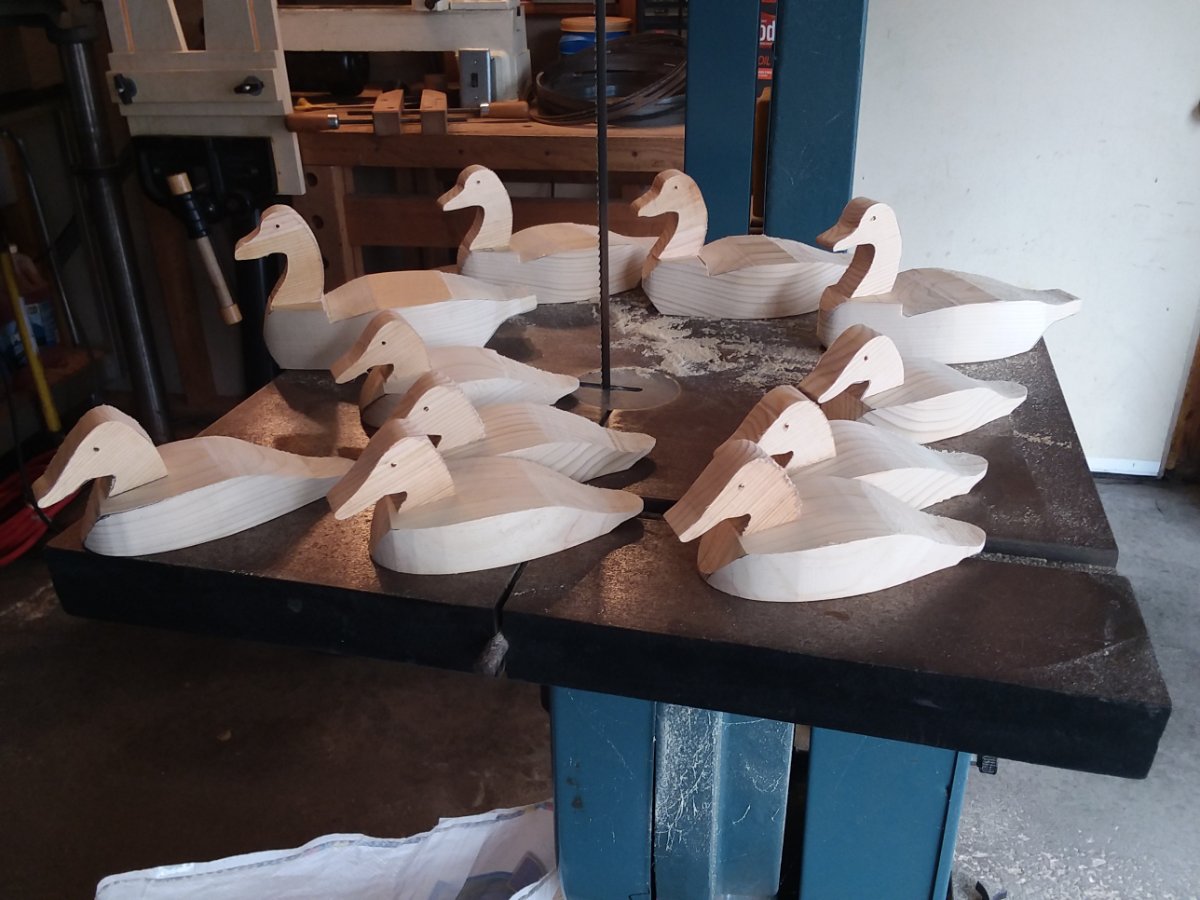

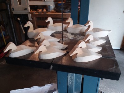

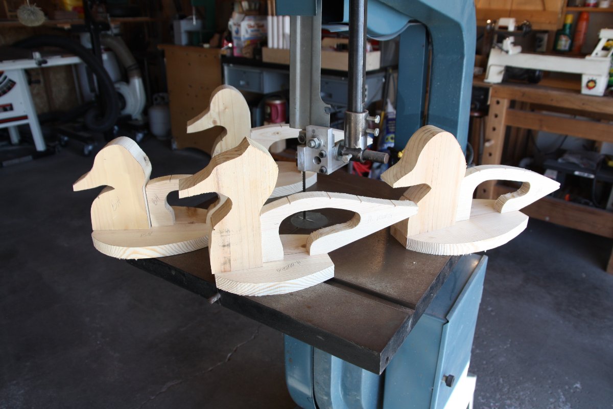

I had the 18 inch Reliant bandsaw running yesterday cutting out some more duck decoy parts. These will be the wire and canvas decoys which have 3 pieces of wood in them. Bufflehead, Hooded Merganser, Redhead, Goldeye. With this style of decoy, there is less carving, but more time spent on "dressing" the bird with the wire and canvas "outfit".
Posts: 23918
Re: Bandsaw work
It will be fun to see them when you finish them OC. ::nod::

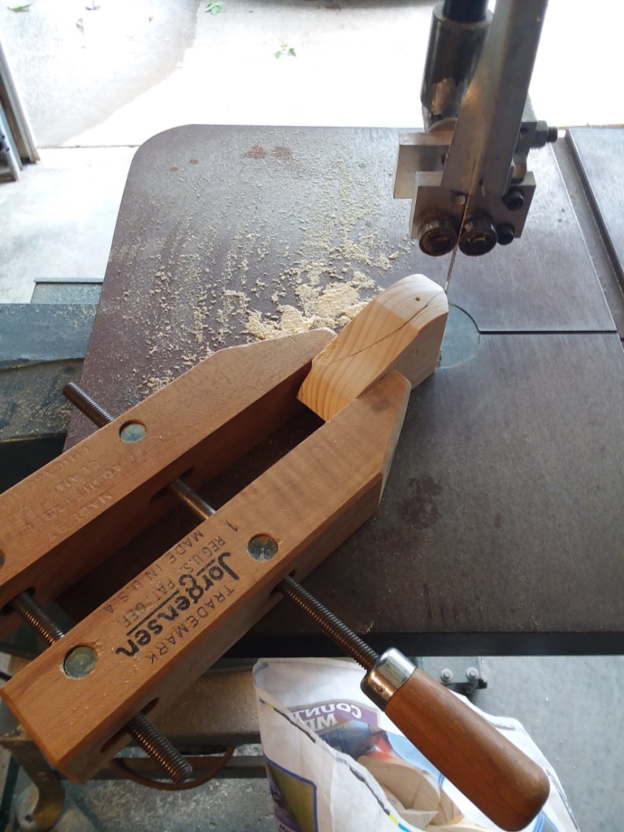

I cut out these mini ducks and geese today to have some on hand for carving over the winter. Note finger saver used to hold the small pieces.
Posts: 23918
Re: Bandsaw work
Can't wait to see them when they are finishef. ::nod::
