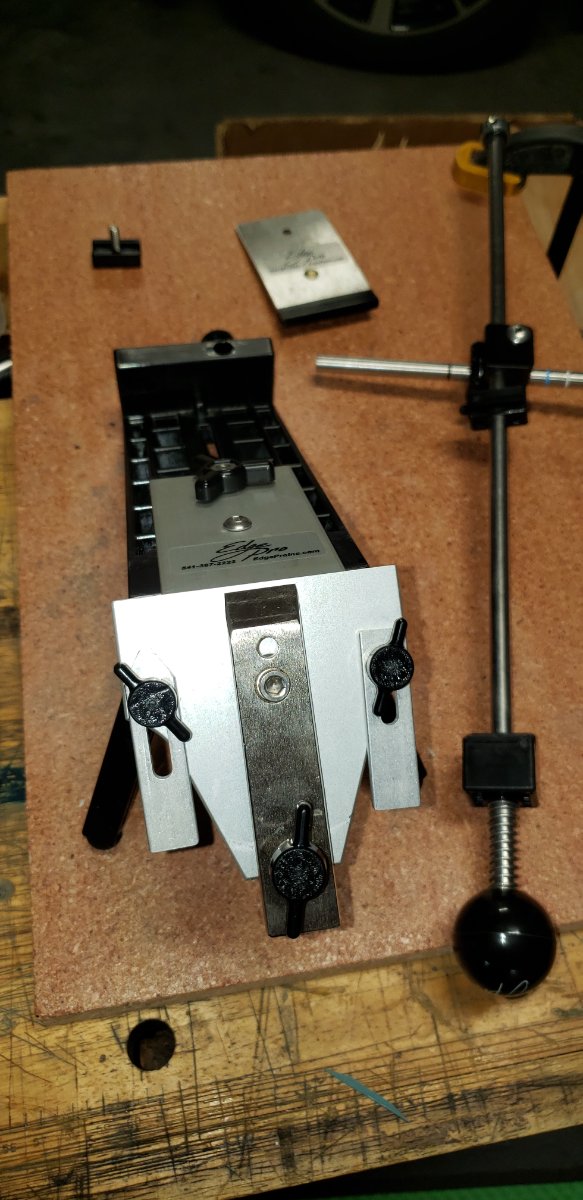

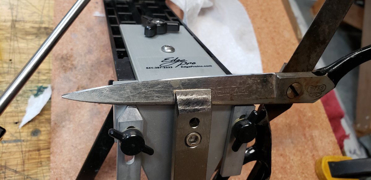

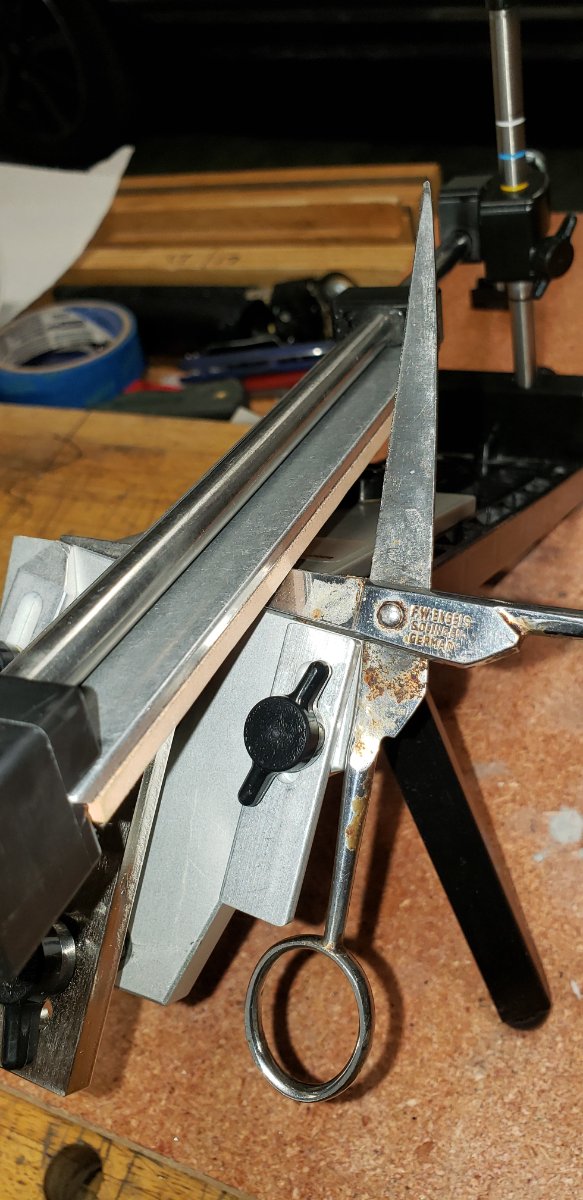

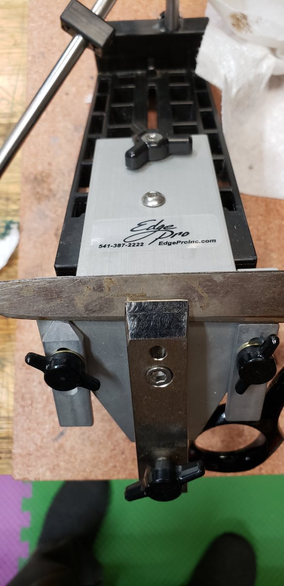

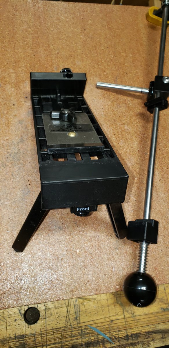

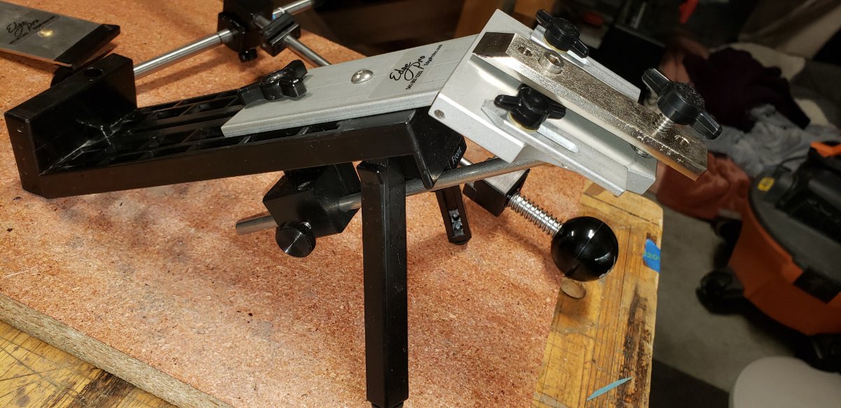

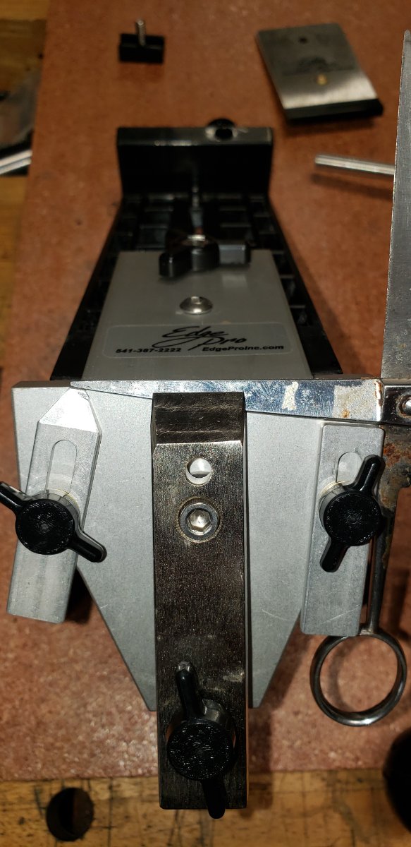

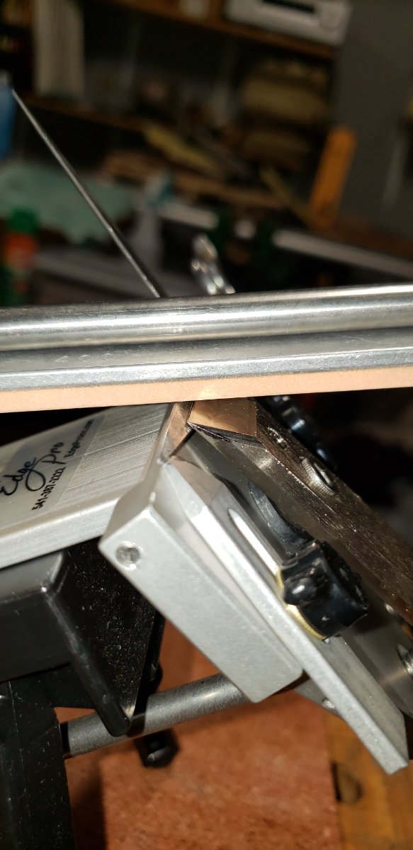

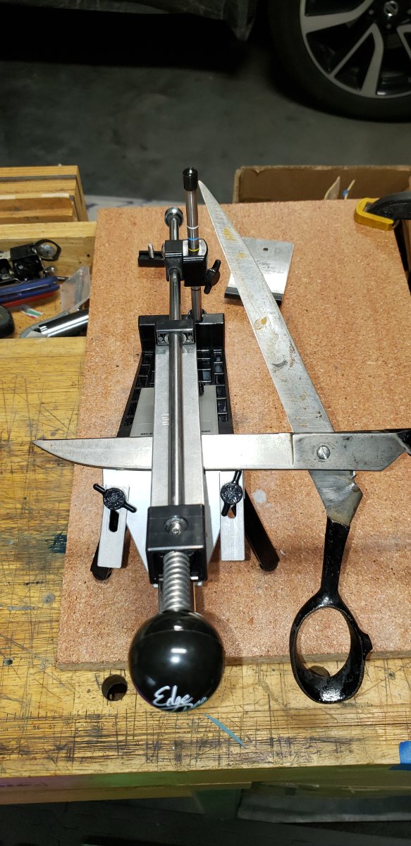

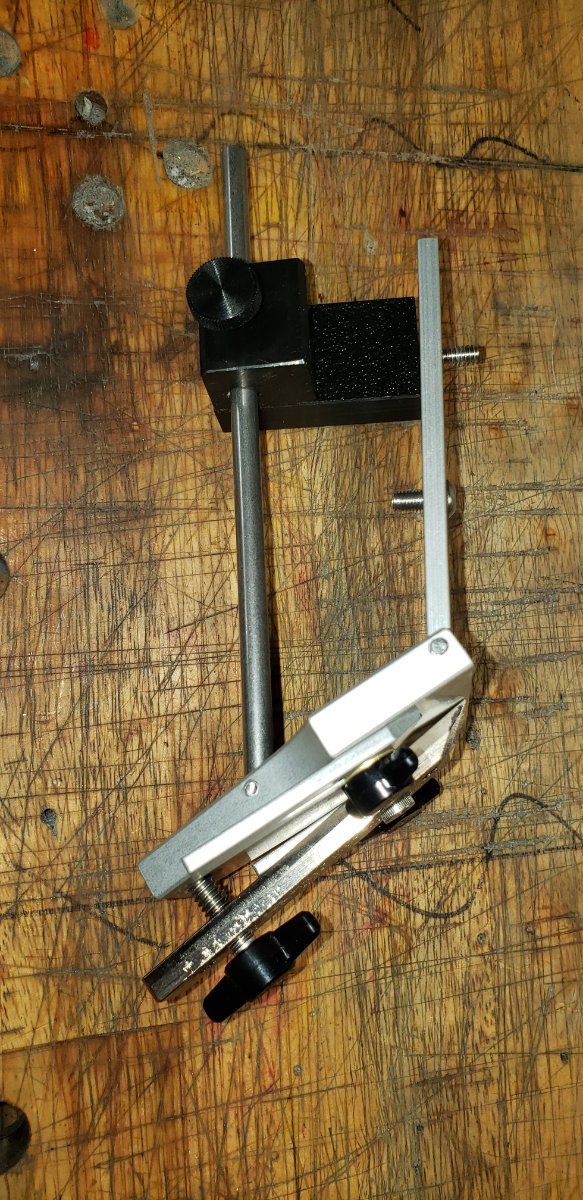

Here are some photos of the scissors sharpening attachment setup.
Unfortunately, my captions do not render correctly, so please bear with my (hopefully logical) sequence of photos, first showing the bare blade table of the Edge Pro Apex unit, then the un-mounted scissors sharpening attachment lying on the benchtop, followed by the scissors attachment installed on the blade table, followed by couple views of a couple pairs of scissors mounted into the attachment and ready for sharpening.
On a couple of these photos, the stone arm has been removed.
Thanks for reading..!
Mark
Mark

kootenay joe
- Posts: 13373
Re: Edge Pro Scissors Sharpening Attachment
Mark, thanks for posting these pictures. They show the scissors 'set up' very well.
kj
kj
