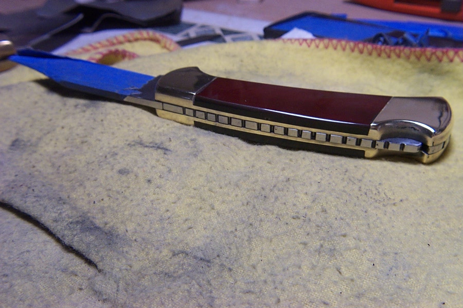

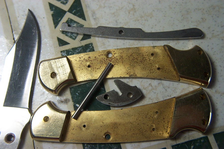

Buck 112, This is addicting
Muskrat man, I went and done it, I have done some simple file work on the main spring, This is addicting, the knife is going to look pretty good. I will put some (Water Buffalo Horn Red scales) on the knife should get them today. I have some time in the knife now but it will be worth the self satisfaction. I can learn by mistakes but would you mind giving me some pointers on puting it back togeather. I plan on using hidden pins. My big concern is the pins at the blade and main spring? The bushing in the blade looks to be in good shape so i will use it, is this a problem, should I add spacers so the blade works smooth on opening and closing? The pin for the main spring seems to be stainless very hard. I hope I am not out of line with Questions but this is one heck of a resource. Thanks for any info and if not I understand.

looking good. on reassembly you can use the original bushing, just use a slackener and hit the pin to spread it inside the bolster, not just a peen do likewise on the two butt pins. the rocker pin you can cut down and peen on each side but don't overpeen it or you will crack the liner, just enough on each end to keep the pin from moving out of place and the liners spreading apart. If it was out of line, we wouldn't have a forum here regarding it

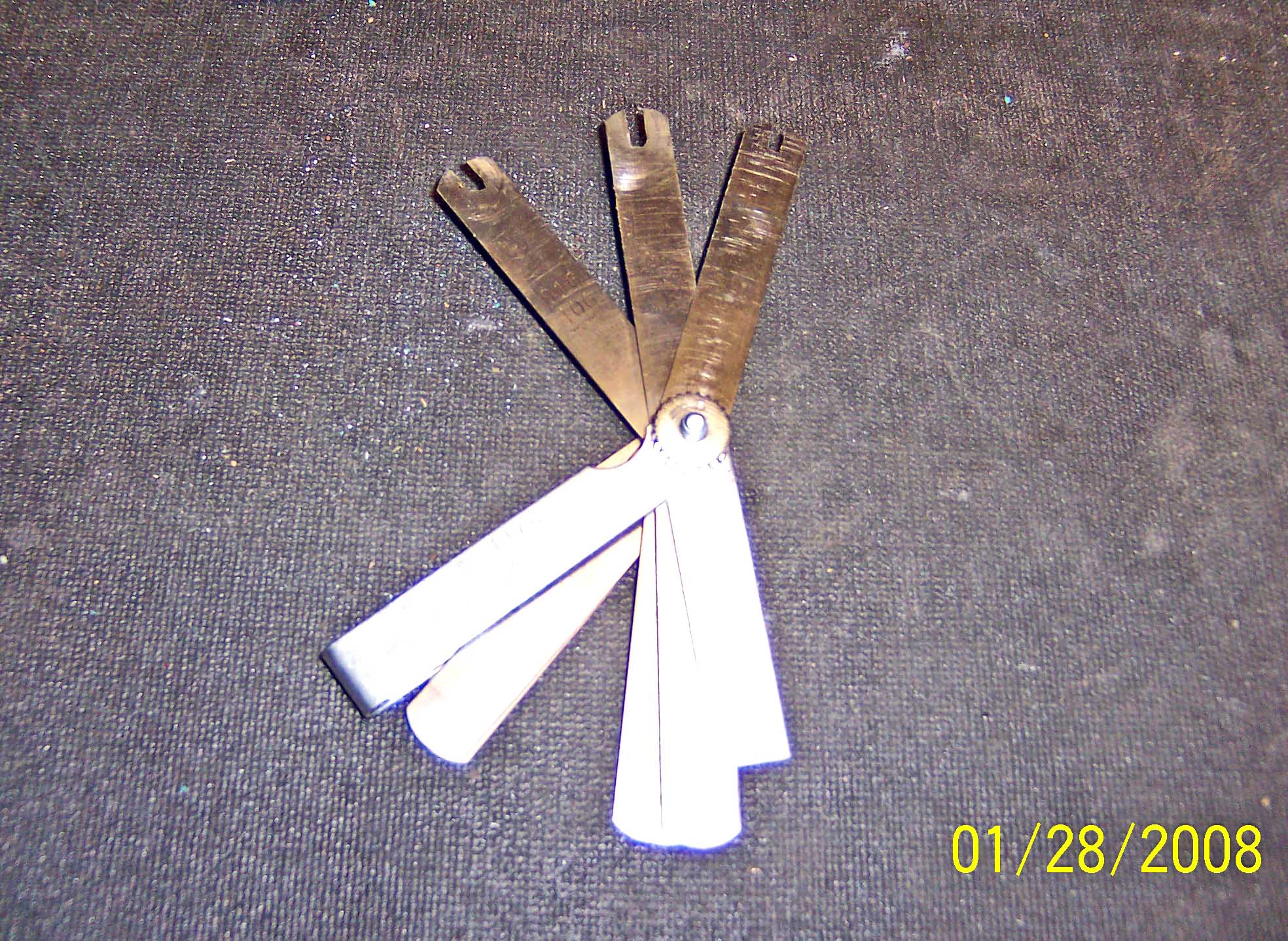

A slackner is a tool that is used to keep the knife liners from pinching the blade so tight it won't open after you peen the pivot pin.
You use it to leave a bit of a gap between the blade & a liner.
Here is a slackner I made.
I used a set of feeler guages & cut a slot in the end of the ones I use.
These are .016", .014" & .013" but you will have to ask MM what he means by "medium." I would guess about .013" if I had to guess.
You slide the slackner around the pin (hince the notch cut into the feeler guage), and hold it there while you peen the pin.
I think what MM is saying is you have to smack the snot out of the pin to get it to seat properly in the hole.
I try to get the pin mashed evenly down around the hole and onto the bolster.
I hope this helps,
I hope this helps,

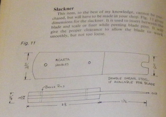

Hey Nobull,
I use a .015 feeler guage, with a notch cut in the center, so's it will slide past the pin. By medium slackener, MM may be going as thick as .020".
It keeps the liner/bolster from pinching the blade so tightly, that it won't open or close.
A picture's worth more words than I know... here's Ben Kelley's.

medium for me is about .012 slackener. I normally use a .007 on regular slipjoints. I can never get the play out of the action when I use a .014 or .015 slackener

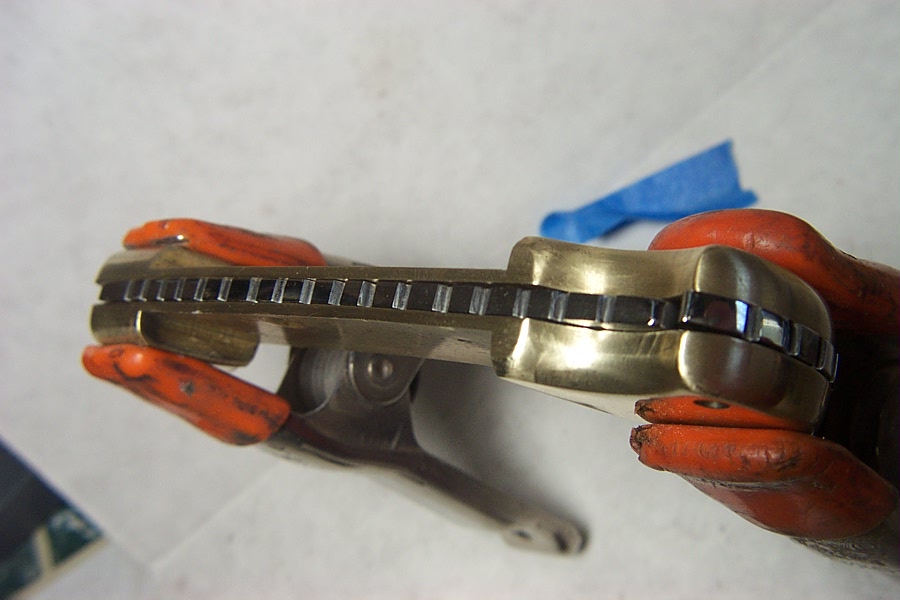

Handles are on
First off I want to say thank you guys again. Save me a lot of trail and error. I did get some snot, but it was not from the pins. I made a mess with the epoxy and I didn't have enough hands. I used a .012 slackener and it worked very well. A little tight but work some valve grinding material in to the blade and bolisters and its like oringinal, walks and talks with good snap. Got into alittle trouble, we were going out to dinner the night I was installing the handles. I just kept a saying yes dear. We made it but alittle late. I will take another photo when I detail the knife and blade.
