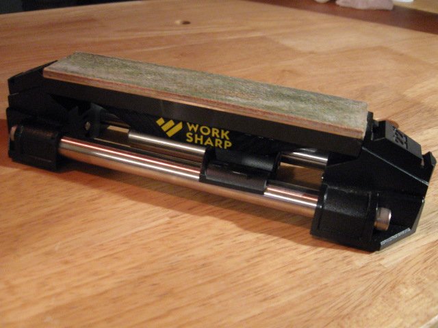

My new CopperLock has been put through its initial testing. Though it didn't do too badly, there is room for improvement. I got to thinking that it may be best to save my current pocket-friendly gear for use in the field or dire emergencies. So I'm considering the purchase of gear that is more of the bench-top variety.
Oil, water, or dry matters not to me. If the angled jobs offer great benefits, I'd like to get one of those. I'm looking for something that would be good for many types of steel, rather than excellent for one or two.
Does anyone have any recommendations, be they specific or general, for a setup that might work well for me!?

IMHO this is all you need. viewtopic.php?f=113&t=66841. The more I use it the better I like it. FYI in my review of it I mention that I also bought the upgrade kit which consists of three additional stones (different grits than what comes with the basic kit). My recommendation would be to hold off on buying the upgrade kit until you’ve used it for a while. I’ve never needed to use the extra stones in the upgrade kit to get the edge I want. I have tried them all though, more out of curiosity than need.

I use one of those too and I also like it. The Pivot Response System (stone tilt feature) really works. It's not just a gimmick like I thought it might be. I do like the strop that comes with the upgrade kit.Mumbleypeg wrote: ↑Tue Apr 13, 2021 11:44 pm IMHO this is all you need. viewtopic.php?f=113&t=66841. FYI in my review of it I mention that I also bought the upgrade kit which consists of three additional stones (different grits than what comes with the basic kit). My recommendation would be to hold off on buying the upgrade kit until you’ve used it for a while. I’ve never needed to use the extra stones to,get the edge I want. I have tried them all though, more out of curiosity than need.

I watched the video in the thread Ken gives a link to.
Ken you say "I sharpened seven three-blade pocket knives and a fixed blade," in about the time it would have taken you to sharpen 1 or 2 knives using conventional stones.
I cannot see why this Worksharp device makes sharpening so much quicker. Either way you are moving the blade edge over the stone so what makes it so much faster with the Worksharp ?
Also how long does the 320 grit stone last before it is not abrading the steel as well ?
In the video the guy strops at a larger angle than he sharpened at. I have always stropped at a lower angle (almost flat on strop). Maybe i've been doing it wrong ?
kj

I think the reason for my being able to sharpen the knives quicker is the Diamond stones. I’ve only previously used carborundum and Arkansas (natural) stones. Plus the Diamond stones were new. They just cut quicker than what I was accustomed to. One thing I’d point out is that the video is starting from a fairly dull knife, at least he followed the instruction set assuming so and therefore required significantly more passes on the stones than the knives I sharpened. If you notice on the video he remarked about how quickly he was able to go from a knife that was dull (cut paper with difficulty) to a shaving edge. So apparently he thought it was faster. (Compared to what, he doesn’t say however).kootenay joe wrote: ↑Wed Apr 14, 2021 3:11 am I watched the video in the thread Ken gives a link to.
kj
How long the 320 grit stone lasts I can’t say. So far mine is still working great, and being diamonds I assume it will last for years. As for the angle on leather I’ve always used an angle that is steeper. I want to feel a very slight drag and see that “drag” on the surface of the leather. Not sure exactly how to explain it but I know by the feel when I have the right angle. Another way to think of it is when using a leather razor strop the leather is curved when you’re polishing the edge - it sags slightly as you pull the blade across it. In which case it’s near impossible to not be at an angle steeper than you had on the hone. If your angle is too shallow you’re not really polishing the edge, you’re polishing the bevel. Hope that makes sense.

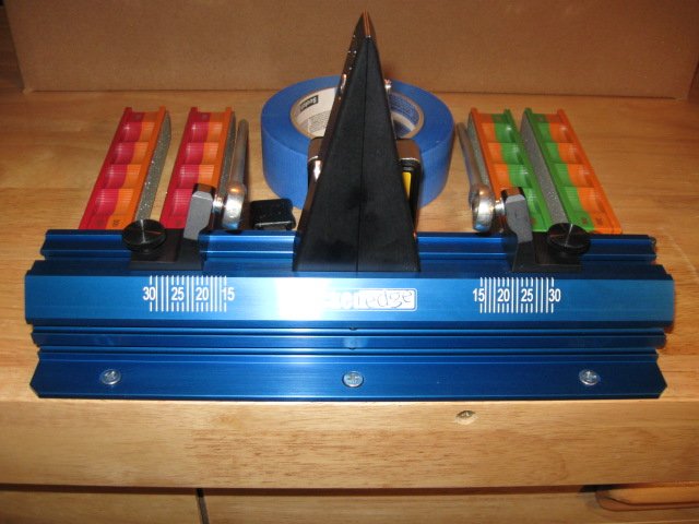

Have a read of Working Edge's Edge Pro Apex 4 sharpening system thread, you will find it interesting.Dan In MI wrote: ↑Tue Apr 13, 2021 8:30 pm My new CopperLock has been put through its initial testing. Though it didn't do too badly, there is room for improvement. I got to thinking that it may be best to save my current pocket-friendly gear for use in the field or dire emergencies. So I'm considering the purchase of gear that is more of the bench-top variety.

As regards rod-guided systems, there are three tiers of cost-to-results ratios.
The lowest price point would be the venerable and time-proven Lansky, which produces a good-to-excellent result, depending upon how much attention the operator pays to nuancing the details.
There are other makes of rod-guided systems in this price class of course, which cost less than the Lansky.
The WorkSharp Precision Adjust fits into the upper end of this tier, at roughly $10.00 more than the Lansky, and is a better value due to the higher precision of manufacture and increased rigidity of the chassis, compared to the other appliances in this price point.
The middle tier would be the Edge Pro systems, which produce an outstanding result without needing to finesse the details, and which produce an even better result still, when the operator is willing to finesse the nuances.
The upper tier is the Wicked Edge, which by reputation is the most precision and effective appliance for hand-powered sharpening. The Wicked Edge also is very expensive.
Perhaps a major determining factor in these three price classes is how rigid the device is, and how accurate are the machining tolerances in the manufacturing process.
EDIT: My opinion... if the budget is tight, and cost-effectivness is critical, for $50 you cannot go wrong the the WorkSharp Precision Adjust Sharpener, a rod-guided system which gives accurate and repeatable results.
Hope this helps..!
Mark
Hope this helps..!

Thanks for the detailed summary Mark.
I think I must have gotten into the Wicked Edge scene just in the nick of time. I paid approximately $225 (can't remember the exact price) for my Wicked Edge Go system but I see that they might not offer that model anymore. Their base model nowadays looks to be quite a bit more money.
The Go model has the basic features of the higher end models while still being compatible with most Wicked Edge upgrades.
