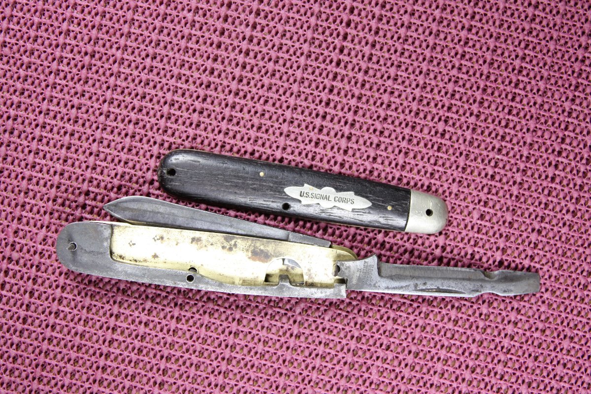

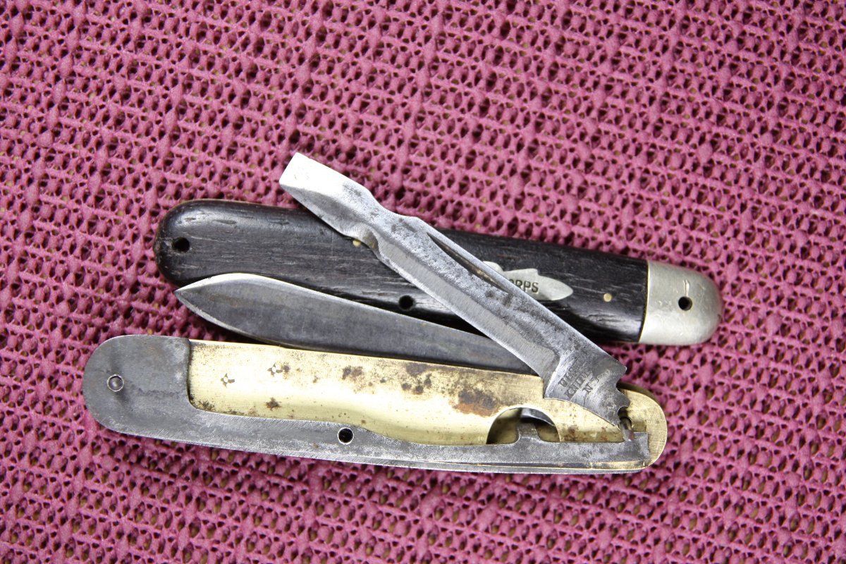

For the benefit of those of you who like myself have not seen or had one of these apart before, its kind of interesting how the locking screwdriver mechanism works on this one. Most of the electrician TL29 type knives have a split scale lock to hold the screwdriver blade open when applying pressure to a screw and keep the blade from folding shut on your fingers. This Ulster used a different lock mechanism, and it surely was the demise of this fine old knife. Some idiot opened the blade and it locked open, then inexplicably when they went to close it could not figure out the method of unlocking and closing the blade so continued to try to force it closed until the blade was broken. If you look carefully at the pictures, you can see that the spring that works the screwdriver blade has an extension that protrudes thru a cutout in the center divider underneath the master spear blade. Once the screwdriver blade is open, it locks by a notch in the tang of the blade (which is broken off now) and a hook on the end of the spring as seen in the later Buck 110. But instead of having a lever that is depressed like the Buck, this Ulster used that protrusion of the spring to unlock the screwdriver when the master blade in the closed position was pressed down. Now to see if I can find a replacement blade to fix up this fine old knife.

Thanks OC for the tutorial. Very interesting. Hope to see it when you get it fixed.

Thanks for showing the internals of that guy.
Are you going to maybe weld up the tang and re-drill it or something?

I might give that a shot if I can't find a blade.Meridian_Mike wrote: ↑Thu Apr 08, 2021 9:38 pm Hmmmm...

Interesting. It seems like you’d have a tendency to squeeze the blade while using the screw driver and inadvertently unlocking it.

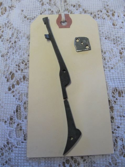

That spring reminds me of a knife I did some time back. Only the spring was the thing that was broken.
I still don't know how I managed to reproduce it, but it worked and the knife went back to it's home in one piece. That spring also had a corkscrew working off of it...Here's the broken one.
