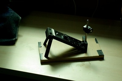

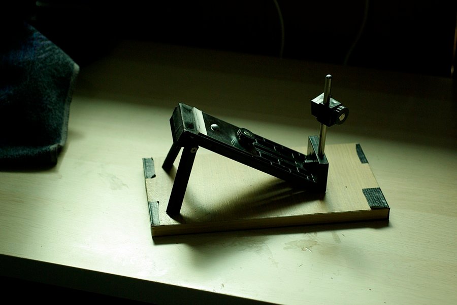

Is this it ?
I got 3 for the handles .. I hate changing stones ..
If I see them going cheap again ( discounted ) I will buy two more for the handles .
A little tricky to use , but take your time and constantly check how your holding the knife and you should put down a very nice edge .
If this is the one ? ::hmm::
Mod ) I screwed mine down onto a flat board - as is = Rickety as all heck !
Screwed down to a flat board really makes for a solid platform . If mine were not screwed down , I would throw it away . ( Rickety as all heck )

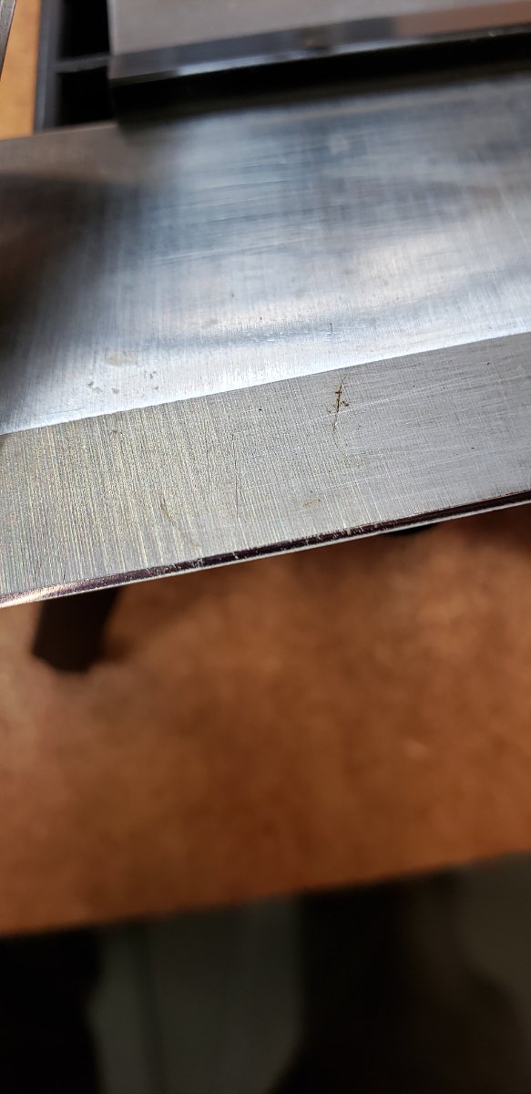

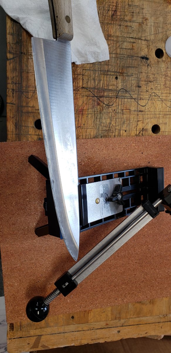

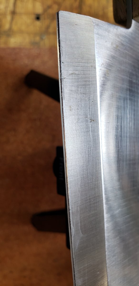

My very first project with the Edge Pro was a large Japanese chef knife, which needed a lot of grinding to remove a whole bunch of chips from the edge.
After setting the cutting angle by a short sequence of trial and error with the sharpie, the Edge Pro's 220 grit stone made short work of re-forming the bevels, using the factory angle.
Changing the cutting angle is quick and easy, just a quick verical adjustment to the stone arm pivot hieght.
The second photo shows the correct cutting angle, as evidenced by the stone wiping the sharpie ink from the full width of the bevel.

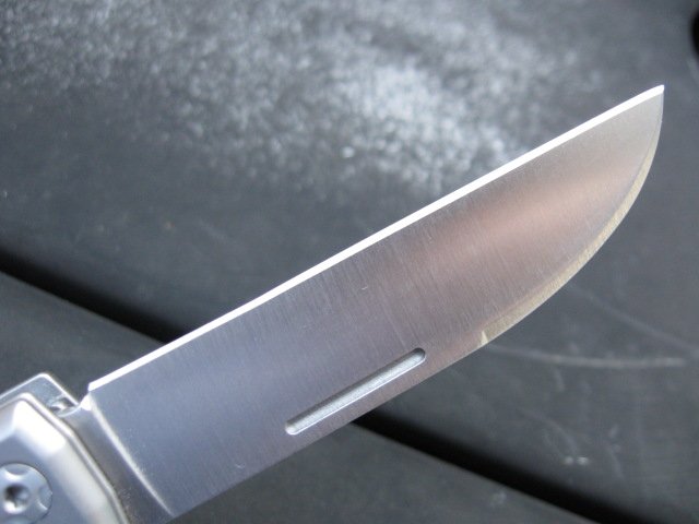

The next pic (sort-of) shows the fully polished bevel on this now dastardly sharp chef knife, which is, much as I hate to admit, significantly sharper than I would achieve freehanding. :oops:
Paper-thin slices of tomato, and a quick slice of my knuckle from hardly even grazing against the edge..!

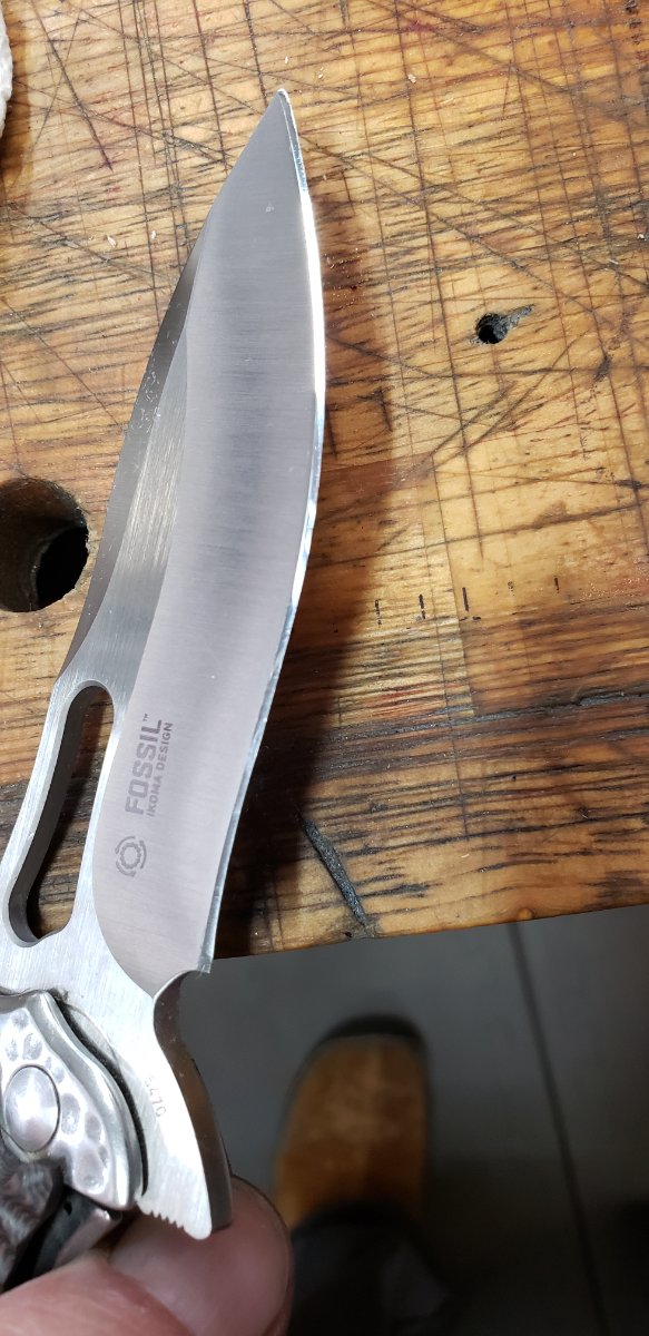

Next up was my C.R.K.T. Fossil, which was a challenge to hold steady on the machine's blade table, due to the shape of the blade faces, with their steep hollow grind.
Note the polished bevel on the Fossil, which is now sharper (ahem) than ever before.

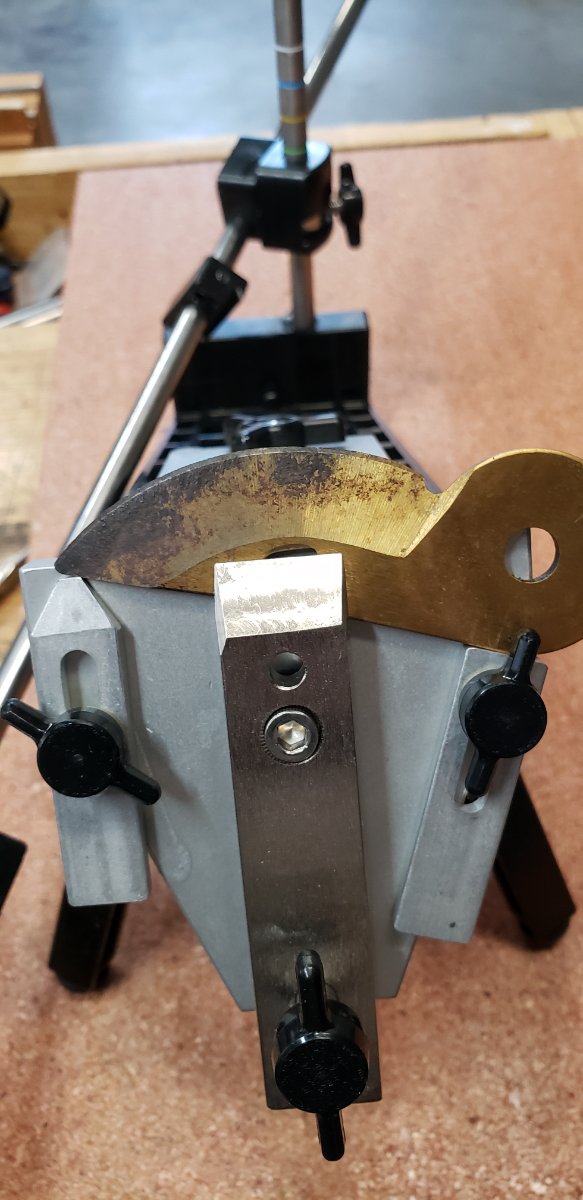

The magnetic insert attachment is an Edge Pro optional accessory which greatly helps the user to keep the knife steady on the blade table...highly recommend this attachment.

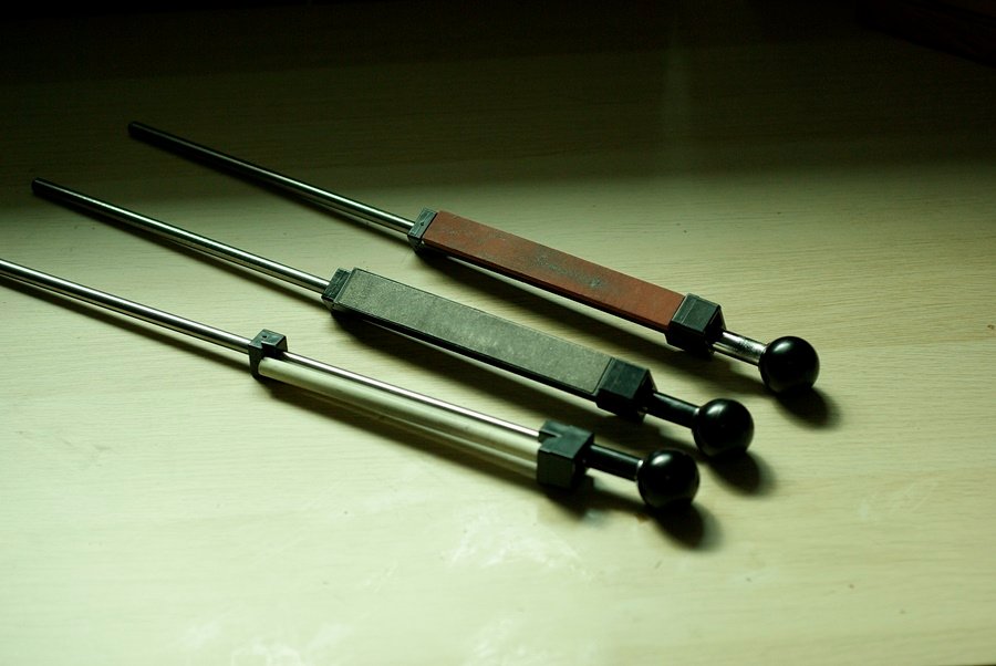

Mounted on a wood board . Makes for a nice solid foundation .
3 handless - Stone / Diamond / Ceramic Rod .

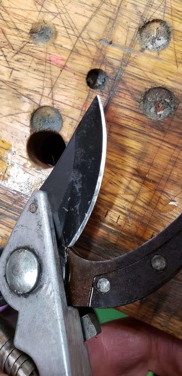

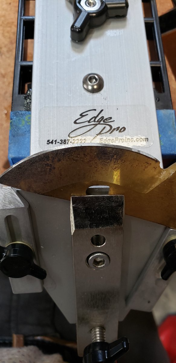

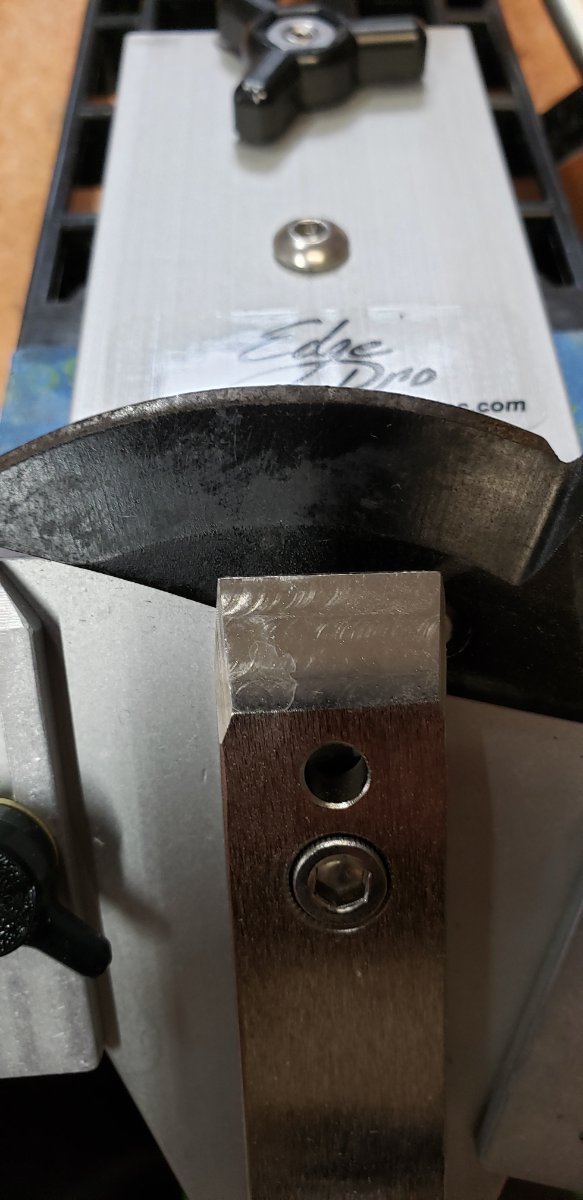

Sharpened two pruning shears with the E.P. scissors attachment, below are before-and-after photos.
Took more time to disassemble and reassemble the shears than to set up the E.P. and sharpen the blades, for sure.
My wife proceeded to test the two shears after sharpening; she's happy and so am I..!!!
