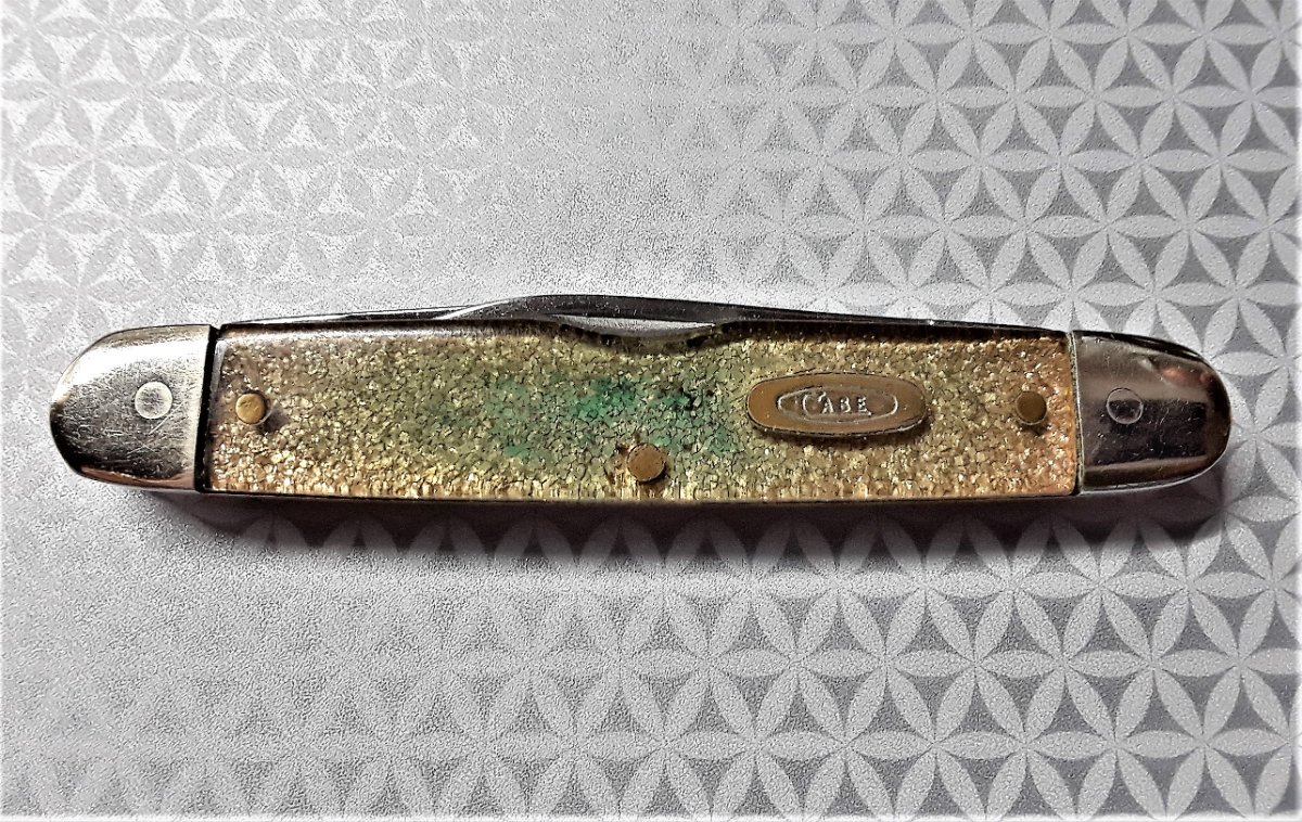

This is a CASE Centennial Penknife that I've had for some time. As you can see
the metal flake (or whatever it is) under the clear celluloid handle is starting to
discolor. I'm looking for recommendations as to whether I should leave it alone
or remove the handles and replace them with something like a smooth bone or
maybe Micarta. And of course I want to try and save the CASE shield.
Anyway I know there is a big difference between the Knife Kits I've been doing
and what I'm asking here. I think my skills are up for it, I'm just undecided yet.

At the very least, I would remove the scales. It might look horrible, but you're preventing it from getting any worse.
I may sound paranoid, but I've dealt with the aftermath of one knife outgassing for at least 2-3 years unchecked in my Granddad's collection destroying the Boker Stockman and causing quite severe damage to a dozen knives stored near it, and caught a Buck Creek before it went bad.
By the way, this Kirinite is a close match to the original scales but is acrylic. It is also stable.

Definitely outgassing.
I would remove the celluloid.

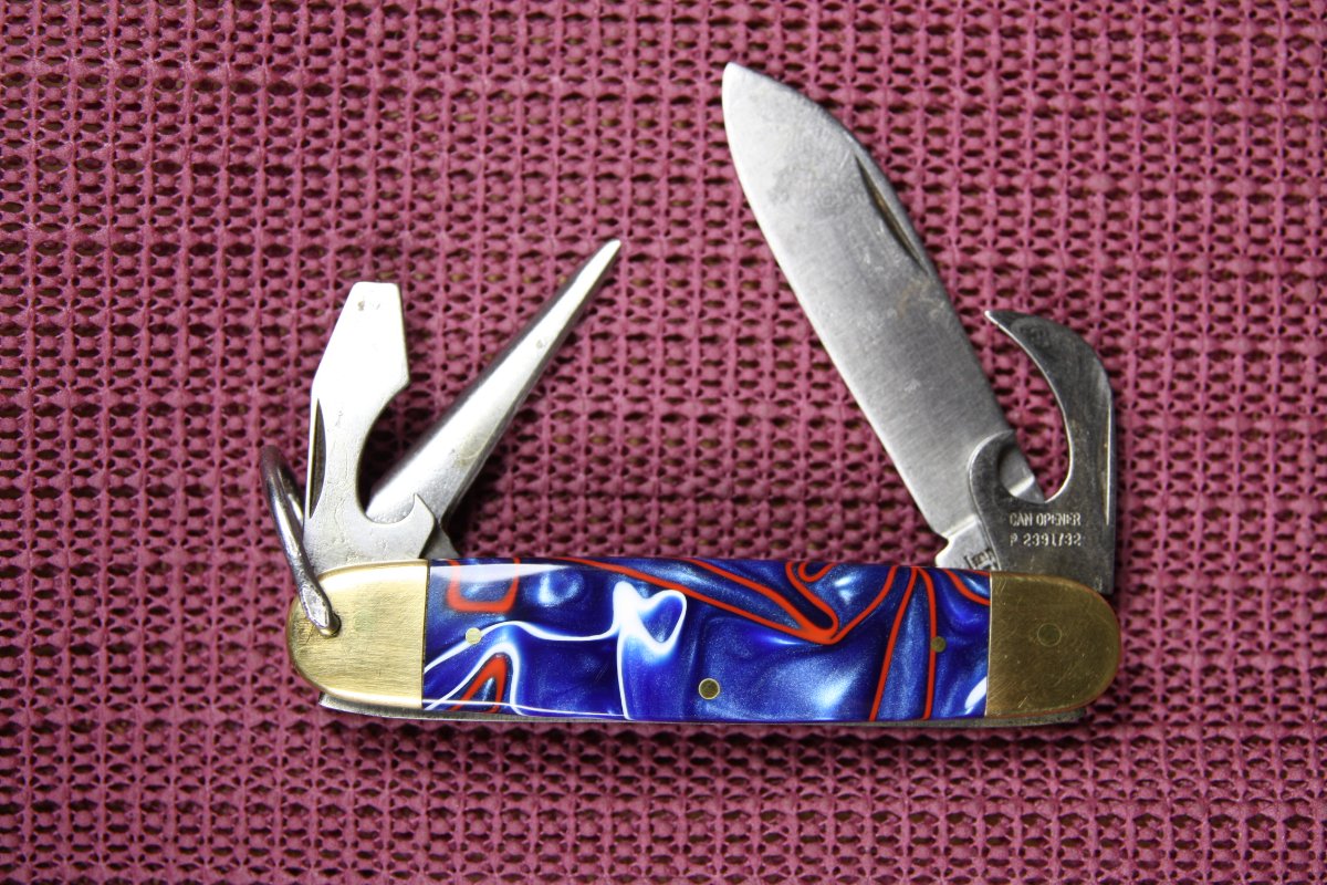

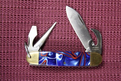

Kirinite is a good choice for a rehandle. Its easy to work, tough and looks good and comes in many colors and patterns. I used Kirinite Patriot on this Kamp King that I did a full conversion to brass bolsters and scales from the shell handle original.

Thanks for showing your knife. It looks like you did a very good job on it.OLDE CUTLER wrote: ↑Sun Apr 04, 2021 11:03 pm Kirinite is a good choice for a rehandle. Its easy to work, tough and looks good and comes in many colors and patterns. I used Kirinite Patriot on this Kamp King that I did a full conversion to brass bolsters and scales from the shell handle original.

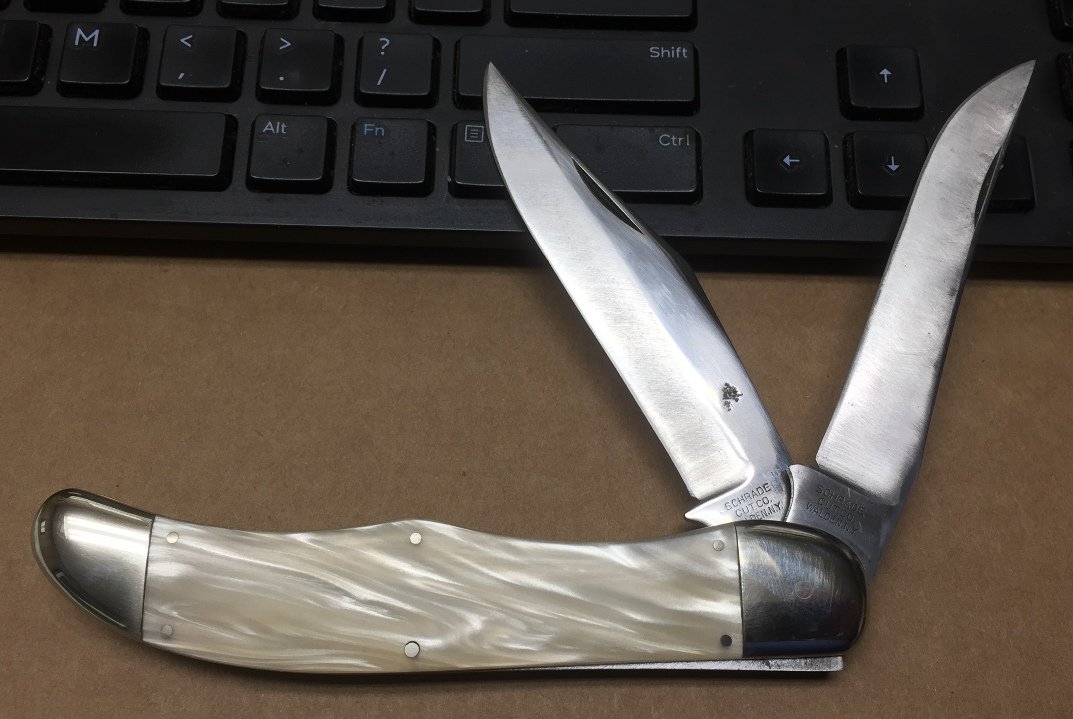

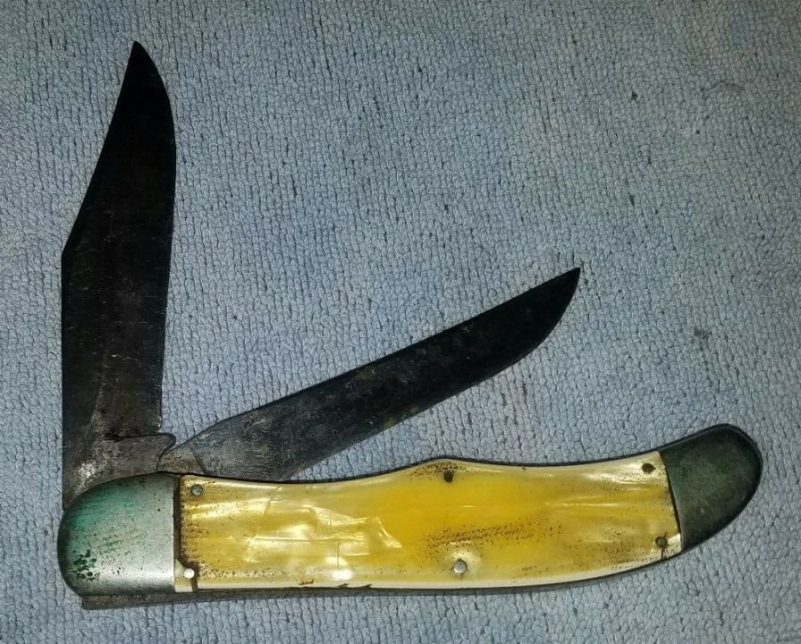

I used Kyranite on this old Schrade hunter.....cody6268 wrote: ↑Sun Apr 04, 2021 10:53 pm Kirinite is a material I used to say "looks dumb" for many years. As someone getting into knife repair myself, the more I like it. Celluloid outgasses. Real pearl is stupidly expensive. Stag and bone look good, but if one is trying to make a knife look as close to original as possible, that's not good. Also, both choices are expensive. Some woods are as well. Kirinite does match the old patterns of celluloid quite nicely, all the while being perfectly stable.
before..... after......
I used the Kyranite because I thought it looked closest to the "mother of toilet seat" type of material used originally.
BUT.... Kyranite does make a NICE knife handle cover!
SO... I would vote for Kyranite.

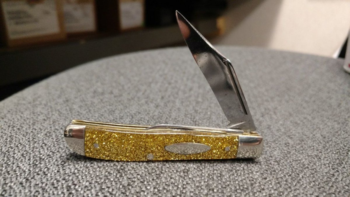

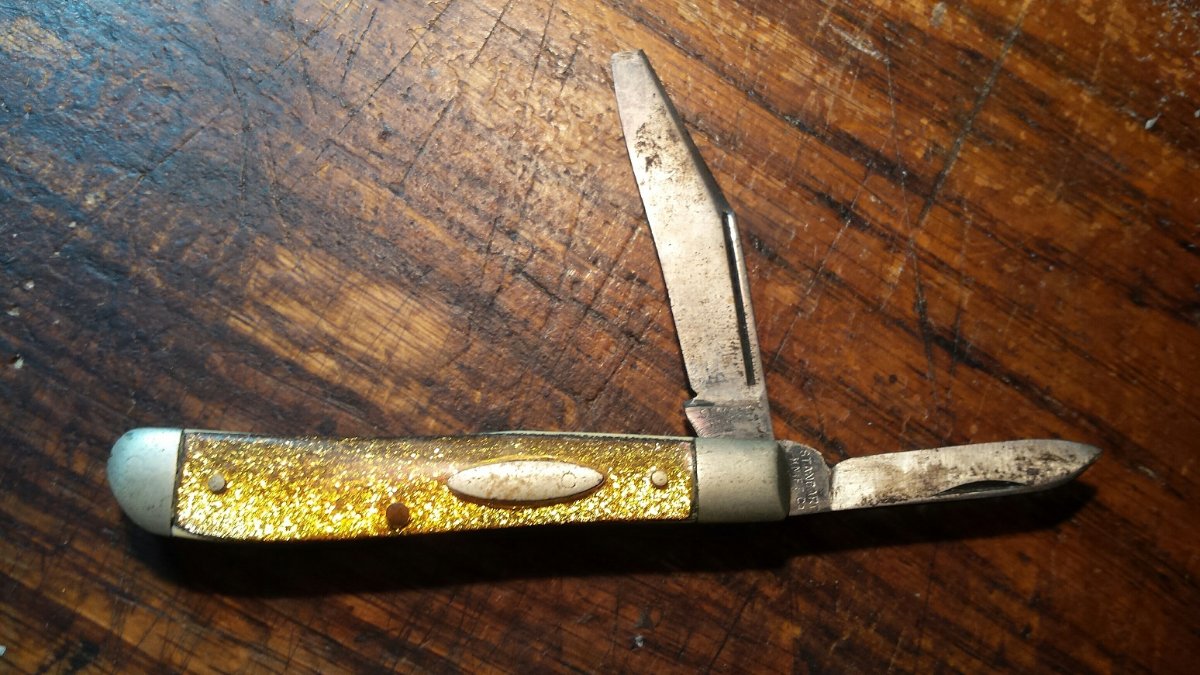

Here's one that I saved with that exact color kirinite. Don't think I could have found a closer match...
Before After
Can't wait to see what you do with yours!
Before After

That yellow glitter Kyranite is some FINE looking stuff.
You did a great job on that knife Glenn!

Glenn, that is a beautiful job. I hope I can do the same. How hard or easy was it to put the shield on the new handle material?
David Roberts
Prayer Changes Everything
- glennbad
- Posts: 8174
- Location: NH
Re: Now or Never
Thanks, I'm sure you'll do a fine job! Shields done by freehand (no template) are more difficult for sure. They can be done, just takes more layout, constant checking and rechecking as you go.
