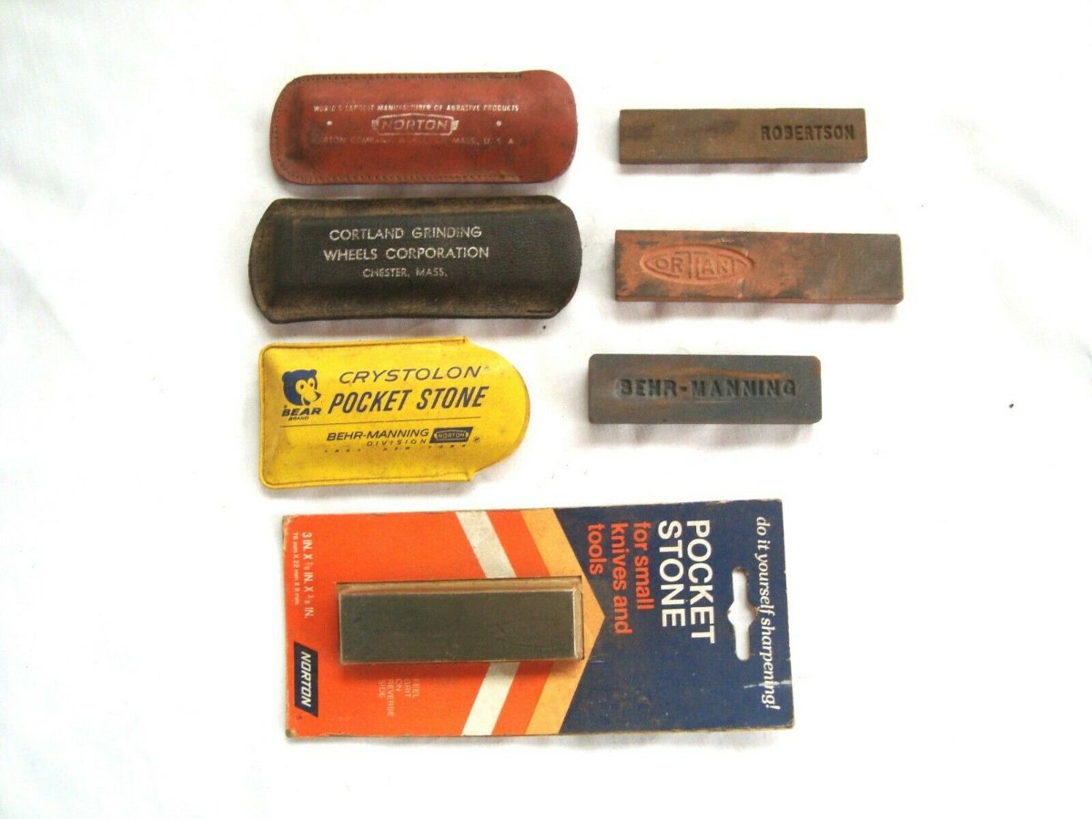

Usually, I make a point to NOT buy used sharpening stones. I put a pretty low bid on these synthetic Norton stones, as the seller had a couple of other items I was also meaning to purchase but lost the bids on both, and forgot about them. These four stones ended up costing me almost $20.
They look loaded with metal, not much different than the same Norton of this type I've had since I was a teenager. One Norton stone is new, but they aren't expensive. I have one in my toolbox, and it cost like $5. I figure that the sealed one is still perfectly usable and that if I clean the others good enough, they'll be handy to have for quick sharpening jobs as needed.
Are these salvageable, or am I out $20?

Those small stones are salvageable. If you want to clean them I would suggest putting them in very hot soapy water a time or two and maybe scrub them with a green kitchen scrubber. Although they look usable as they are.
Because they are small stones they haven't been used very hard.

Re: Salvageable Stones?
On old used stones that are really grimy with caked on sludge and steel/grit slurry embedded in the pores, I give them a blast with some spray can brake cleaner before soaking them in the mentioned hot soapy water. It will take off some of the really heavy stuff first and speed things up. Do this by laying the stone out in the middle of the street and blasting it, one side and then the other. Take the usual precautions when using brake cleaner.
