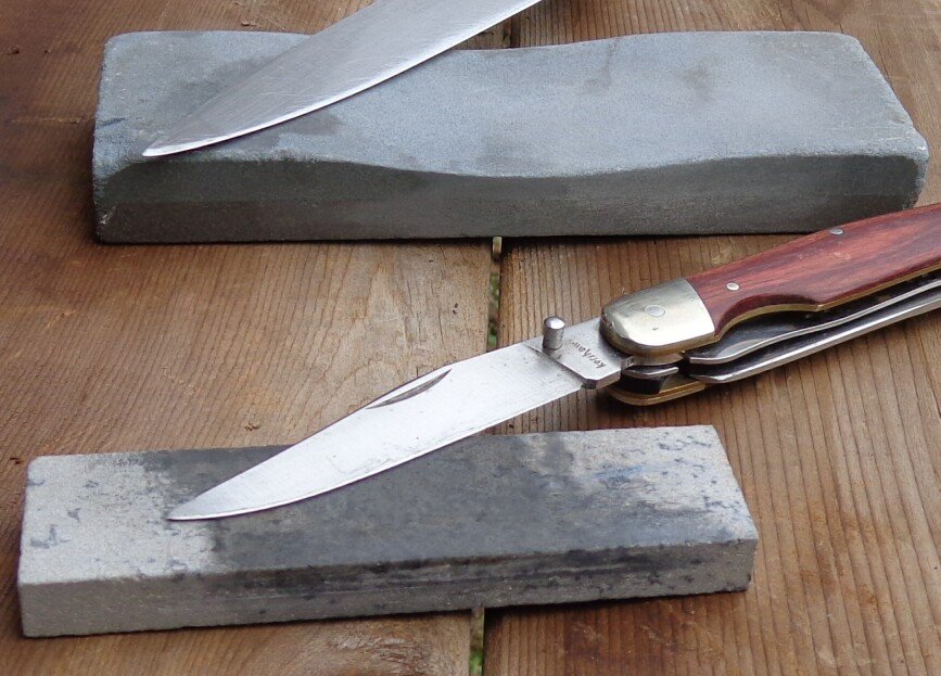

It sounds as if the knife may not have a good bevel on the edge. When I get a knife that is dull, one that I have never sharpened, I start with a very coarse stone. Much more coarse than a soft Arkansas. One of those big old combination stones from the hardware store like the one at the top in this photo.
After I have got a decent bevel on the blade I usually switch to a soft Arkansas like the one at the bottom.

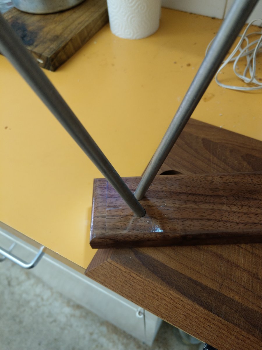

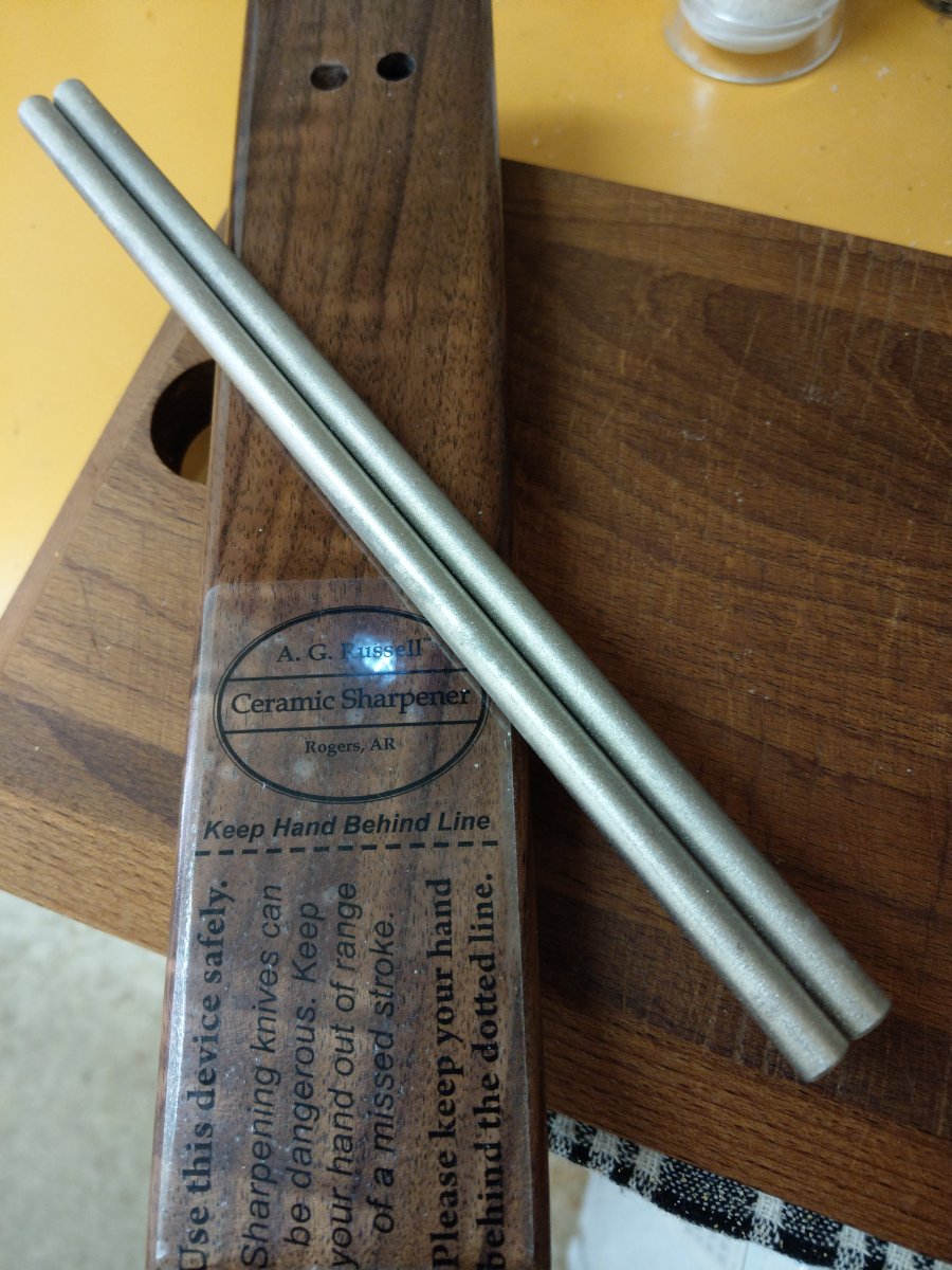

Mark, just posting my A G Russell diamond crock sticks. If you are looking at purchasing some, i would suggest getting the whole kit, box and rods, works out a lot more economical. The box is really well made and stores the sticks. Has a 15 degree angle, i don't know what you are using now, but if you have a lansky set, this will add another angle to sharpen with. You would then have 15, 20, and 25 degree angles, this will give you some more micro-bevel angles as well.Working Edge wrote: ↑Sat Mar 27, 2021 3:12 amCudgee, that diamond crock stick is a great suggestion...!!cudgee wrote: ↑Fri Mar 26, 2021 9:54 pm Waxpad, you are getting some very good advise from experienced people here. But something you may wish to look at, wont necessarily help with this particular issue, but may help you in the future with your sharpening. You said you have ceramic crock sticks, A G Russell have diamond coated crock sticks, i have a set and they are really good to put and edge back on a blade, then working your way through the ceramic grits to get a razor edge. Just a thought mate.![]()
